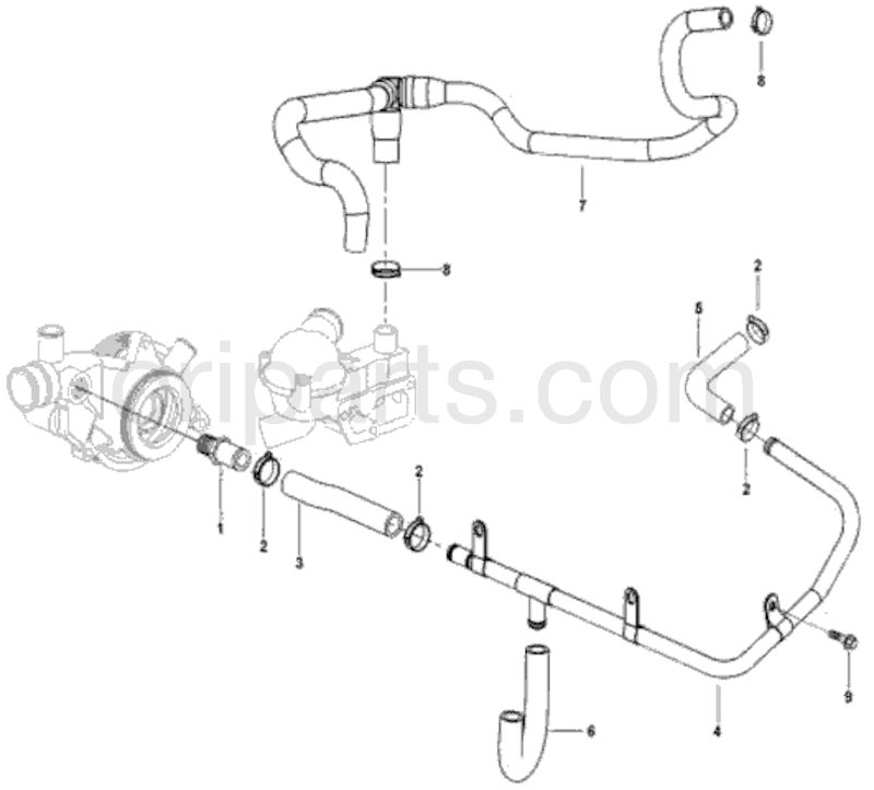

I looked up some part schematics for the Thar and came across the attached pic of their heater hoses which show where the factory lines connect just in case I do get a Roxor.

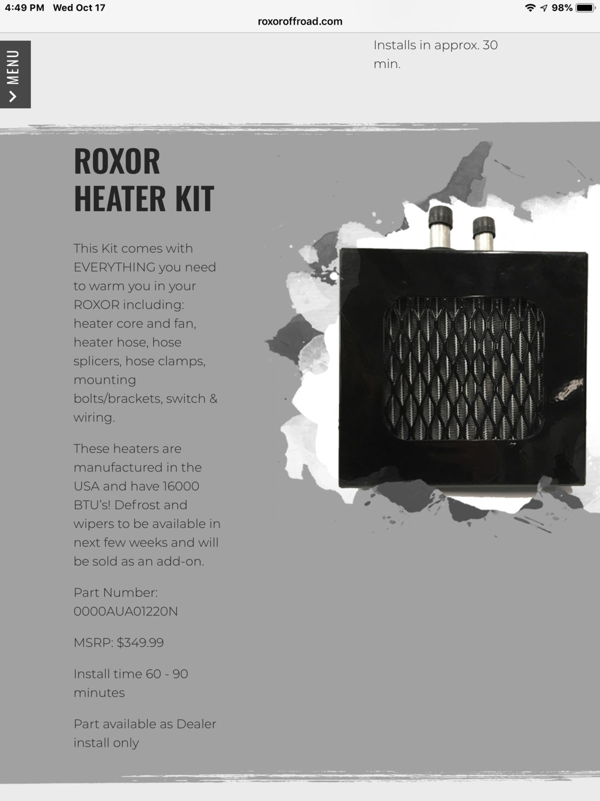

Part available as dealer install only. Looking at a $600-700 heater, lol.
I think when they say "dealer install only" they are actually saying it is an add on after manufacturing and not done in the factory even if you order a Roxor with a heater, not that you can't install it yourself. I know guys that can't or don't want to and they have more money than they do mechanical skills, so they would get the dealer to install it.
