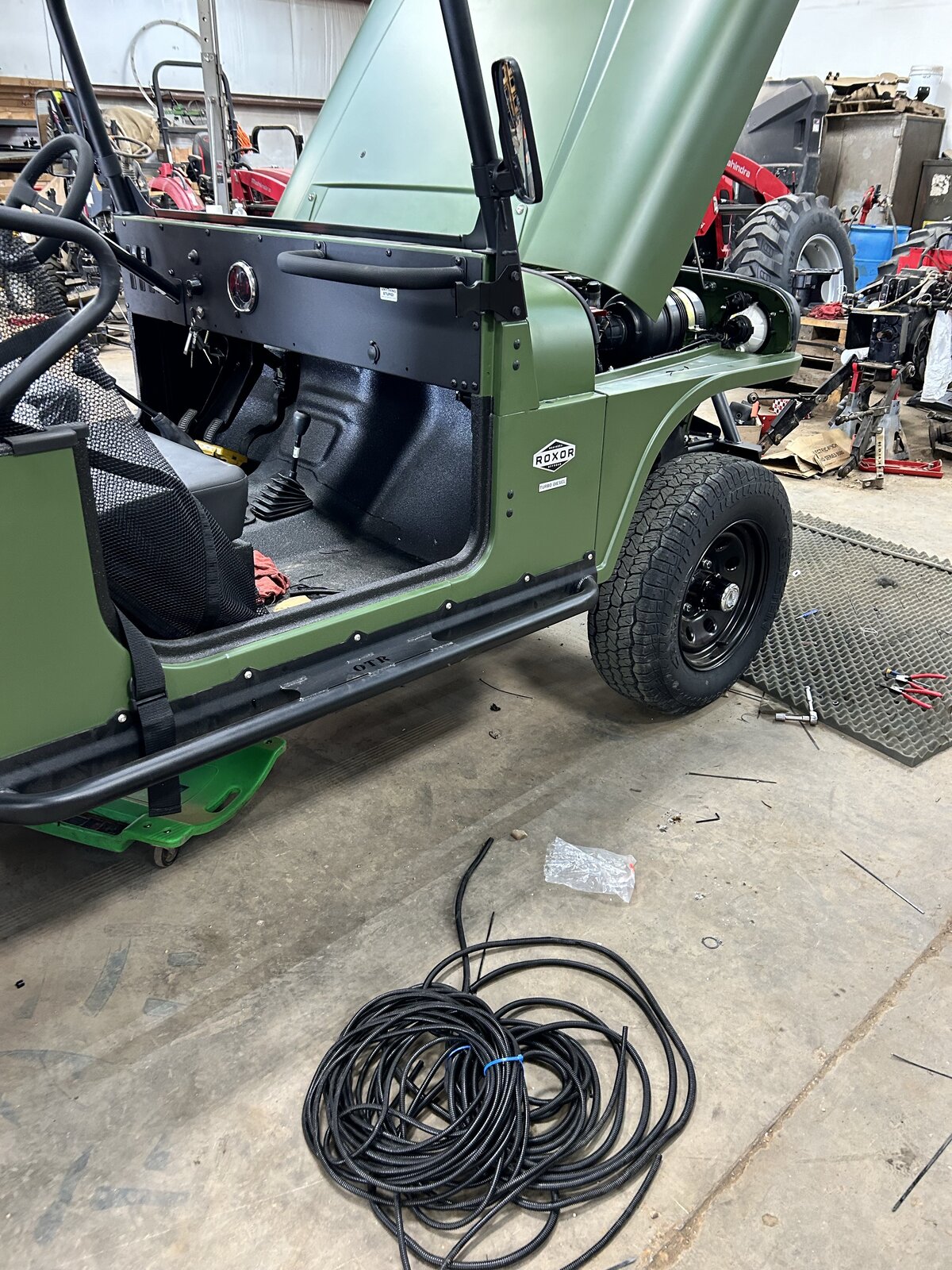

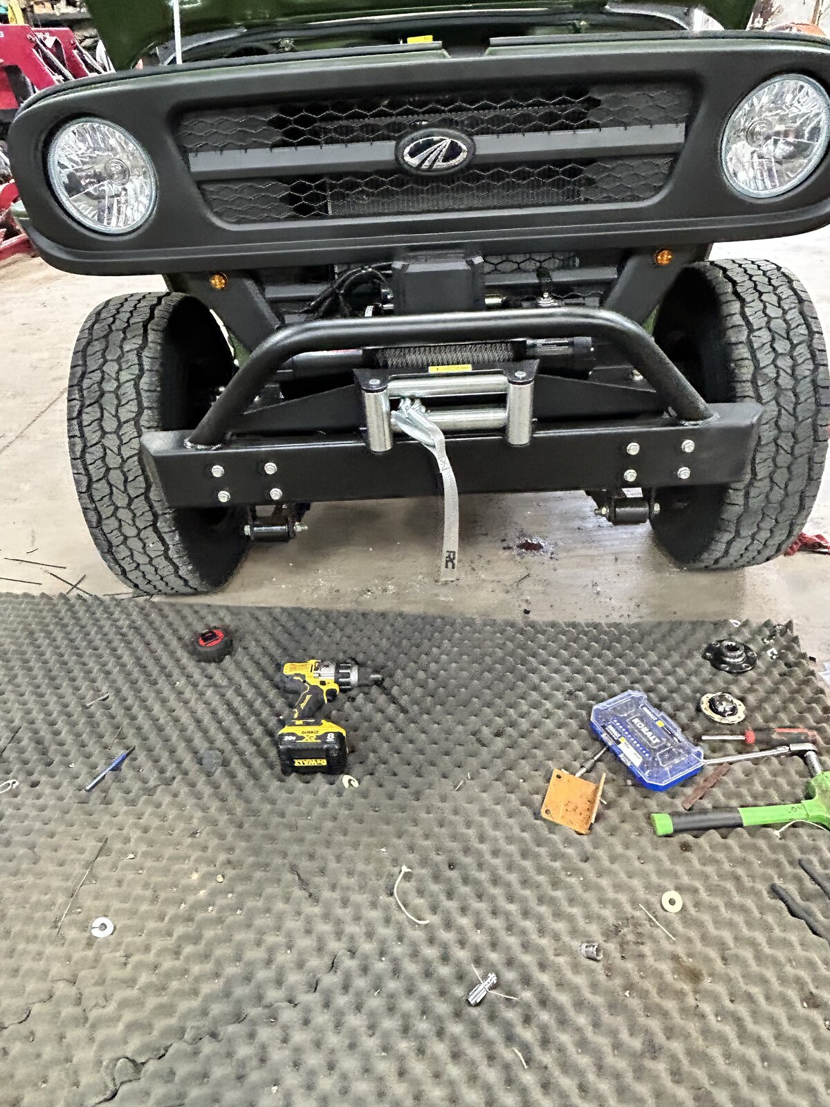

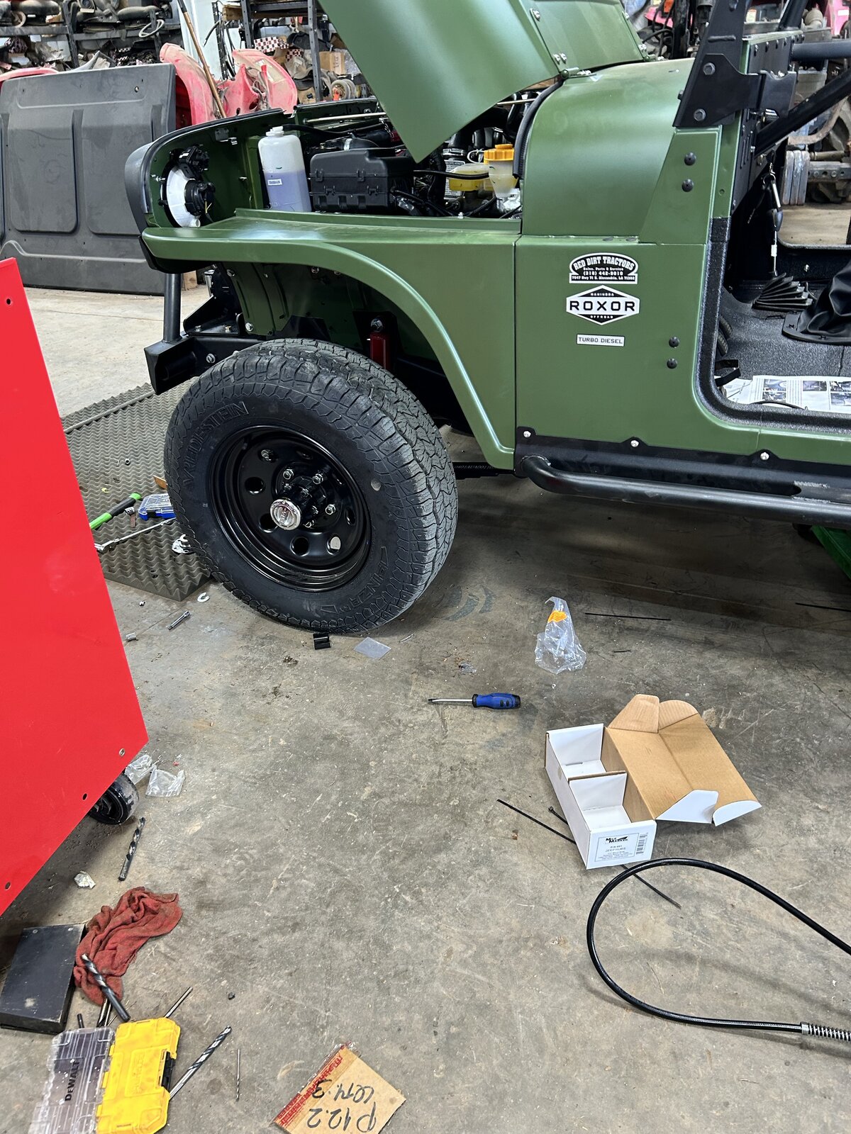

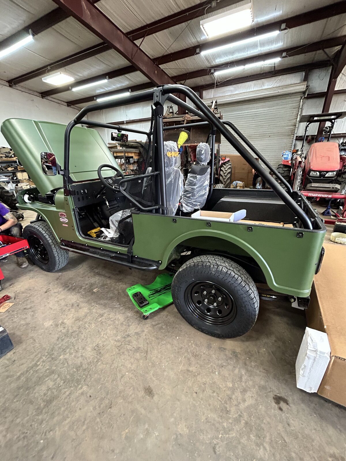

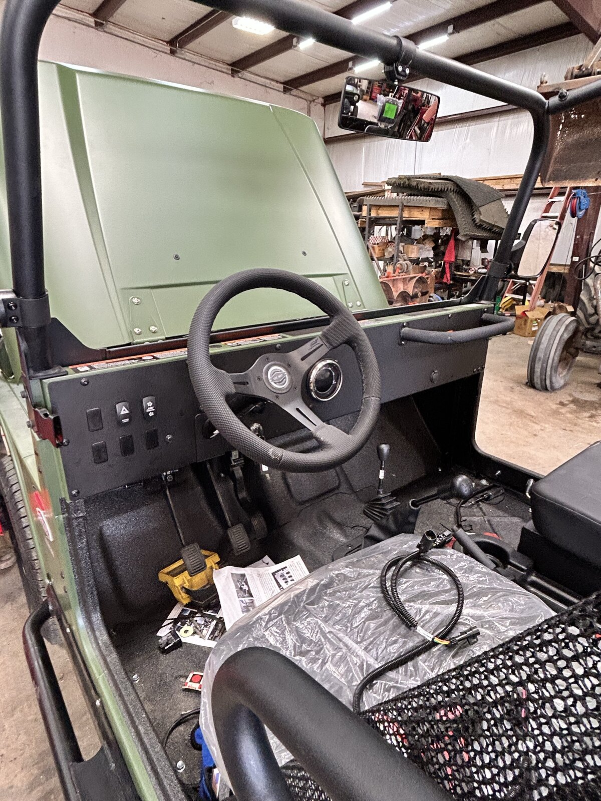

Bob R1
Mar 1, 2023
244
Missouri Ozarks
I see Front Turn Signals Lights in the Grill, and a Couple Switch's. Looks like the Turn Signal Kit is installed.
We have a Front Bumper with Bull Bar.
We have a Winch Installed.
Looks like the Sports Bar is installed.
I see Rock Rails on the sides.
Looks like the Locking Hub's are installed.
The OX Locker Cable and Levers might be what we are seeing in the Center Picture. The Locking Hubs are installed on the front axle, so you would think that they would have installed the OX Locker before the Locking Hubs.
They still have the Roof and Windshield to install.
No Rear Farm Bumper installed so far either.
Shocks, can't tell.
Looks like the Tires still need installed.
1.5" Climax Lift does not look to be installed so far either.
OEM Side Steps are not installed either.
They are probably three days out. My guess would be about One to Two Hour's on the Top and Windshield.
Probably another Hour on the Rear Farm Bumper.
Shocks will probably be another Hour.
Tires another Hour.
1.5" Climax Lift another Hour.
Side Steps will take another Thirty Minutes to an Hour.
The Front and Rear OX Lockers will take some time. My guess would be Four to Six Hours per Axle, unless they have the Lockers installed, and have not finished running the Cables or installed the Levers so far.
If the Mechanic can stay on your project, you might be driving it this weekend with a lot of luck.
Bob R
