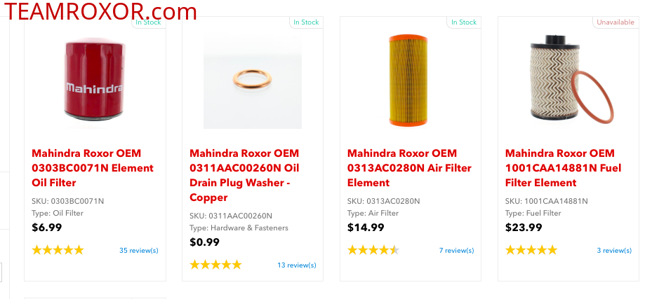

Found this on search.
CJ2Rox said:
I'm 200 miles away from my first oil change. I was told 51626. I've cross referenced both numbers and will personally Run a Amsoil filter.
View attachment 8464 View attachment 8465
Just did an oil change and used the six 51324. It’s a little shorter than the Mahindra filter and only cost $10. Went with Rotella full synthetic and it was $50 for 8 quarts.
The Roxor dealer was out of oem filters and said they are $25 when in stock. They did have a service kit that had oil and a filter for $150.

I try to buy all of my Roxor needs from Sherwood Tractor (ad on home page here) . They have oem parts at reasonable prices. To get the best bang for the shipping cost, get several things at a time. OEM Filters should be under $10 at the dealer , $25 is a ripoff.

I've used them too and was happy with the delivery time, price and customer service. Now, that being said, has everyone switched to the Wix brand oil filter? OEM not available and no estimate on getting them back in stock. I really didn't want to hunt them down on ebay and pay $$$$$$$$$.
