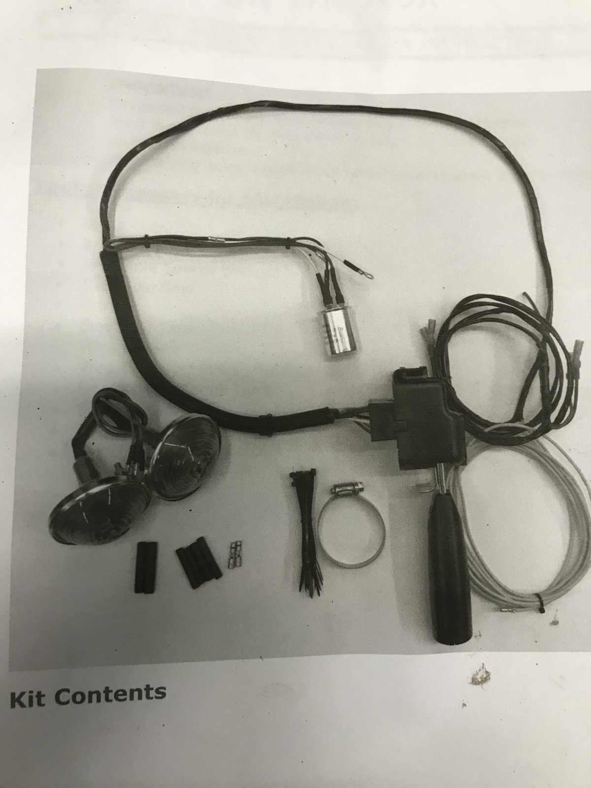

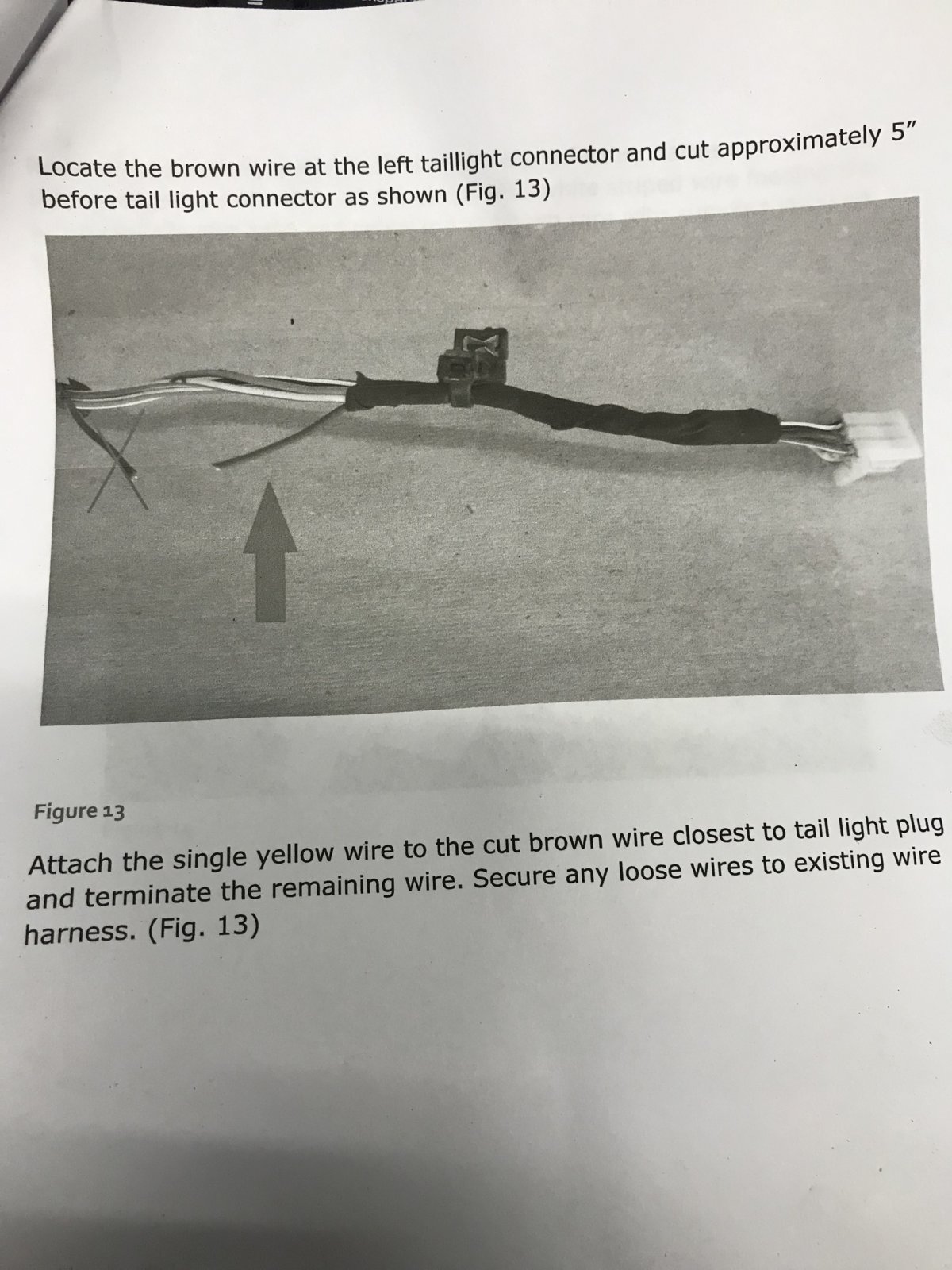

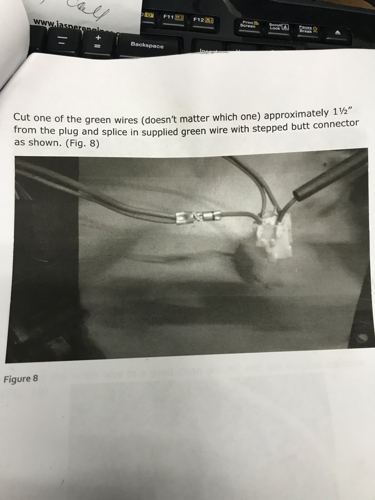

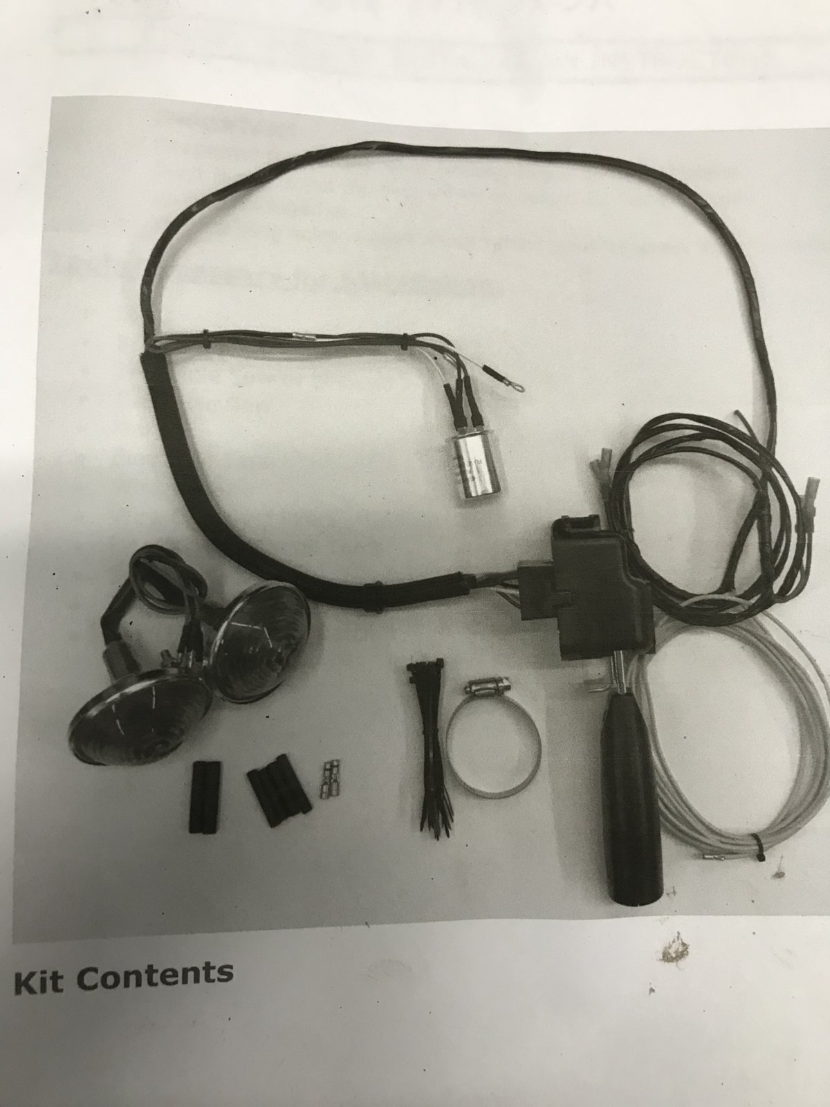

As far as turn signal harness goes I still have directions for my purchased kit which will tell u where to splice in wires and color codes it uses a standard Grote truck style turn / emergency switch u can get at Napa with harness u only have to add on the front two lights and add wiring to them

I’ll post it tomorrow they are at work

I’ll try to load pics now

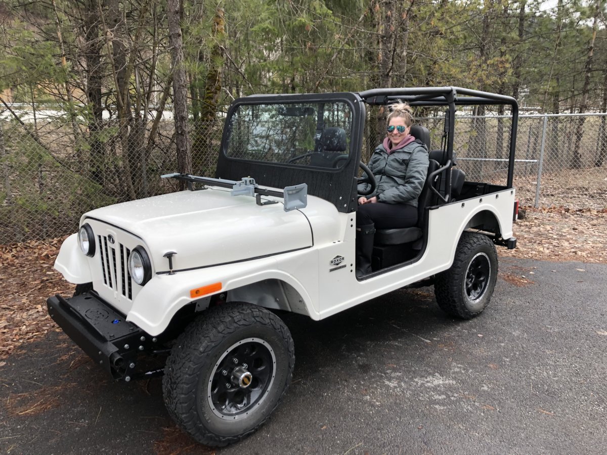

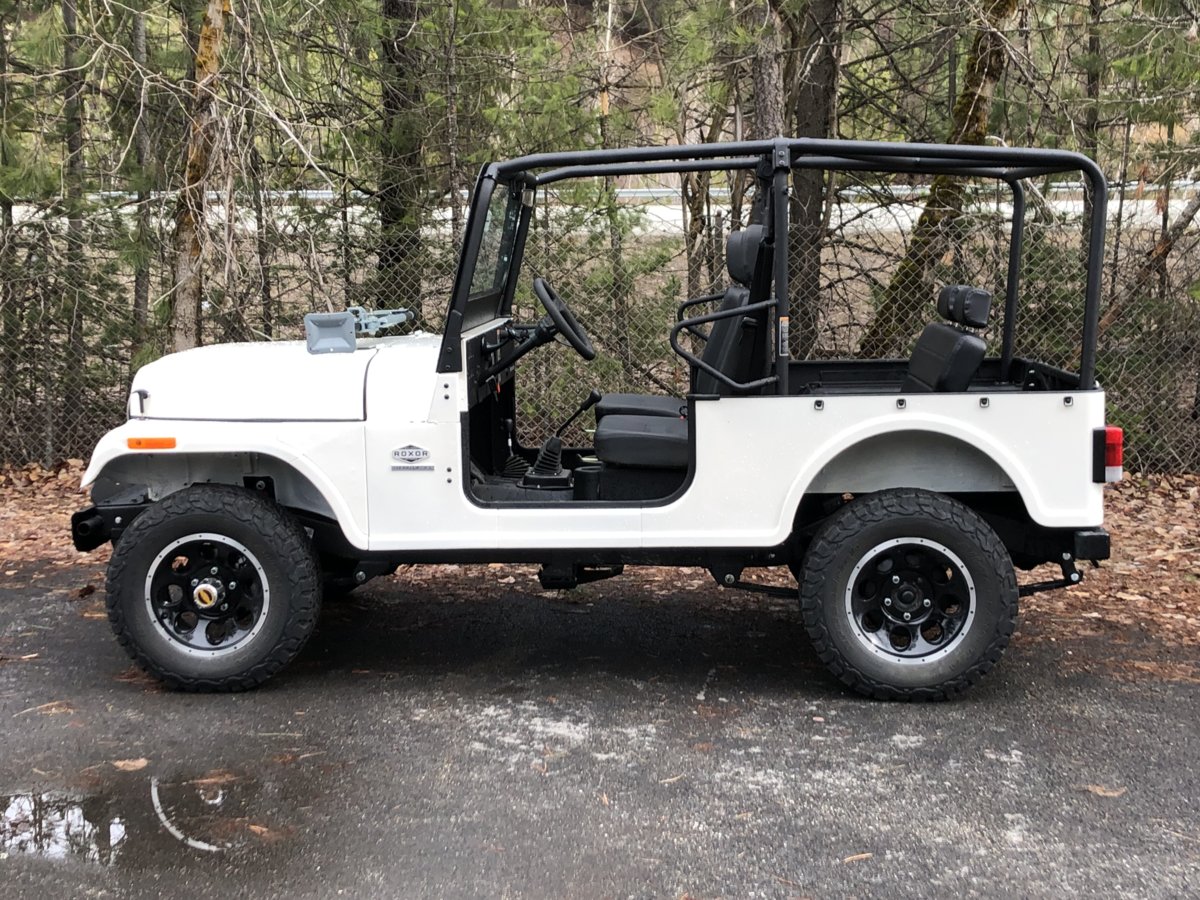

Got everything I built turbo lined and a locker installed in the rear axle, pretty happy how it all turned out! Second picture is my girlfriend driving. Haha
