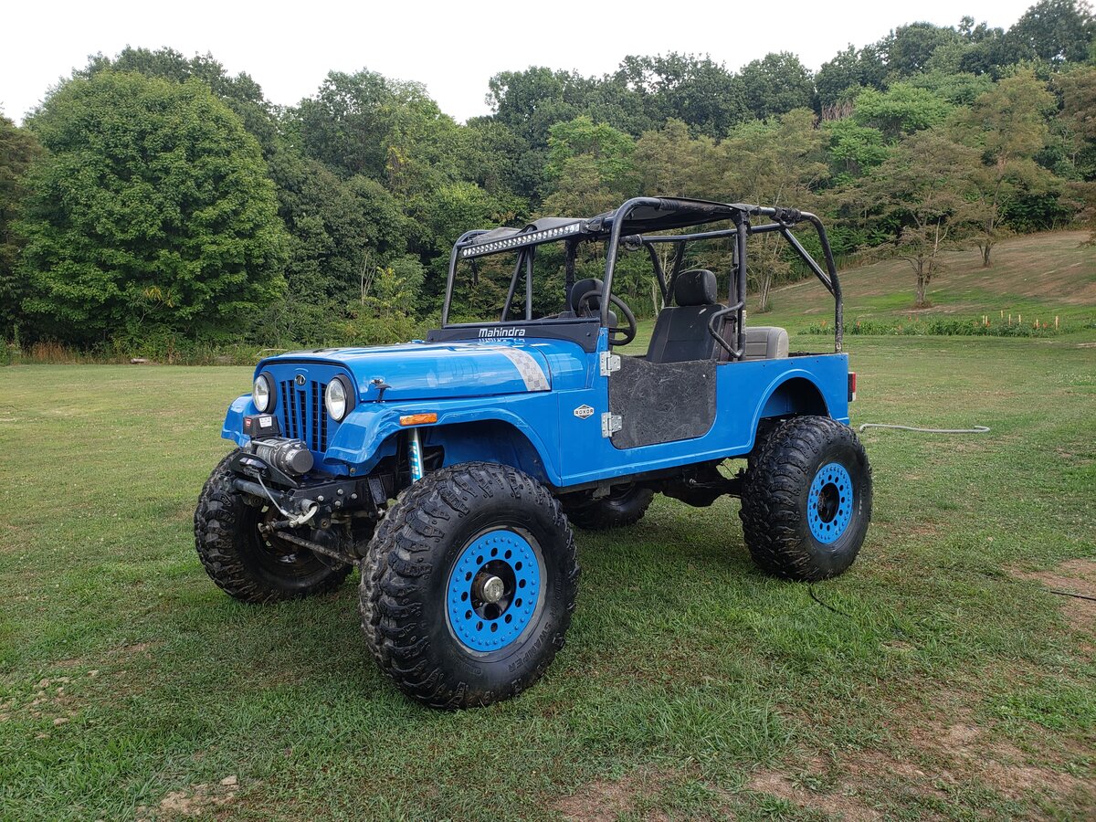

Now that it's done and I've been wheeling it all summer, coming back to a transfer case swap. This winter, the transmission and transfer case are coming out to start building an adapter.
