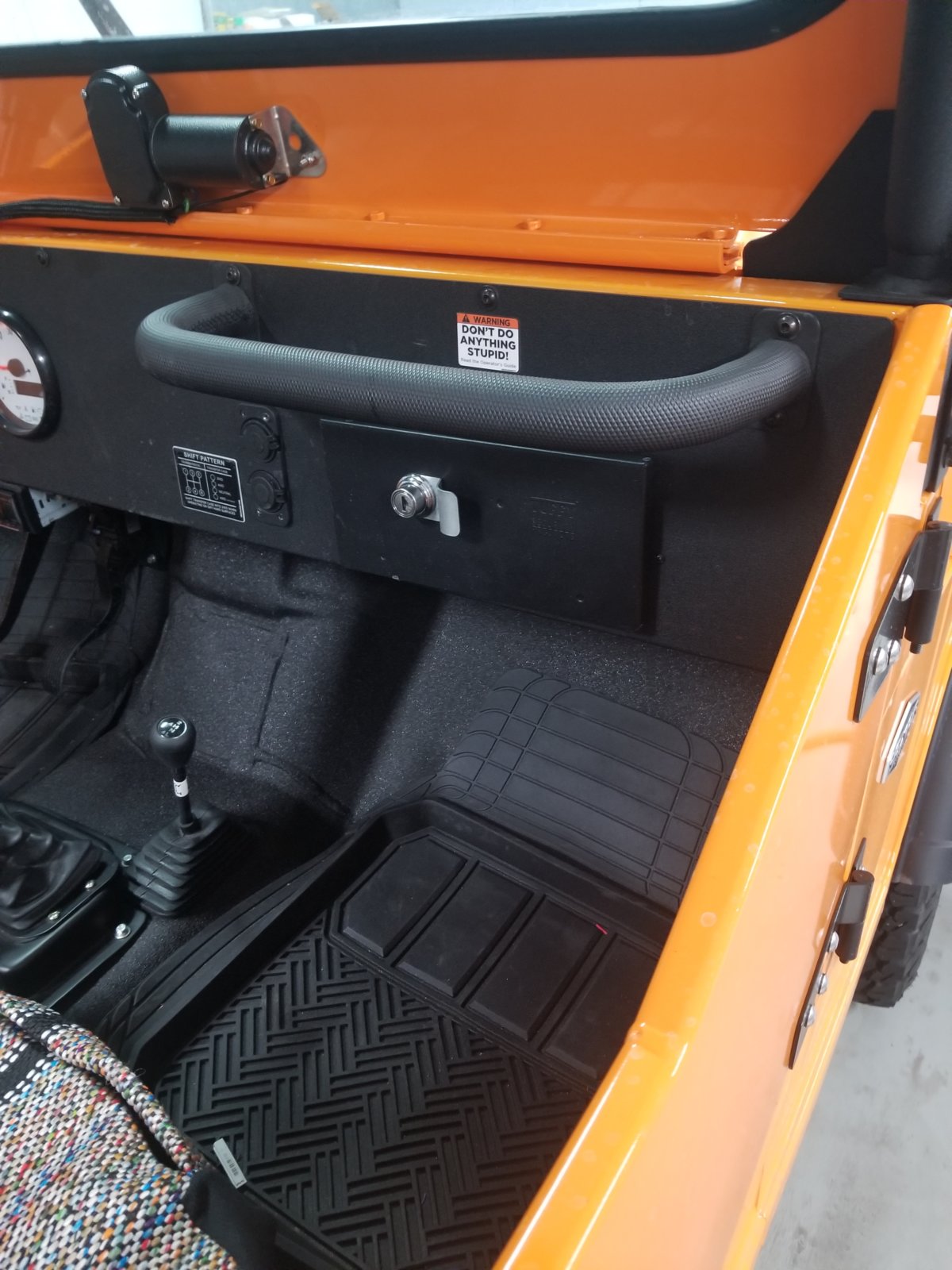

I was thinking it would be cool to somehow put more lockable storage in the dash, such as something close to a conventional govebox. Seems to be plenty of room to do it I think.
I mounted a locking glovebox in the dash using an air cut-off wheel.
I am looking at mounting a radio receiver next--but first must relocate the lights and horn switch. The glovebox was bought on amazon and is made by Tuffy 035-1. made for CJs

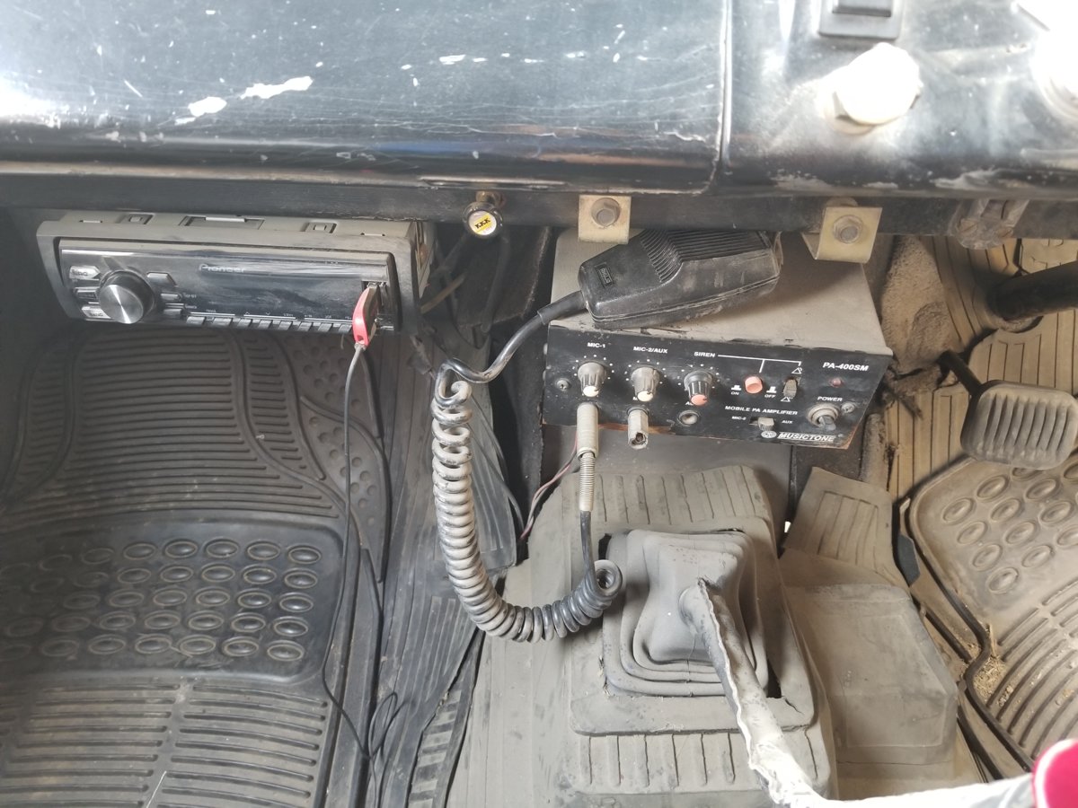

This looks neat, but in my opinion just to install a audio system you could just use some metal brackets and install it under the dashboard, unless you want to install the heater which kind of goes in the same place.

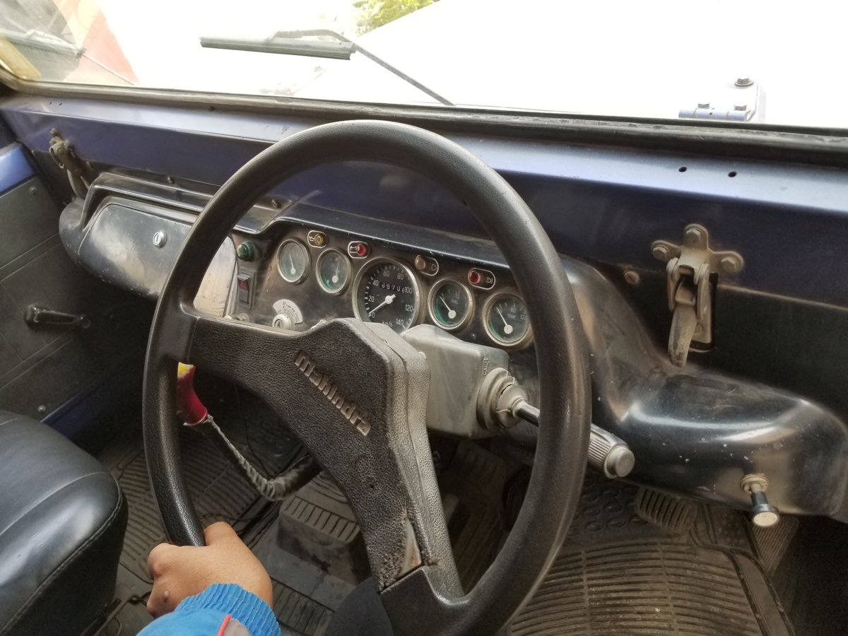

I have this old MM540 back in my ancestral home and there are some pictures of it with some audio system installed
Here is how an 1985 mahindra (408 k miles on it) dash looks like, it has an IDI engine so you can see a glow plug heater coil as well. Dont mind the dust in the pictures this thing still runs.
