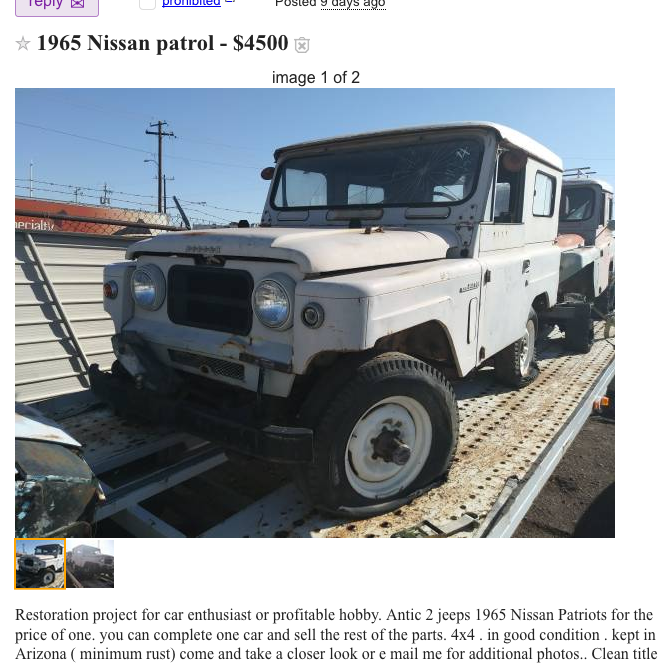

If I were to do a Roxor drive train, or frame and body swap, I'd go a bit exotic.
876
I like the Willys Wagon, Willys pickup, or XJ.
