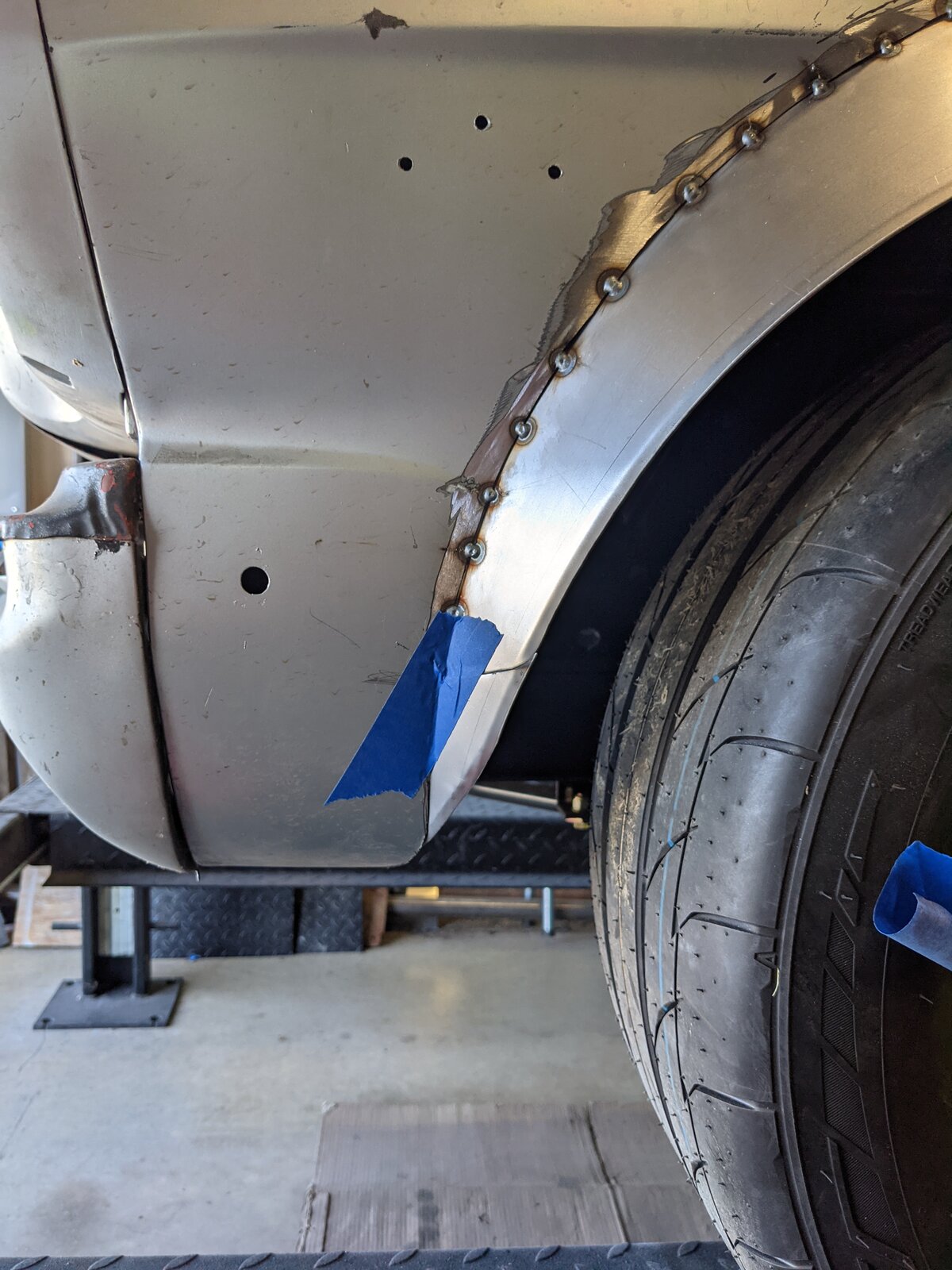

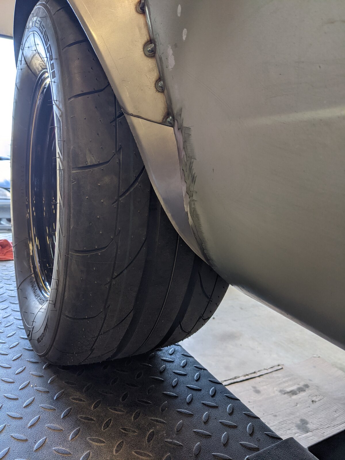

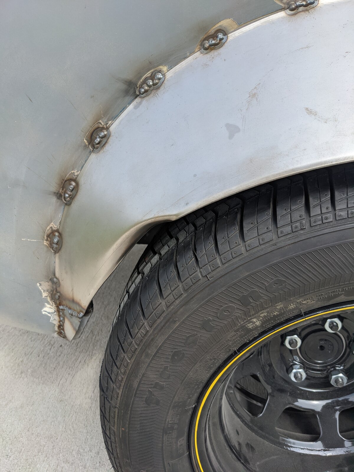

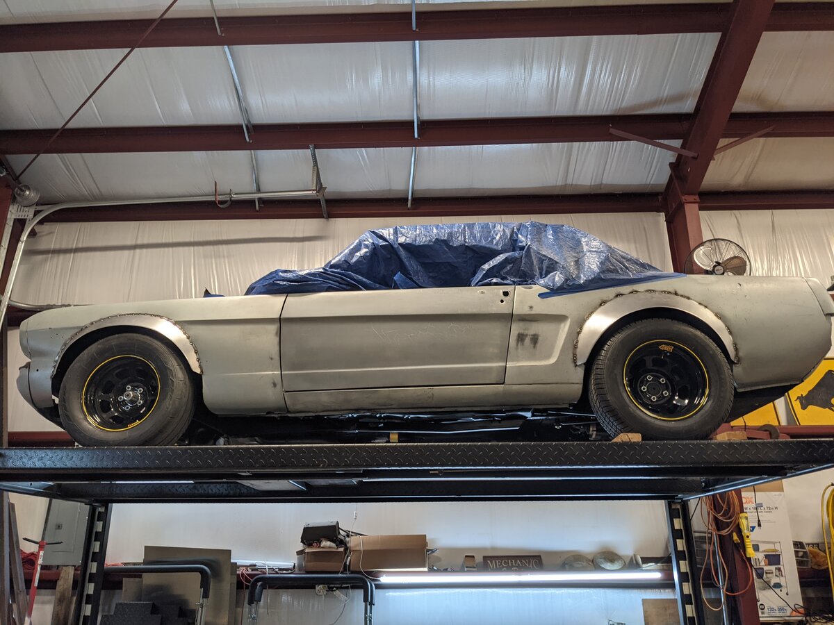

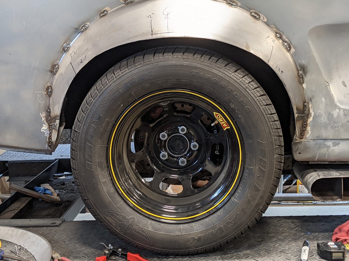

We took a break but I did fabricate some flare extensions that blend the flares into the body. Still need to weld them but they fit great and finishes out the flare where it looks like part of the car and not just a stuck on flare.

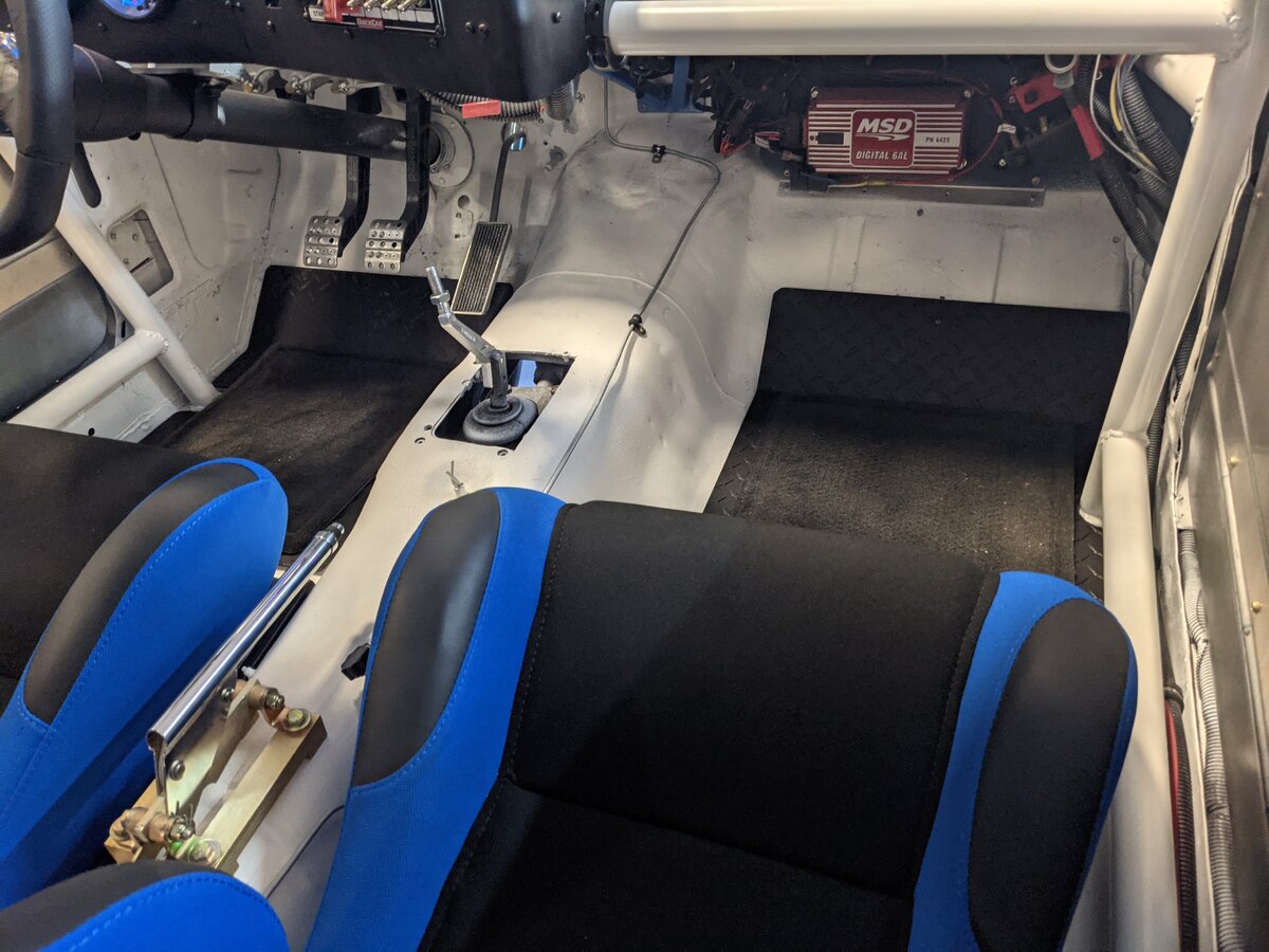

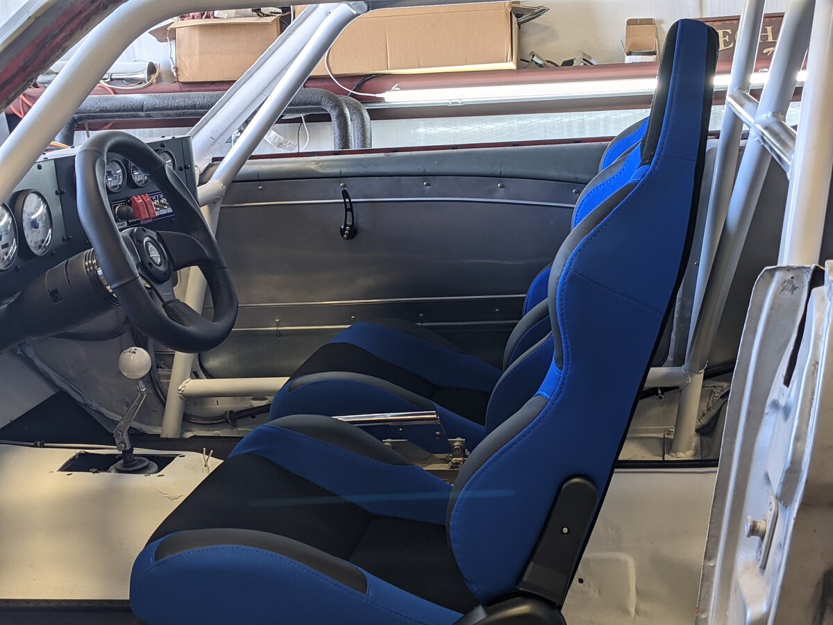

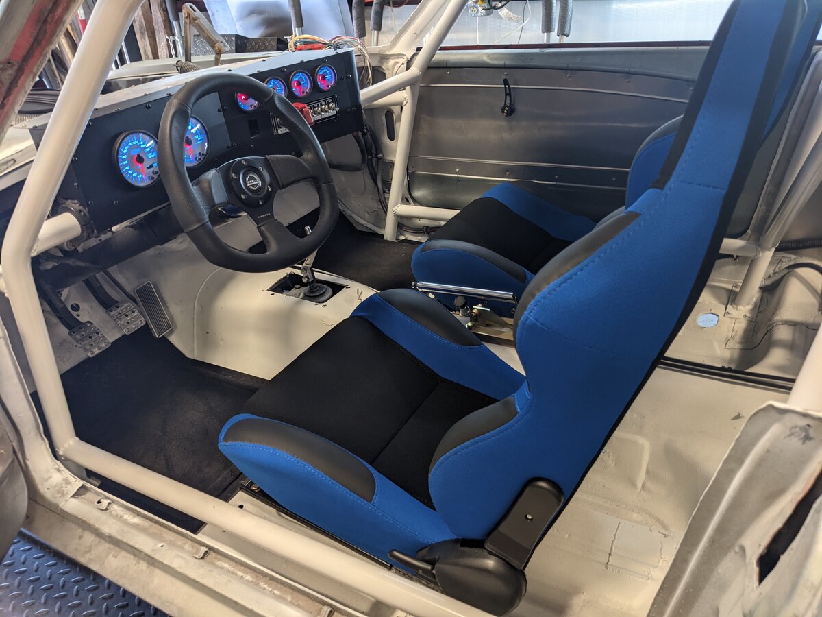

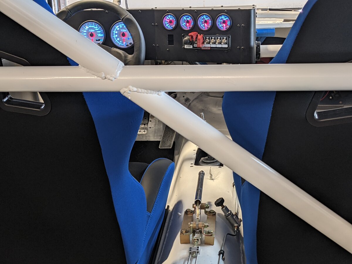

Installed the floor plates after adding heat/sound blanket to the back side. Installed the dash cluster. Installed BOTH seats for the first time. Installed the battery hold down frame and the battery. Hooked it all up. Test fired it! VAAAAROOOOOM!!!

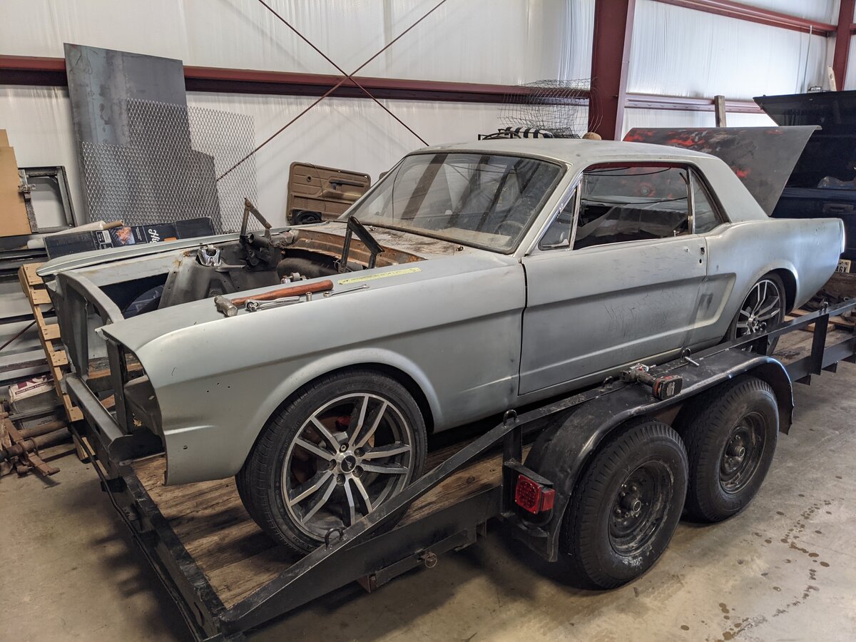

Well thank you sir. I am trying to get it to at least drive around the block by April 15th, which will mark the 1-year anniversary of dragging it on a trailer in a cold April drizzle late one night to get it home.
I usually get 15 to 20 hours a week in on working on it with a few weekends here there with Pete's help to good 8-hour days.
I'll post a THEN and NOW pic. Lolol. Don't look much different Sept it's missing the trailer! Lolol.

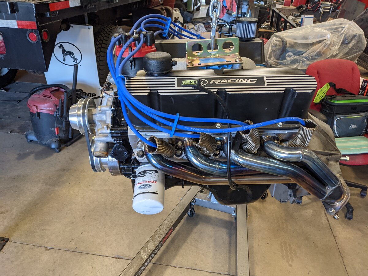

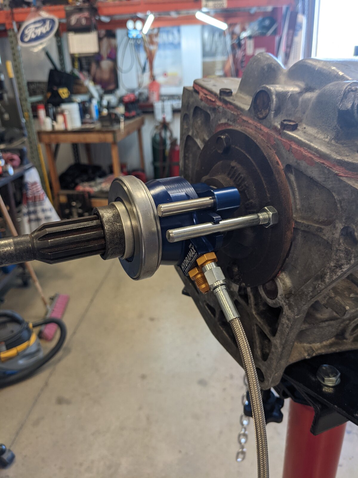

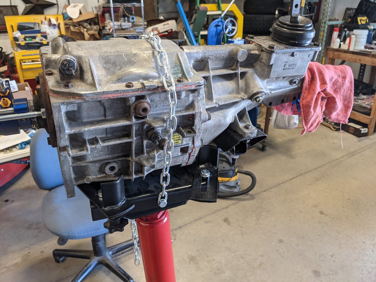

04/09/2022 UPDATE:

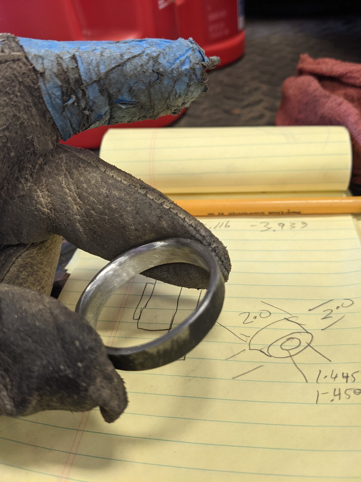

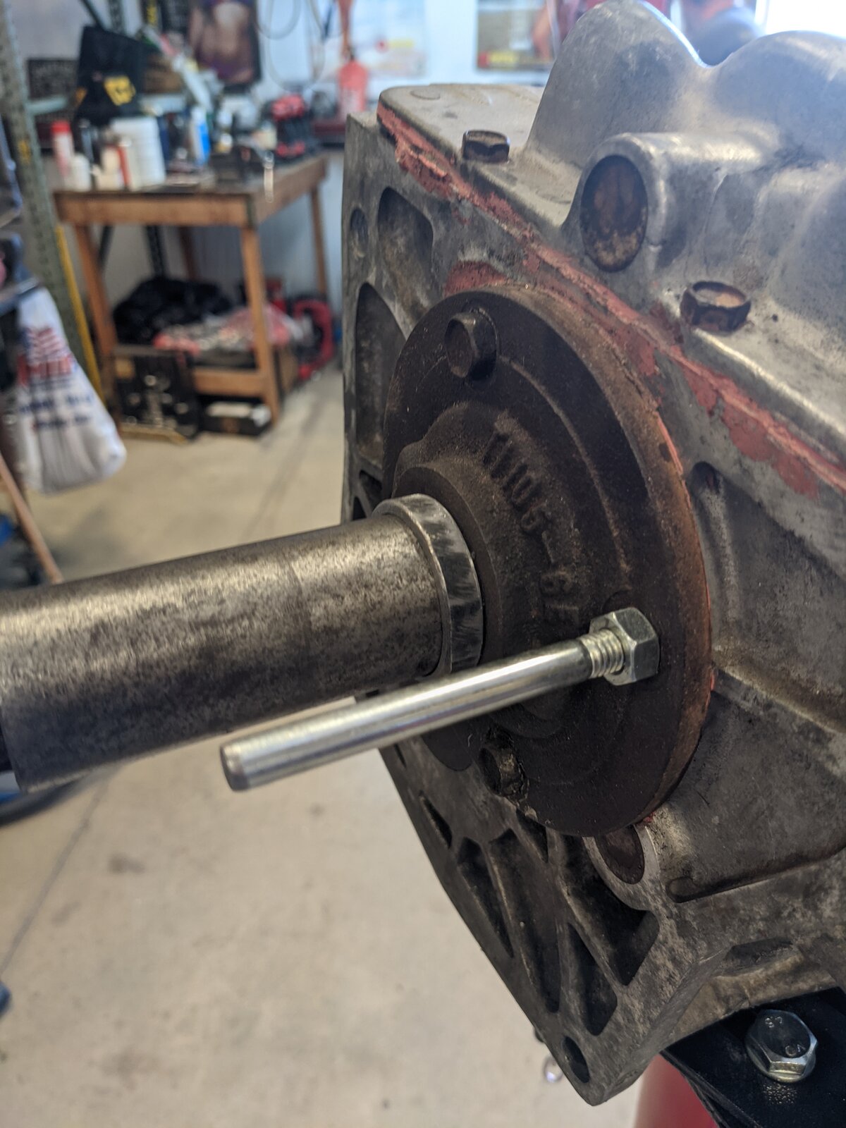

Well, my cheap bastard bargain bin hydrolic throw out bearing that mashes the clutch pressure plate which releases the clutch was not as labeled. It's not for a Ford T5 tranny. It came up 1/4" to short per the clearance measurements.
Also, the part that keeps the mechanism from spinning is not correct nor was the bolt that has a locating shaft. Wrong thread.
Found a bolt in Pete's buckets of bolts that we converted to the correct locating shaft.
Looked and looked in all the pieces of material around Pete's shop to fab a spacer with no luck.
Went to Home Depot and found a piece of pipe in the plumbing department that was a drop somebody left on a shelf. I asked about it. Nothing they sell. I asked for it and they gave it to me. Lol.
So went back, used the chop saw, cut a spacer from the pipe. Sanded it to exact length and chamfered it to seat against tranny pilot shaft plate. Then stuffed on the rest of the non Ford parts. We made the correct spacing within ten thousands of an inch. .010. lolol. Fingers crossed.

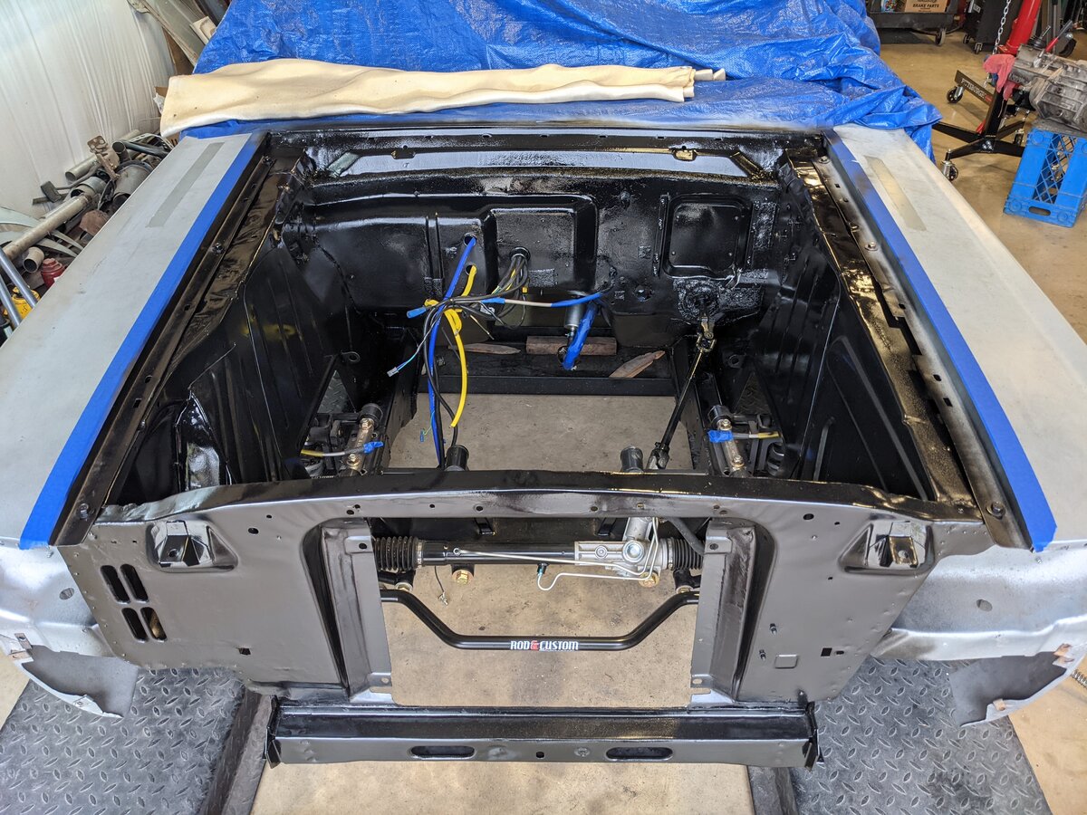

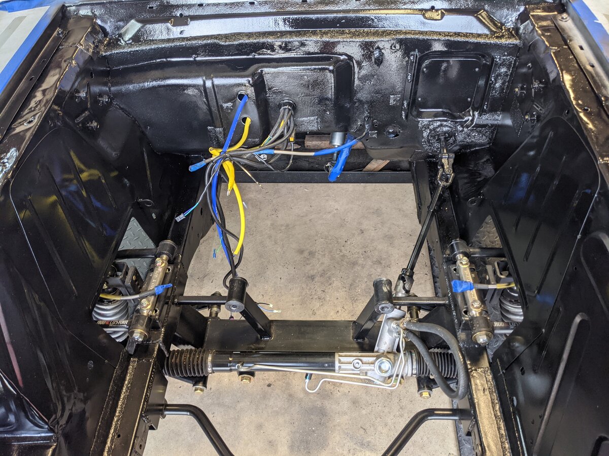

Pulled the engine so I can finish cleaning up the fire wall and clean, seal and paint the complete engine compartment.
PXL_20220409_222648948.jpg PXL_20220409_222703100.jpg PXL_20220409_222709230.jpg PXL_20220409_222814076.jpg PXL_20220409_224105347.jpg PXL_20220409_171756345.jpg PXL_20220409_171803457.jpg

Well, I did the " Tammy Fay Baker" make over to the engine bay today. ( if ya ain't old, you won't understand who that was. :) ) Got all the crusty areas in the engine bay cleaned up and either painted, undercoated or both. Plugged all the arrant holes here and there and wire brushed away some rust.
Except for where I kept leaning in on painted areas that were still tacky, it looks mostly decent.
So letting it dry till tommarra afternoon and we will then stuff the motor back in. May get the tranny in as well. Then the drive shaft.
We serviced the rear end with it's posi-trac STINKEY additive and serviced the tranny.
Then it's bleed the clutch system, get it working then start the bleeding of the brakes. Fingers crossed.

04/12/2022 UPDATE:

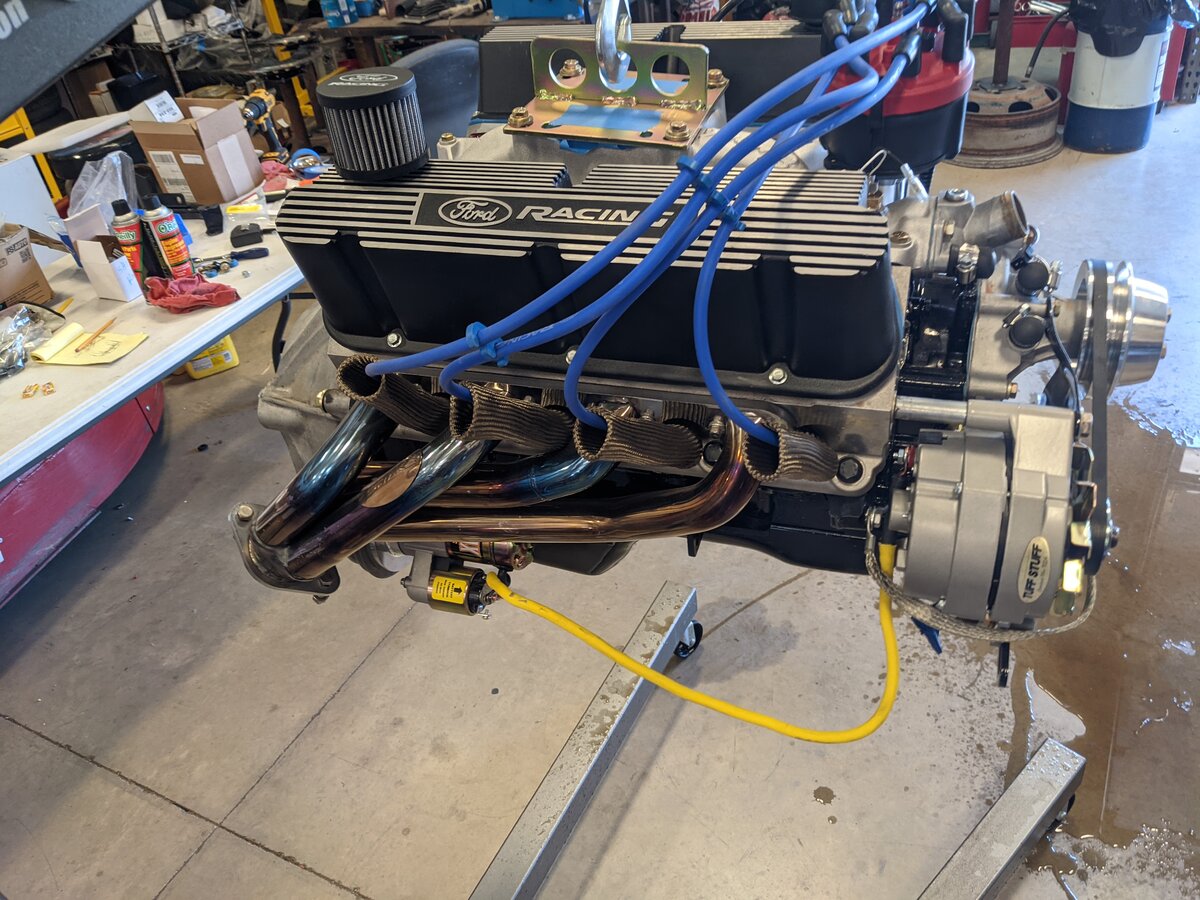

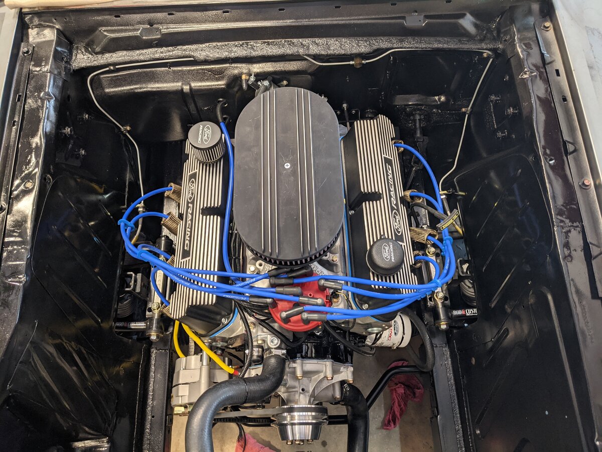

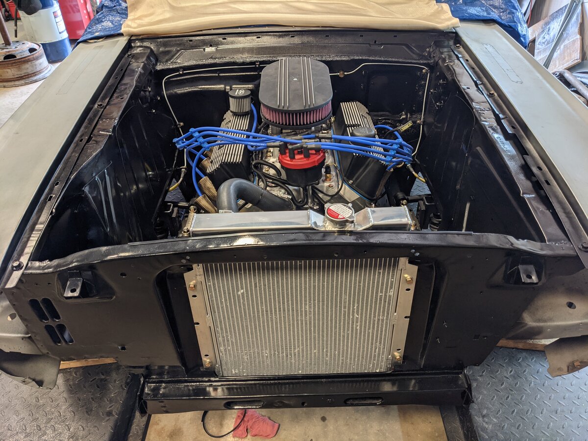

Well yesterday, Pete and I got the motor in, tranny in along with the throw out bearing system, drive shaft and got it all tightened up in 1 hour 20 minutes.
That included pushing the car out and turning it around, get it in, stuff in motor, push back out, push back on the rack to do the tranny and the rest.

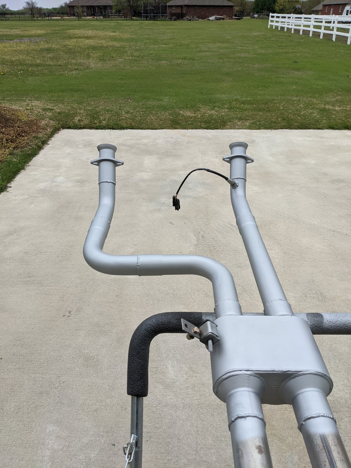

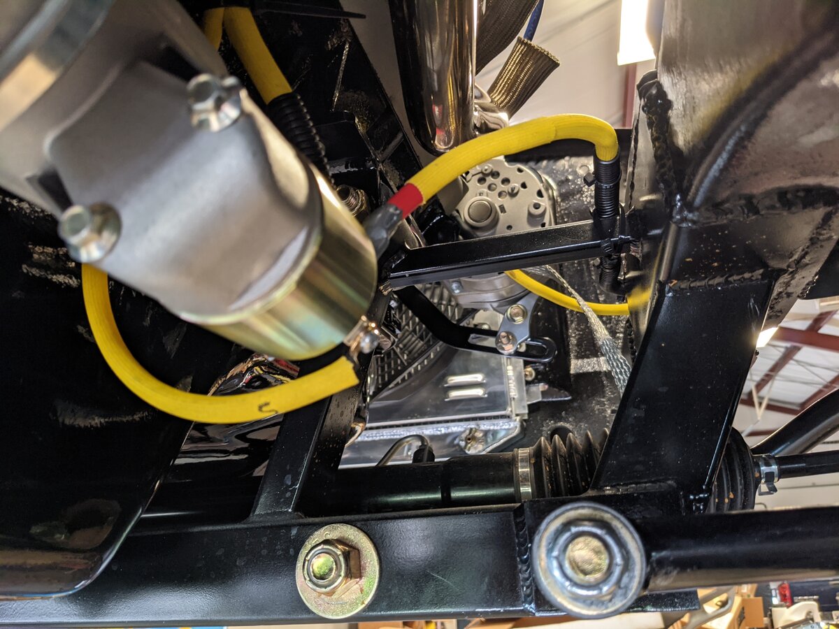

Today I installed the EFI throttle body, Atomic 2900, motor wiring is hooked up, radiator in, hoses on, wiring tie wrapped on top of motor, gas peddle linkage and gas peddle is in with boot, found some rustolium high temp black and some silver ceramic coat. So I sprayed the muffler fwd with the ceramic. Starter wires, alternator wire and ground strap installed. There is only one unhooked plug and it goes to the exhaust gas reader.
I ordered some heat shielding to go around the hydrolic line to throw out bearing assembly which is within 3"-4" from the headers. It's silver, it looks like NASA stuff from the moon lander. Lol. Good to 500 degrees touching and 2000 within 3 inches. It arrives tommarra.
Once I get the shielding on I can tighten all the clutch lines down. Bleed the system and see if it works, needs a stop or if it's good as is.
Then bleed the brakes, adjust the E-Brake and install the fuel tank vent line and roll over fuel check valve.
I think Friday may really be the day!

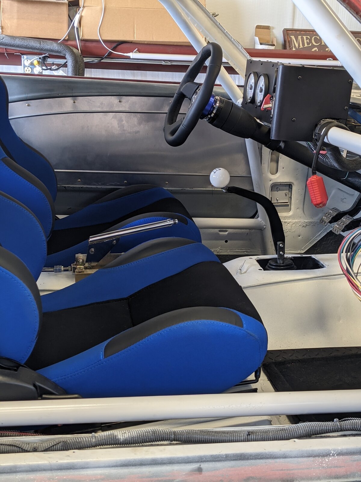

04/18/2022 UPDATE:

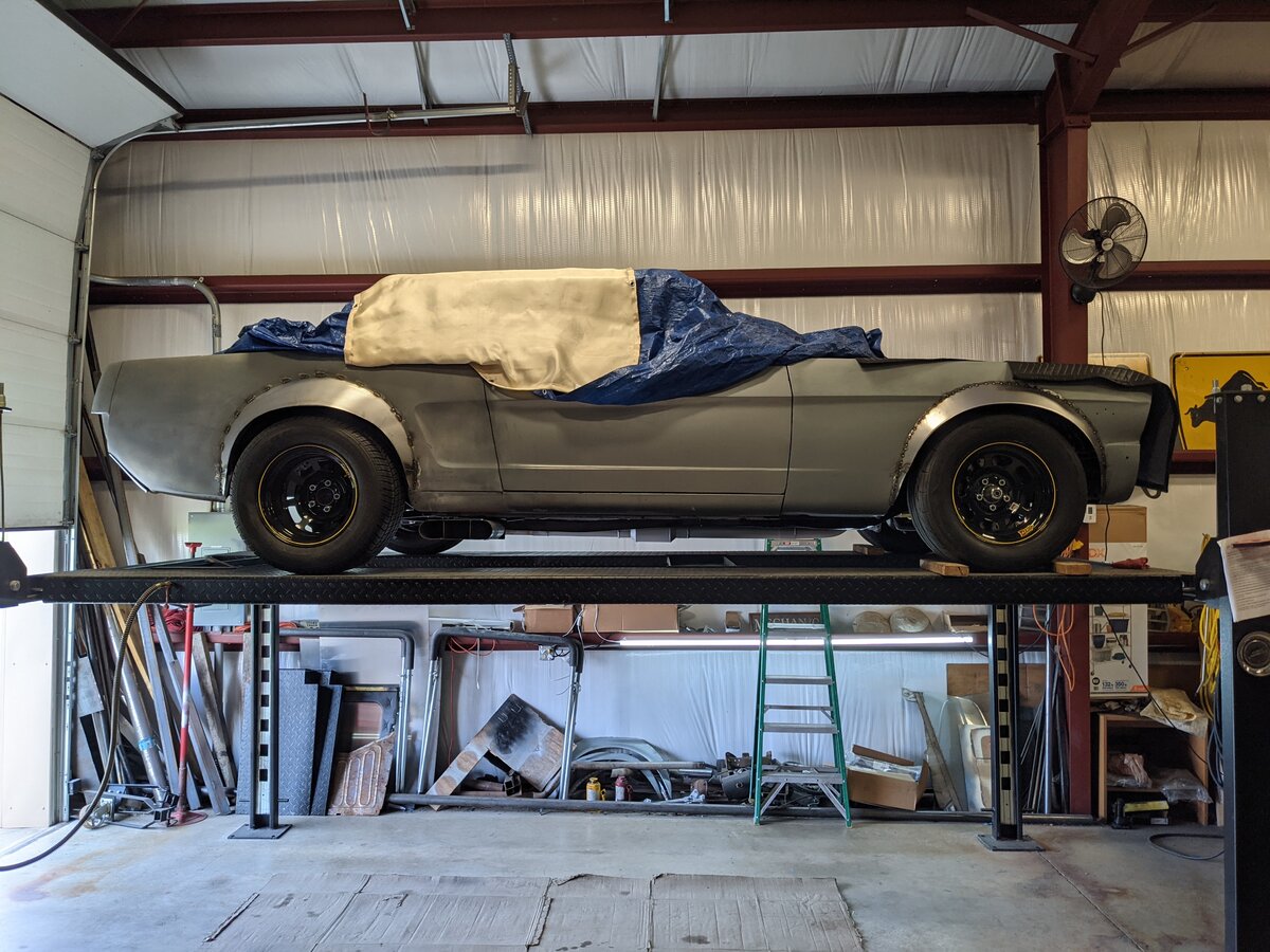

On Saturday we did a few more test drives. Actually looking at the gauges and paying attention to how it drives and feels.

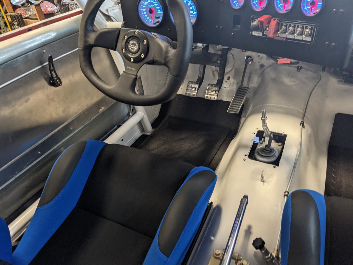

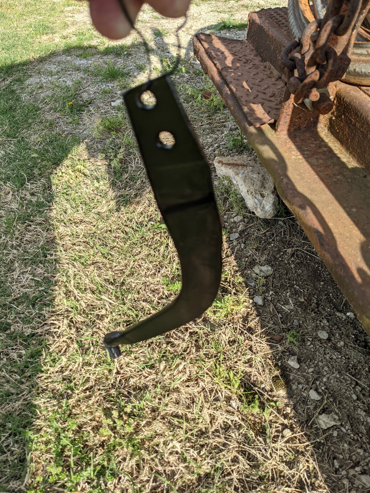

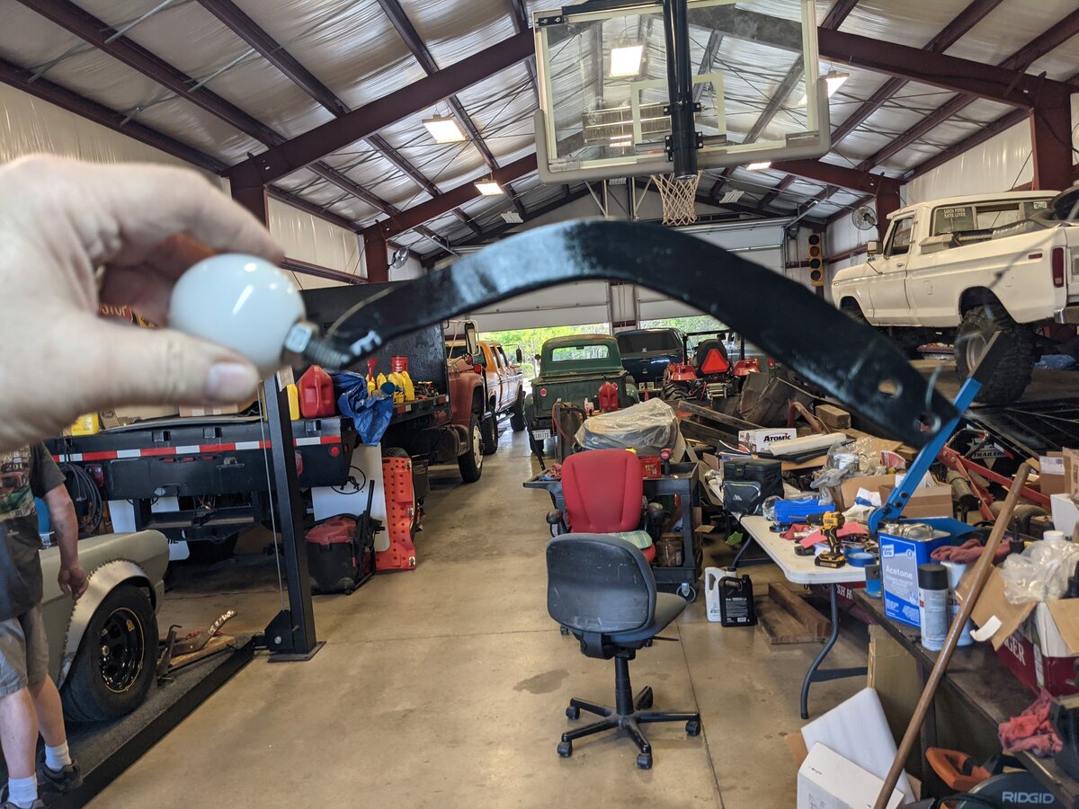

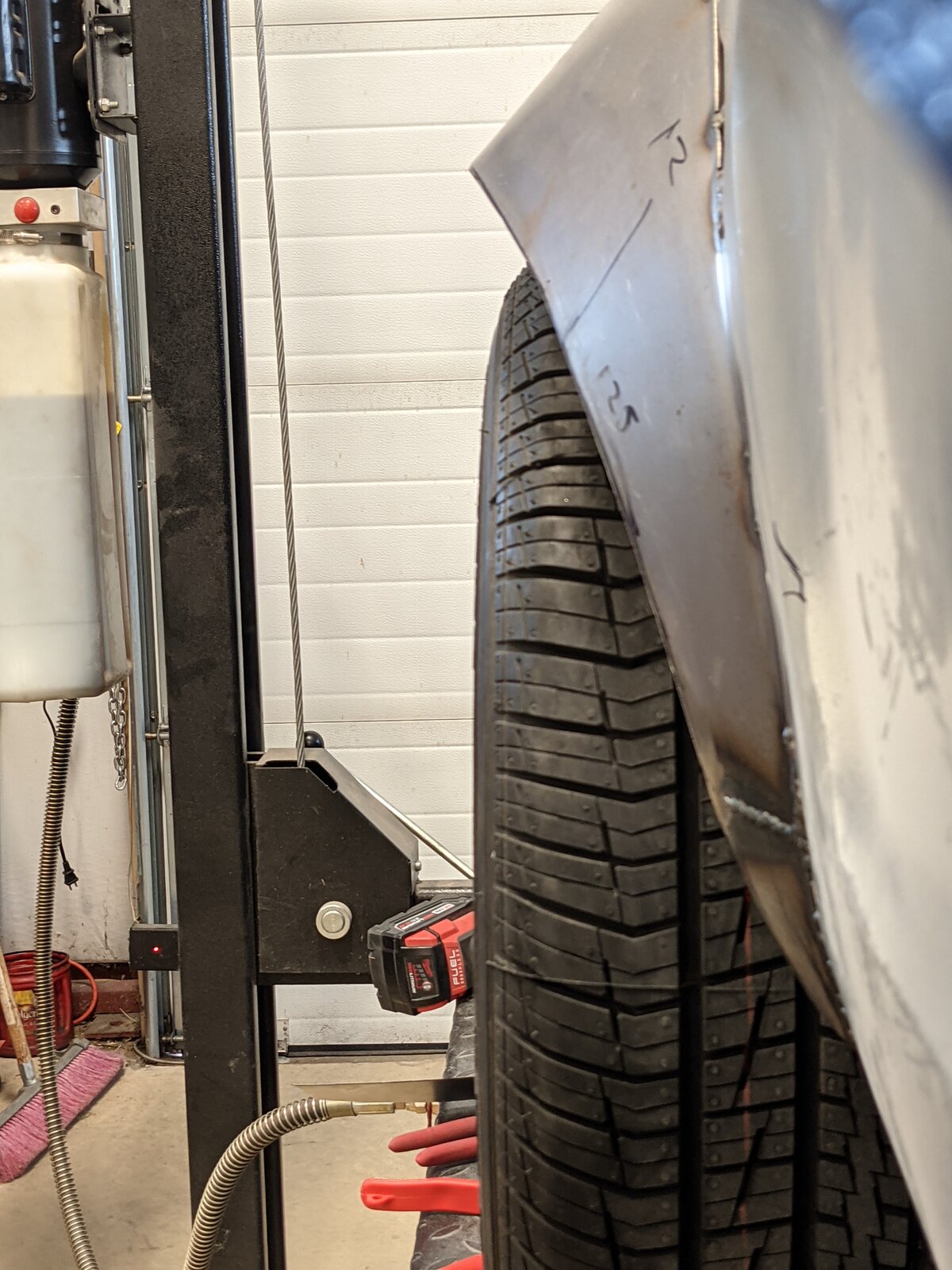

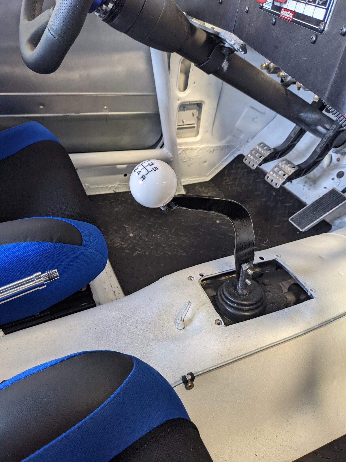

After Pete drove a mile or so I drove it. The shift lever I made from a clutch lever, yes, the peddle assembly was inverted and straightened then bent with attach holes added and a bolt welded to it for the knob. I had found it in a parts box, it fixed the to low and to far forward problem. The shift knob is now in a perfect position. Lolol.

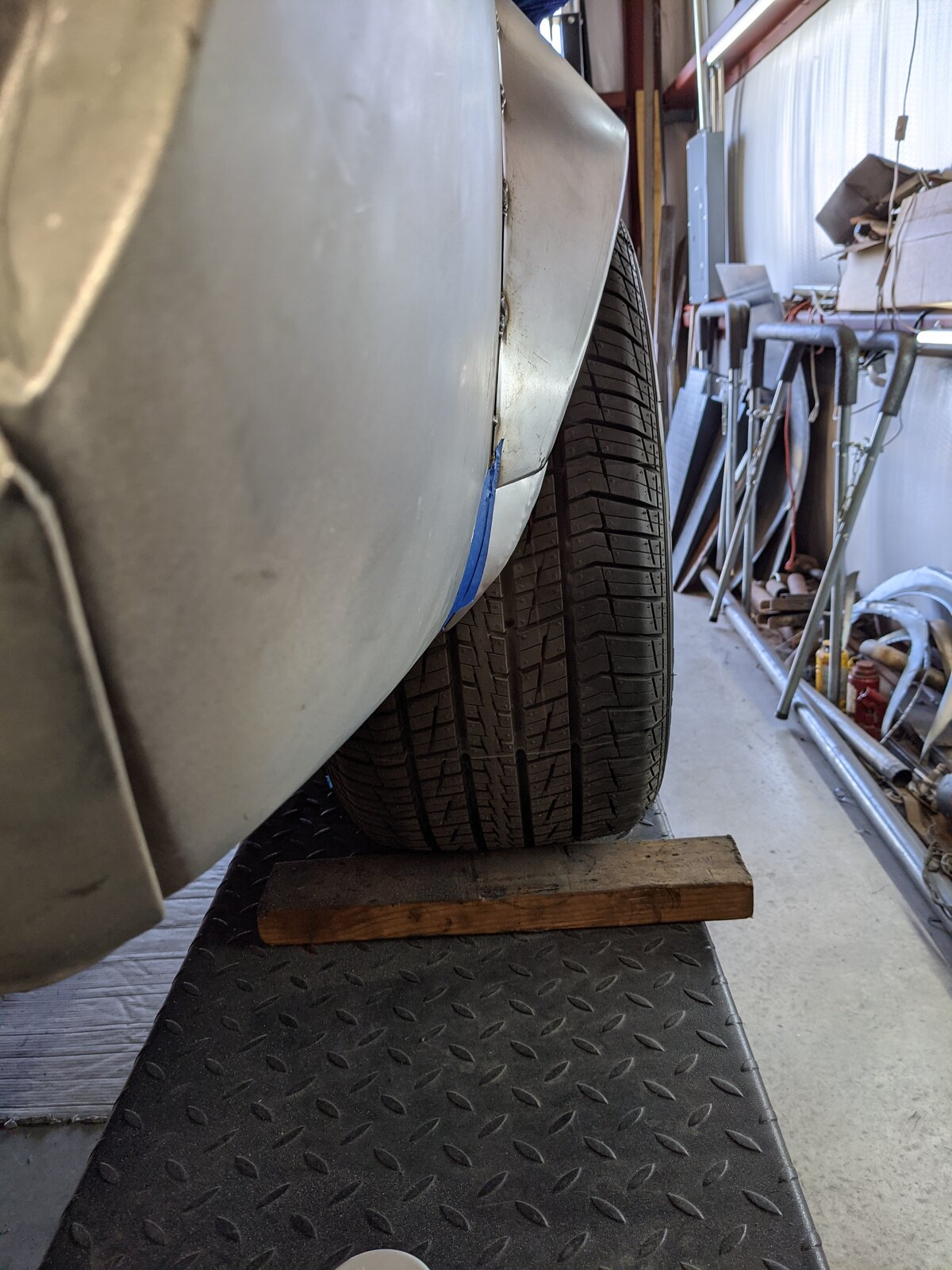

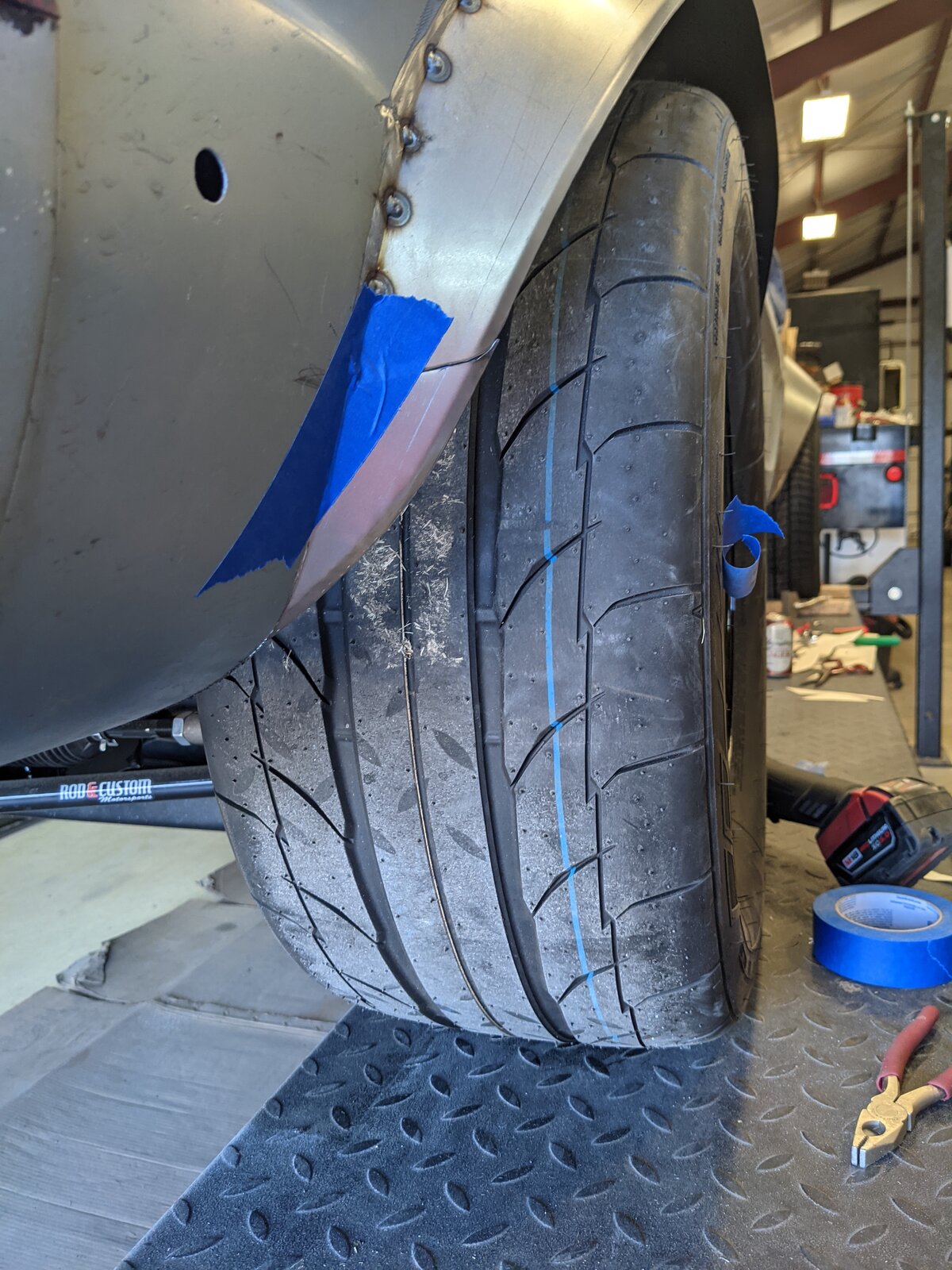

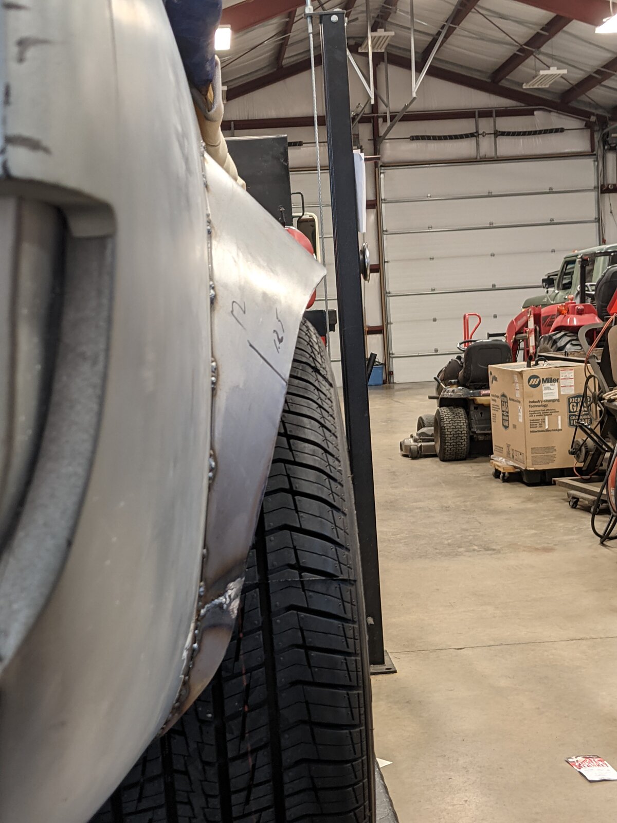

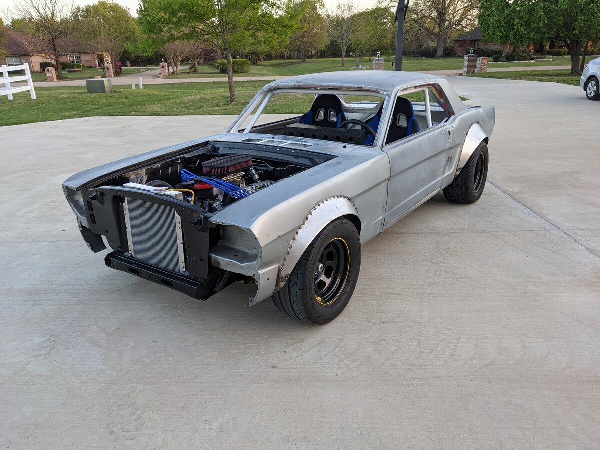

As I finished my mile drive I turned left into the driveway pretty hot. The driveway has a bump and is off camber a tad. Veeerrrpt! I rubbed a right rear tire on the flare! S H I T!!!!!
Now I have to re figure flare to tire clearance in the rear.
Need to get the power steering hooked up and mount the GPS antenna for the speedo. Then go do a little more testing. Maybe I should hook up some lights first??? Lolol.

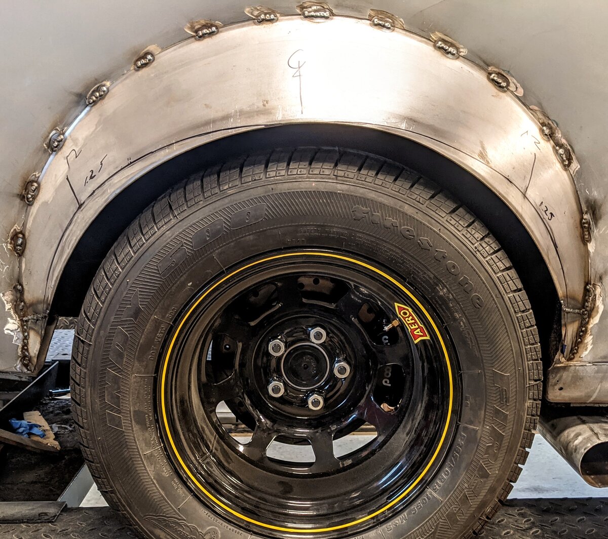

04/20/1022 UPDATE:
Well I found a tranny leak at tail shaft to drove shaft yoke. No big deal. Bought a $15 seal and will install it this weekend.

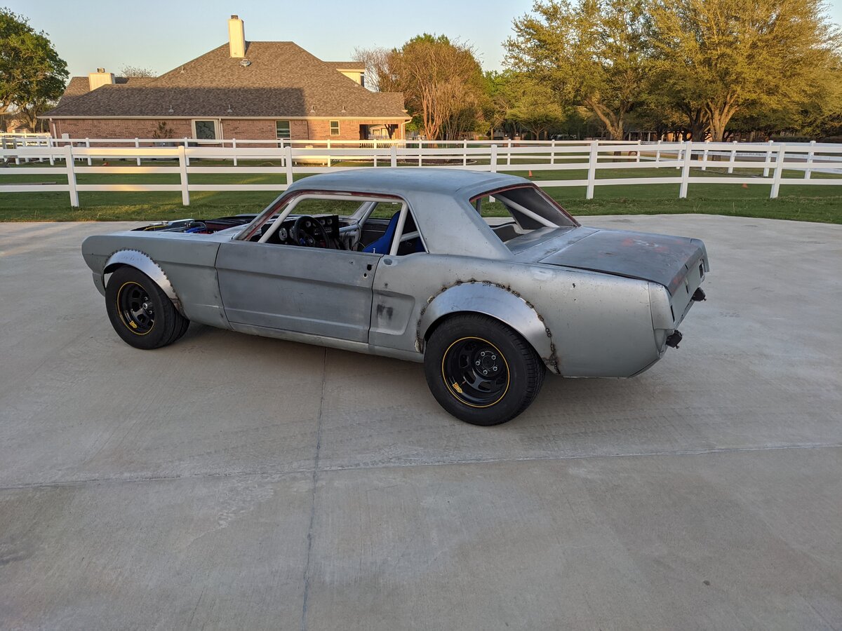

Went ahead and trimmed the rear flares to clear the rear tires. Added 1-1/4 inches more in the area that rubbed and mirrored it on the front side of the flare.
Still have to add the turn down on the lip as it was before I trimmed them. The rear kinda matches the front squared off look I guess.
