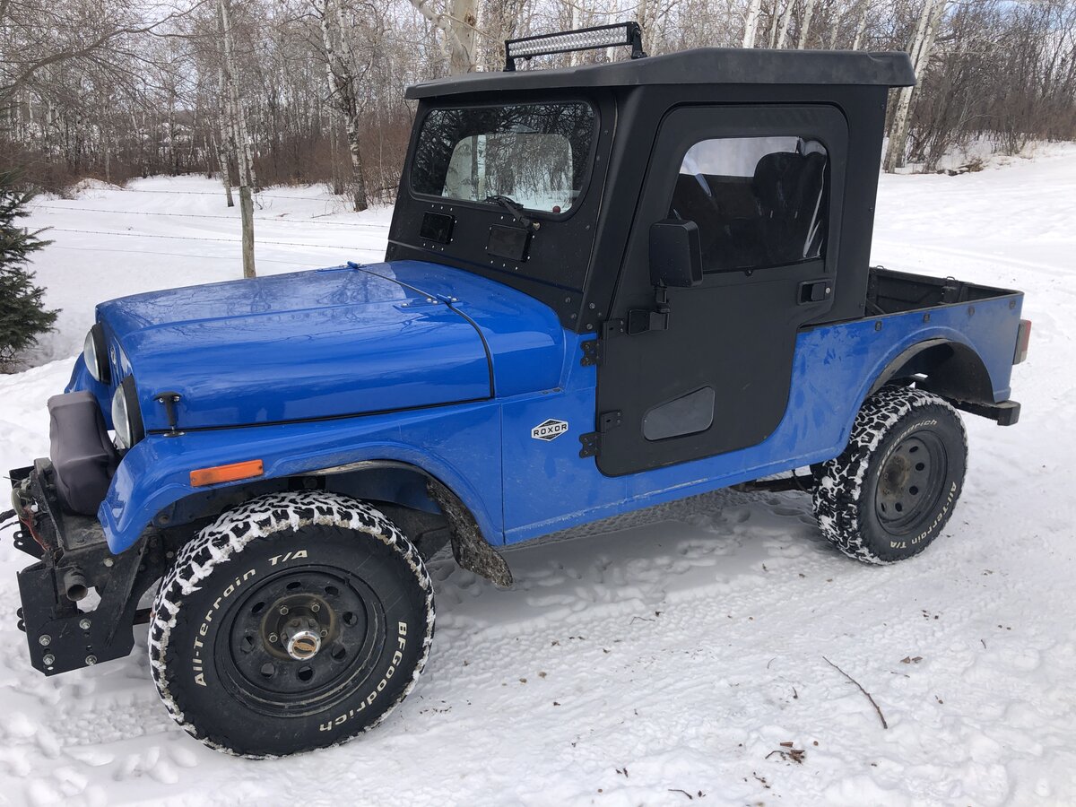

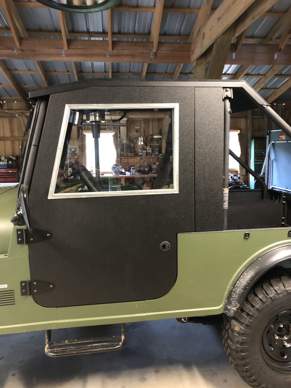

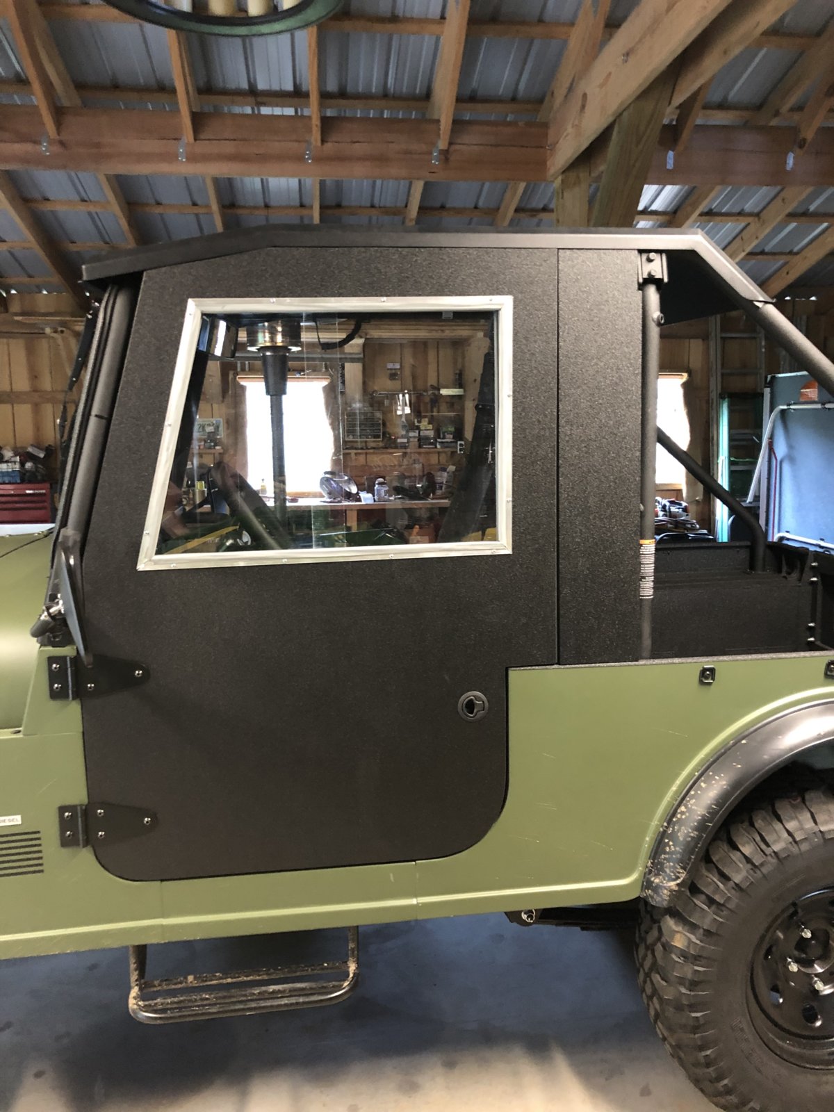

Those of us where snow happens would appreciate the window. Obviously I don’t know what’s involved in your manufacturing this, but making the door “full size” with a window cutout may work well for us in winter. Looking forward to what you come up with.

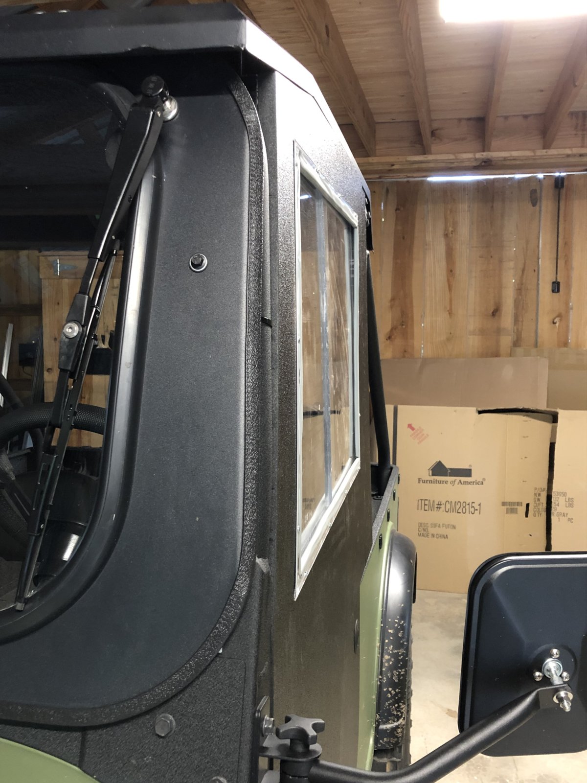

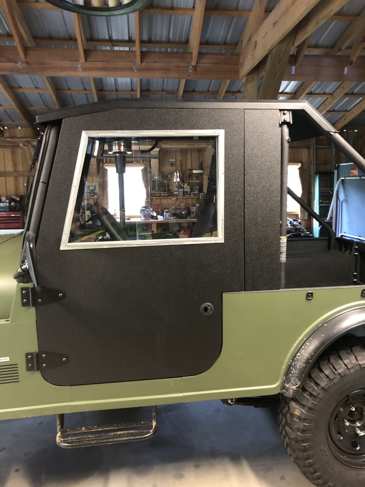

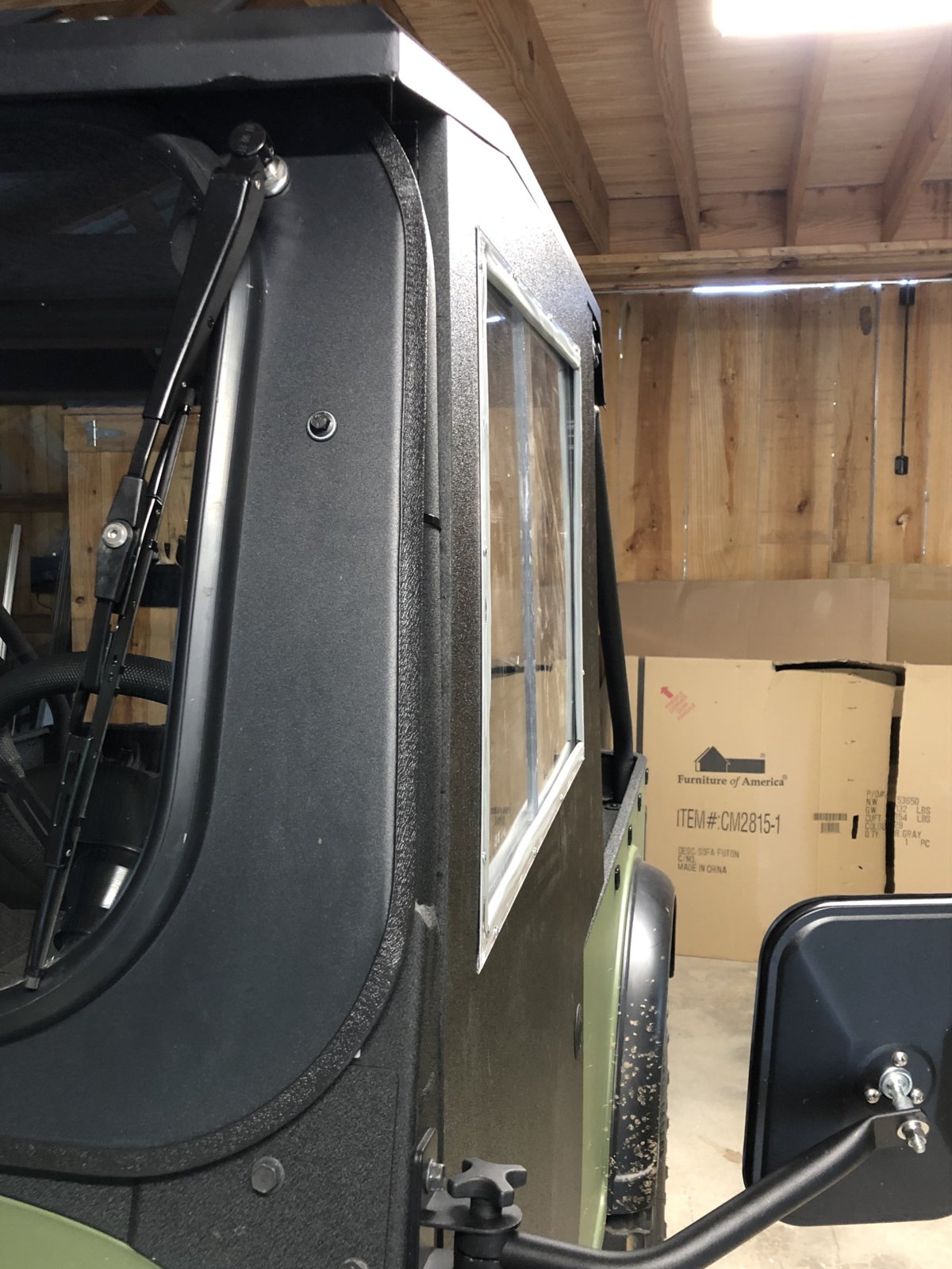

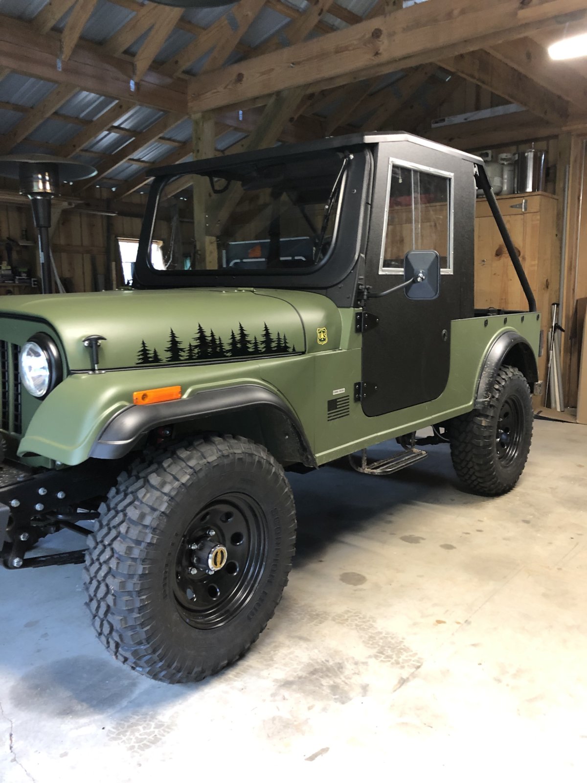

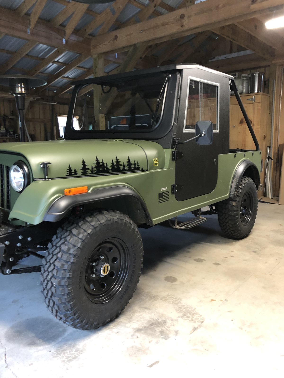

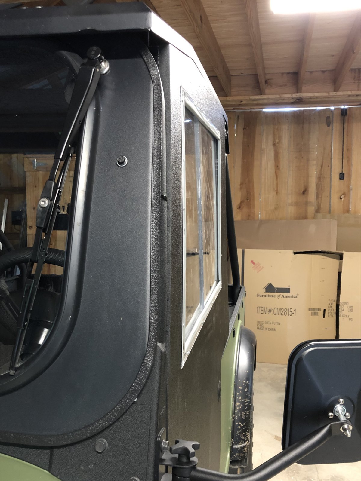

I have full doors with windows on mine that are made o a similar material. They work great at keeping the cold/wet out and the heat in. I’ll attach a photo with the “Alucobond” skin attached. (Adds stiffnes)
1,297

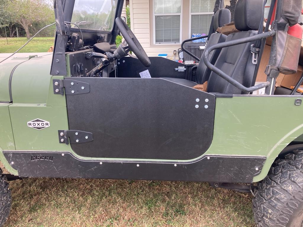

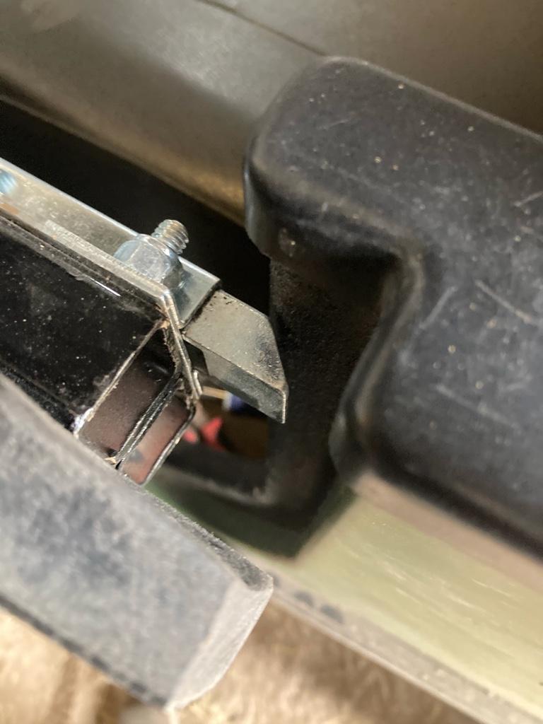

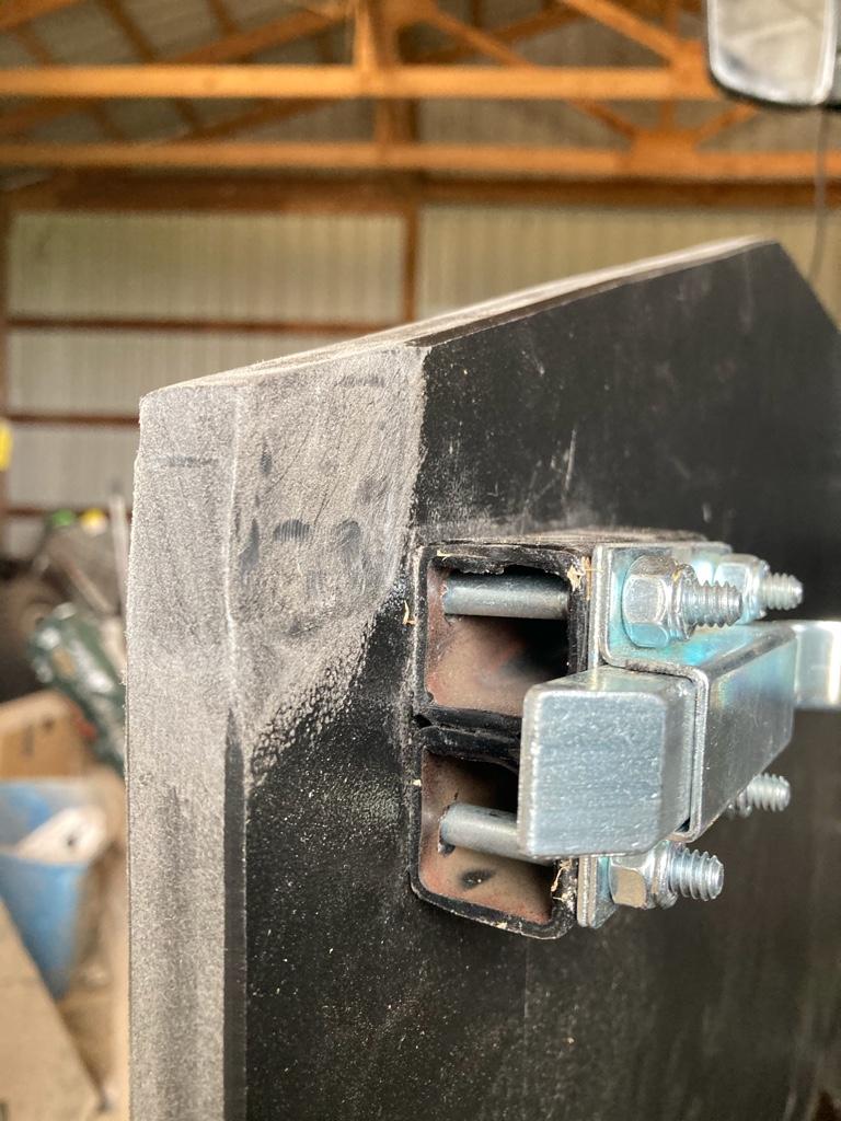

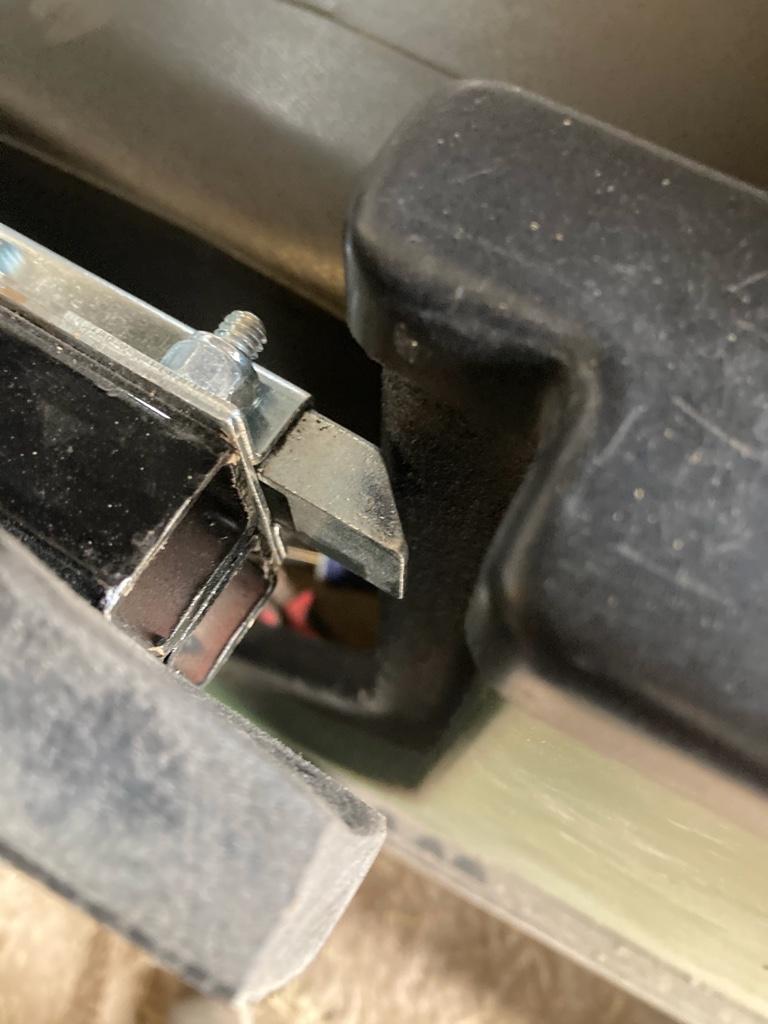

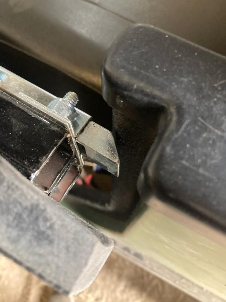

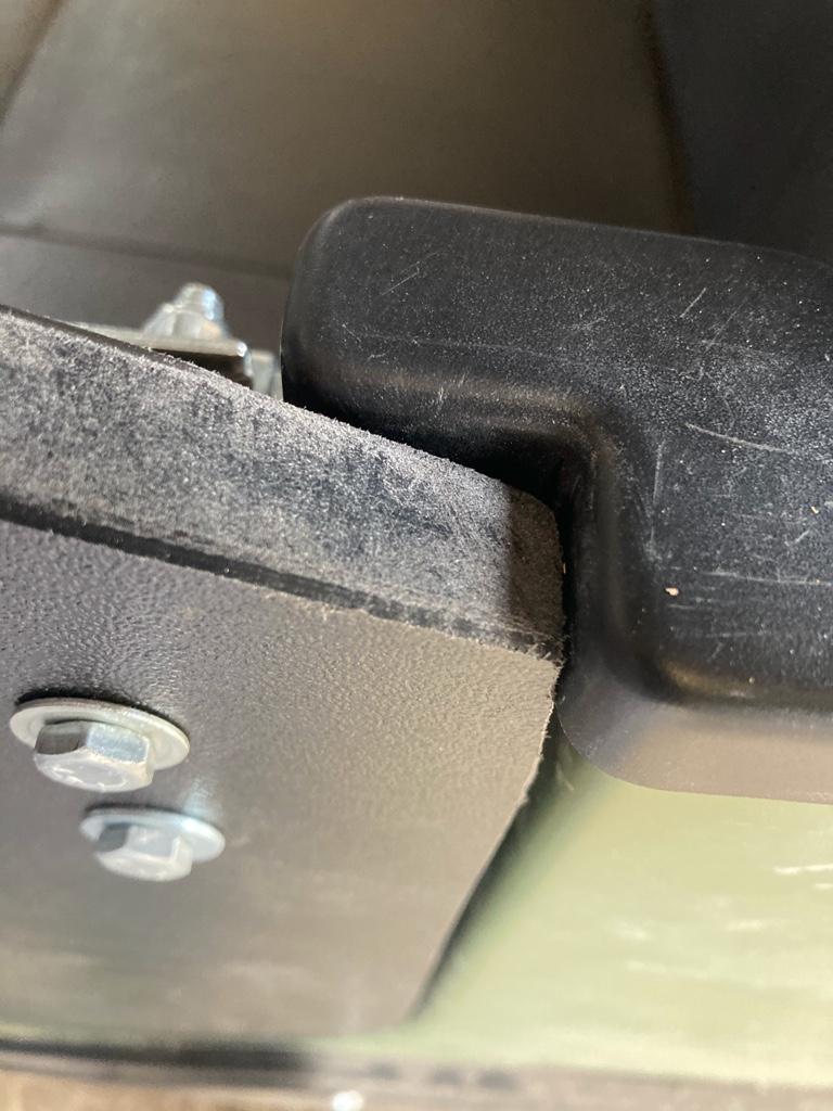

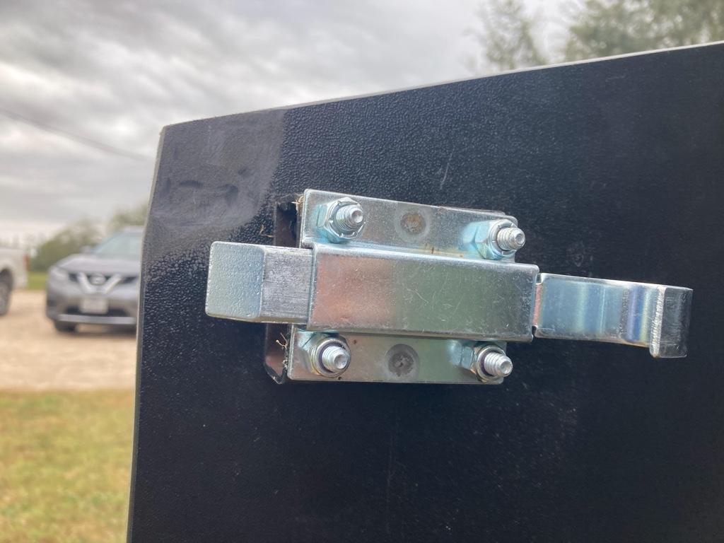

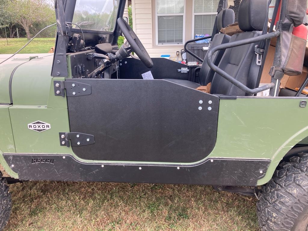

I picked up just the door blanks from Jeepish. I was gonna build my own but ran in to trouble trying to make a frame to rivet some aluminum skin to. I couldn’t get the 3/4” tubing I had to bend properly so I ditched that idea and went with his door blanks. I’m glad I did. I don’t think I could duplicate the quality of his and the way they fit the door openings. I still need to finish them by installing some door straps so they don’t swing open and hit the Roxor. I plan to bolt the strap to the lower door hinge bolts and the other end to the Roxor where the hinges bolt to the factory nuts. A longer bolt and they’ll be enough room to bolt the strap there. I might even make a post that they slip on like the jeeps have that way removal is even easier.
I used some smittybilt hinges and wallowed out the top hole of the Roxor side hinge so they would line up with the factory nuts. Doesn’t take much and works great. A stone on a dremel is all it takes. You’ll need 2 sets of the lower hinges
Part #’s 7641 and 7607.

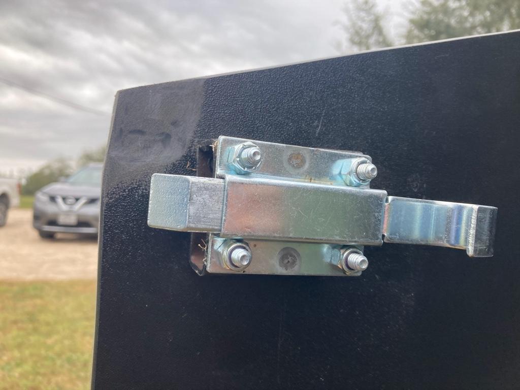

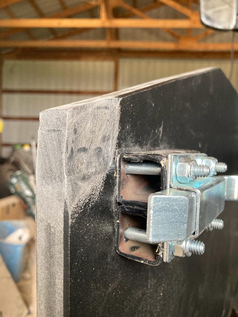

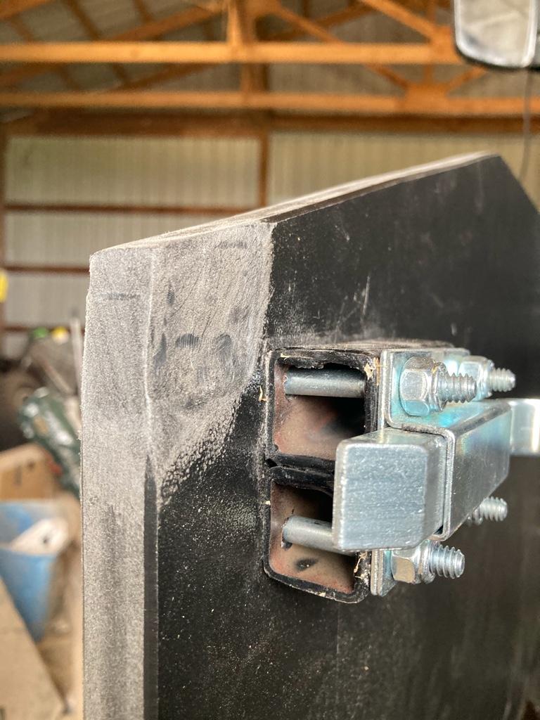

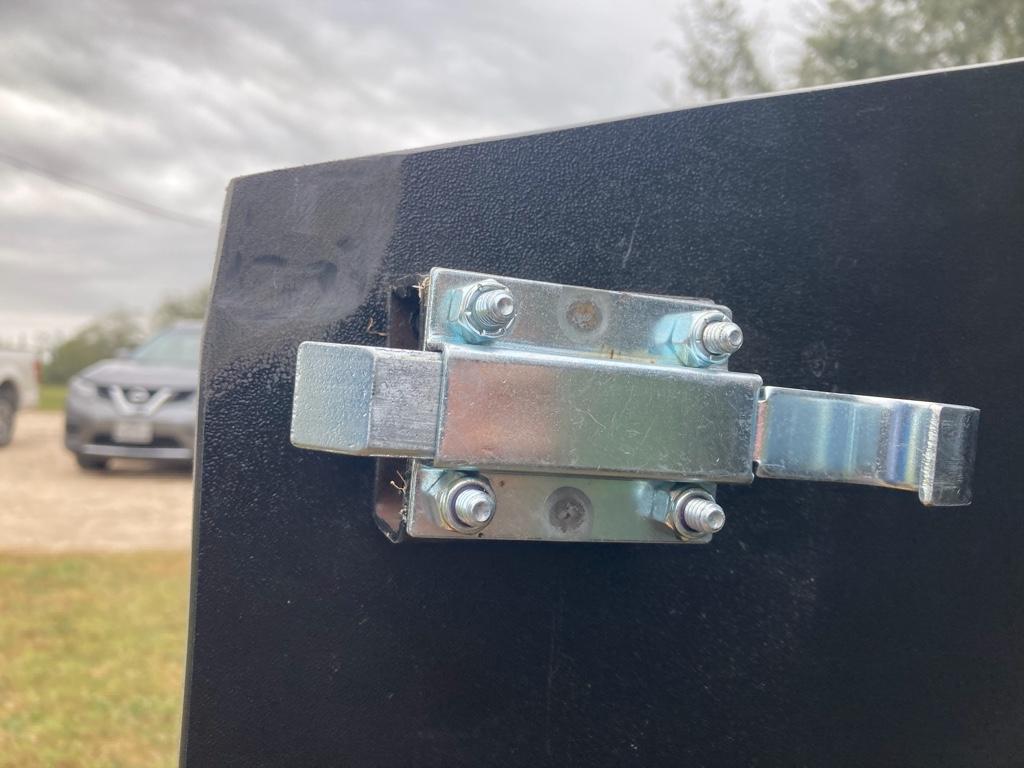

I used some 1” tubing that I was gonna build a frame out of to shim the latches. The latches latch right on the tub just like the Roxor doors and other aftermarket options. This way when the door is removed there is no striker plate that can snag clothing getting in/out. Latch is a Buyers Products Company part no. 90M.

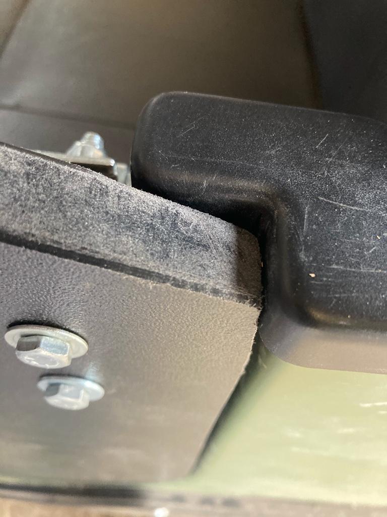

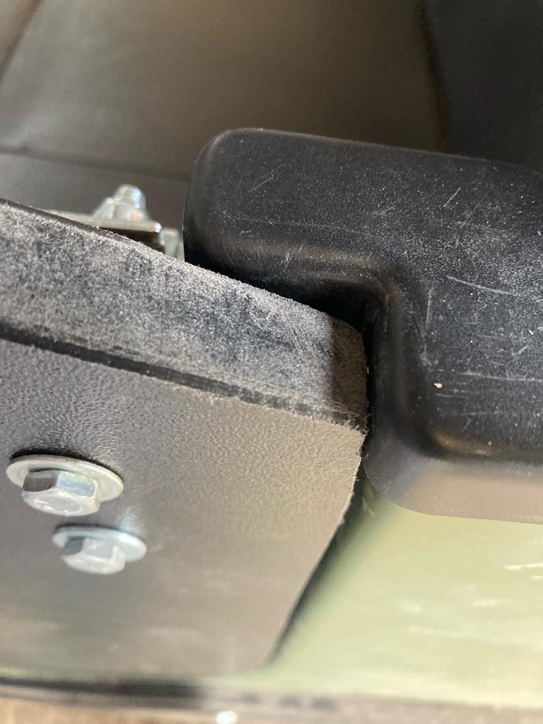

As you can see I had to trim the door a little. Evidently Indian quality control tolerances aren’t up to American standards. Both doors fit tight on the drivers side where that factory rubber cap sits. Passenger side was a perfect fit. The easy solution was to trim the door to fit. A little flapper wheel on a dremel followed by the dremel flat sander worked great.
The doors fit tight and shut well and no rattles. Well worth the time and money. Eventually I’m gonna swap all hardware out with some of those rounded head Allen wrench bolts that are painted black so they match the door. Until then I’m gonna rock these doors like they are. Hoping they’ll help hold in some heat from the heater while driving around feeding out the deer and retrieving the game I harvest.
Thanks Jeepish for offering a great product. Much appreciated.

Nice looking job. I have the On The Rox doors,I painted em body color. They do help with the heat. Now, if someone would make uppers ! I like aluminum and stainless, rust is a big deal in upper Mi.

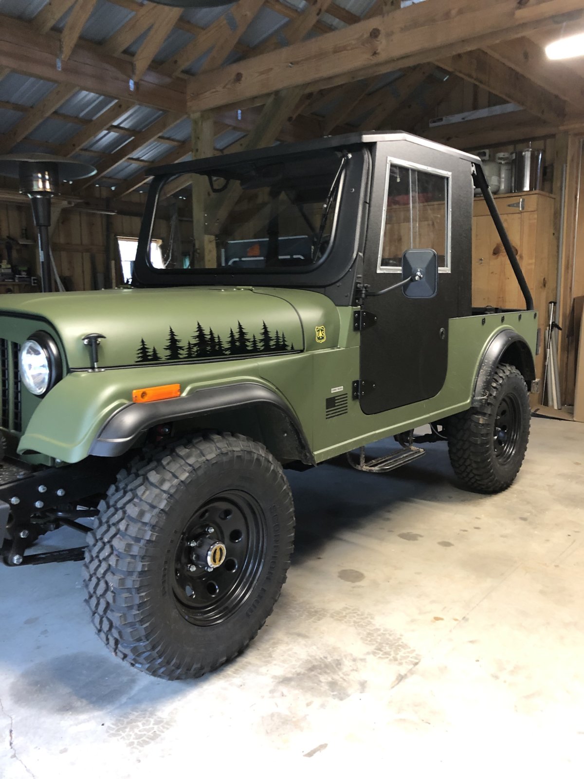

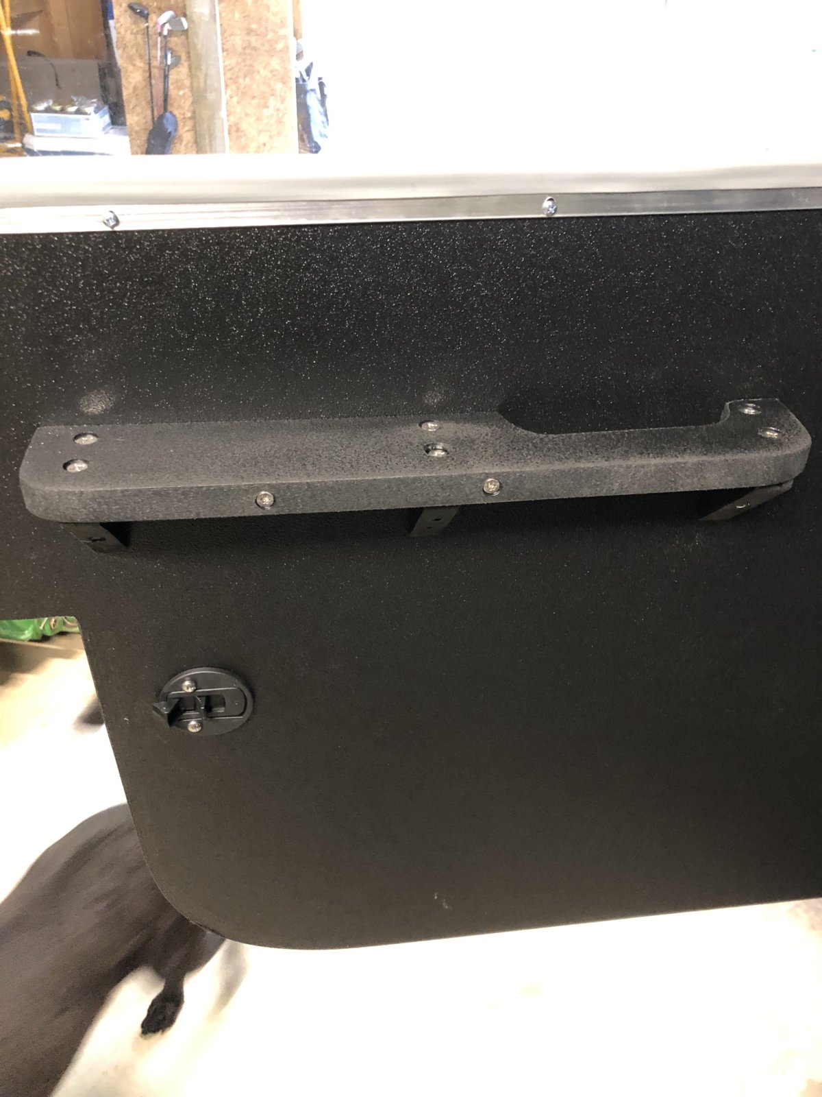

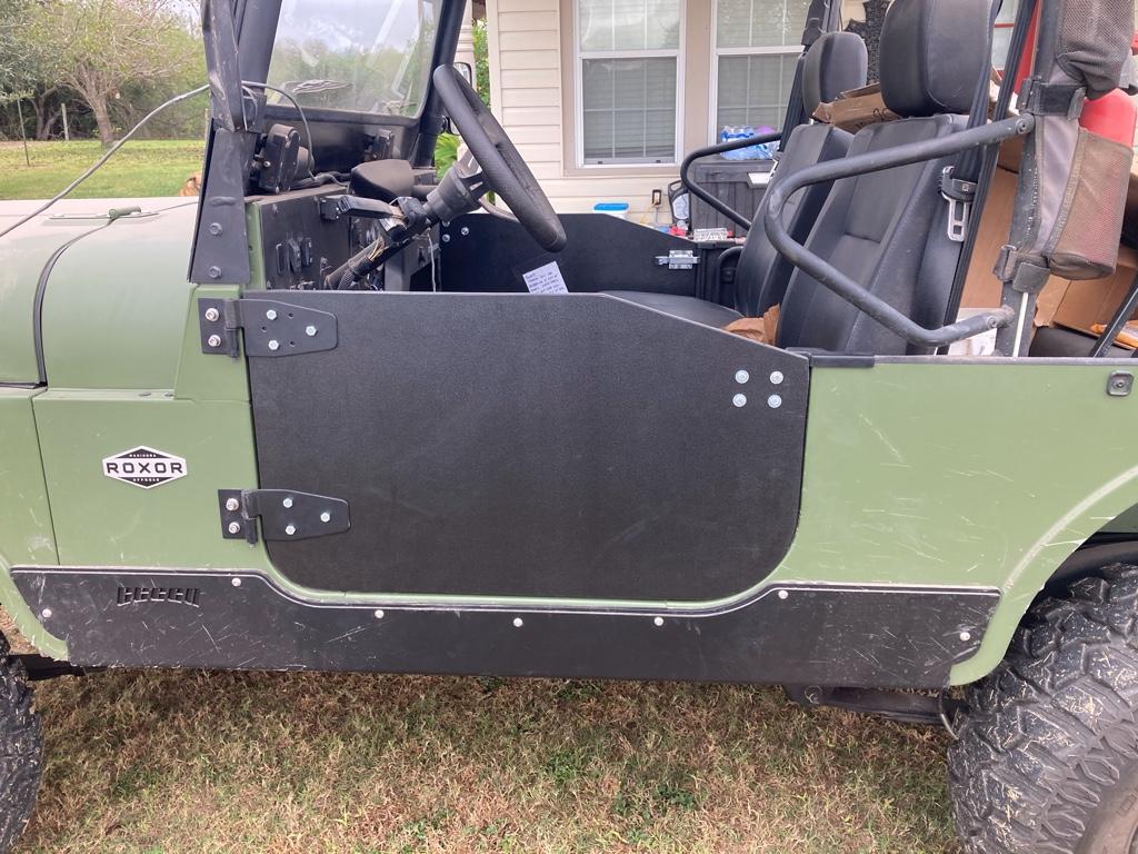

I’ve been working on this for a while but I feel like I have come up with a more affordable option to Roxor half doors. I am building these doors out of 3/4” High Density Plastic that is pebble grained. The color is throughout the product so you don’t have to worry about paint scratching. The texture looks and feels like the bed liner inside the Roxor. Hinges are painted black but are stainless. Latches are plastic slam latches and they are holding up really well on my Roxor. There is nothing on these doors to rust or corrode. Each set is custom made in my shop and will come to you ready to install with all attachment hardware and weatherstripping included. Takes less than 10 minutes to install.
Ready to install Doors- $499 + shipping
Door blanks (no hardware)- $399 + shipping
If you’d like me to get started on a set for you, send me a private message. Thanks for your interest and feedback. View attachment 3568View attachment 3569View attachment 3570

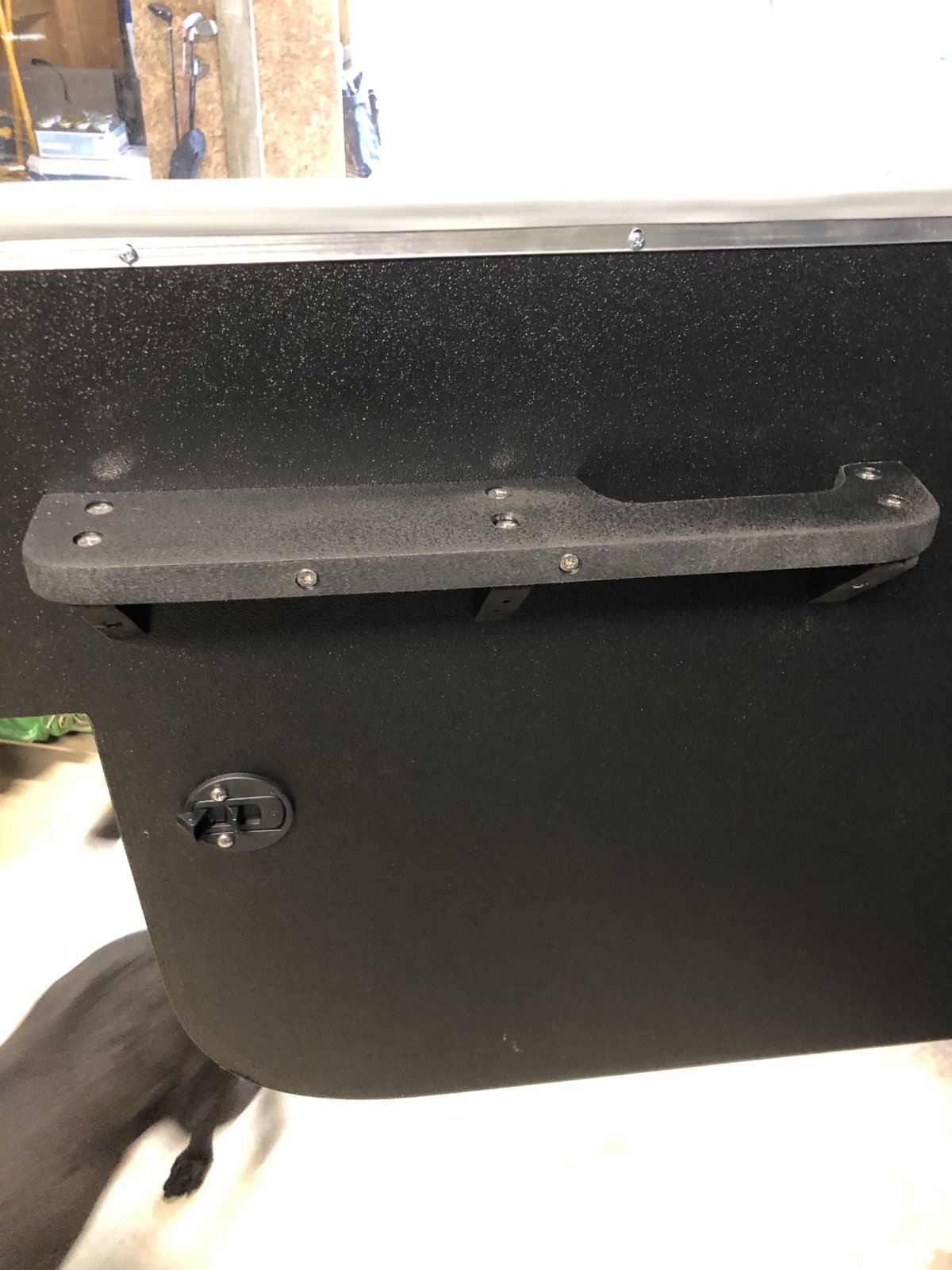

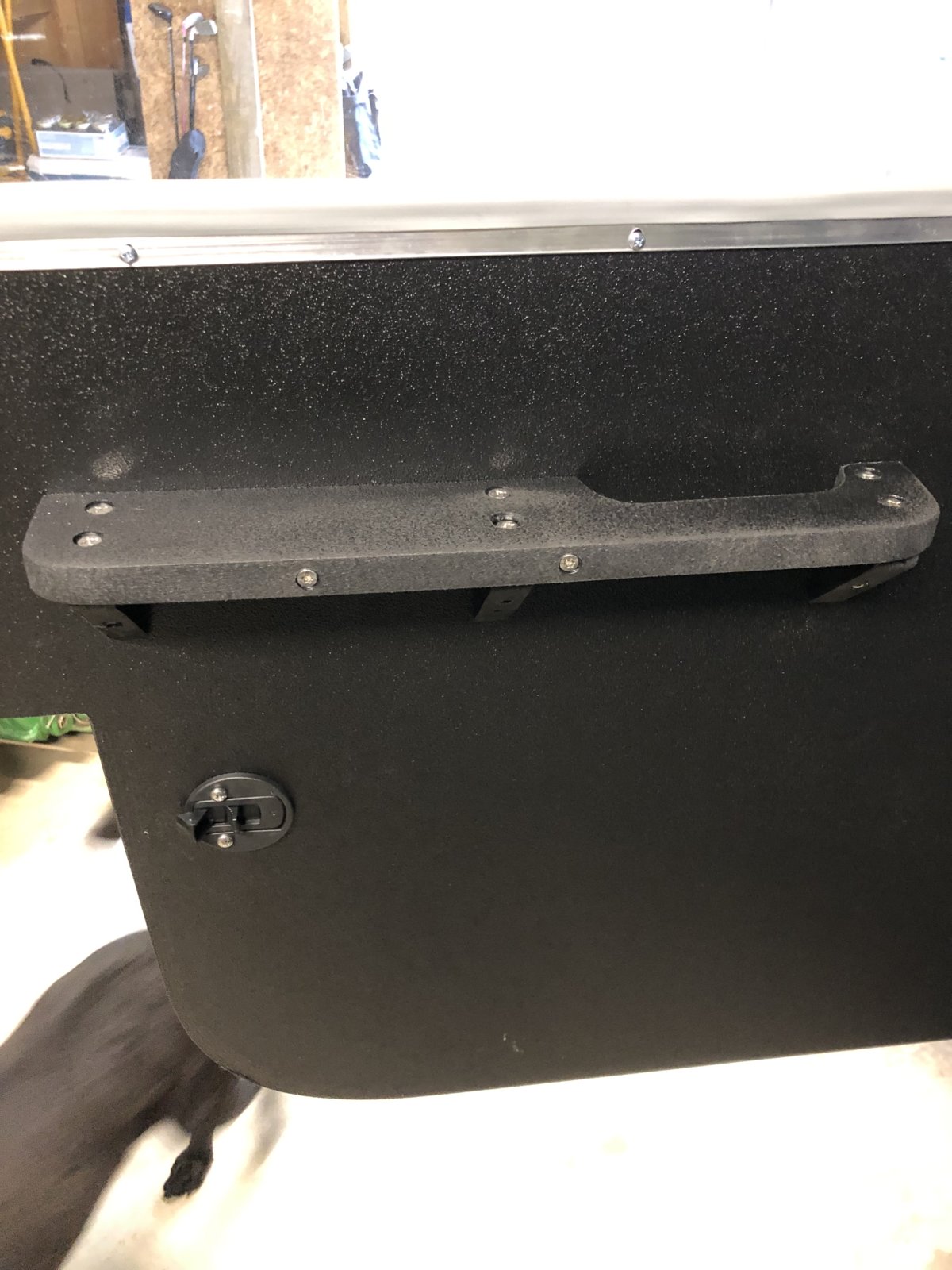

I think I’m going to have to weld something all the way around and attach to the inside of the door to make it a little more rigid. Piddled with it a little more this afternoon. View attachment 3823View attachment 3824View attachment 3825View attachment 3826
