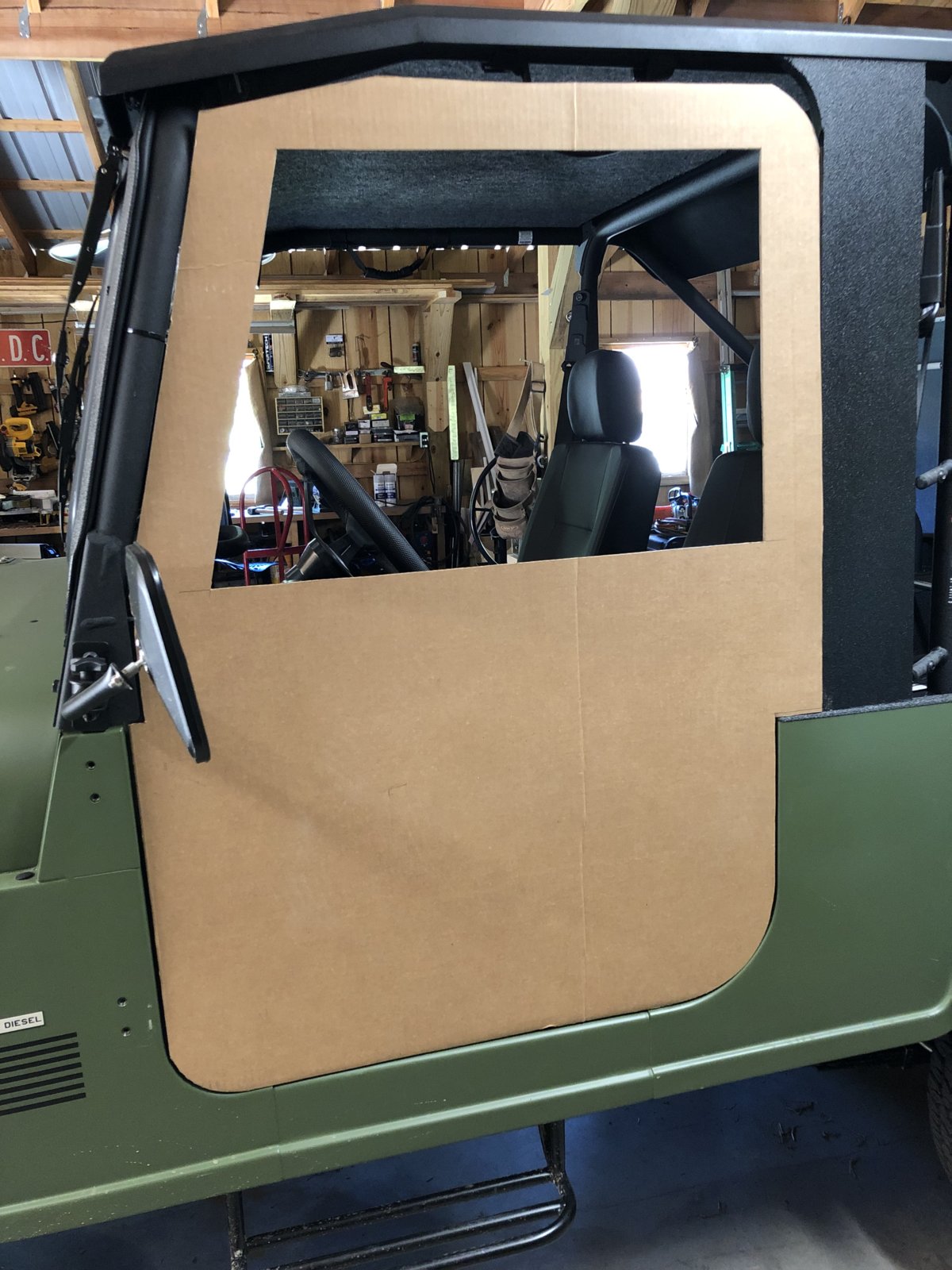

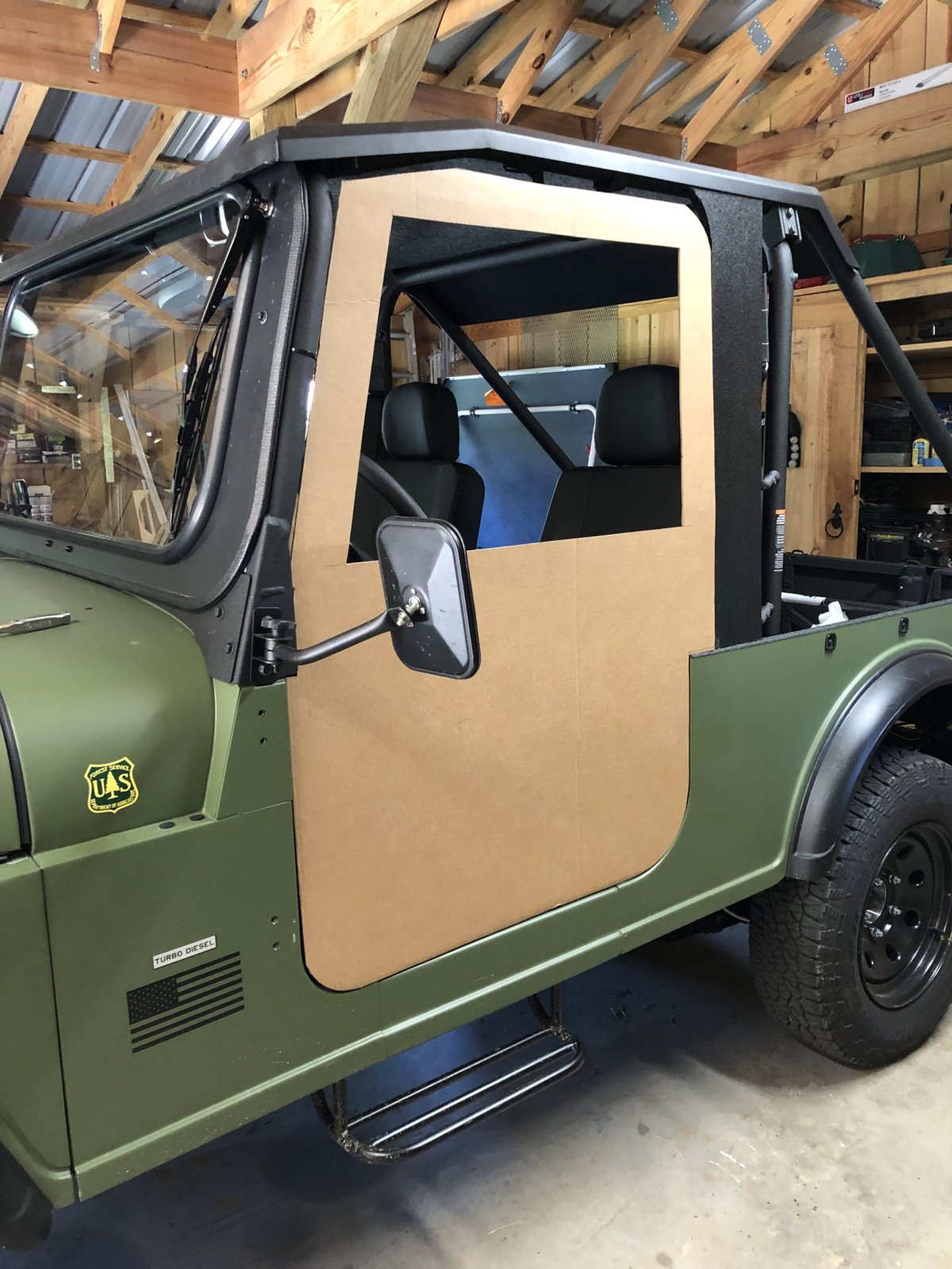

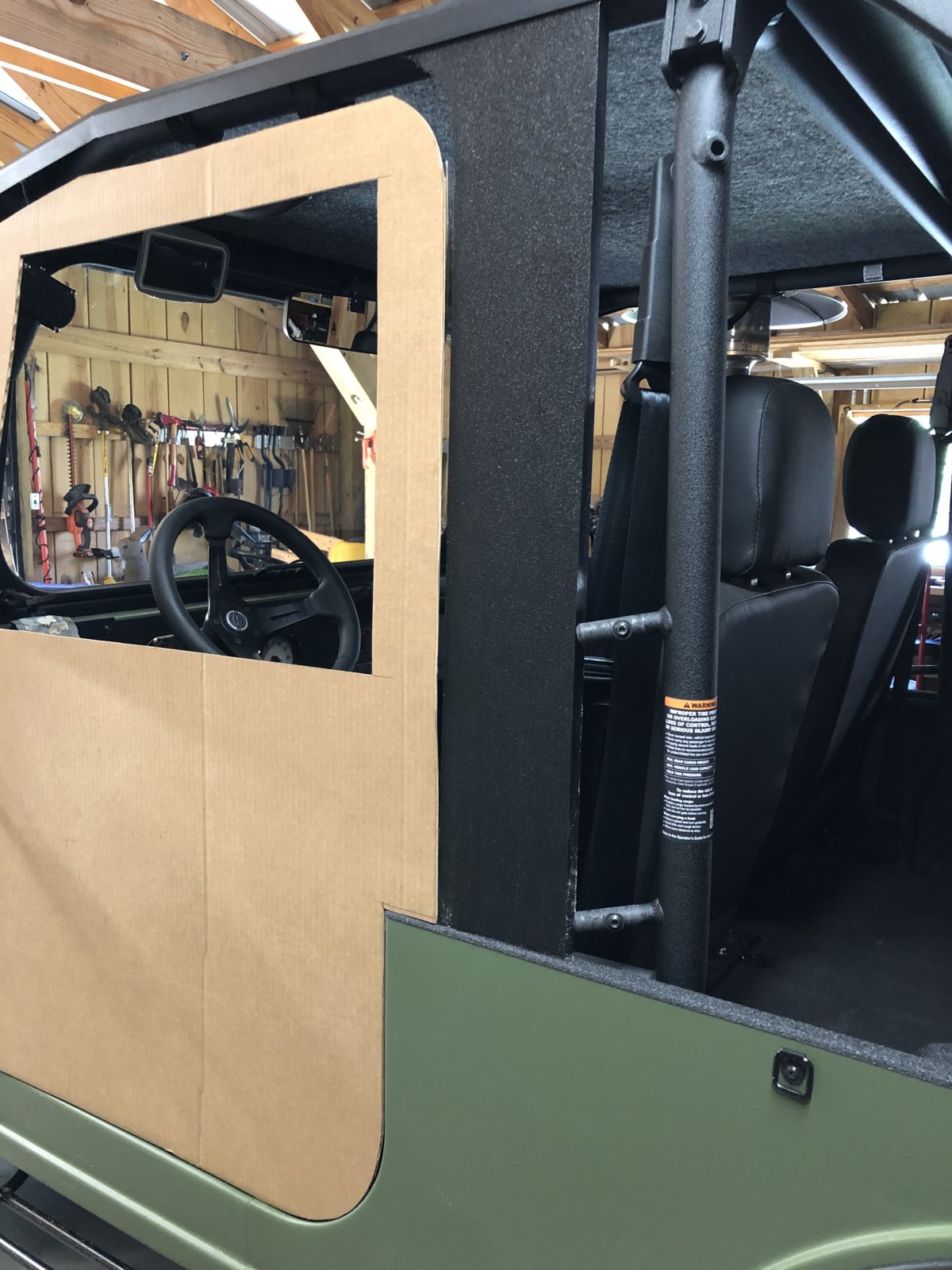

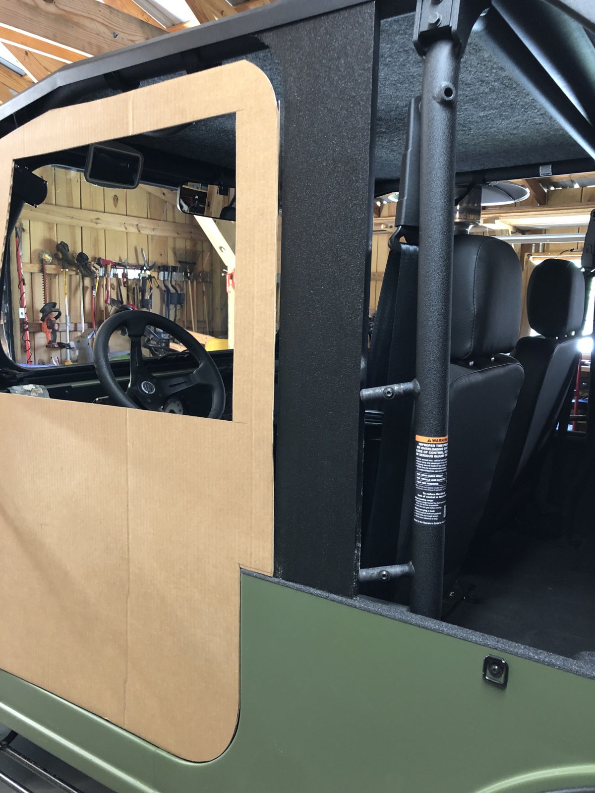

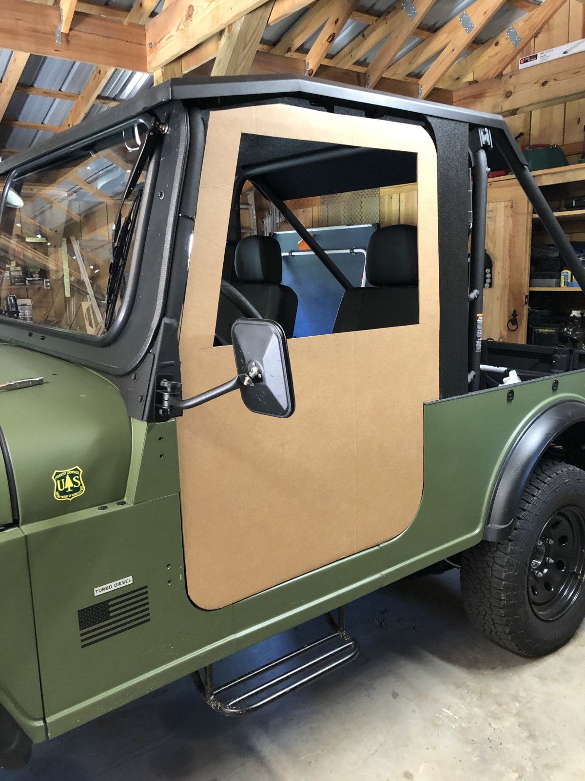

So I really feel like the half doors I’ve been making definitely serve their purpose but when i made the larger doors out of the HDPE, the door was just too flimsy. Maybe if the window was fixed it wouldn’t be too bad.
Also, the other problem I was running into is that the body of the Roxor along the bottom of the door is not exactly plumb with the roof (mine has a fortress top) and if you really look at the tops out there, most of them turn in at the front roll bar. When I put my flat, full door on the machine there was a gap in the corner.
I figured out that I could bend a piece of square tubing to compensate and screw it to the inside of the door and it did draw the door in under the top like it should be. So currently my full doors (the only set I built) have 1 piece of bent square tubing screwed to the door adjacent to the windshield. After driving around on the road and off, I realized that the doors are still too flimsy and would sometimes come open on me.
That is where I am currently. I’m either going to weld a complete tubing frame to be screwed to the inside of the door or do exactly like you said and make a frame to be attached to the half doors and get my local upholsterer to make some uppers with fixed or zippered windows.
For the mirrors, the half doors travel under them with no problem. For the full doors, you could either mount mirrors onto the doors or just make a simple stop with a short piece of paracord and some fender washers.
Thank you for the compliments on my Roxor. I’ve had just about as much fun tinkering with it as I have driving it.
