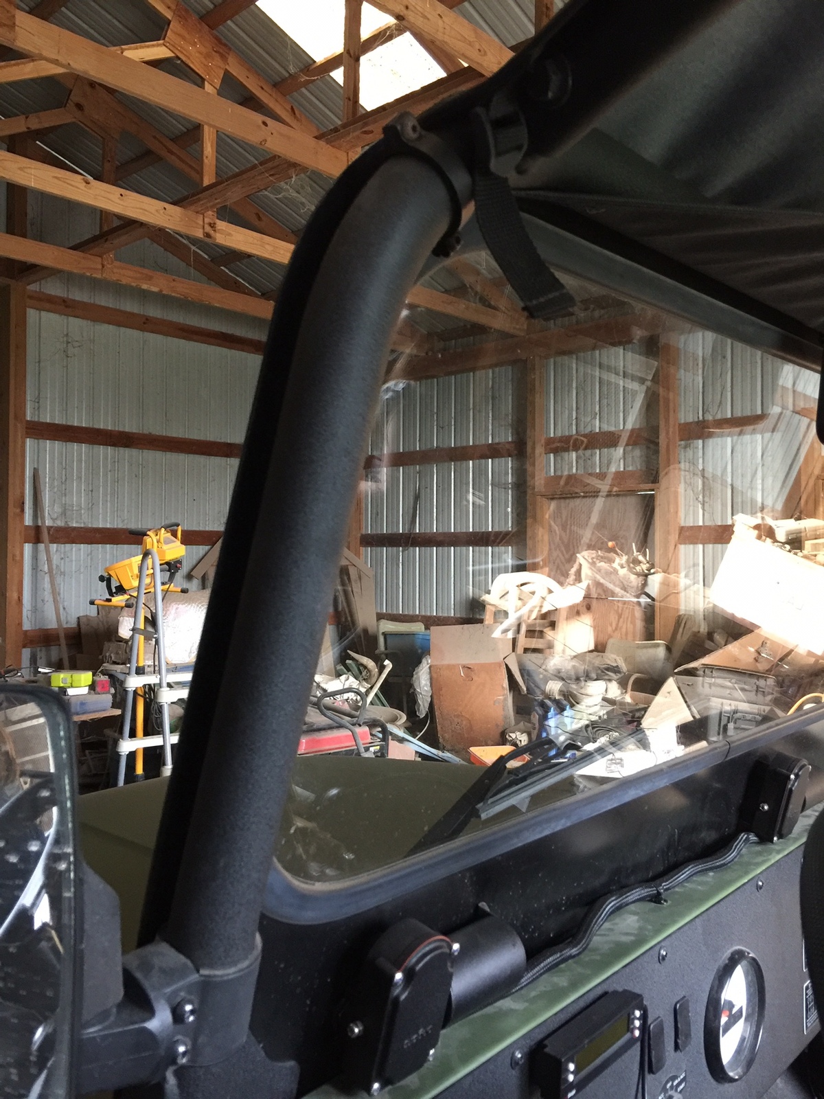

I actually can't right now- but here is the OTR PDF on the windshield- page 7
Windshield+Frame+With+Wipers+Instruction+Manual.pdf

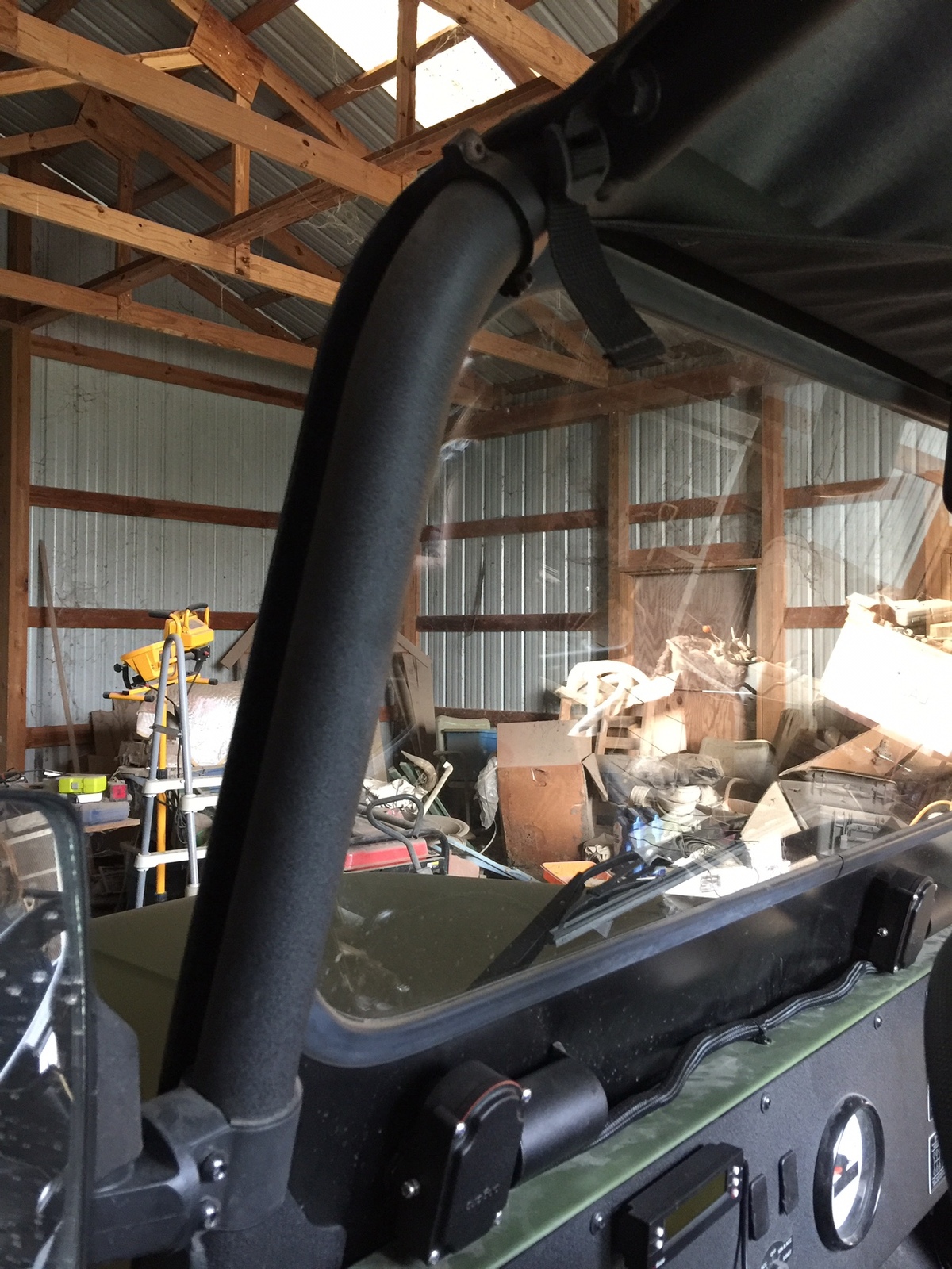

However, I don't see a reason why you can't bolt the window frame with a rubber washer to the roll bar and eliminate the tube clamps. I just checked and the holes in the frame line up in the roll bars.
1,303

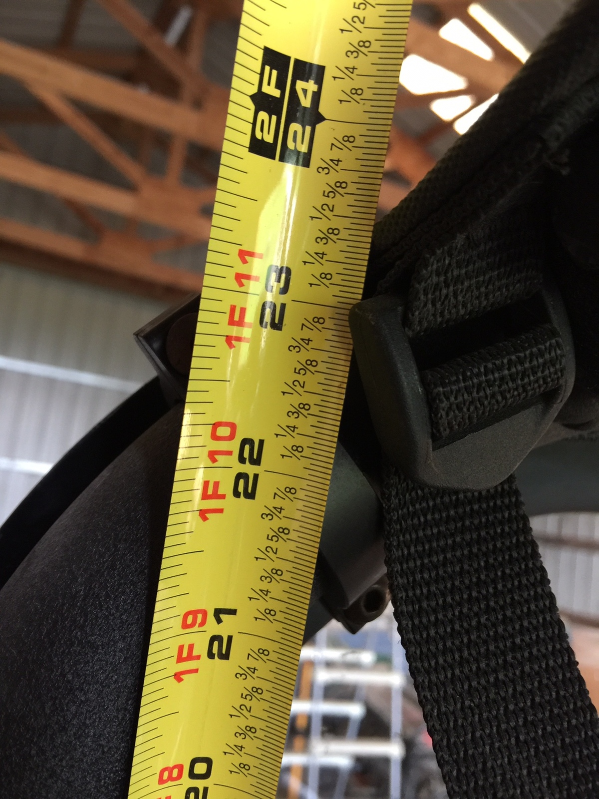

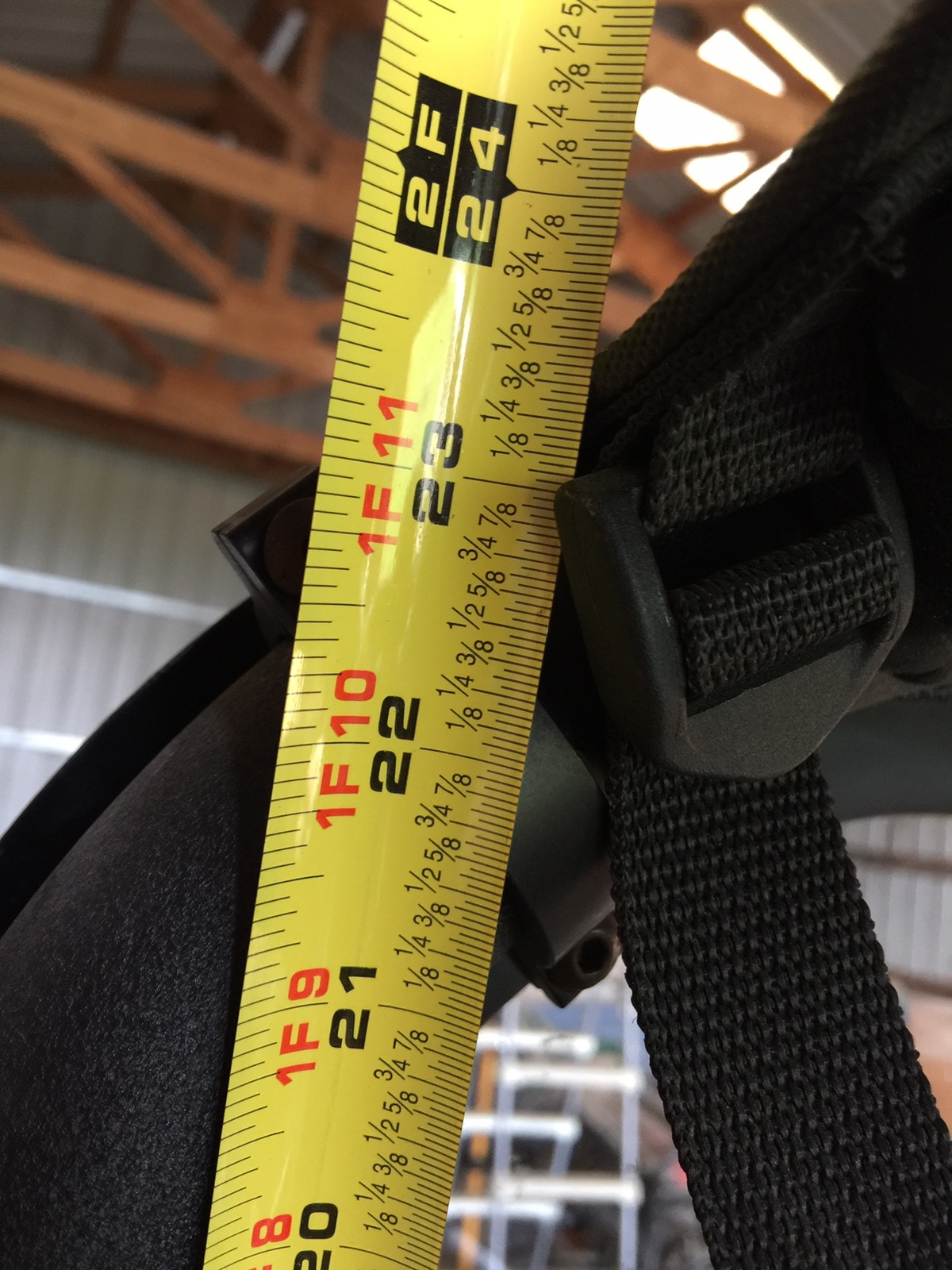

If you get a chance, can you take a picture of the clamps and where they are. Will help in the next phase of “design”.
Tape was flat on the dash going up to clamp.

View attachment 3608View attachment 3609

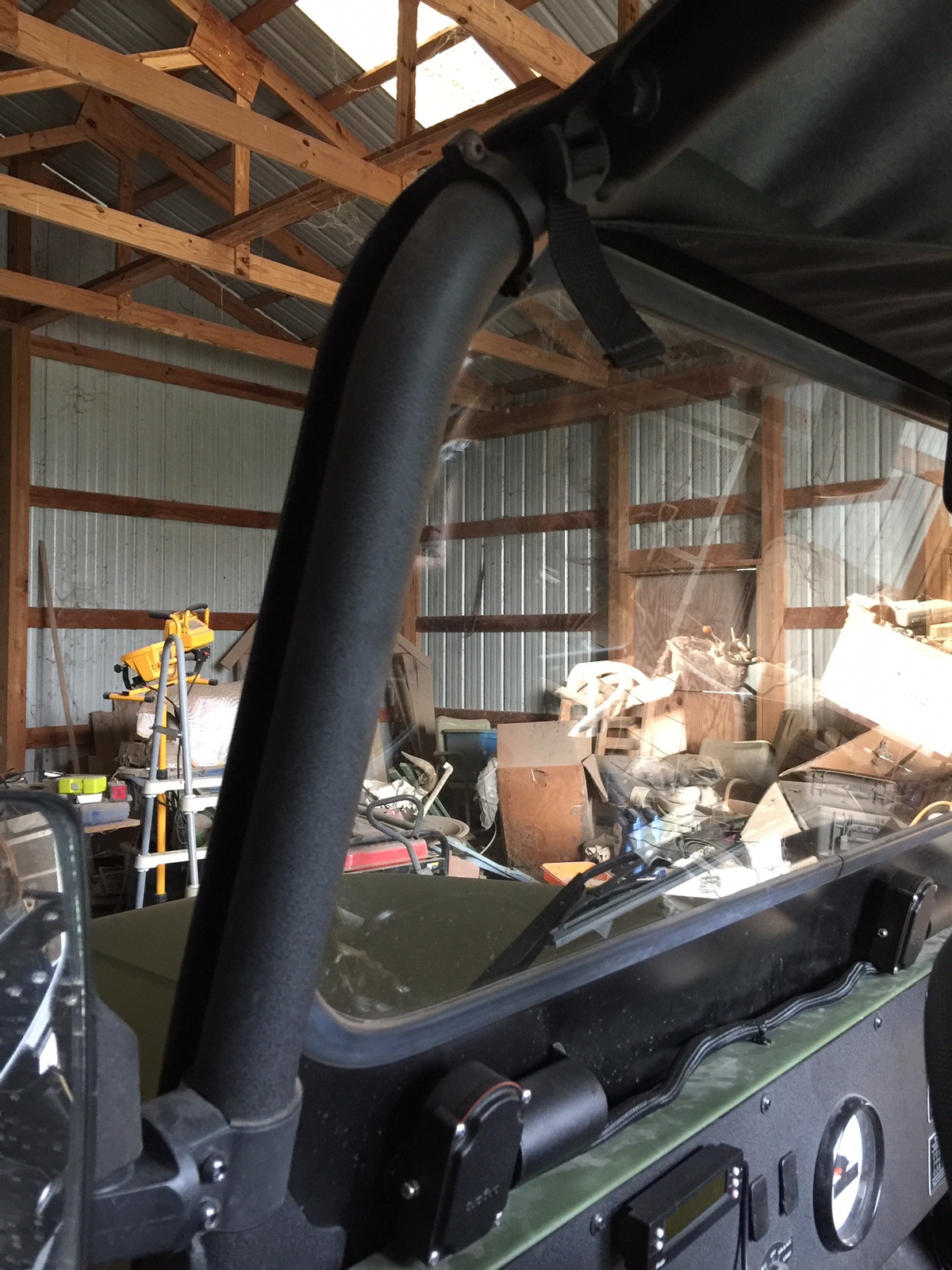

I think I can work around that. The only thing is that the way the roll bar attaches to the one around the window frame, it’s going to leave a gap in the corner at top left (on driver side) between the door and the soft top. Fortress made their tops to extend over this area which will help keep the rain and wind out.

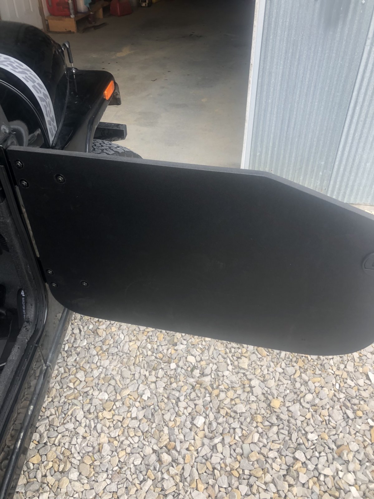

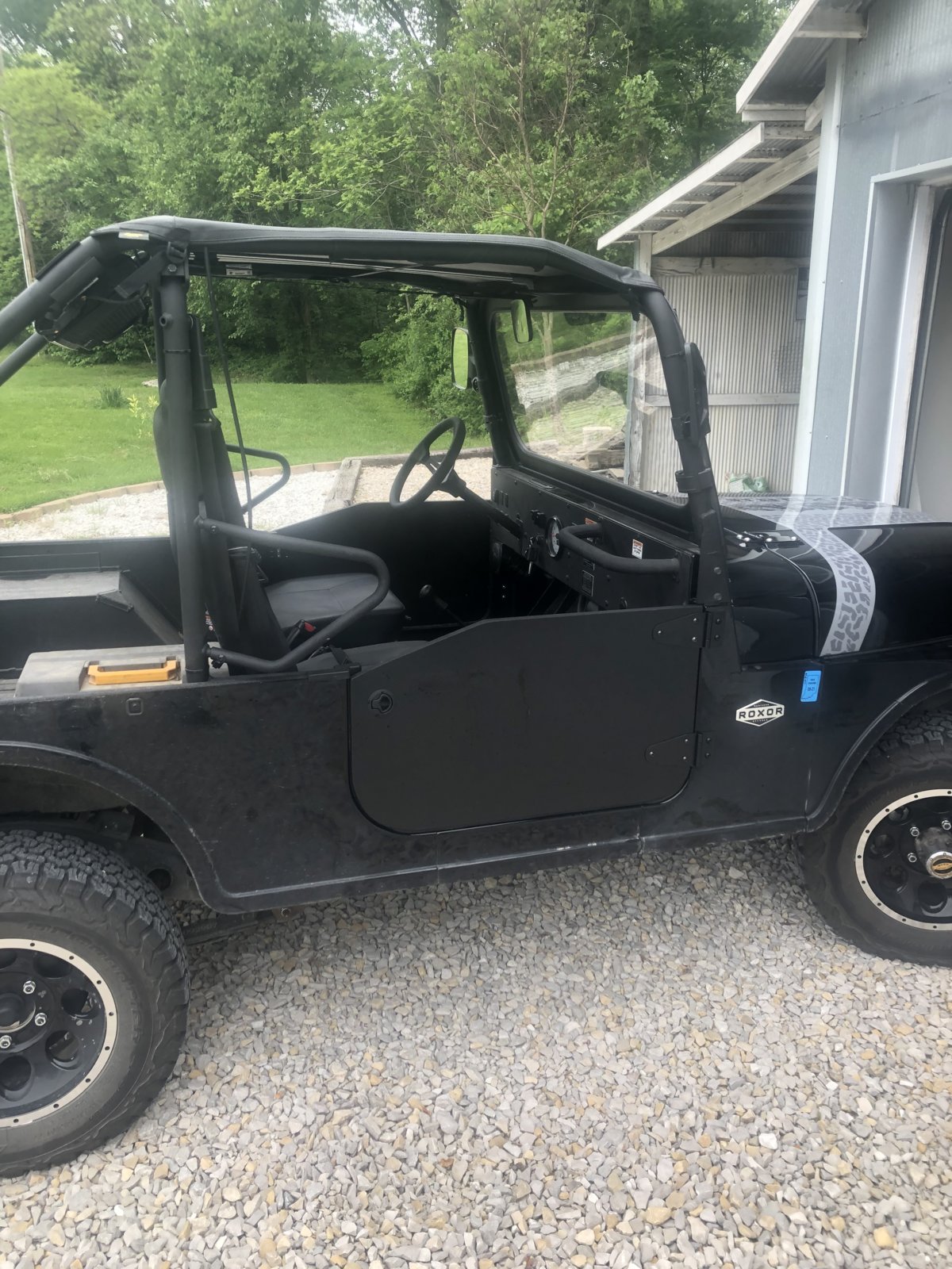

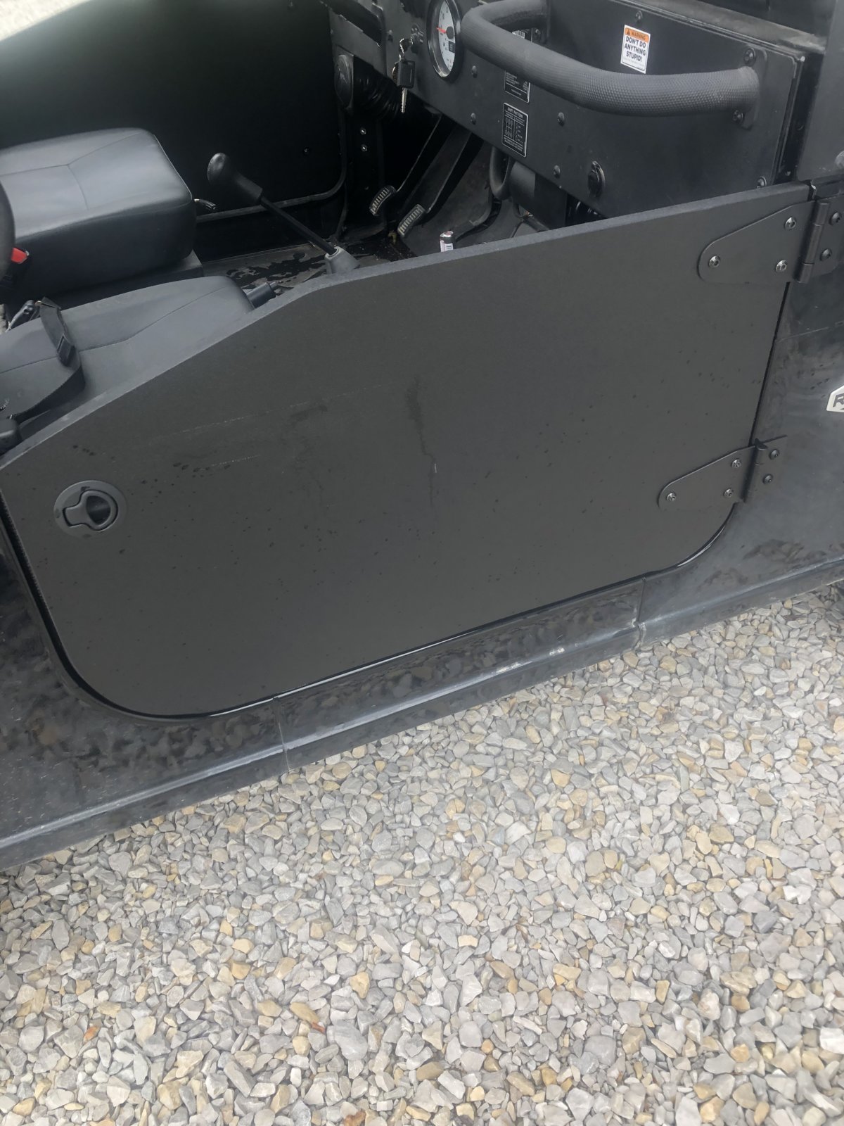

I purchased a set of Jeepish’s half doors, and I’m very impressed. My roxor is dirty and they have some water on them in the picture, but they are very well made, look great, and are much cheaper than the Mahindra ones. I highly recommend them.

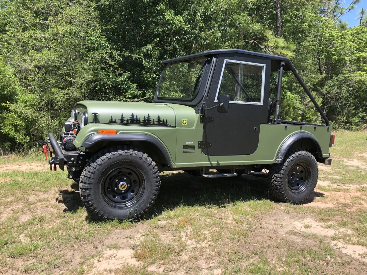

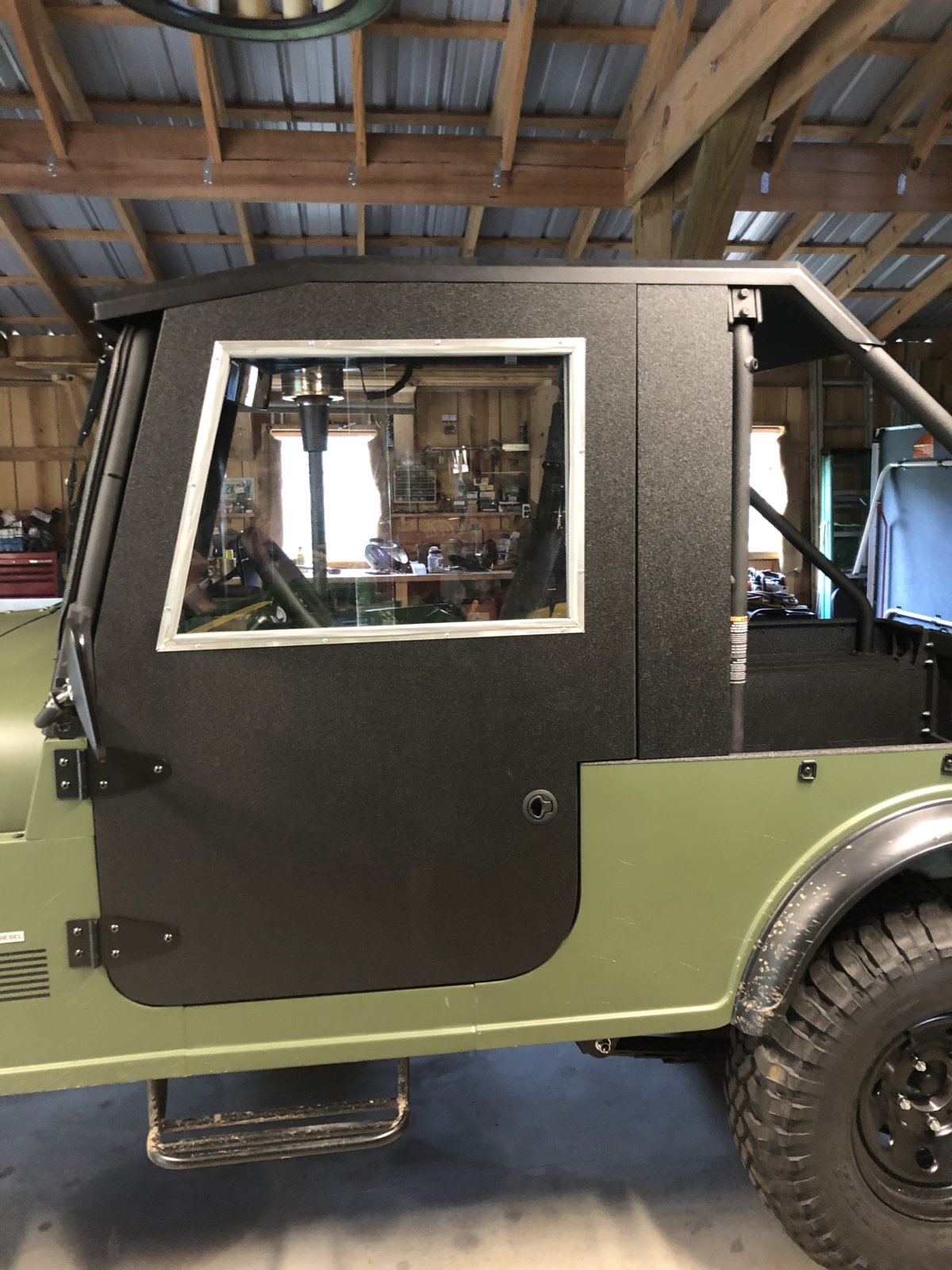

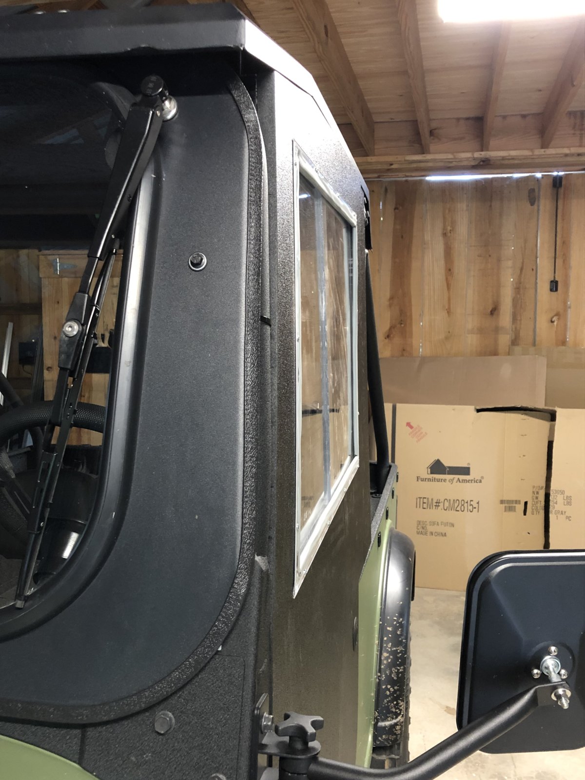

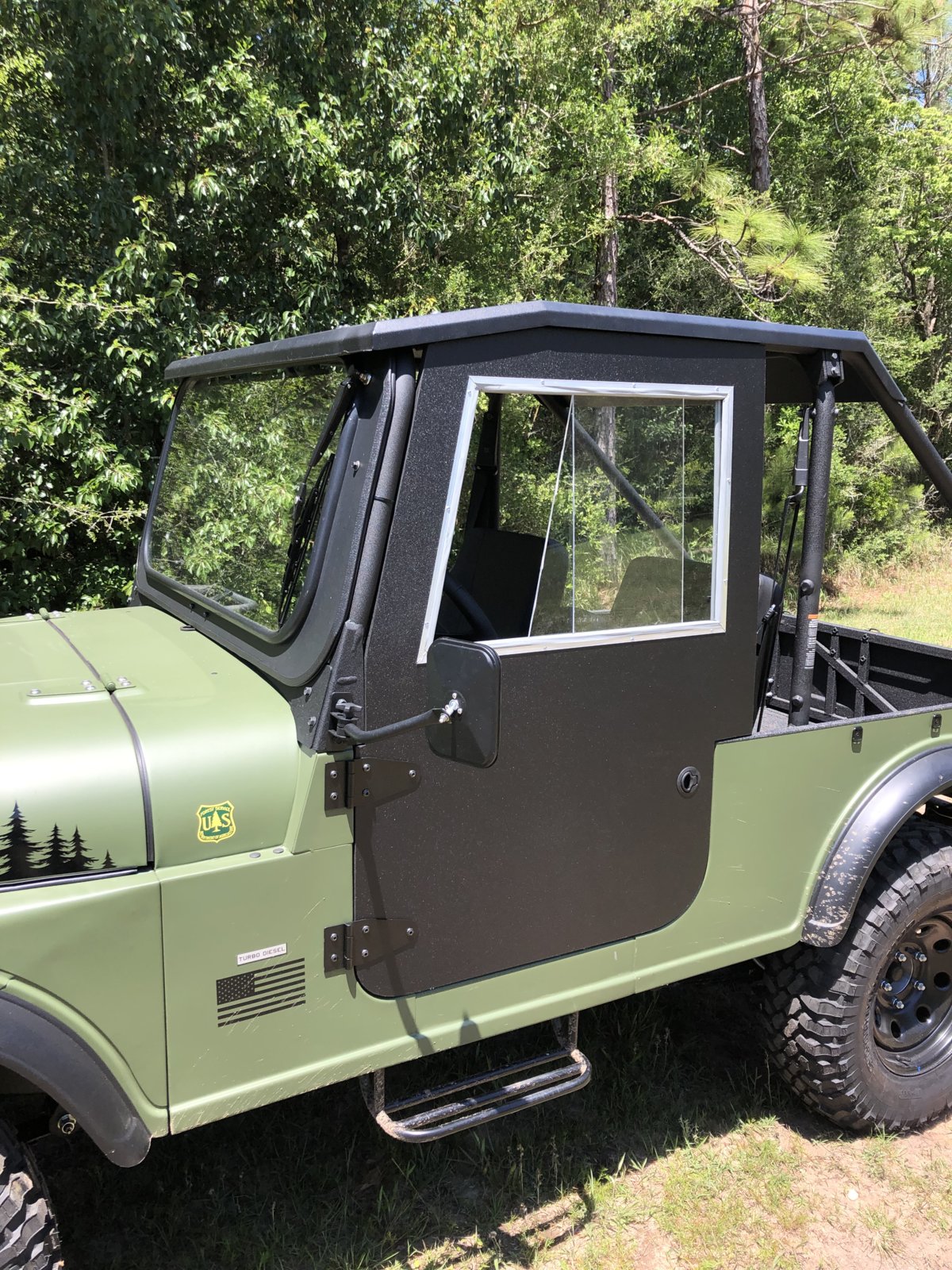

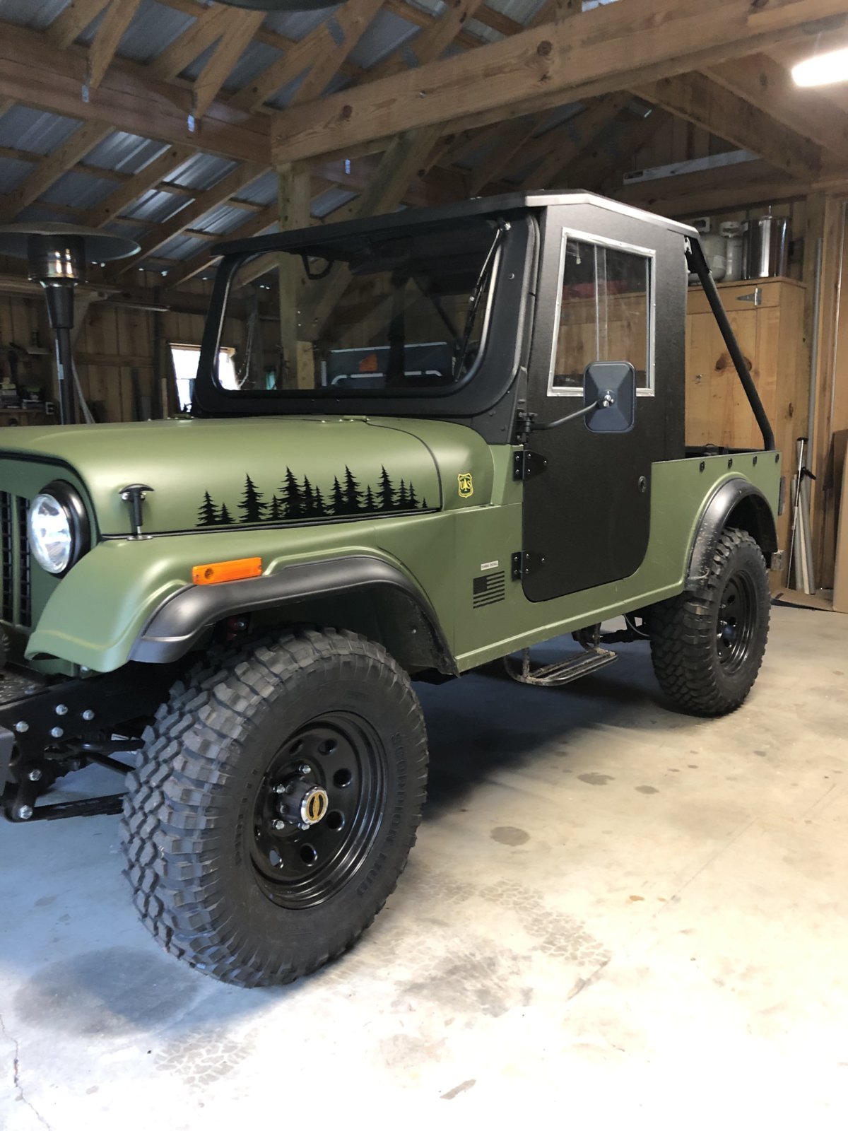

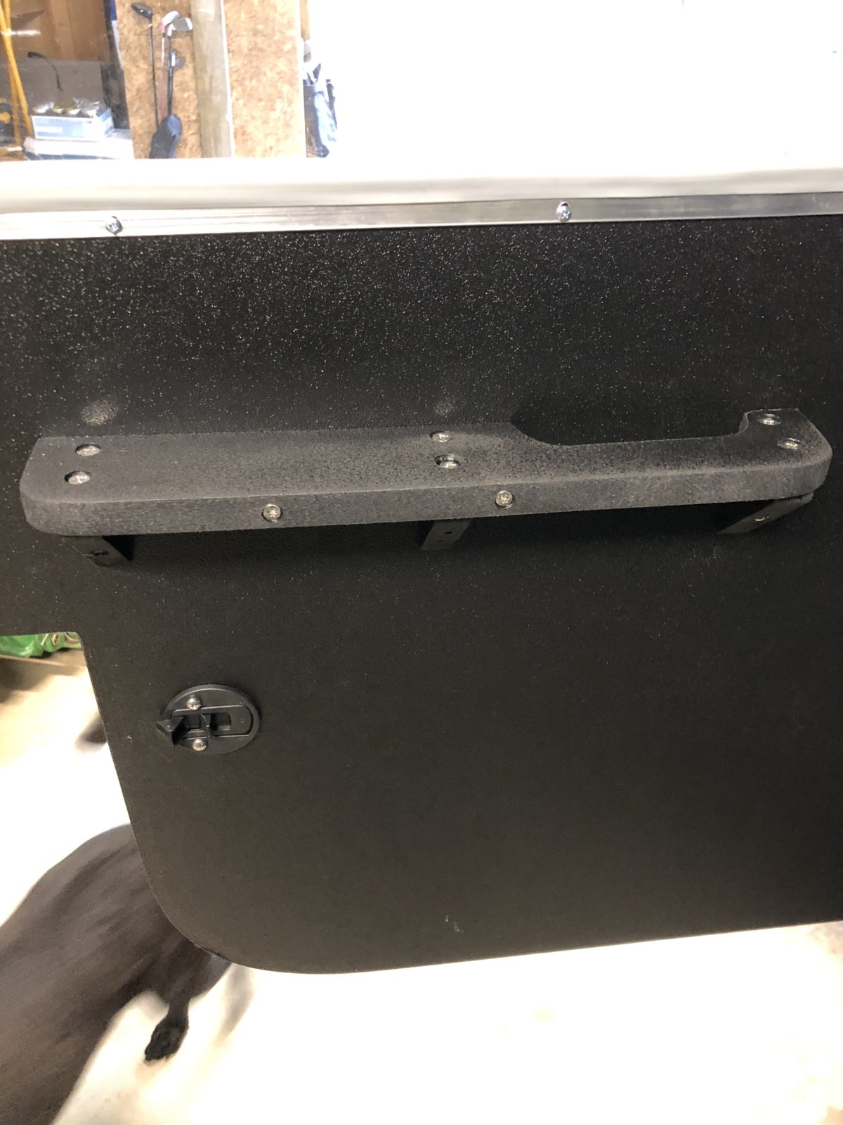

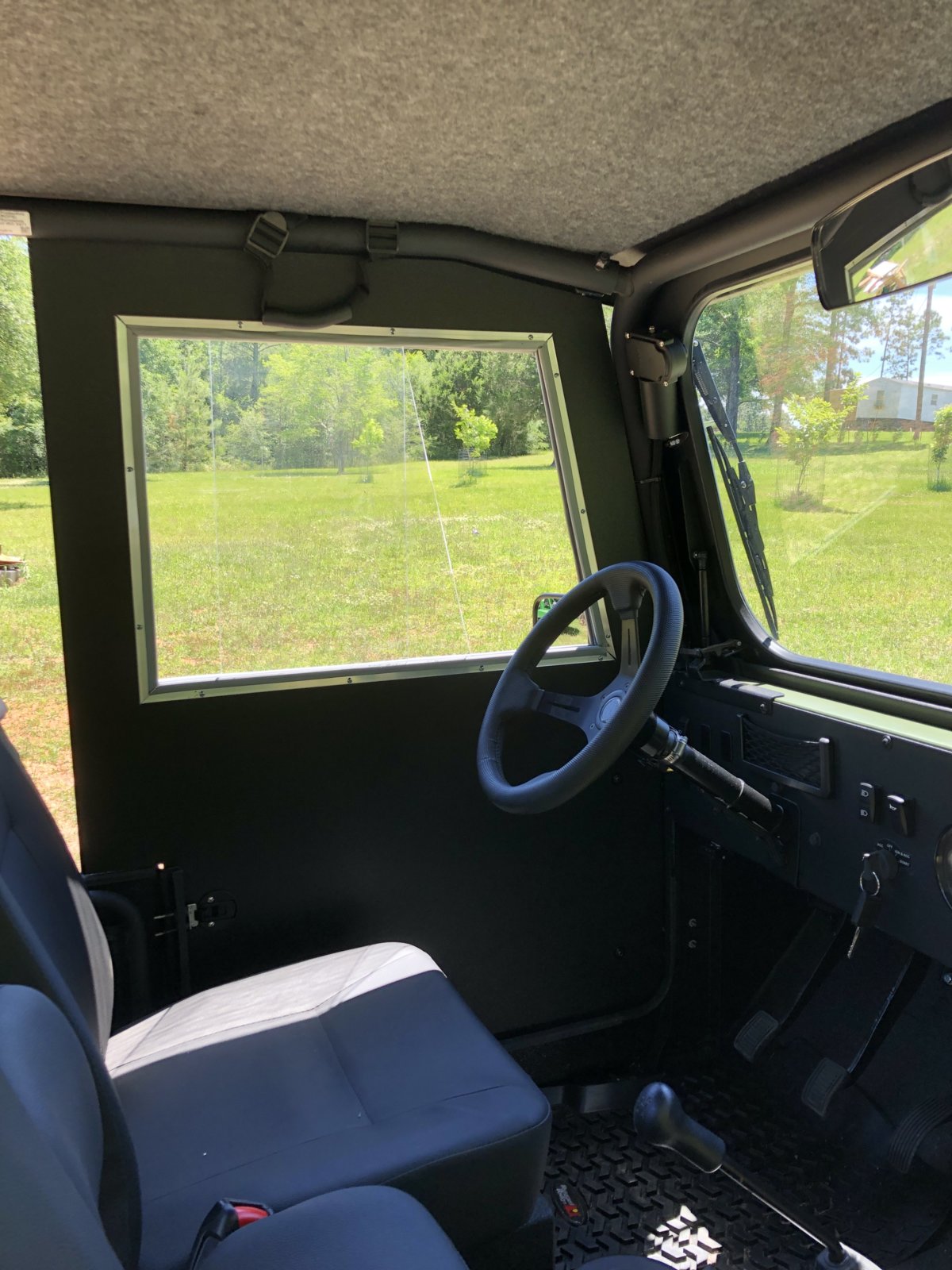

Been working on this today. I only have one made but I like the way they fit around the roll bar and tuck under the fortress top. Should do a good job at keeping the rain off as they are without adding any weatherstripping. I test drive it down the road a ways and was really surprised at how much wind it cut down on even with just one door on!
I’m not crazy about the plexiglass because it scratches easily but at least I’ve got a pattern to get some tempered glass cut.
Also, I’m going to order the window trim in a bronze color. Should blend with the door a lot better.
One more thing: because they are plastic, they are a bit flexible. After lunch I’m going to weld up a steel stiffener to add to the inside to give the door some strength. What do you think so far?

Thanks! I’d have to sit down and figure up my material cost and see how much time I think it’s going to take. I’d really love to sell them in the $1,000 range but I’m going to have to see. Definitely want to use tempered glass instead of plexiglass.
I wonder if some pipe insulation on the roll bar would help keep the rain out while driving. Nice job. Very impressed by your creativity and fabrication.
1,303
The foam padding made specifically for roll cages will be denser and probably seal better and last longer.

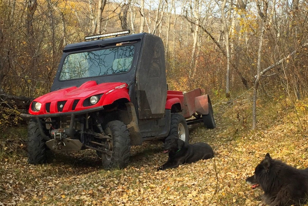

This is my old Rhino, my brother and I made doors/cabs for them. Our whole door was Lexan with a 3/4" tubing frame. I thought about that for the Roxor. They scratched a bit, but they were light and easily removable. I painted the bottom inside of mine black.
I have video of them on my Youtube channel. They served me for many winters.
That’s not a bad idea. The door does rattle a little against the roll bar towards the back.
I have video of them on my Youtube channel. They served me for may winters.
I think I’m going to have to weld something all the way around and attach to the inside of the door to make it a little more rigid. Piddled with it a little more this afternoon.
