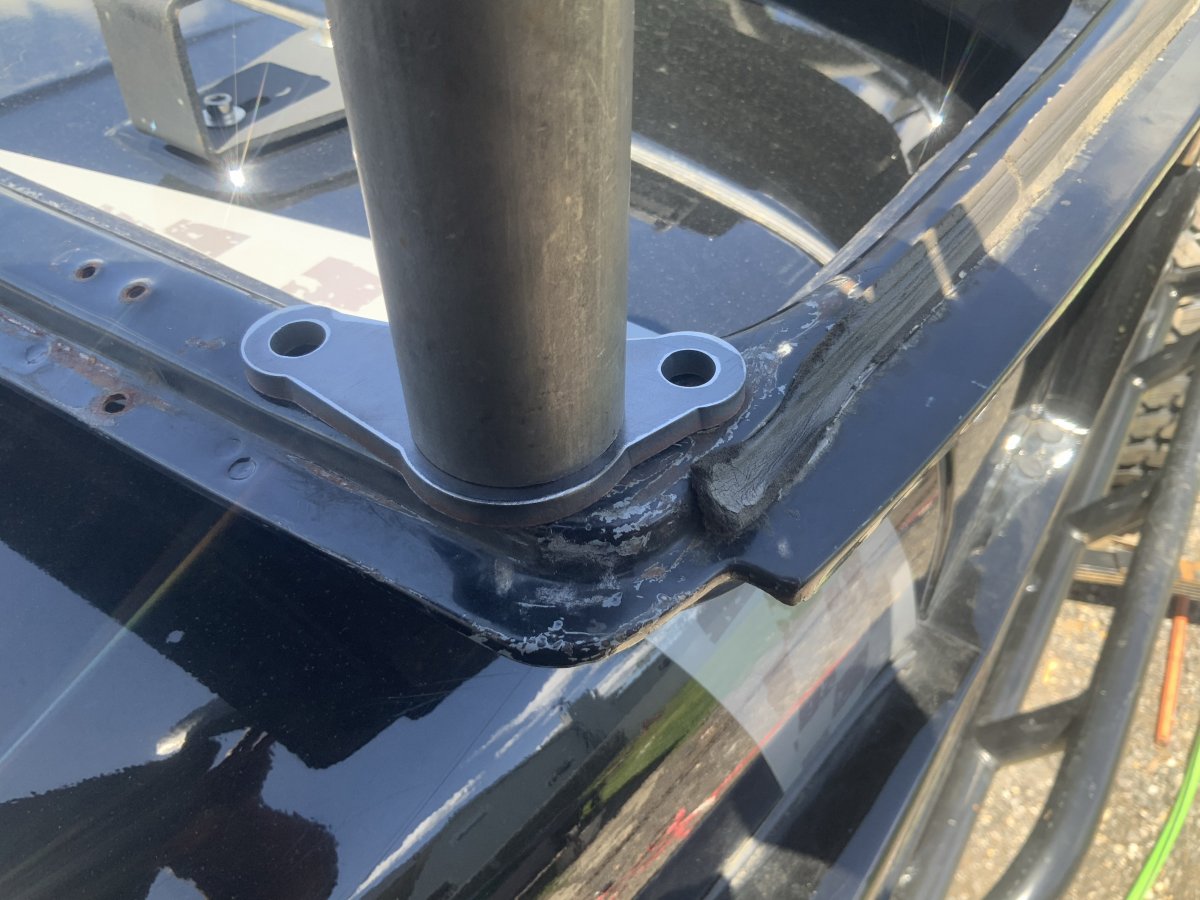

I am planning to install a YJ windshield. Ive seen it mentioned as an option on here but haven't been able to find where anyone specifically has done what I have in mind. My reasoning for going with the YJ is that it has locations in the corners to attach the roll bar side pieces. I figure if I can find a set of those and some roll bar tubing, I can remake the parts of the roll cage that extend from the windshield back to the rear wheel wells.
Anyone have any experience or thoughts on this project?

I can cut you a set of the windshield mount tabs on my plasma table. I just made a set for myself. Doing something similar on mine.
Max A.
Nov 4, 2019
578
Baltimore, MD, USA
00168
I’m doing a family style cage from scratch. 1.75 .120 wall dom tubing.
I should have a full cage starter pack available for sale next week. it will include the plates to mount the the factory tub points plus a sandwich plate for the front A pillar to the floor.
I guess I should also list the windshield tie in plates for sale too.

Decided to install the donor windshield this weekend. My new frame came in but I decided it would be best to fit everything up with the one from the yunkyard. Looks good to me. The roll bar extensions I got look like they will bolt up to the center roll bar once I cut it down. The passenger side one is bent but for fitting up, it worked fine.
