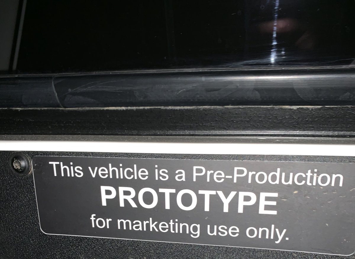

Not much to leak other than their are some tuning improvements, grill has changed and gearing is 5.38.
Thanks. As you know, there's been much speculation and drama over the changes coming to the 2020 lineup.
