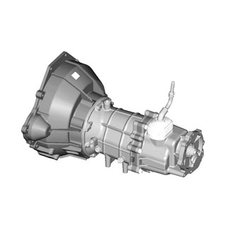

According to the ultimate authority on all things true and pertinent, Wikipedia, this is the manual transmission in our Roxors, the NGT520:
Product CodeNGT520 (For 4WD Application)
Product Description5 Speed Manual Transmission
Maximum Torque Capacity220 N-m
Configuration2 Shaft design
Speeds5 Forward and 1 Reverse
Gear Ratio Spread5.06 - 4.78
Gear RatioV4 - V1
1st Gear4.00 - 3.78
2nd Gear2.09 - 2.24
3rd Gear1.38 - 1.43
4th Gear1.00 - 1.00
5th Gear0.79 - 0.79
6th GearN.A.
Reverse Gear3.52 - 3.52
FD GearN. A.
SynchronizationForward gears: Single cone
Reverse gear : Sliding mesh
Weight (Dry)53 kg (Without Clutch Housing)
Gear Shifter SystemRod type (Direct Shift)
LubricationSplash Type
Oil Capacity2.3 liters

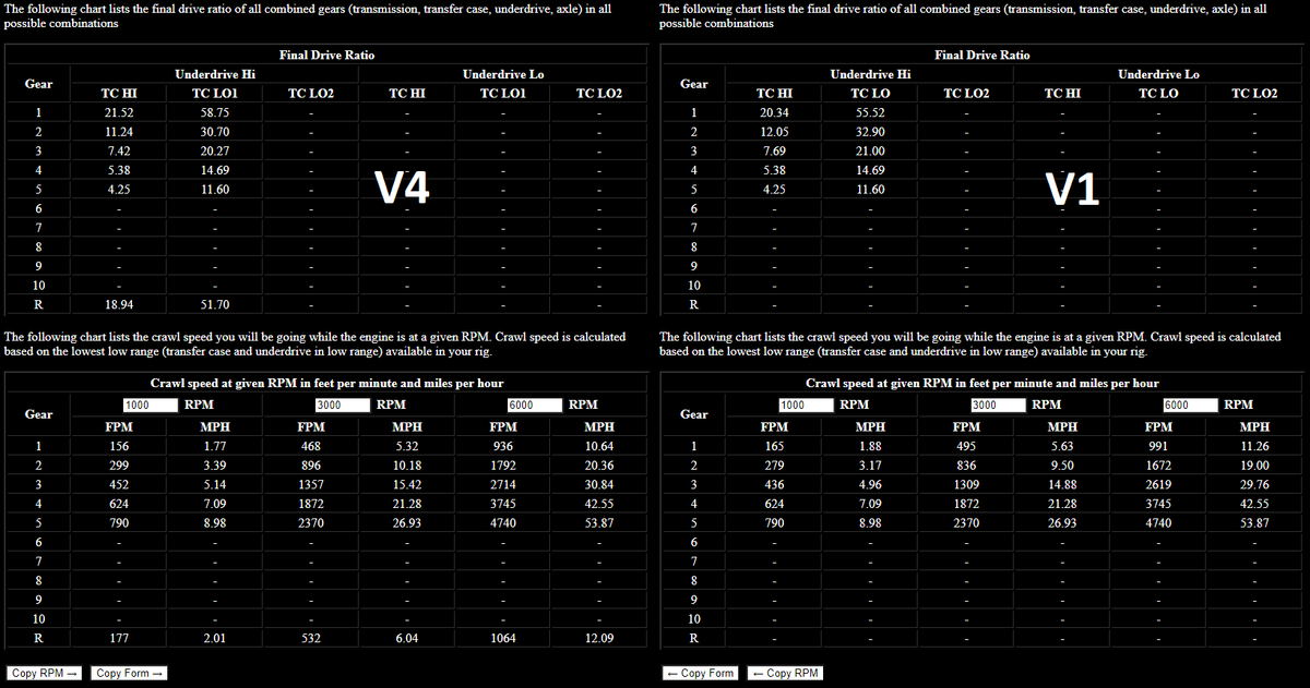

it doesn’t seem like a whole lot but since the gear change is happening in the transmission, you still have to multiply the transfer case ratio then multiply your differential ratio to get to your final drive ratio so a small difference in the transmission will feel larger than it seems
Max A.
Nov 4, 2019
584
Baltimore, MD, USA
00168

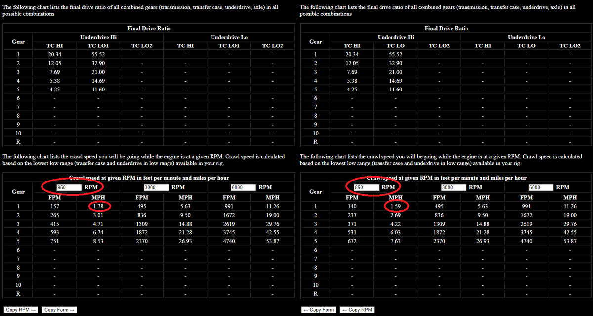

Nice find. v4 final drive with 5.38 in low would be 58.75:1 and the v1 would be 55.52:1. That's the difference of 1.8mph vs 1.9mph @1000 rpm with 35s. I don't know if its worth it.
You may be better off getting a lower idle put in your tune for slow crawling. I had Diesel Freak drop my idle by 10%. Still has plenty of torque and oil pressure but have a slower crawl.
I have been wondering about that option! My idle is still at 825 or 850, whatever the factory is and I have been able to idle up quite a bit of the obstacles if it wasn’t super technical.
And thanks for doing the math for me. I think you’re right on the transmission idea

I just ran the numbers through Grimmjeeper.com's gear ratio calculator and got these results (attached PDF file). This website is a fantastic tool for estimating what gear changes will do for you.
  • Gear Ratio Calculator.pdf
