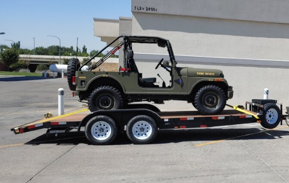

I suggest you double check how your Roxor will fit on your 10ft trailer.
I have a 6'9"x14' tandem trailer rated at 7000# which works for me. I agree with Togo though that you should stick with a tandem.
A basic Roxor weighing 3035#s would be maxing out a single axle trailer with a standard 3500# axle once you add a spare tire, winch etc.
You could build a trailer using a 5400# axle, but a tandem is more stable, easier to load and has margin of safety in case of a blowout.
A Roxor at 12'4" in length, 13' with a spare, will fit on a 14' trailer with little room to spare. You need some wiggle room if you're using chains with binders for tie-downs, and even straps need room to ratchet.

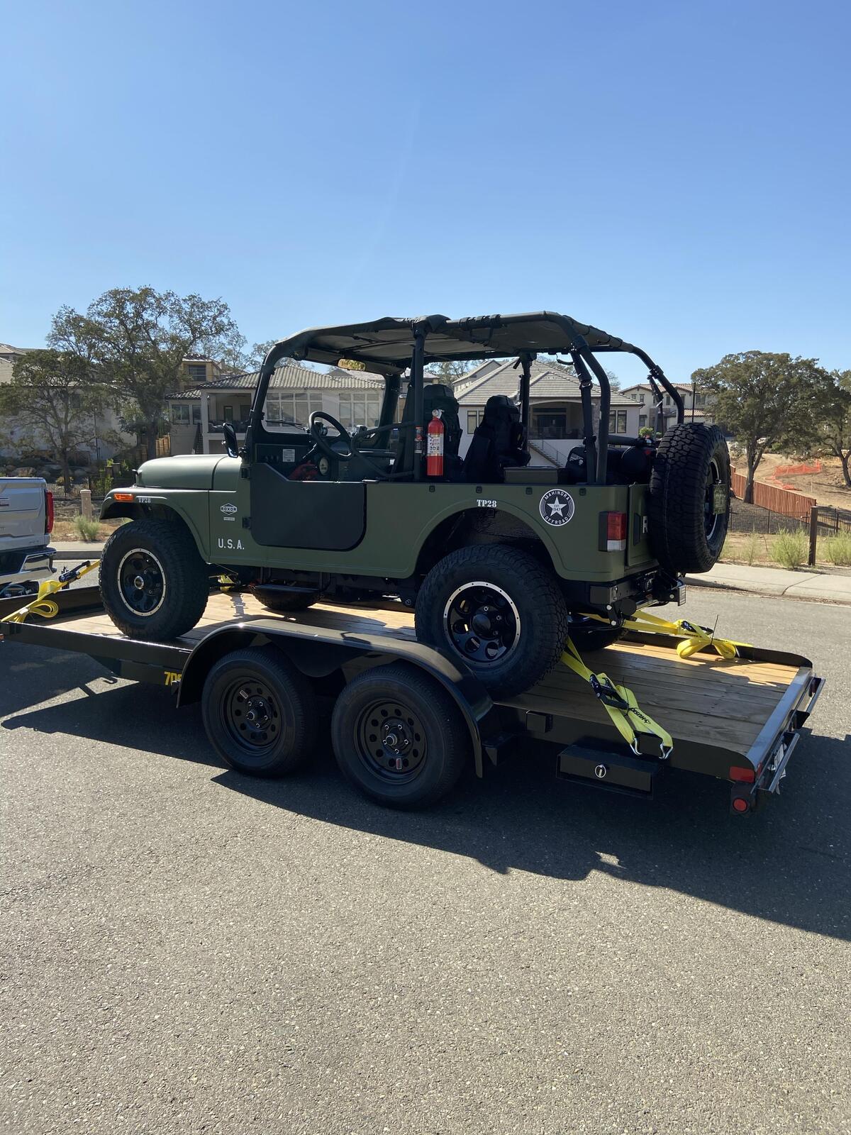

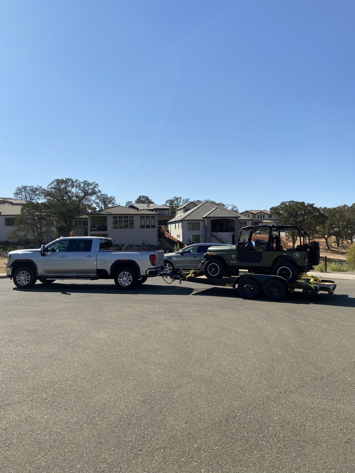

I use a 16' tandem axle trailer. I'm not sure I'd want anything less for long distance hauling. Whatever you go with, I would recommend tandem axles for sure.

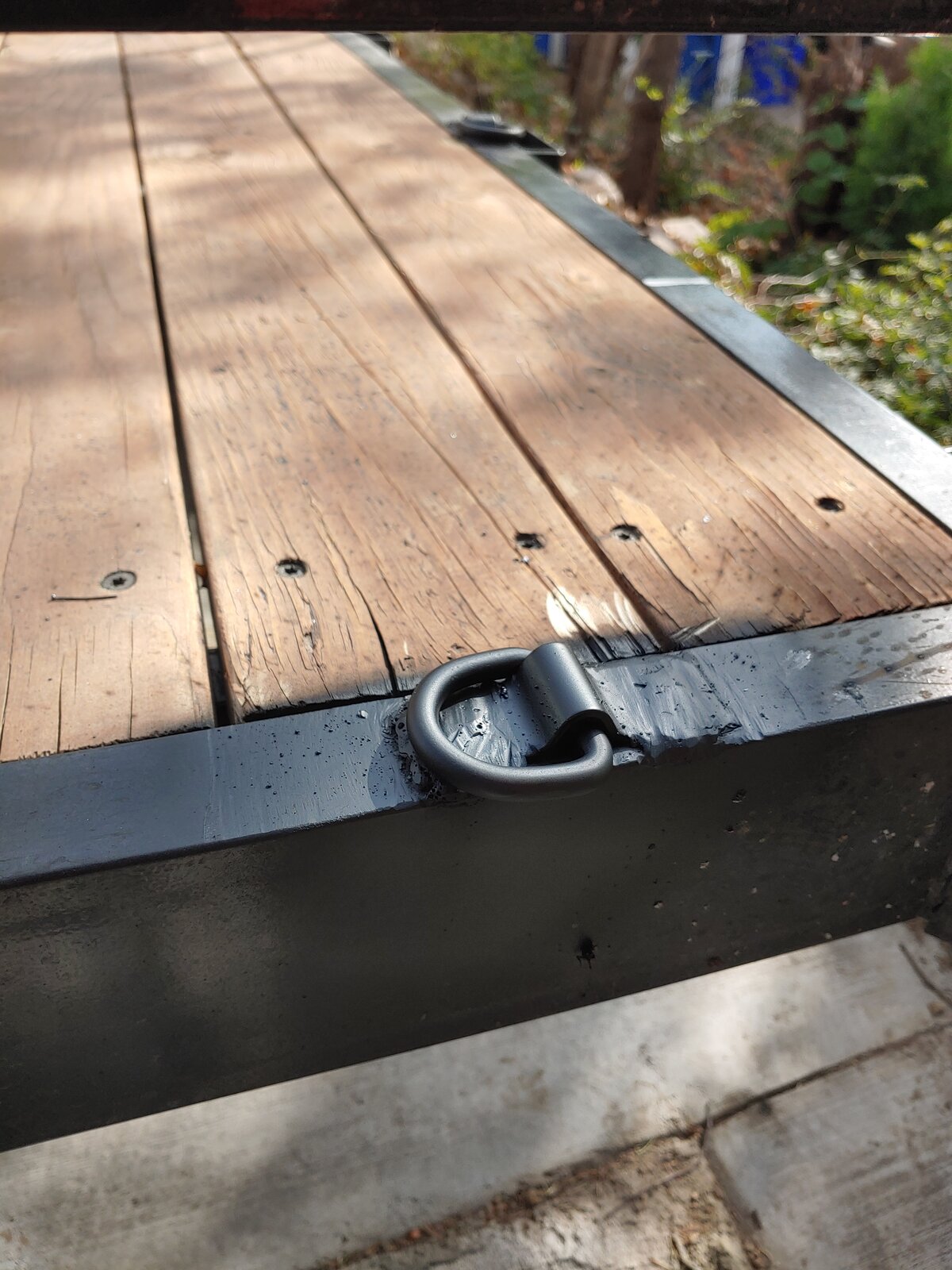

2,199
Same here a have a 16' with a 2' dove tail for my muscle car. Double axle 10k I welded extra tie down points on.
