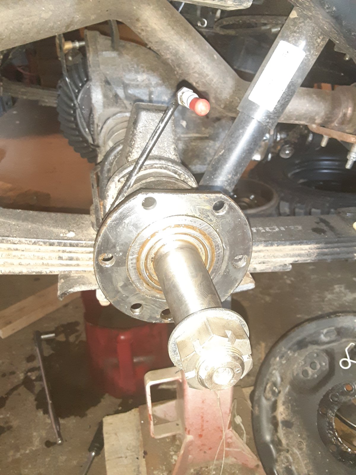

Does anyone know how to get these rear axles to come out
I am wanting to install a torq locker as well for the rear. If anyone has the step by step instructions for this install, please share. Thank you!!
Instructions can be found on Roxor parts page. Scroll to the bottom and look for install guides.
Thanks Mavrox!. Those help with respect to common roxor part removal, but was hoping to see some instructions specific to the Torq locker instead of the Spartan. Im not sure if the whole carrier needs to be removed for the Torq install like the Spartan. And, maybe only one axle needs to be removed, but Im not sure. I would love to know if someone has done it, and has some steps, pics, lessons learned, etc for the Torq locker.

Gotta pull carrier. Pin won’t clear the ring gear so it has to come off as well.
