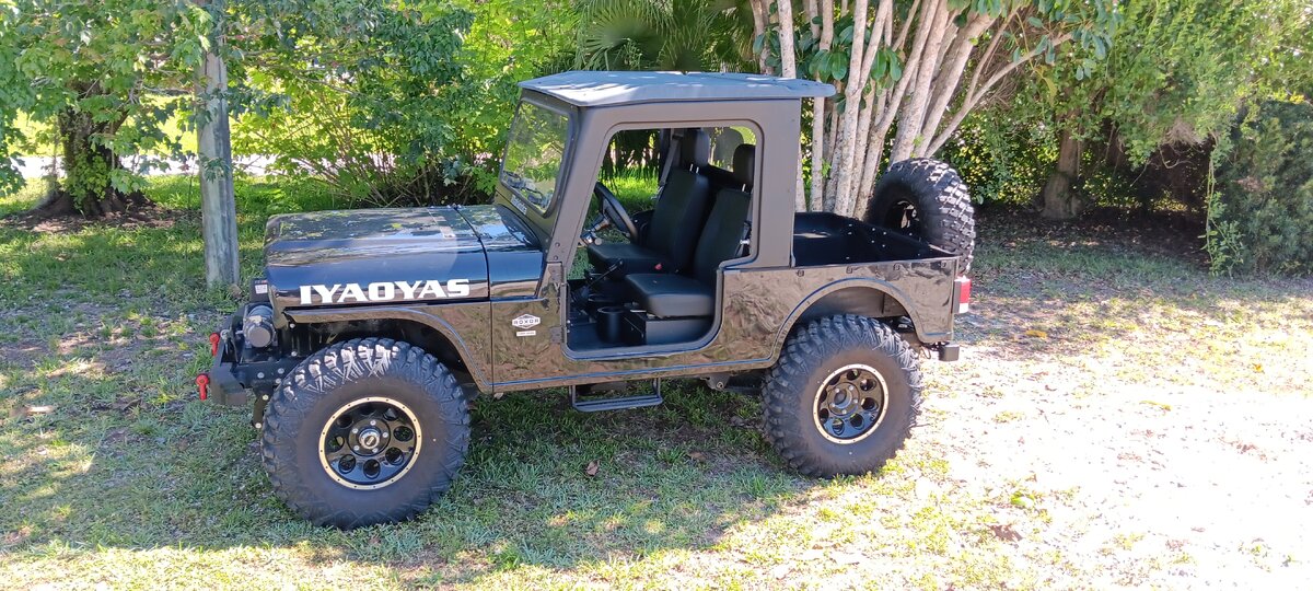

I run with the Pro Crawlers 35 x 10 x 16. You would need 2-inch wheel spacers on the front at least, to keep the tires from rubbing on tight turns.
I am running the stock rims also.
Also, mine runs good on the street but if I do a 45-degree cut across a deep ditch my rear tires rub the lip of my tub. A slight body lift would help me.
Also, mine runs good on the street but if I do a 45-degree cut across a deep ditch my rear tires rub the lip of my tub. A slight body lift would help me.View attachment 14846

Thanks for your input. With the ones I’m looking at being essentially 33x10x16 do you think those issues would still be there?
I think you would not have those issues. The 33s would probably work easily. I had done all my measurements before I went with the 35s and I am right on the edge with my setup. 2-inch difference is quite a bit and my 35s run true to 35-inch height.
