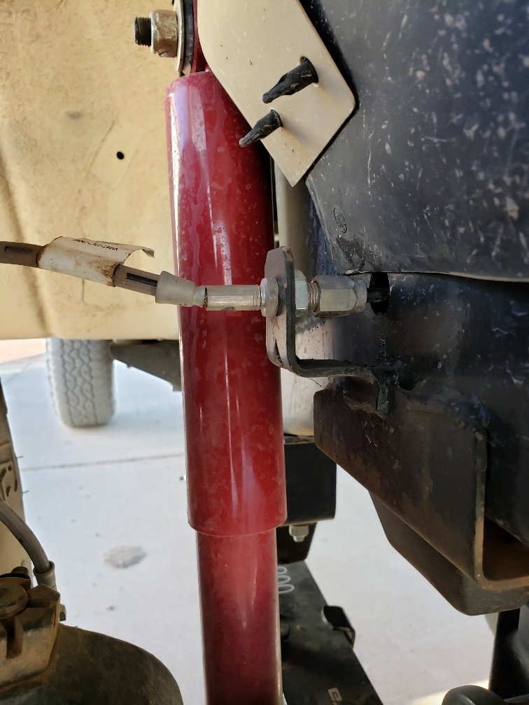

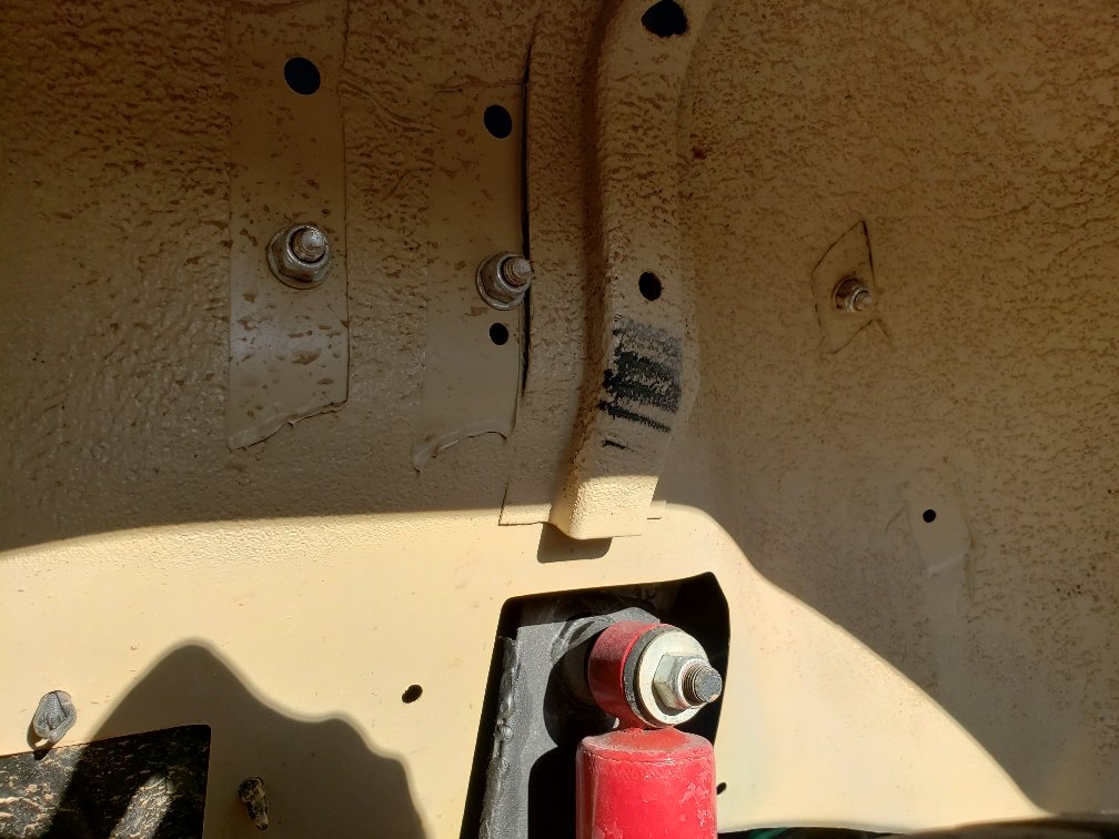

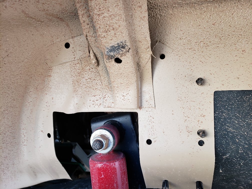

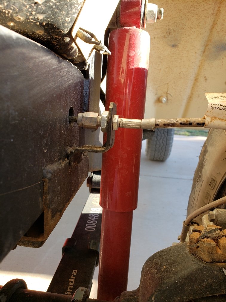

Weather is PERFECT out Finally, so we took off on a "short" wheeling trip when I got home from work. The trail I chose ended up being pretty gnarly for only a shackle lift. Rubbed the both front tires inside the wheel well, and bent the brake lines up just a tad. The new wheels I ordered are 15x7, 4" backspacing with 0 offset. Exactly what the stock wheels are. So after next week when I get the 33" KM3's on, I'm probably going to have some problems. I very much dislike wheel spacers, but I think I'm going to need 1 1/2" spacers. We will see next week.

Watch that bolt on the upper shock mount, mine hits the inside of the sidewall on the tire with the sway bar disconnected and would probably tear a hole pretty quick if you did a few rotations.

Good call. There was a slight amount of rubber on the driver side shock bolt

Sway bar off mine. Brake line looks same as yours but I don’t think that’s an issue. Have same scrub mark on inner fender as you but running 32” tires- surprised stock tire comes up that high.

Never noticed shock stud polishing yet
