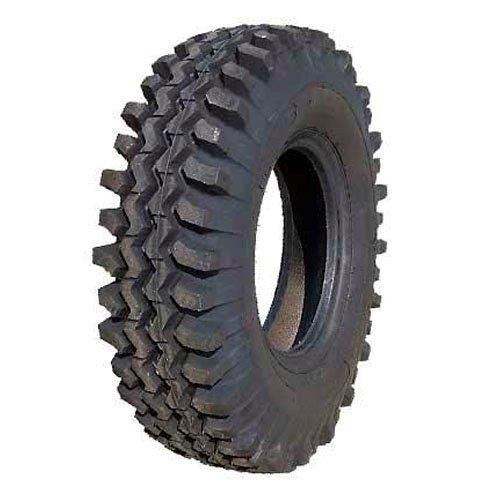

I just bought my 2018 and it came with these tires. They aren't good for street use, but they provide great offroad traction and the sidewalls are stiff as hell and that might indicate a thickness that makes them pretty resistant to getting poked.

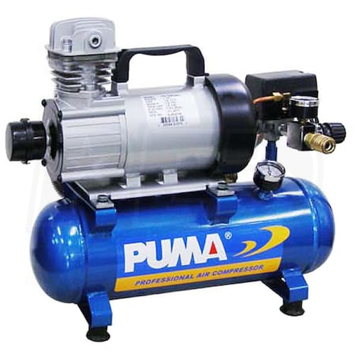

I wouldn't do that. If it worked, the military would do it. The last thing they want, it a flat tire in a hot combat zone. The Russians tried this back in the 80's, but quickly learned that the tires absorb A LOT of ground vibration, that now was transferred up into the vehicles drive train, and caused huge problems with very expensive break downs.
If I was you, I'd get one of these air compressors in an ammo can, that have a tire plug kit in it. They're great, and have a long duty cycle, and air up a truck tire VERY quickly. Make or buy an ammo can mount, and leave it on your Roxor all the time.

I have one of these compressors and, in certain circumstances, I carry it in the back of the vehicle I'm in along with a tire plugging kit. It puts out a good amount of air and can even run an impact wrench in short bursts. Mine is close to 20 years old and still doing good.
