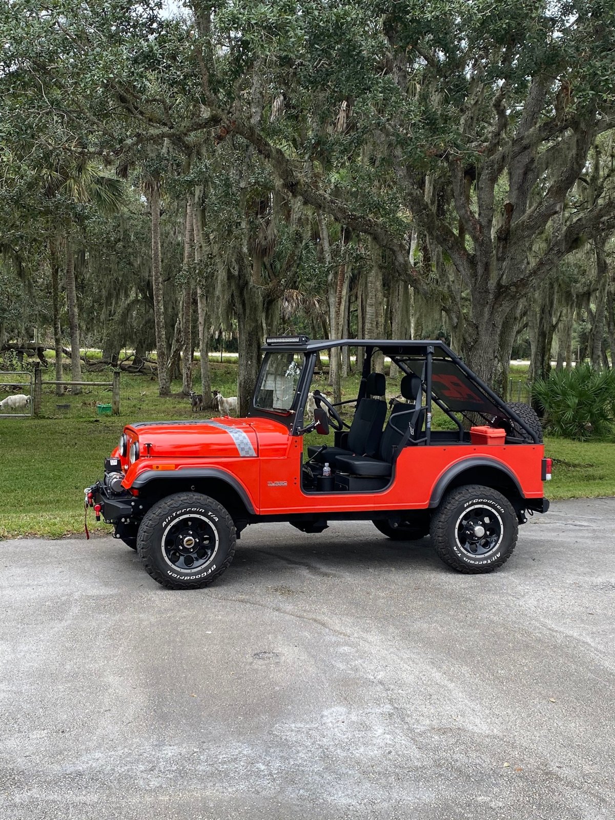

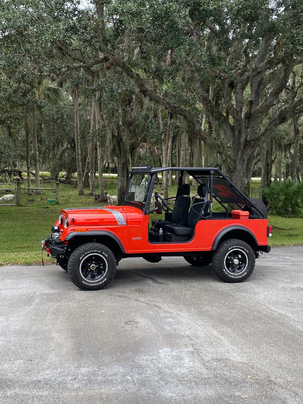

I installed rough country kit used all supplied parts easy install and I feel like it rides better than before it definitely looks better

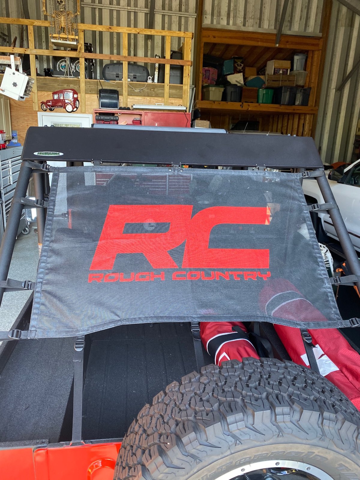

I installed rough country kit used all supplied parts easy install and I feel like it rides better than before it definitely looks betterView attachment 5441View attachment 5441i sure like the red color with that wheel combo
Wanted to ask where you got that piece in the rear of ur rollcage it’s says RC in red ? Does it help with the rain wind or just look cool? I put a wood piece there just for storage under my carport but would like something permanent
066243E3-9562-4D75-8856-C3DA7A69B105.jpeg ADBFB4F3-256C-4993-BA72-CC352E2CCC23.jpeg
RCF
Mar 13, 2019
111
Vero Beach, FL, USA
1697
It’s a rough country roof shade for jeep they accidentally had it listed as a Roxor accessory in their catalog I ordered it with lift kit but it didn’t fit when I called customer support they refunded me and told me I could keep it ; so I took it to a Freind with sewing machine and we added straps to make it fit blocks the sun and u can still see thru it it might block a percentage of rain mostly it just looks cool
