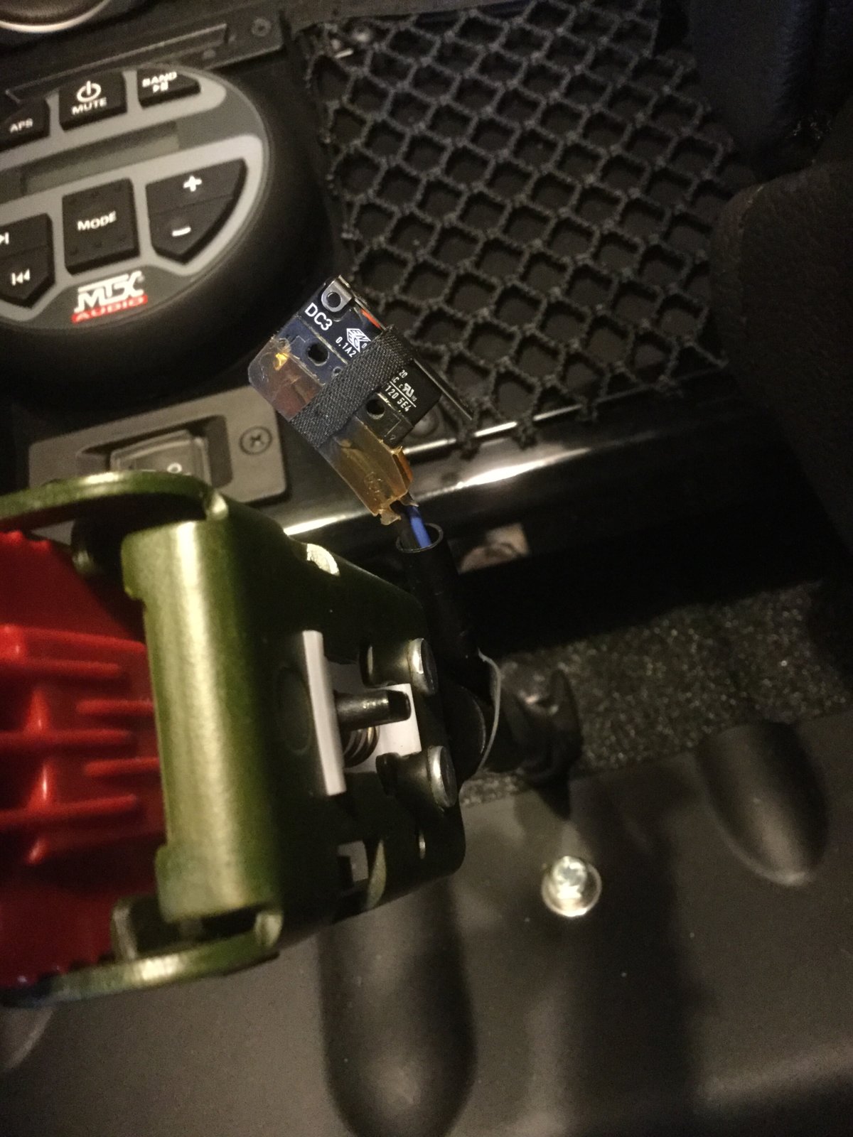

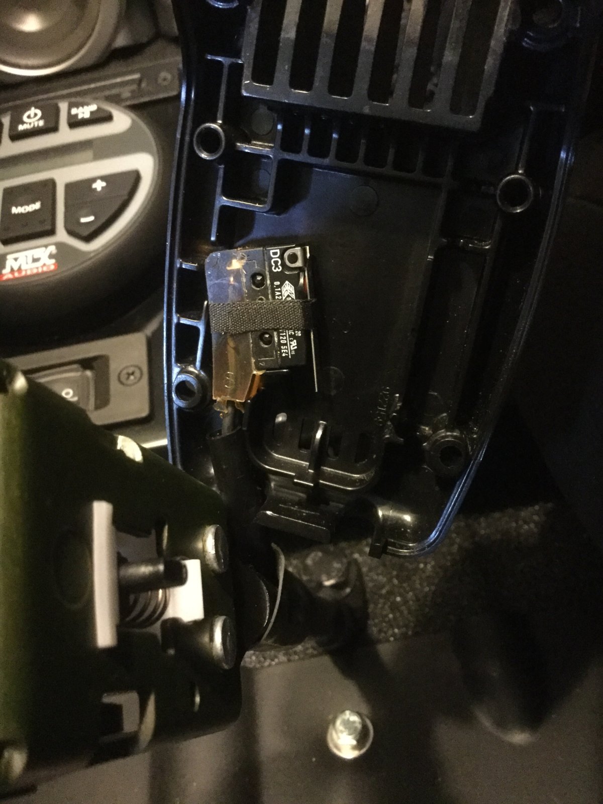

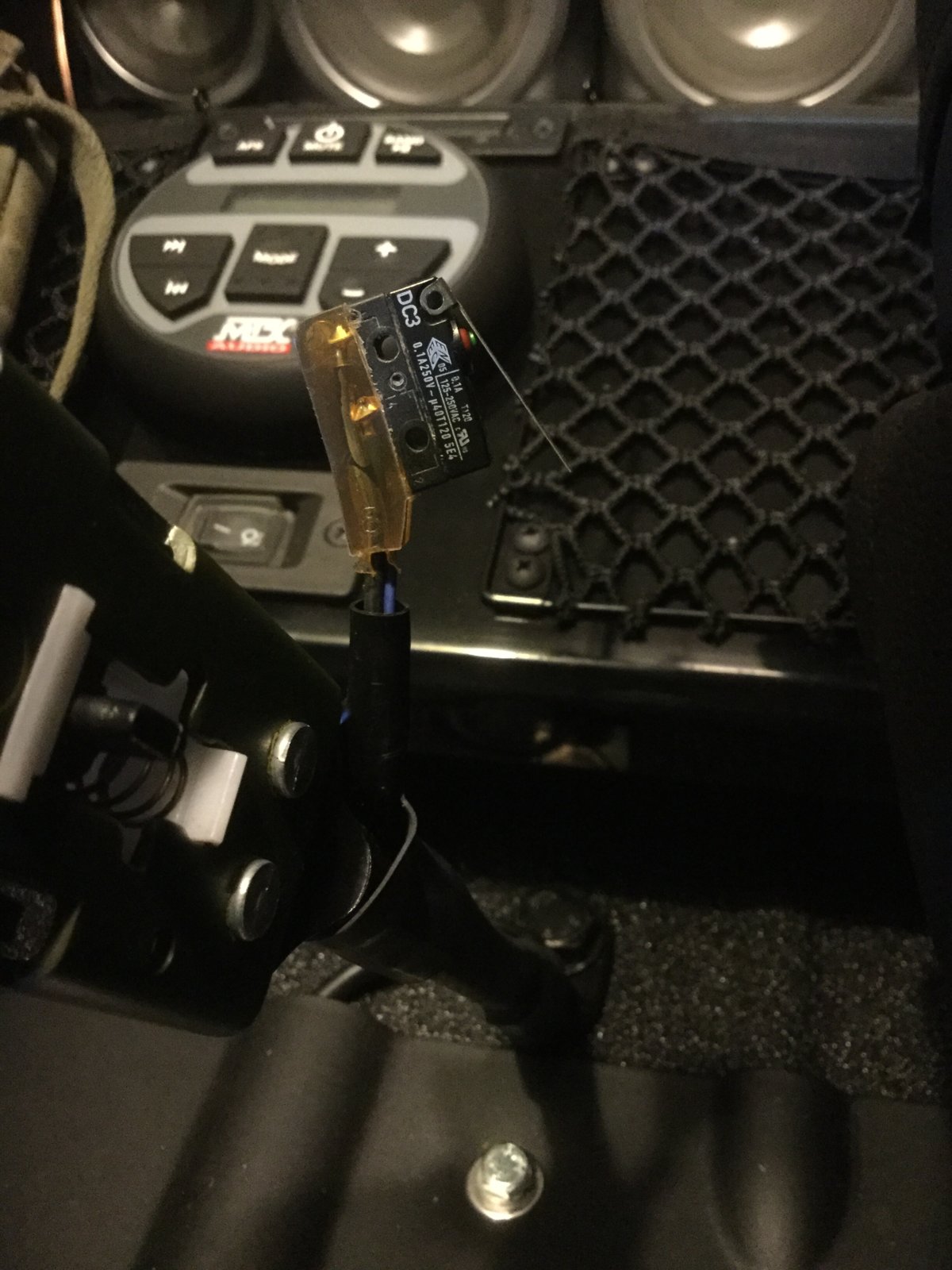

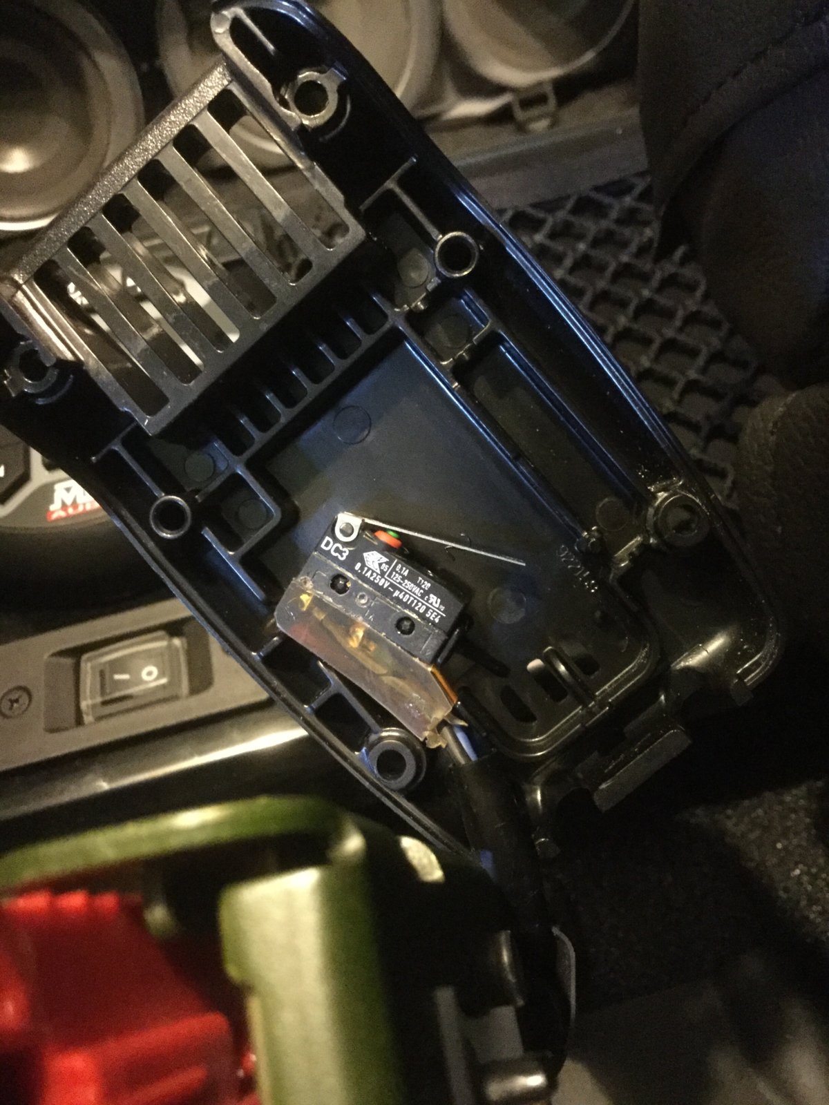

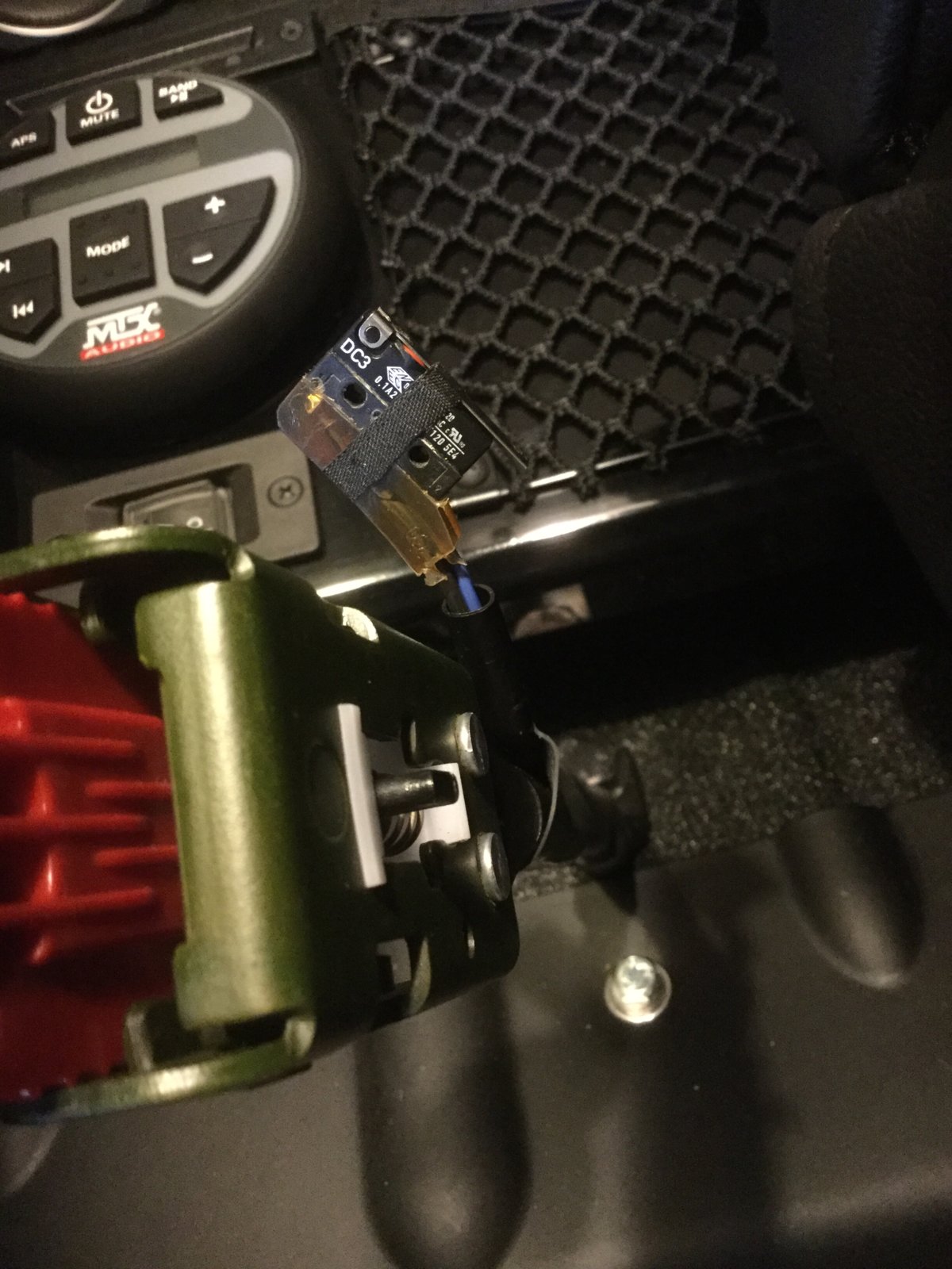

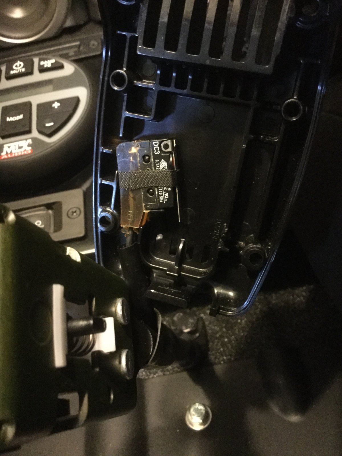

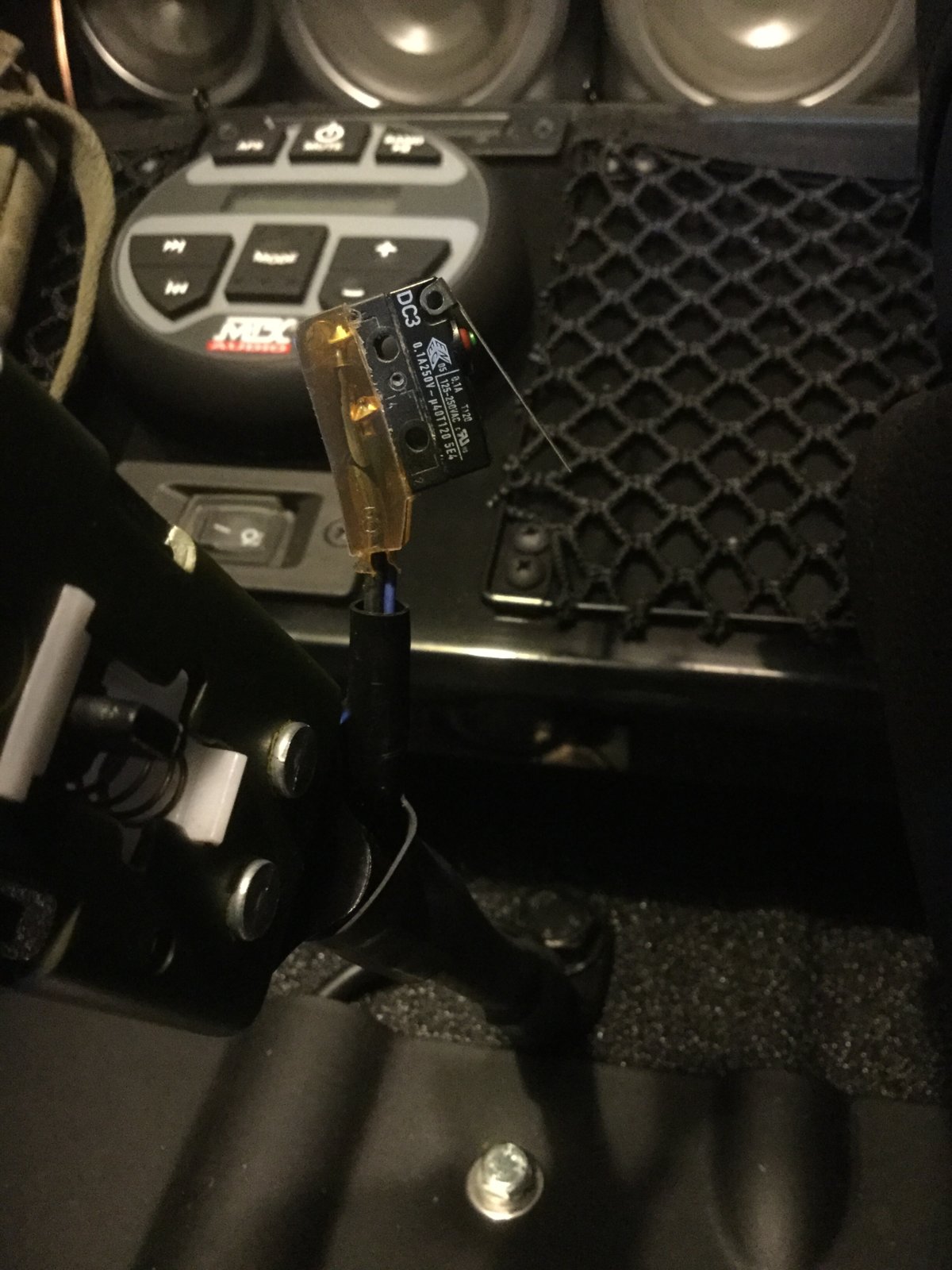

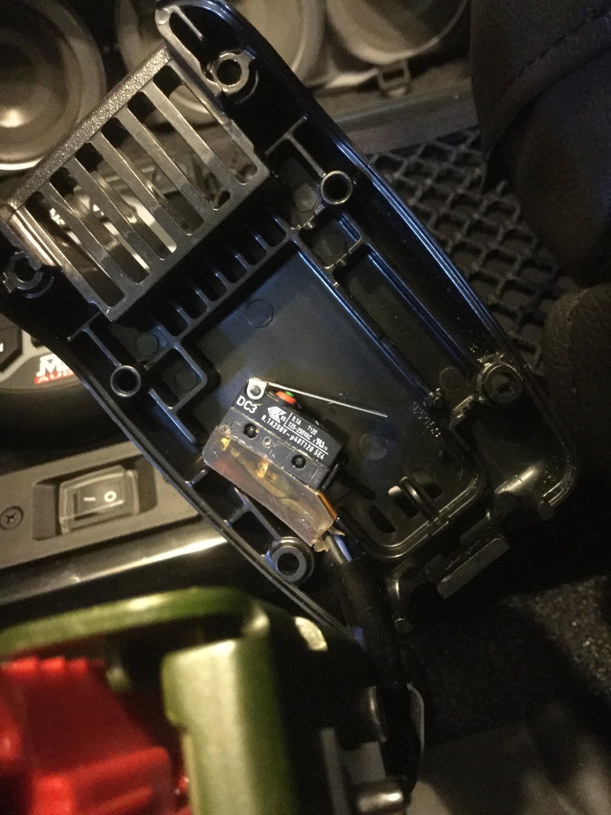

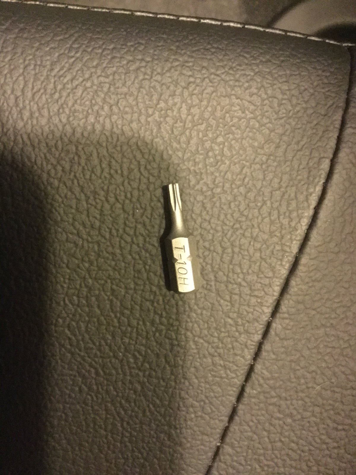

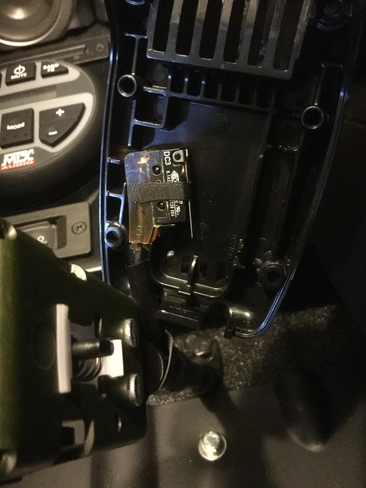

looking cool and nessesity, the mother of invention!

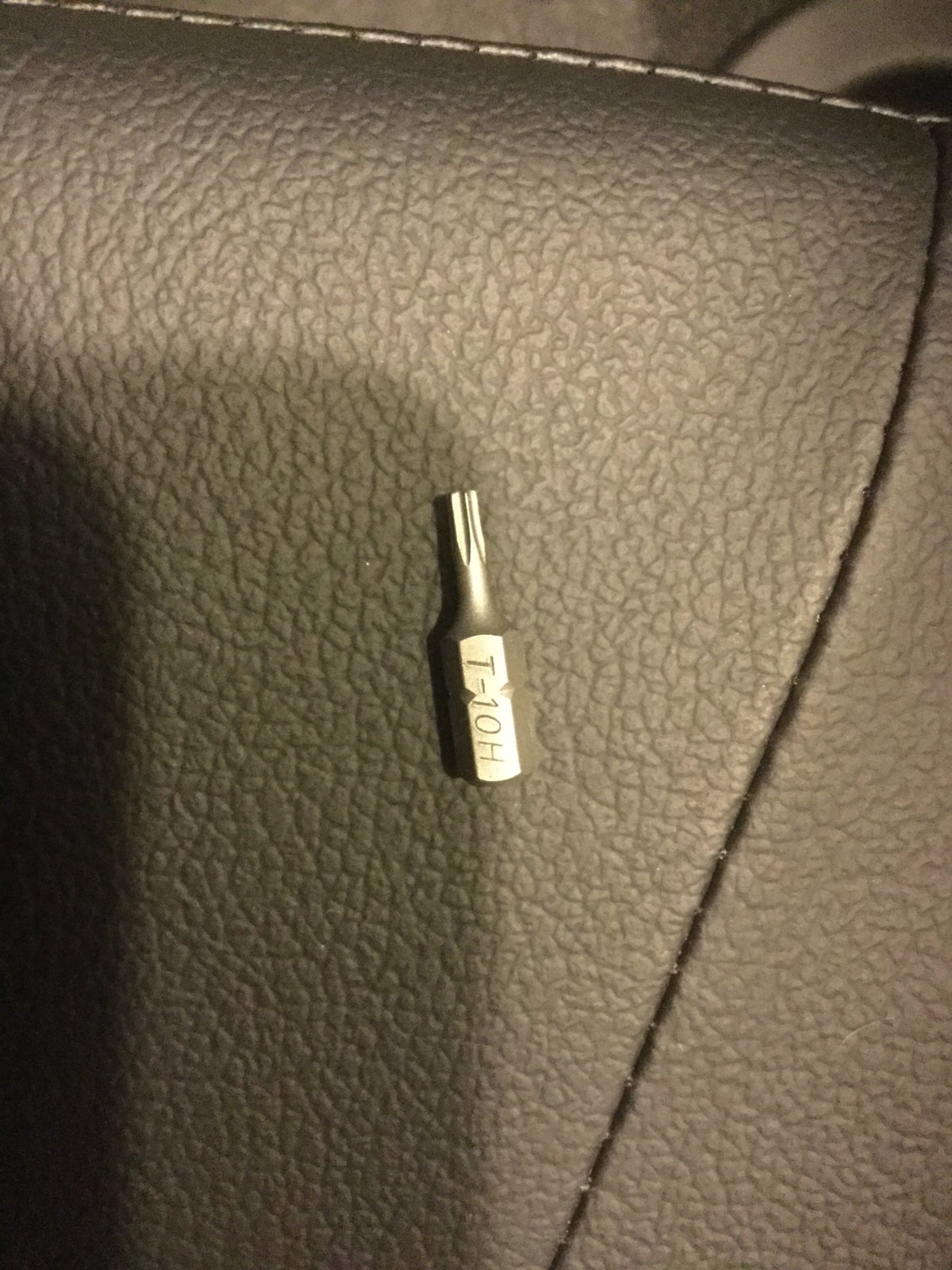

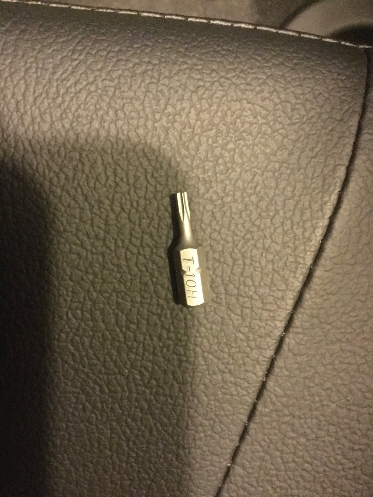

I dont have the seat belt adapter, so I opened the seat bealt with a T-10H security screw from my xbox repair tools and then taped a very simple lever down. I used thin tape cause a wider tape would have closed two holes needed for mounting, i guess i could have perforated 2 holes after the fact, and would have had a sturdier hold.

Great photos, thanks for the detail. Much easier than crawling under the Roxor to cut the wire, and it's easily reversible.

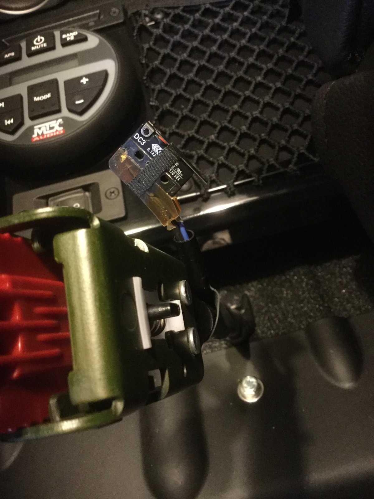

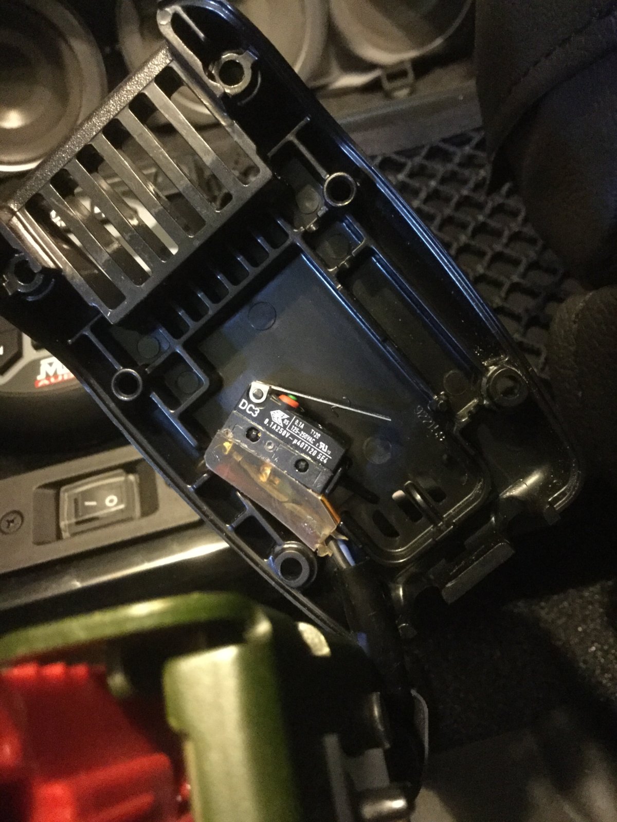

View attachment 2302View attachment 2306View attachment 2307View attachment 2308View attachment 2309
Nice!
