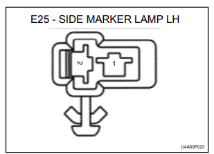

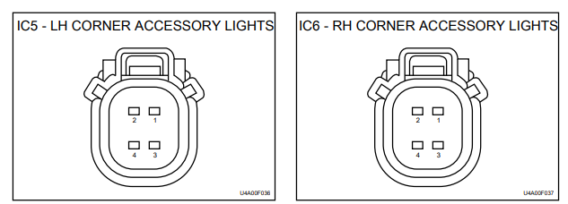

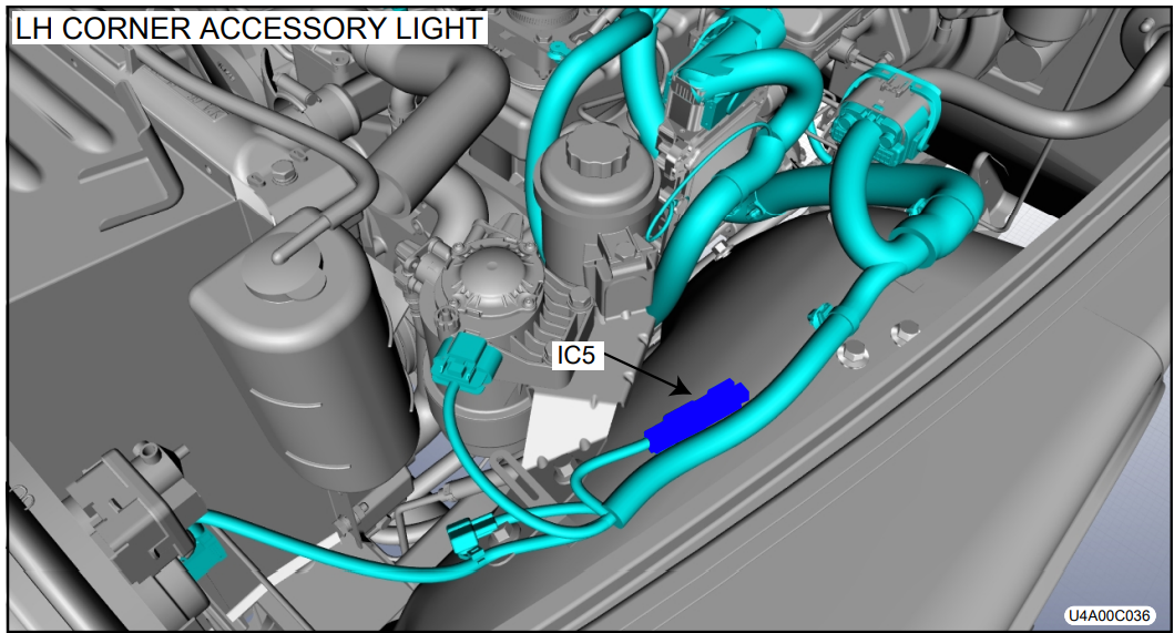

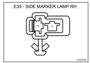

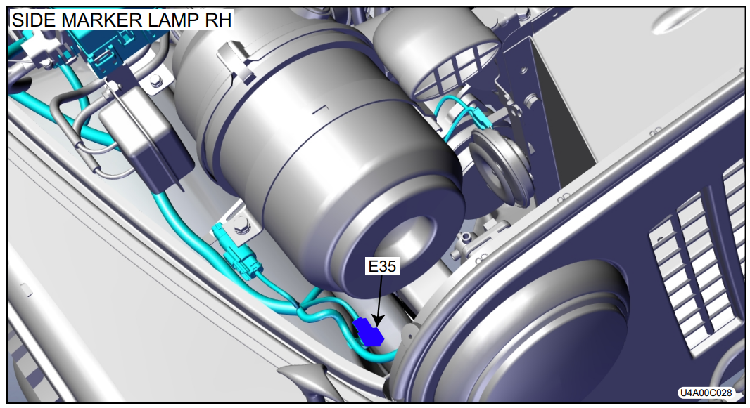

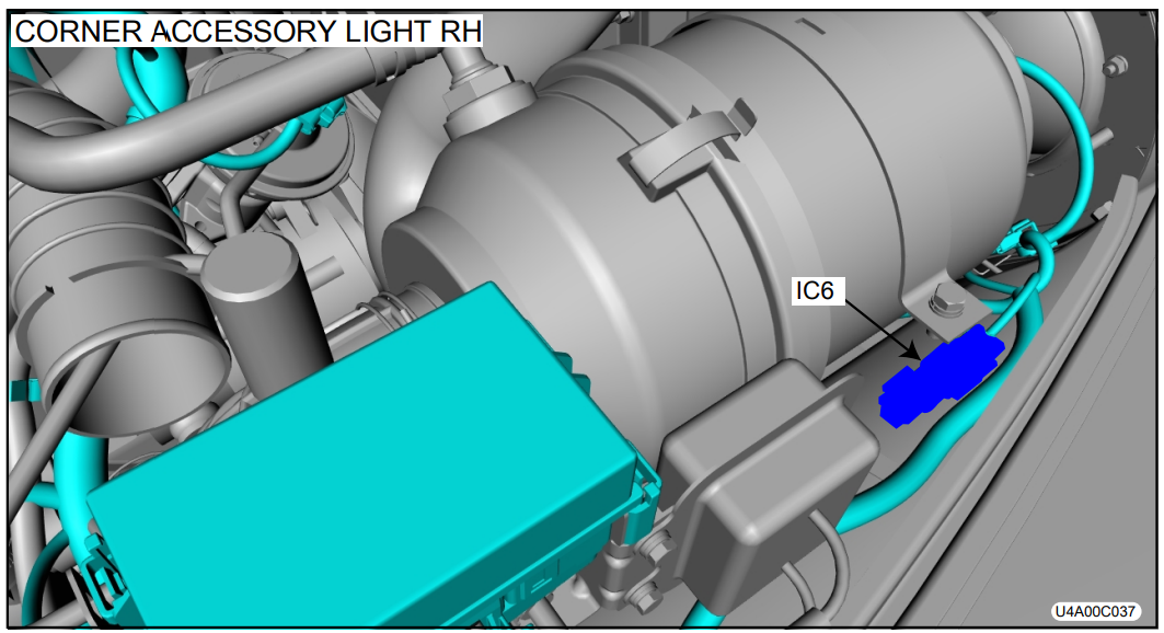

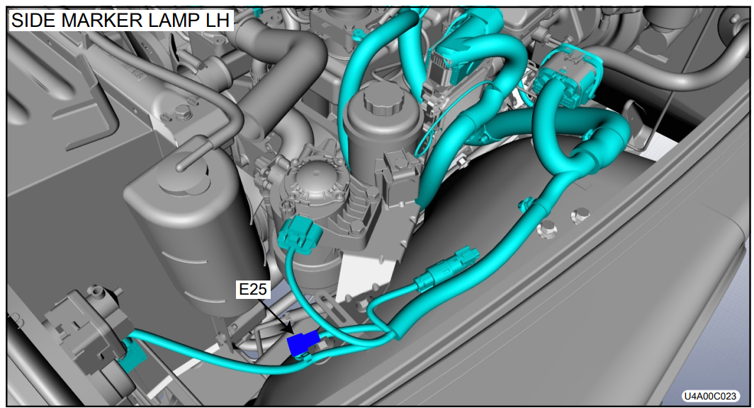

Request confirmation if the following interconnects IC5 (LH) and/or IC6 (RH) and/or Connectors E25 (LH) and/or E35 (RH) are present on the 2023 HDUV. These would currently not be used on the 2022 up vehicles, but may be present and stowed as part of the harnesses. I have noticed that Mahindra changes only what they have to between harness dash number rolls and often leaves unnecessary parts installed but stowed. I would like to put these circuits and connectors to use if someone who has a 2023 HDUV available to take a look under the hood and let me know if any of these are present. Thank you.

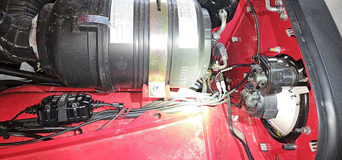

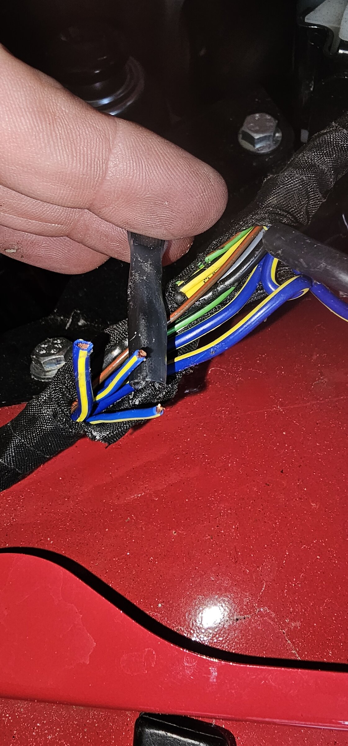

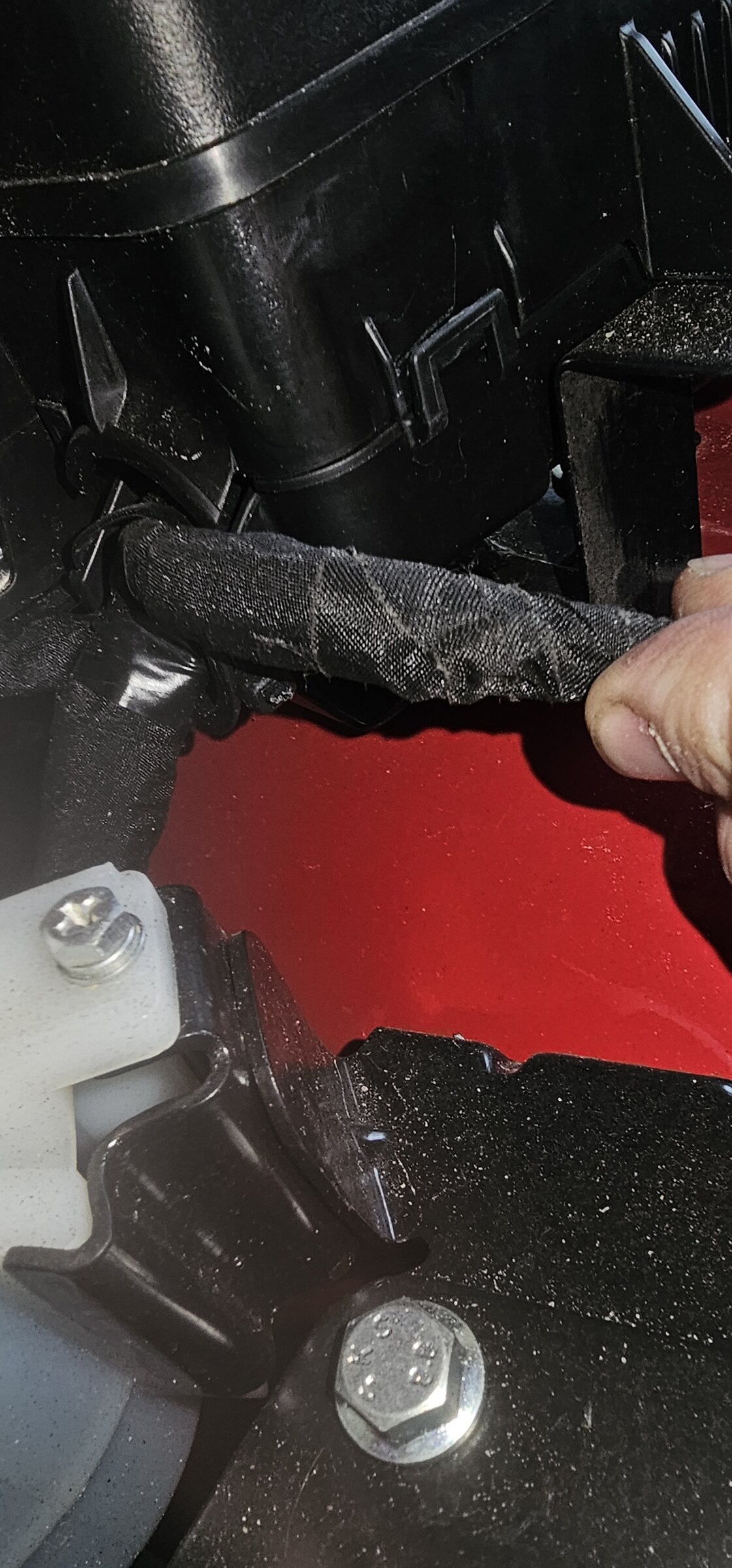

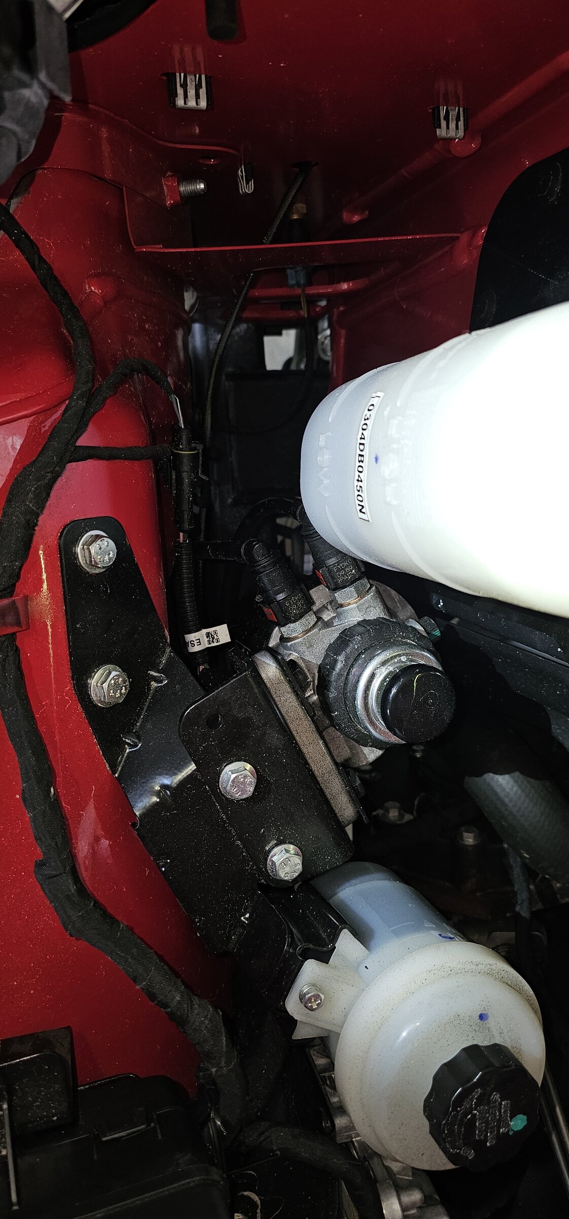

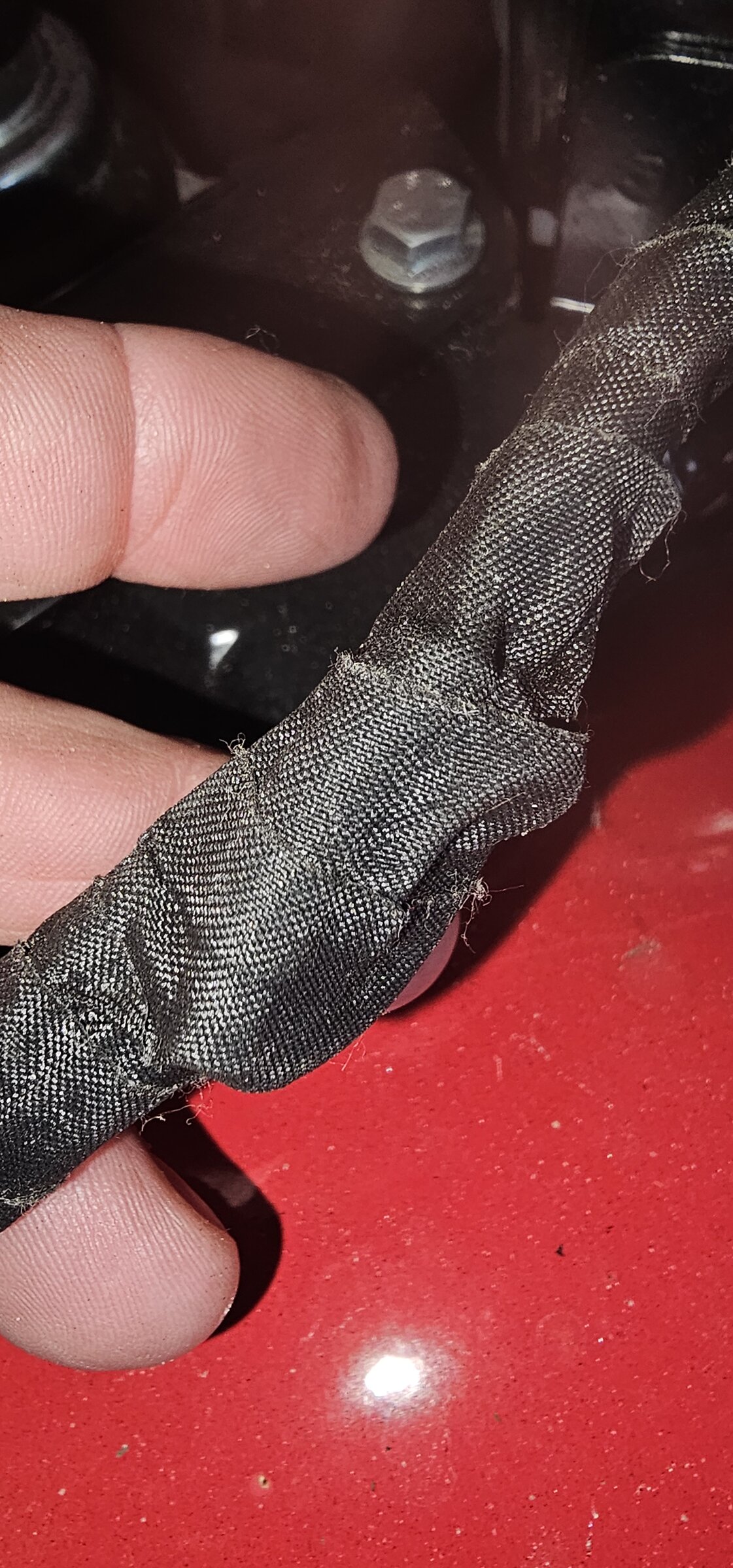

I do not see any connectors on either side. The harness on the right is smooth and doesn't appear to have anything tied back. However, on the left side, there are two bulges under the tape in the area you are interested in. I cut one open and found 3 wires to be cut and terminated with heatshrink and a splice on another wire that loops back towards the other bulge.

I'd like to see the schematic and symbol for cut wires and heatshrink all three together. I left it open to see if their is power or ground on them. One large Blue/yellow 14ga? One Blue/ yellow 18ga and the last Blue/ yellow 22ga. Blue/yellow is used for grounds in other places .
I don't have a problem opening up a harness. I'll put it back a bit better with caps on the wires instead of heatshrink
