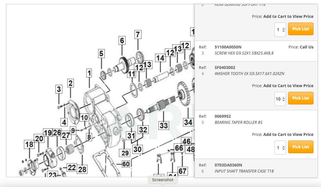

Roxor did the upgrade with the support bearing in that cover that the old Willy's doesn't have, so unless I am wrong, it is not the same. I know the PTO can't be done for sure. Numerous guys have looked into it. Some guys were even working on machine the parts needed and nothing has shown up yet.
Let us know how it goes.
Parts Catalog|ROXOR Offroad
Part number 5:
