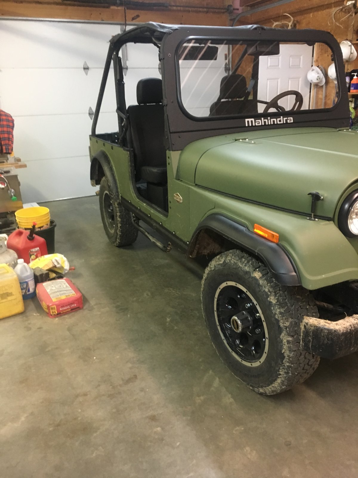

-The step portion of the slider is completely vertical to the rest of the slider and Roxor body. I was expecting the step portion to angle out to some degree like all other side steps I've seen and used. I either did not notice this or could not tell in the photos I looked at online. The issue with this is that it is very difficult to get your foot into the step portion essentially eliminating the functionality as a step. This issue is amplified when wearing any type of mud or other work boots with larger toe pockets. It is less an issue wearing street or tennis type shoes, however, usually when we are using the Roxor were wearing bulky work or mud boots.
Overall, this is a nice, well built product however, potential buyers should consider the step design as mentioned above if their primary use for these is as a step. Maybe the reason for the vertical versus angled step is to keep the width the same as the body. However, this would not be an issue for me since I have installed fender flares anyway. If I had noticed this issue prior to purchase/install, it would have been a deal breaker. I would have went with something more suited for my use as a step. Maybe On the Rox should consider adding an angled step as an option in the future.

Here’s a photo. The step would be much more functional if it kicked out instead of being straight down.
