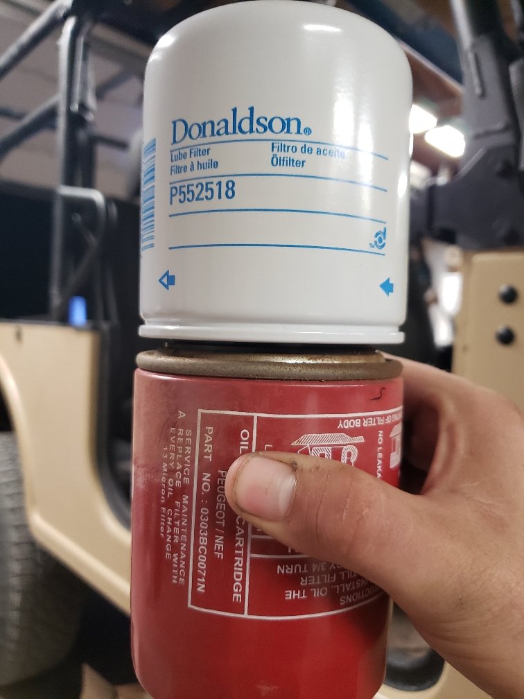

I cross referenced the Mahindra filter to find the part numbers listed in the OP. I have a Donaldson filter, the threads and size are the same as the Mahindra filter. Haven't installed it yet. The Donaldson filter crosses to the Wix/Napa Gold filter numbers.

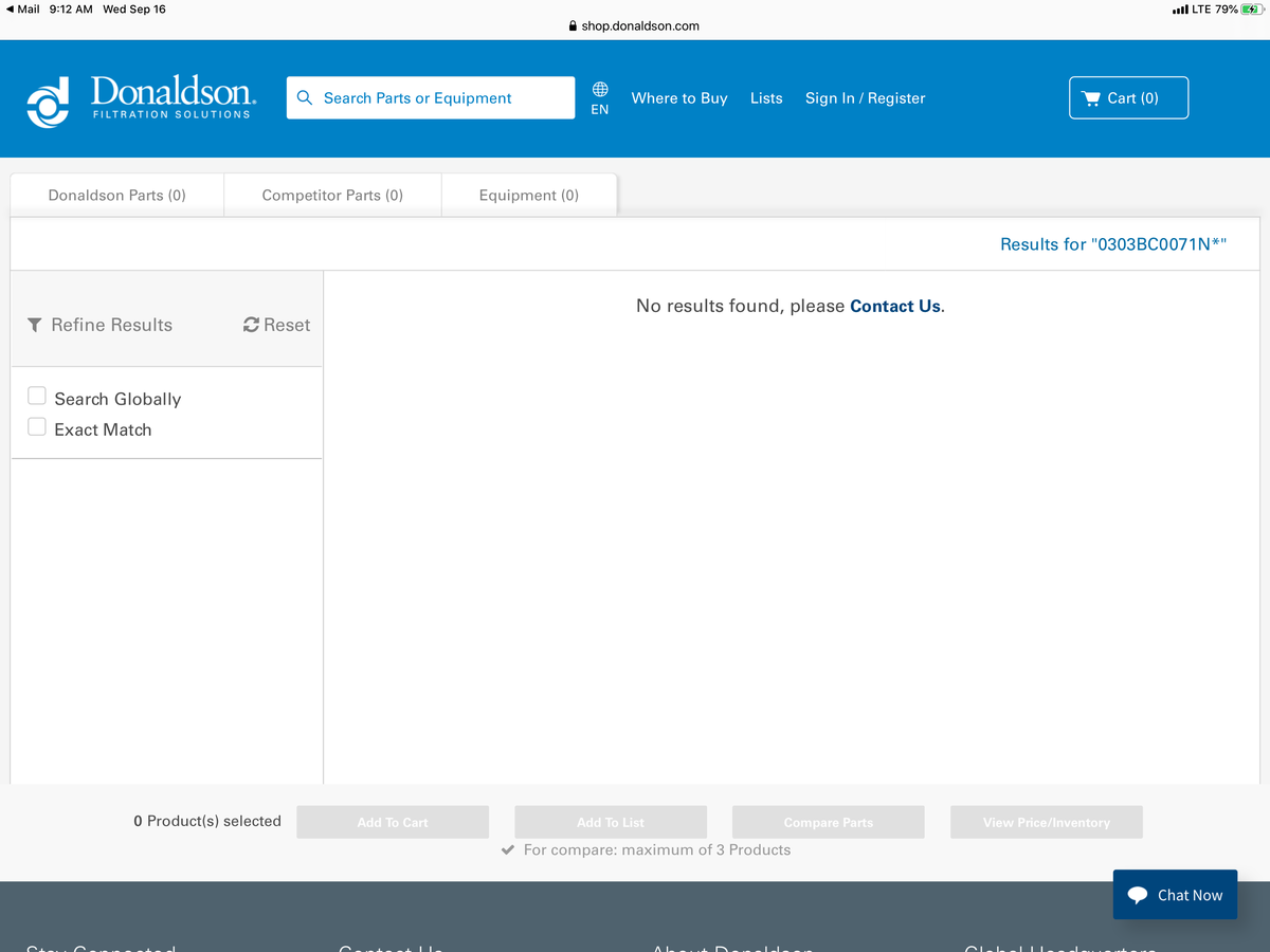

I can’t get a cross on Donaldson

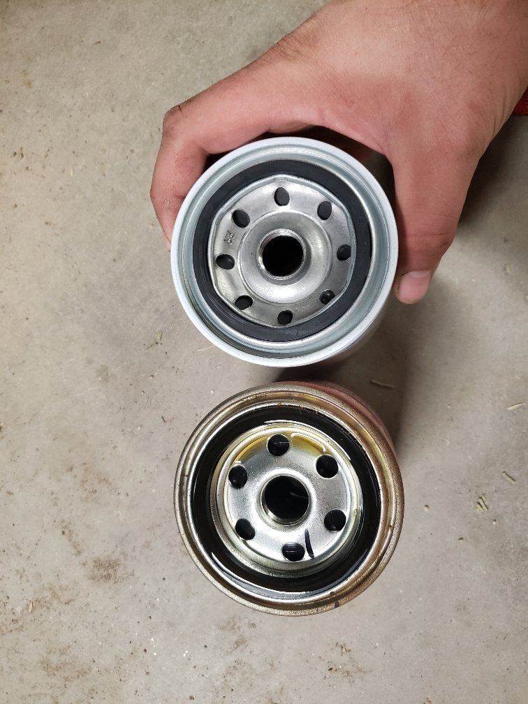

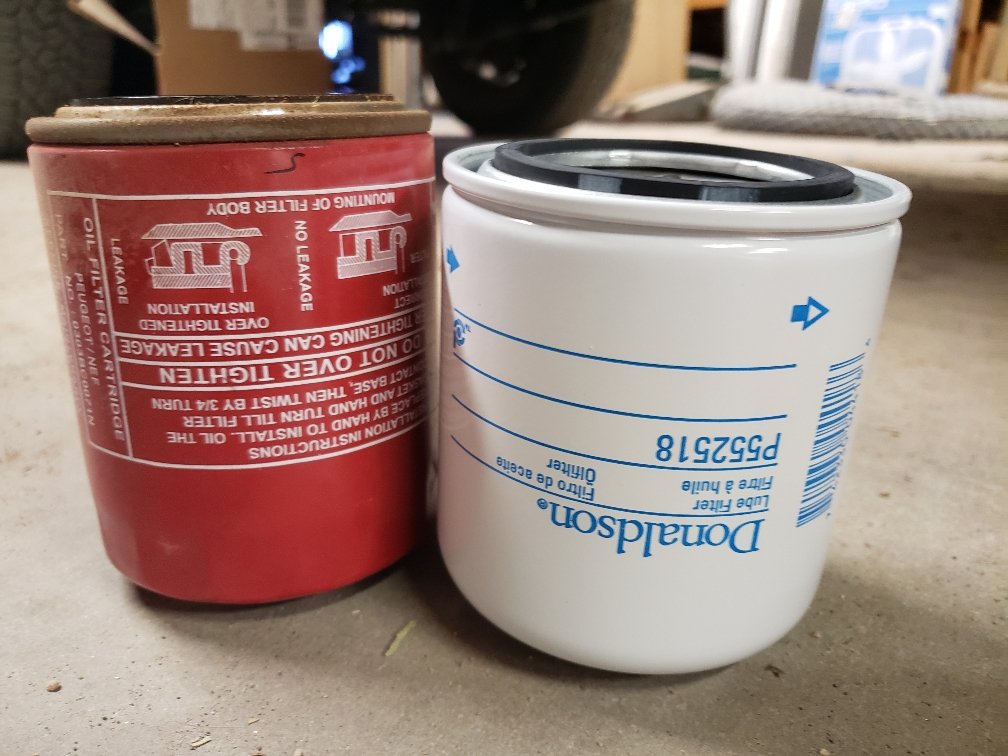

I just confirmed the Donaldson filter works. However, the filter thread face is inverted, and it bottoms out just as the O ring touches. So scratch that number.
Aviator- I found the filter the old fashioned way. Measuring the pitch and opening, as well as the filter diameter itself. Looks like I failed. I will update the PN's.
