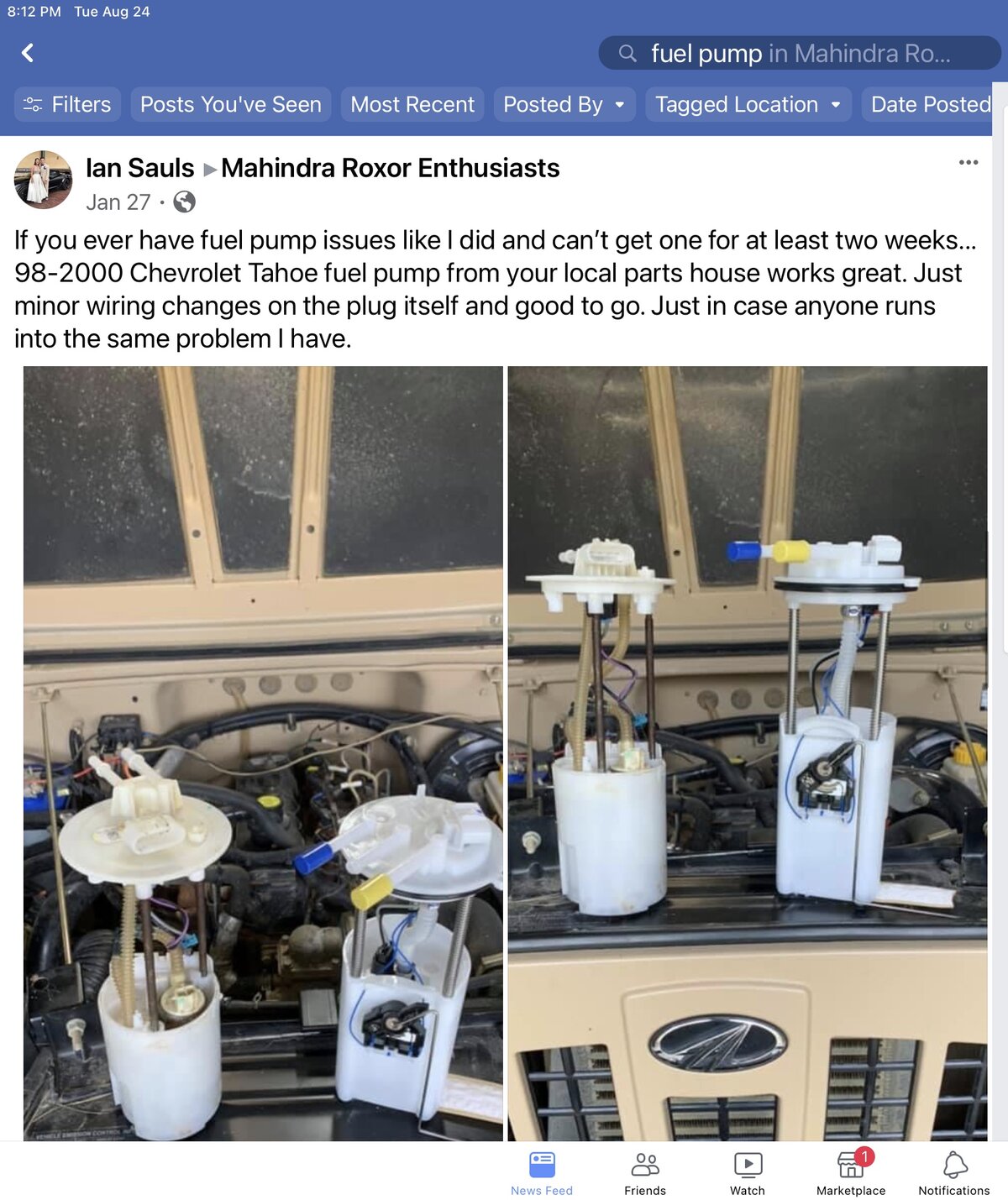

SOLD OUT! I guess a bunch of fuel pumps decided to crap out all at once... I'm going to see if one of my aftermarket diesel guys can help me out. Problem is that since I am going to sell it, I don't want to get too carried away.
1,203
Check with diesel freaks. They have lots of factory parts. If not then try this as a lost resort.
JoeJohn
Oct 24, 2022
6
Miami
Anybody know what wires need to be changed or should I just line the two units up and and match the pattern?
