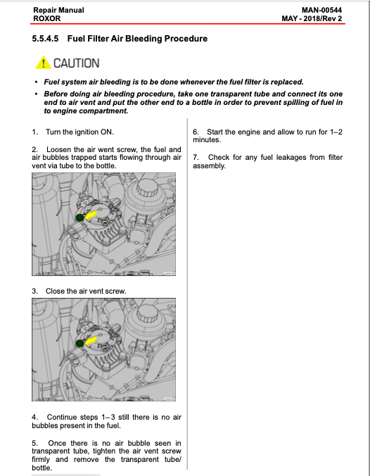

Isnt there a fuel purge valve you have to adjust after you change the fuel filter to get the air out of the lines?
1,305
I didn’t. Make sure the o ring is seated properly and lubricatsd. Screw filter on all the way. Then cycle the key a few times so the pump circulates fuel and purges any air before starting.

did you fill the fuel filter before putting it on? All diesels need need them filled so there is no air in the system. You may need to bleed the injectors by cracking them a bit, turn the engine over until you see them leak and retighten. Should fire right up.

He drove it for 15 minutes after changing the filter. The CR pump self bleeds air.

Sorry for not updating, new member and couldn't remember my login. It's back up and running now. Bled the injectors but it still didn't work. Got to the Bosch fuel injection pump between the fuel filter and fuel rail and heard what sounded like a vacuum leak. Squeezed the line while it primed and heard the noise go away. Turned the key and it fired up. Weird. Probably had a little air bubble still in the line. Anyways, thanks for all the advice, so glad I didn't have to take it in anywhere.
