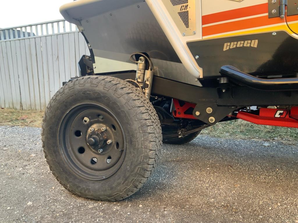

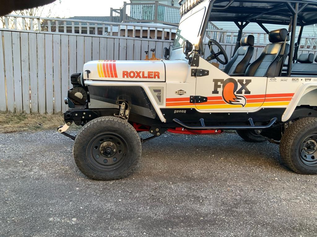

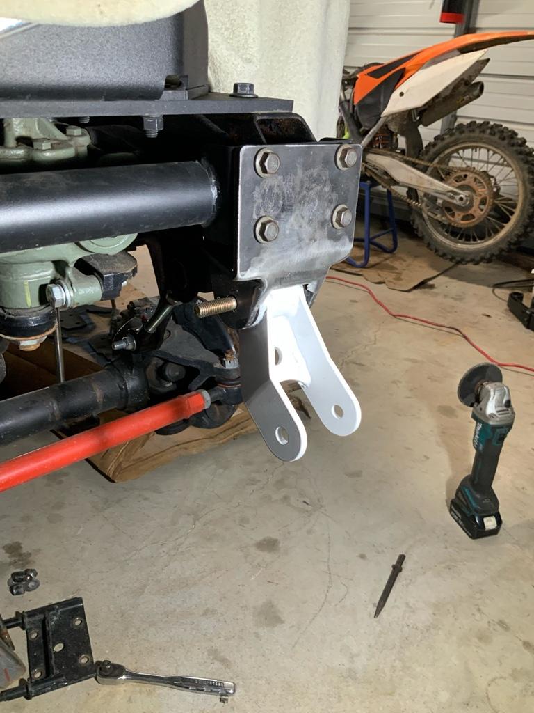

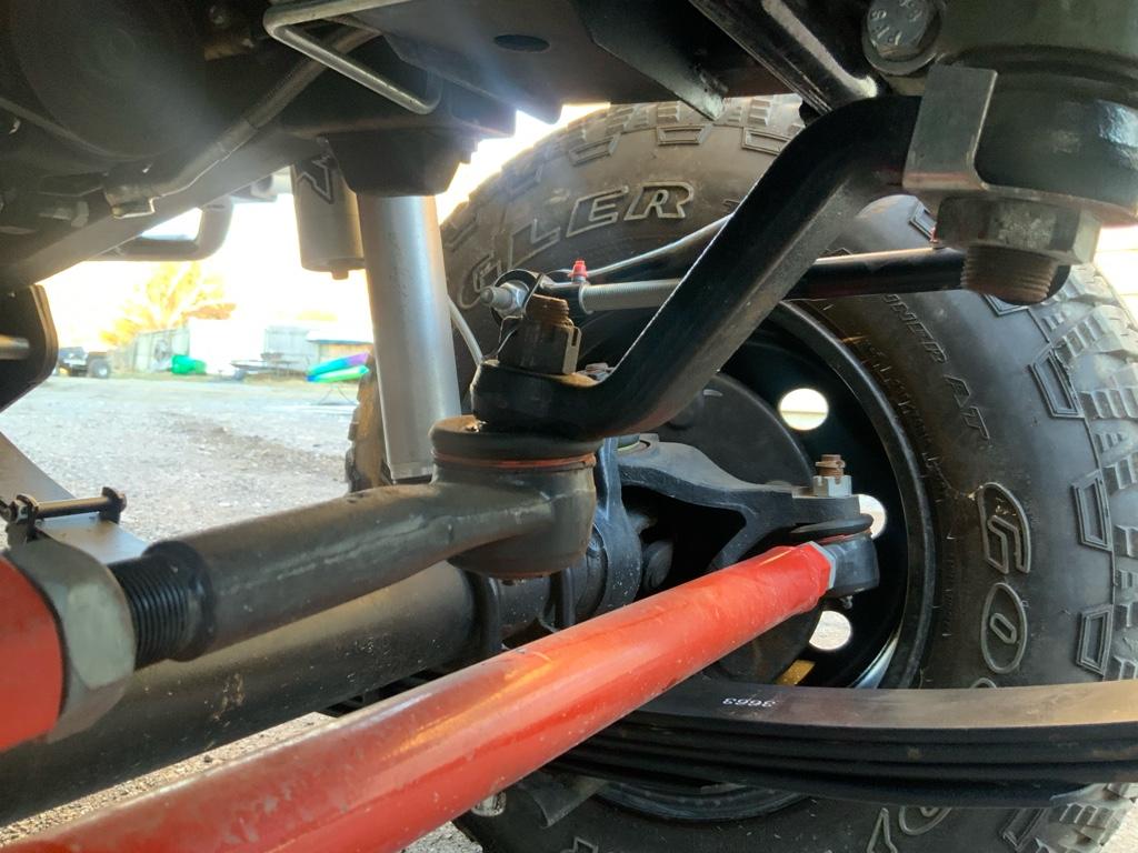

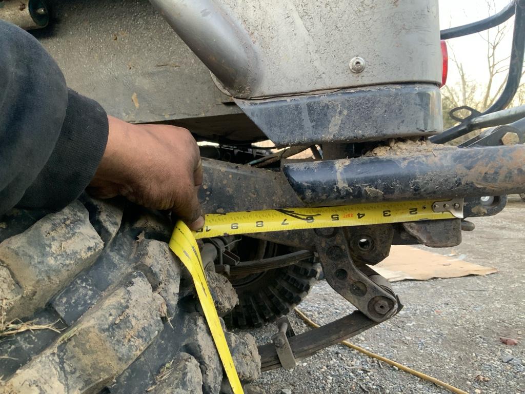

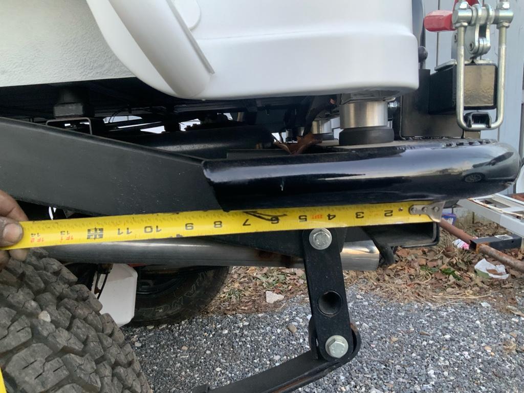

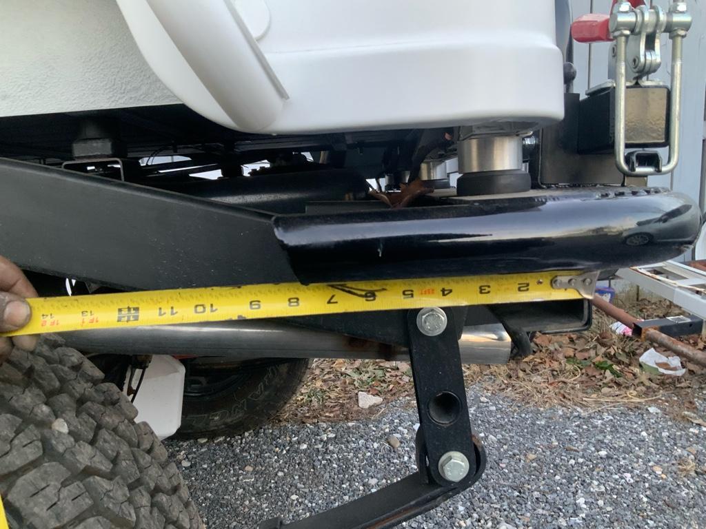

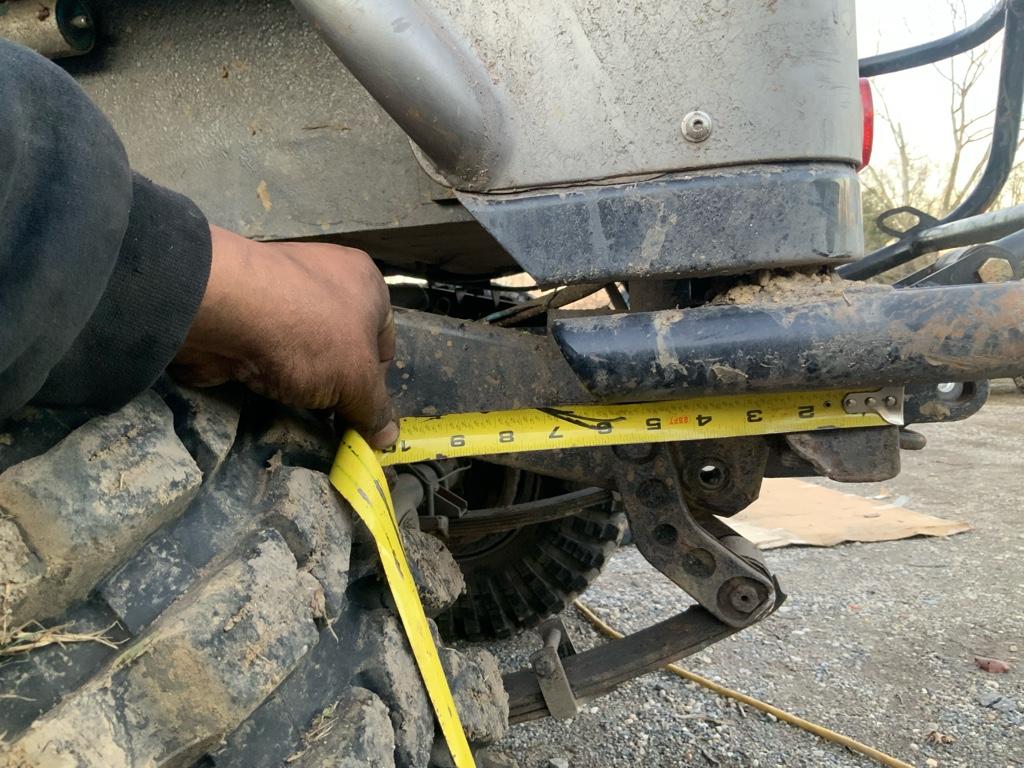

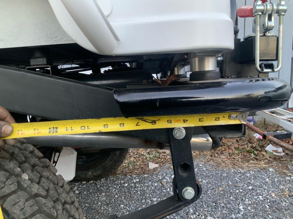

The aftermarket drop pitman arm is definitely going to be an issue on this one. I need to put a stock arm back on so it doesn’t hit the tie rod.

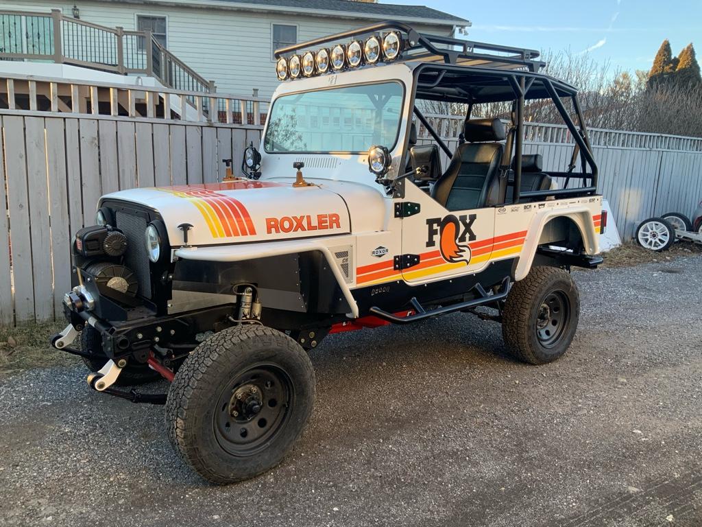

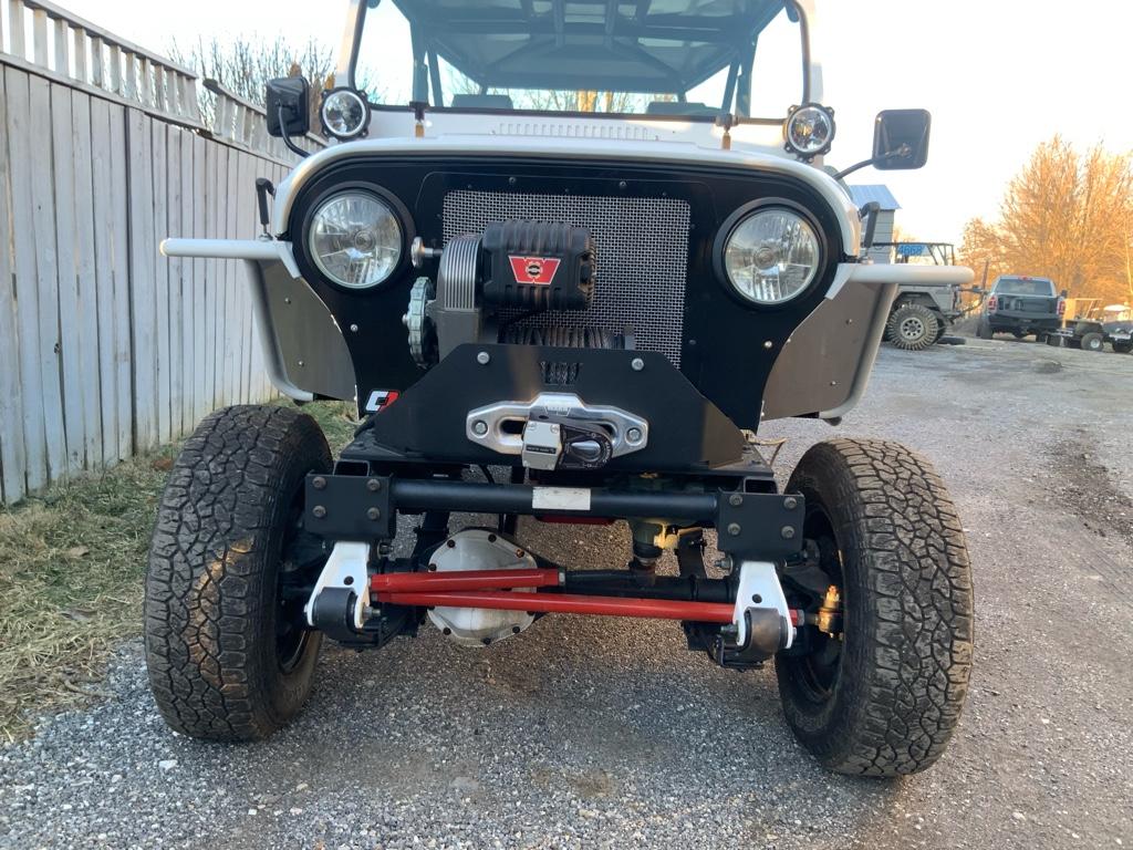

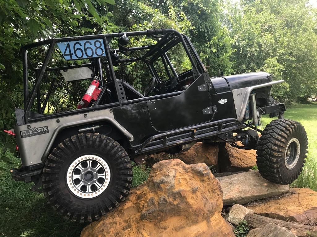

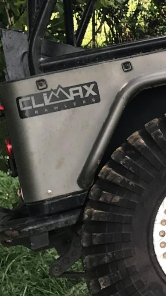

The owner wants to run a 37 or 40 and I’m a little worried about the aftermarket fenders rick just built on the Roxler. I had to do a little cutting on mine with 35s so nothing would rub at full flex.

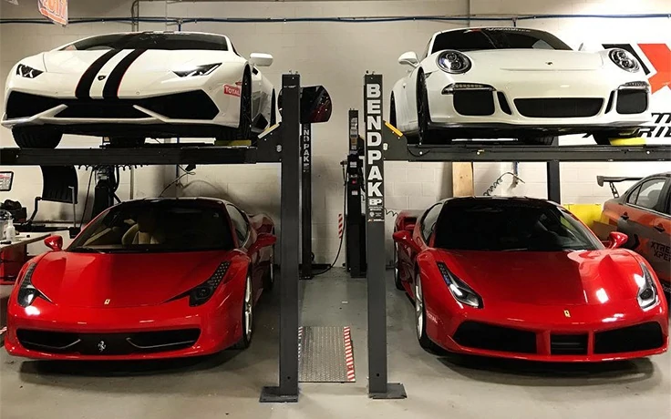

My buddies has 4 posts and you may think it gets in the way but it does not. His also has 2 steel sliders that you can slide the length of the lift or remove them. They are great for placing a bottle jack on to lift one end of a car for say if you need to be under it and spin an axle but have the rest on like they are on the ground. Its very stable and no worries if your yanking and push or pulling on the vehicle. It wont fall off the lift. Also like when I am thrashing around inside the Mustang trying to get in with the car up say 2 or 3 feet in the air, I can do it and not worry if the car is going to fall over or off the lift. Ill try and a attach a pic. Oh and you can park a car under the lift with one on the lift, double stack the parking.
This one says its $3700.00. Id buy one if I had a place that was flat to put it. Even if it was outside, but my driveway slops. Oh and his came with giant steel casters if desired. I think his is an 8000 lb lift.

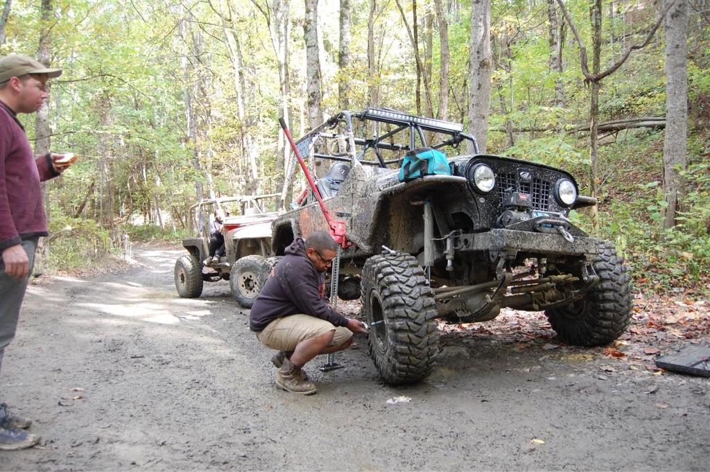

99% of the work I do is on suspension so 4 post lifts don’t work for me. I max out a highlift just to lift a wheel enough to change a tire.
I need easy access for pulling axles off. Room to move around and weld. 2 post lift is ideal if I had more room. Those single post lifts are awesome. Stability isn’t an issue at all and I can’t fit anything in my shop big enough to weigh more then 6k lbs.

As far as your jack not having enough lift for a flat, My buddy carries a freaking lumber yard of 6 and 12 inch blocks of wood whenever he goes out playing or just working around his shop. Lol. a Mini Paul Bunion! Lol. His saying is, Why Jack it when you can stack it! Lolol.

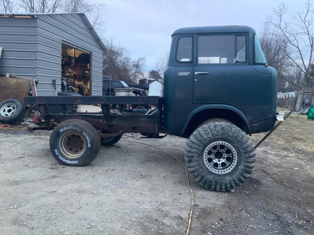

Still deciding how I want to go about this. Part of me wants to keep it fairly un molested but them 35s are saying something different.

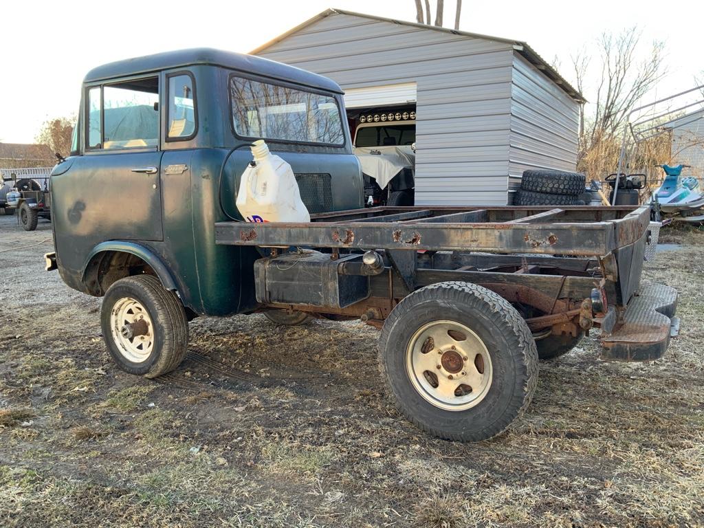

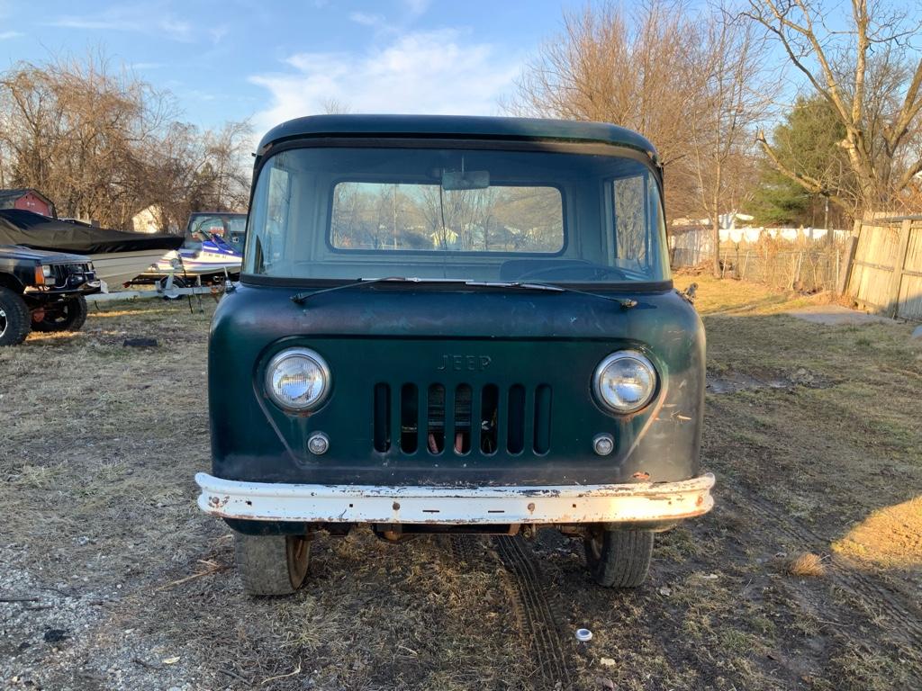

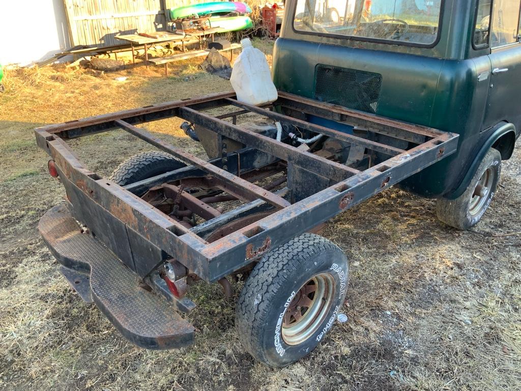

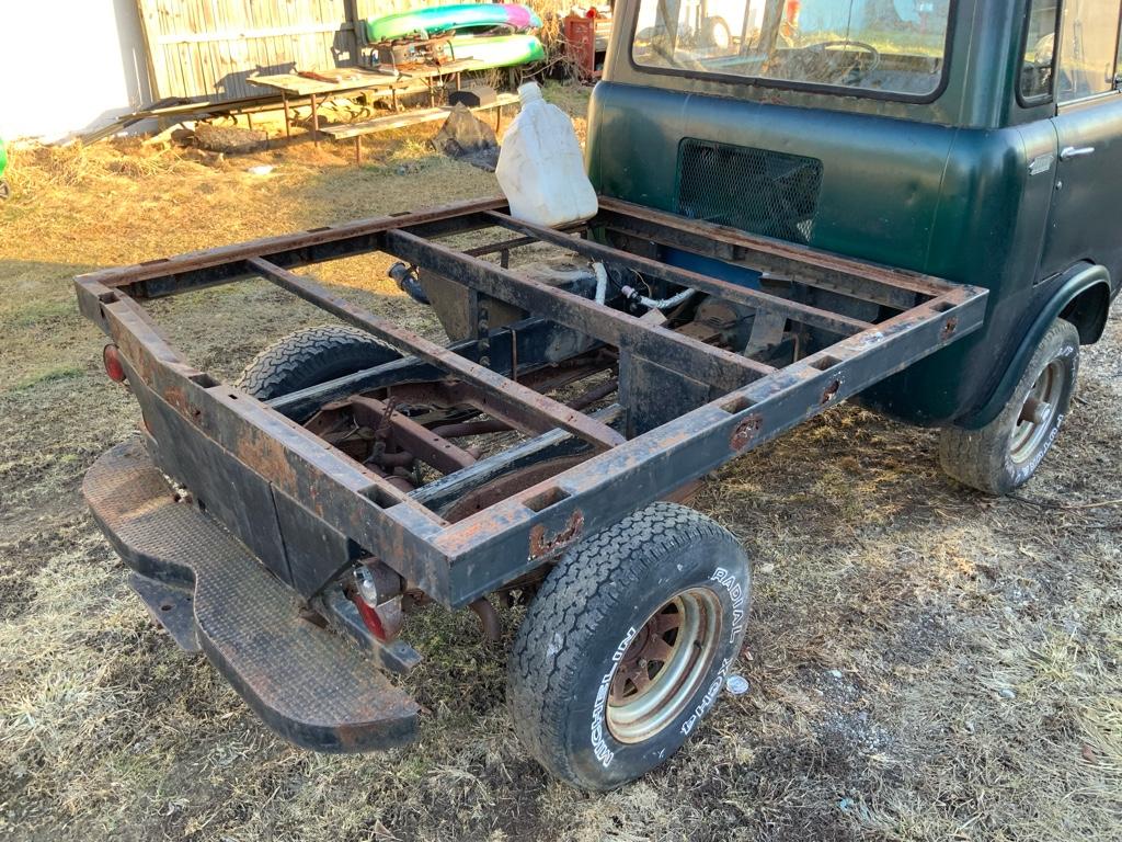

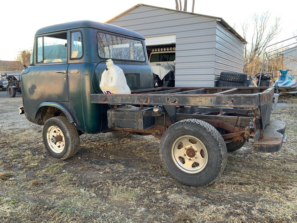

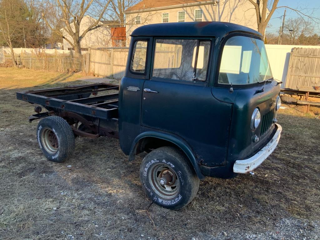

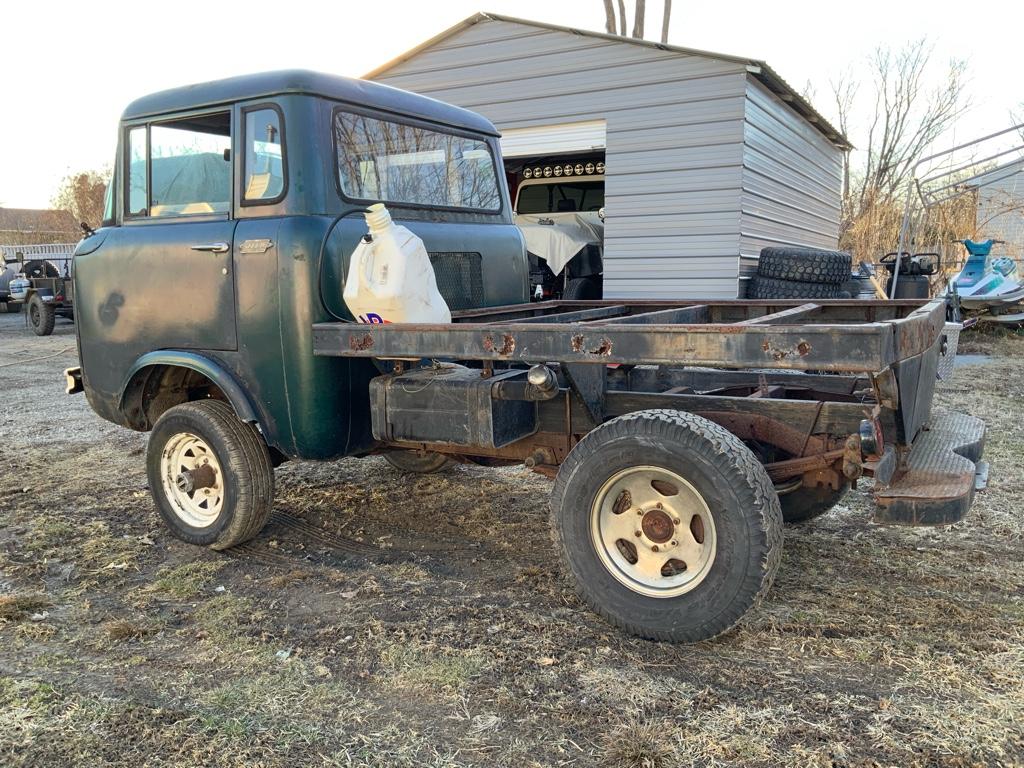

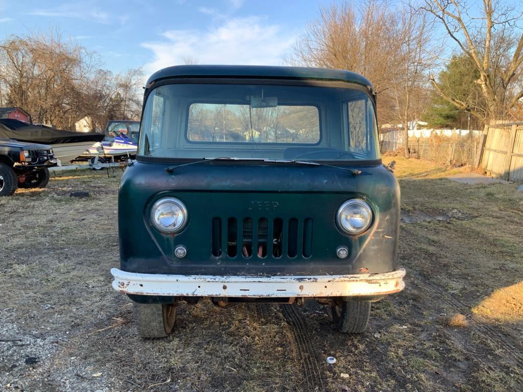

Fun fact: Mahindra made “Jeep” FCs up until the 90s. I didn’t realize that until some of my Fans from India pointed it out. Pretty cool. I’d love to just plop this body over a Mahindra chassis.
Watch the auto salvage auctions. Seen some wrecked ones up for sale. Watched one sale twice in Arizona. I suspect it didn’t meet reserve first time. Can’t remember what it sold for second time but it was in the 5-6k range I think. And it was a hard front end collision with a possible bent frame from the looks of the pics. Theres a rolled one in Oklahoma City that looks to be an easy fix but it hasn’t been released for sale yet. Been that way for over 6 months now. But from what I’ve seen 5-6k is the bottom dollar on these regardless of conditions.
