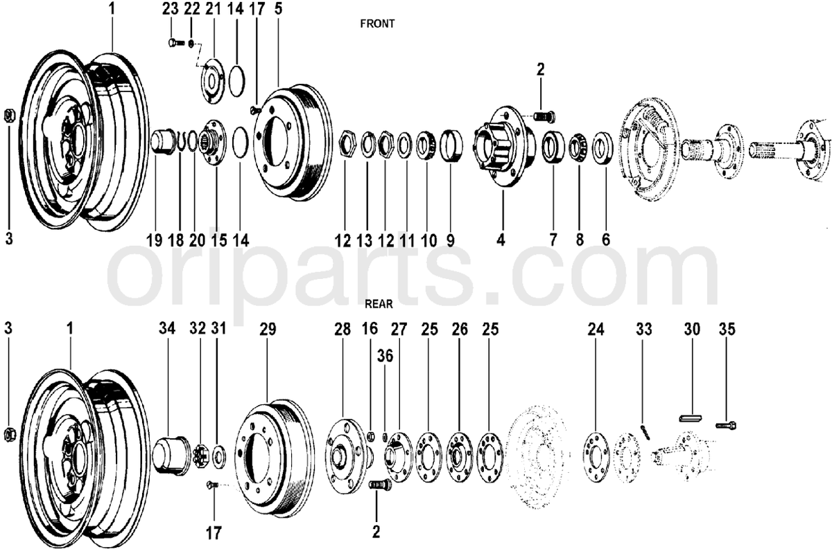

So I installed a set of Mile marker hubs on a budget. Was there any steps prior to install where you disengage the wheel so when hubs are installed they are free and open. Reason i ask is i briefly put into 4x4 and had 4x4 without locking them in.
Do you know the part# for the MM hubs ?
GiStore
Jan 16, 2023
141
India
Thar Owner
Check part # 0079860 No 4 in diagram
Let me know if you need one i can arrange,Hope that helps.
