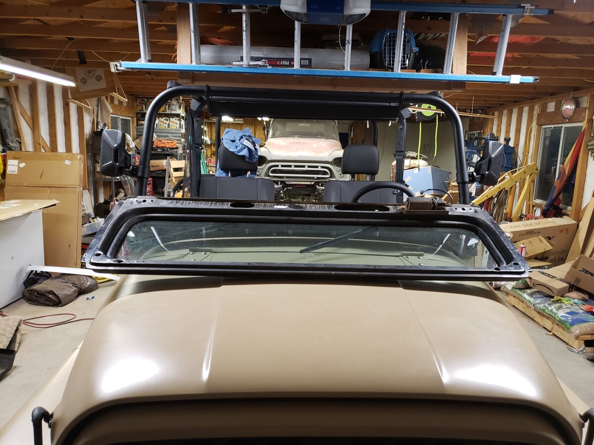

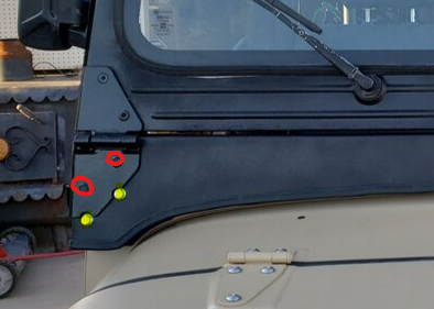

I picked up a YJ windshield last weekend from a part out. Got it home, took off the lexan windshield and installed the jeep windshield/frame. Yes, it bolts right up, but only after removing the forward ROPS. Not going to work, especially if you're tall.
After clamping the jeep windshield onto the OE ROPS, I took some measurements:

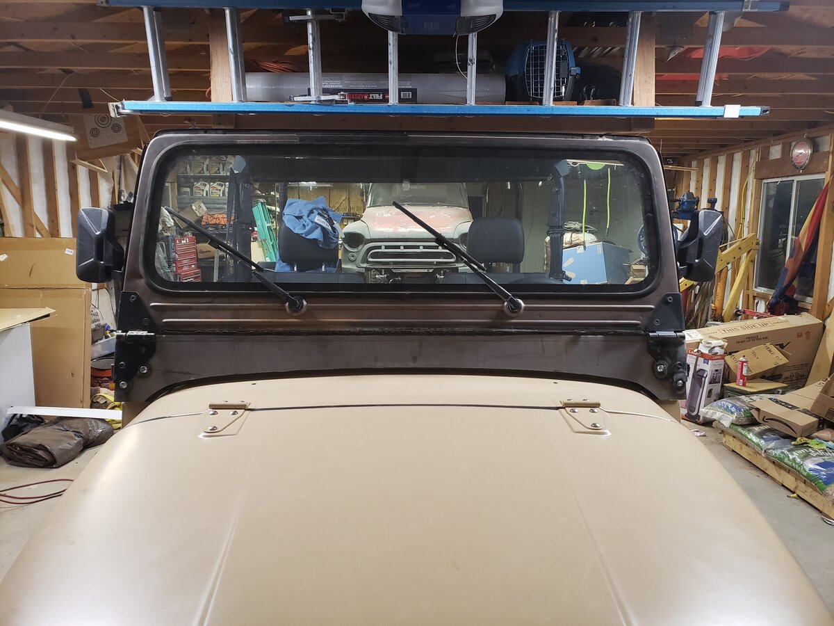

To mount the YJ windshield frame, and still utilize the OE ROPS, the windshield needs to be moved forward 2", and up about 2". I went to the steel yard and got a 9"x63" piece of 1/8" steel, and had it bent 90*. Hindsight, I should have had it bent to 70*, but with a new cowl seal, it should be OK.
I used the Mahindra windshield cowl plate as a template to mark and cut the curve for the cowl, and drill my holes. The holes are elongated, so I used some 1/4x3/4 steel tubing cut to 2" to make some standoffs. Bolted it all in place, and this is what I have so far.

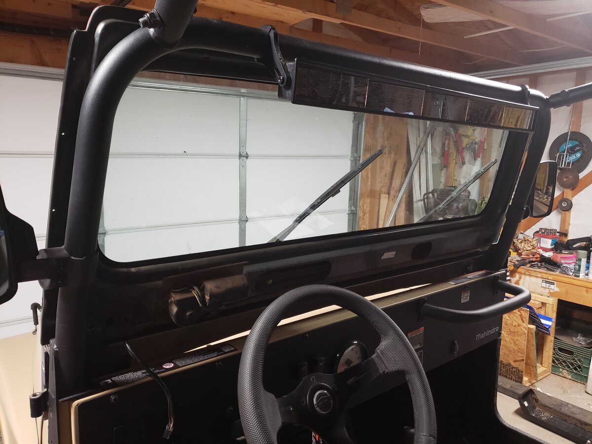

Attached is a picture of the windshield bolted right up to the OE ROPS mounting holes.

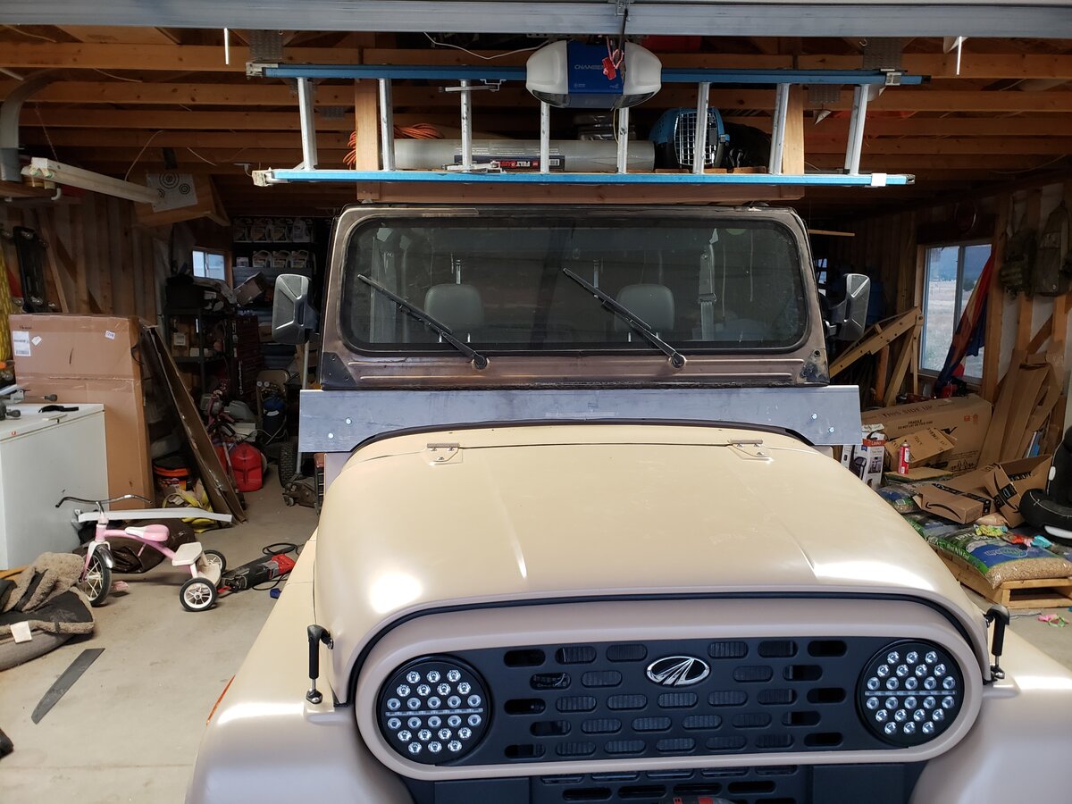

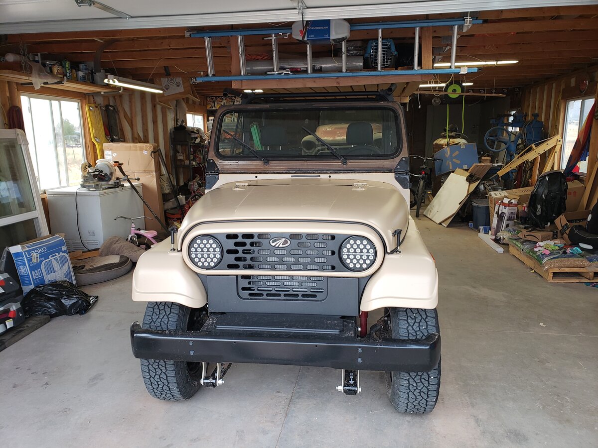

Tonight I will weld the standoffs on, cut and bend the excess steel to wrap around and bolt into the sides where the net brackets bolt into. I also have some edge trim on the way in the mail, should be here Friday. Hoping to have this thing wrapped up by Friday evening.
724

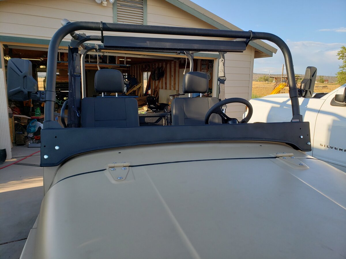

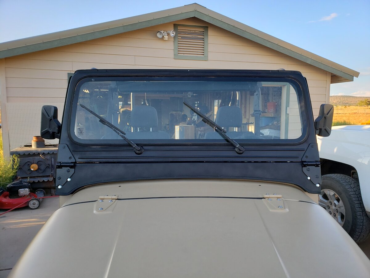

Almost done. Bolted down, it folds, it Almost looks factory. Finish weld the side plates tomorrow, then paint.
