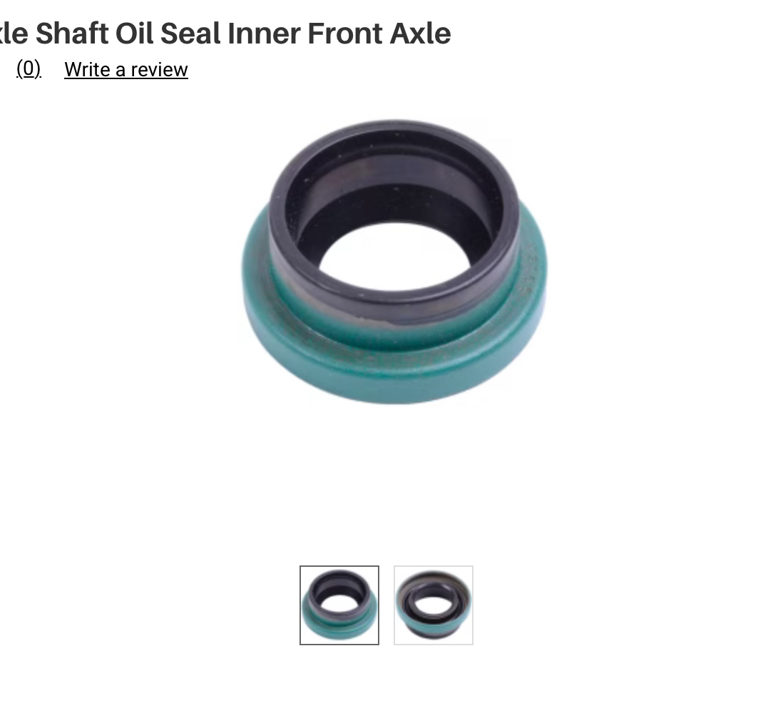

I'm feeling your hardship being Canadian and trying to obtain parts. I know this is still American, but would this seal be the one you need?
QU15120 Roxor Front Axle Shaft Seal

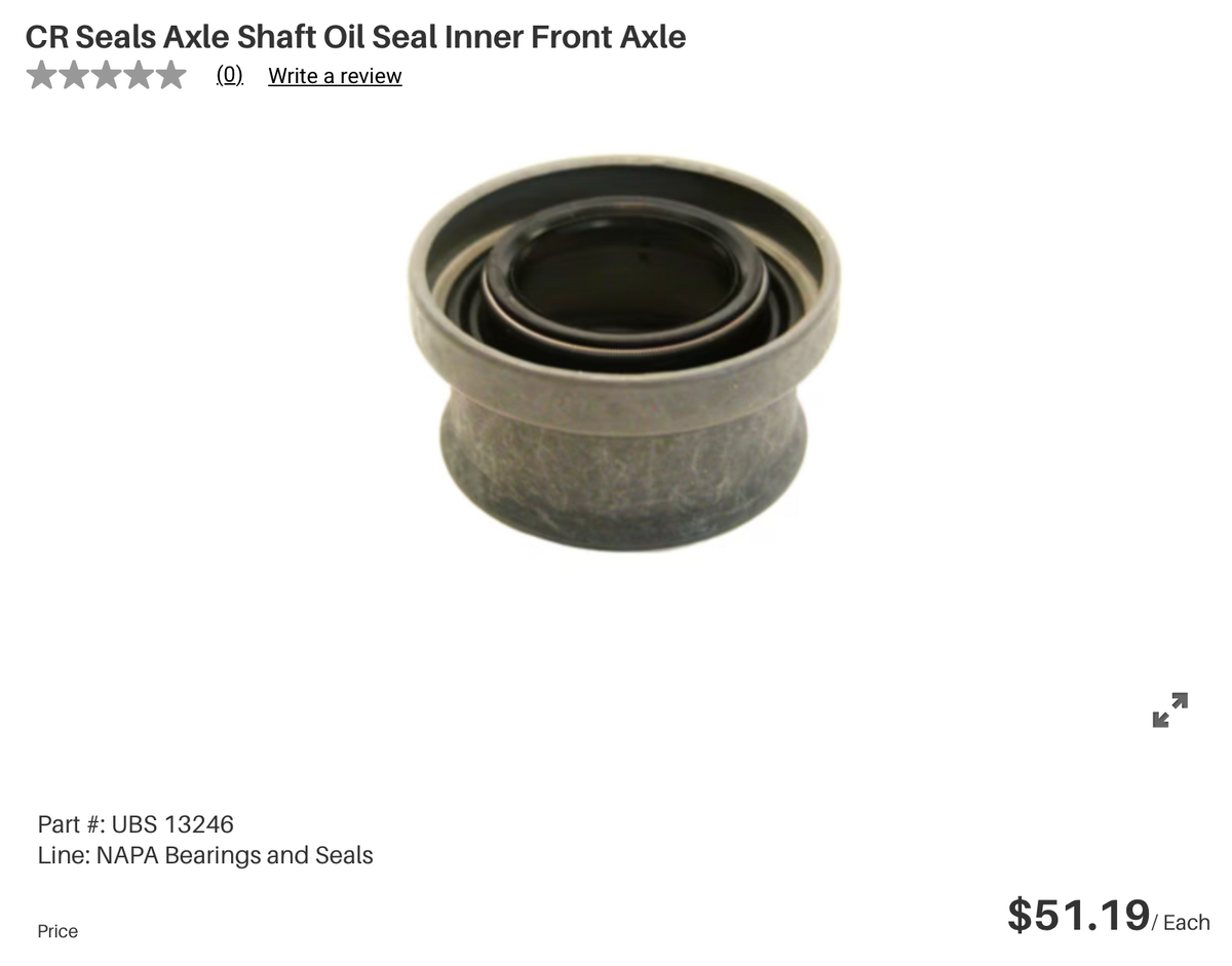

Napa here has the following that may work as it has the same dimensions. it's from 78 Bronco

I actually did but got no help from them. They don't do it by sizes only part #. I did find one myself after spending hours online , a 1978 bronco had the same inner and outer dimensions but my mechanic tells me it was too wide. I'm just totally frustrated with Mahindra. If I lived in the US , there likely is no problem in getting it but with no warehouse inCanada it's a nightmare. And no i do not want Canada to be the 51st state.
See if they have a National Seal part #481837, or equivelent, and match that up with what you have. Worth a shot!
