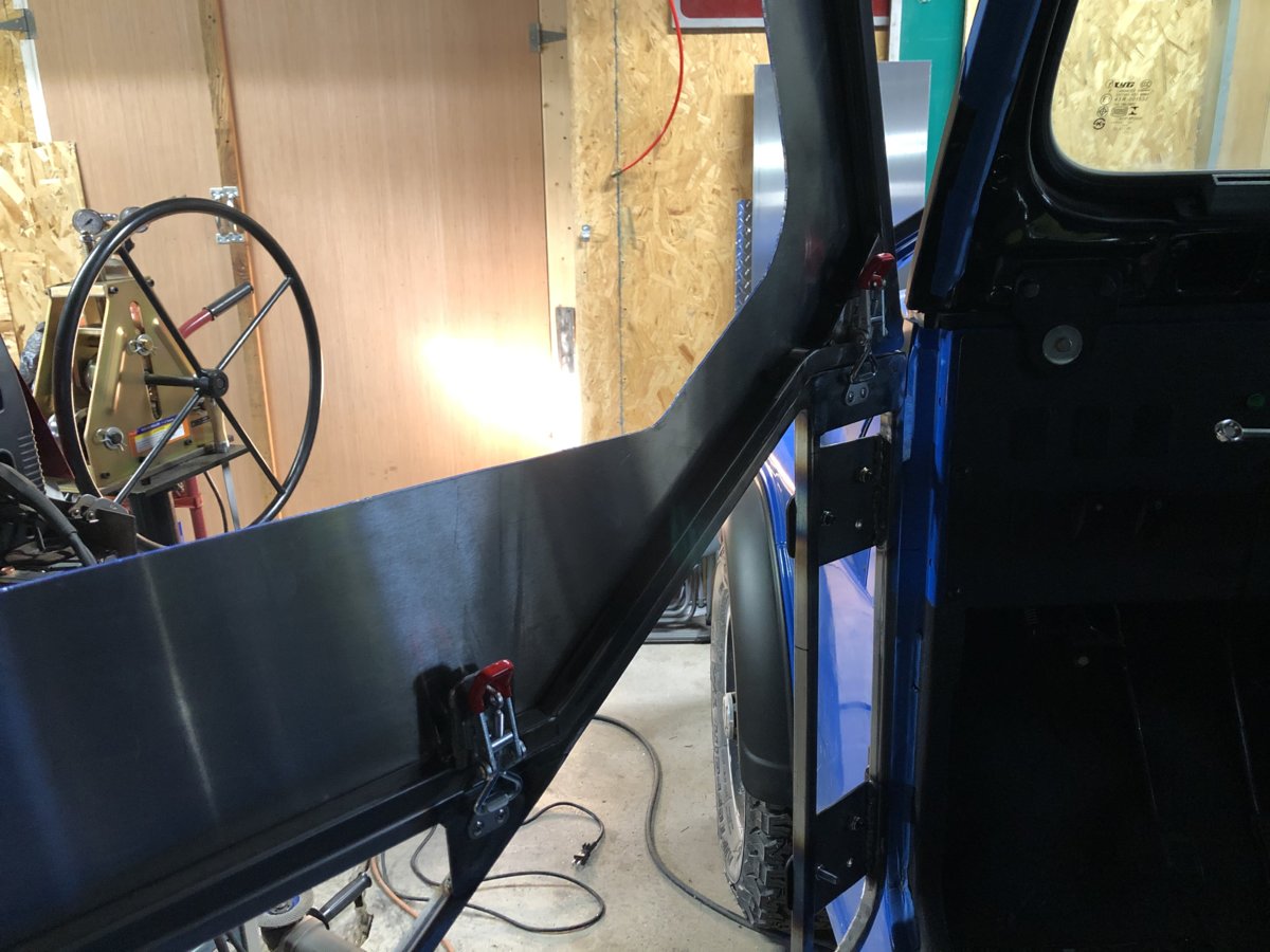

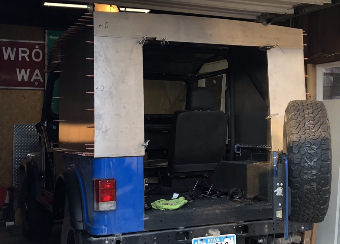

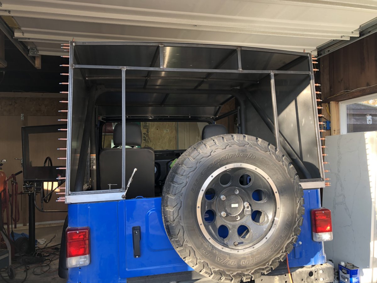

I’ll be using a pair of RV windows on the sides in back, the doors will have sliding half windows, in the back I will put a fixed window in the tailgate.
Made a good bit of progress today on the doors, there are 3-1/4” pins to maintain alignment and 2 toggle clamps hold the halves together, it’s looking to be working out very well, very solid.

Have you considered the mating of the upper door removable section , off set extrusion , flush mount weather strip. Formed aluminum curved set....... ideal would seem to me an overlap of upper door section.

It was considered, the proper extrusion and labor got me going the direction I went.
I’ll have a flat seal between the halves bonded to the upper panel, thin and firm for stability. They mesh up pretty well and there is very little gap.

Those doors are looking great. I would love to have a set like this for the winter months. Keep posting pics!

Haven’t given up yet, it’s been a slow process but I’m gaining on it. All the windows are ordered and getting cut. Pleased with how it’s all coming together.

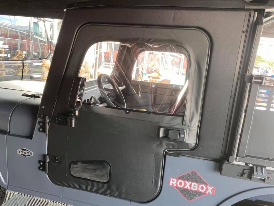

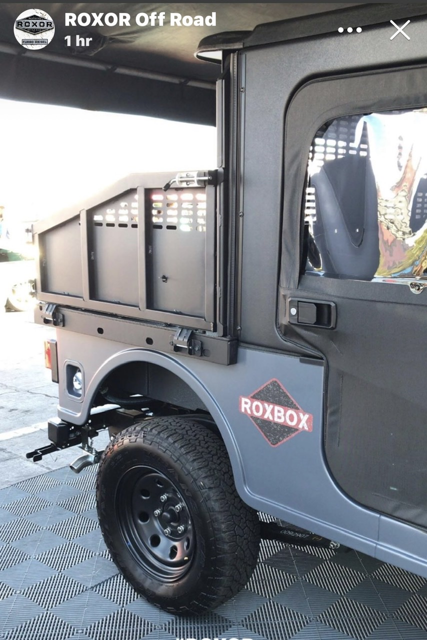

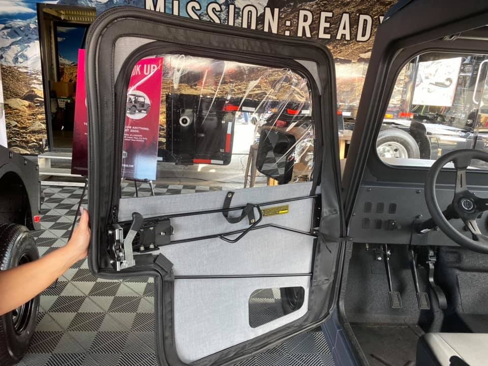

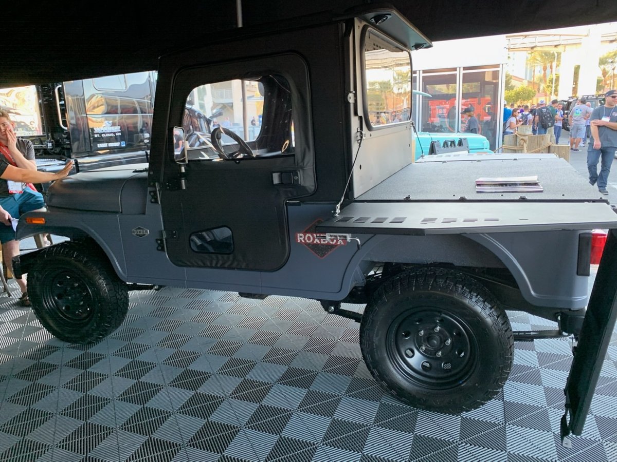

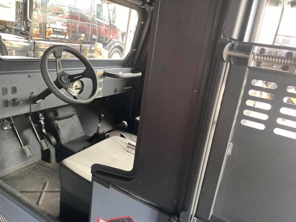

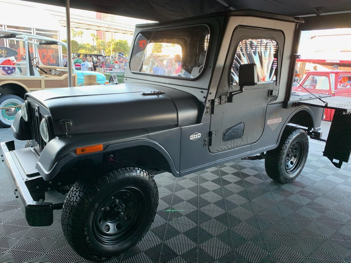

These pics came out of SEMA. I don’t know if it will come to fruition, but this is the OEM windshield and roof.
A3EC0C79-DDDB-402F-960F-6D5446F0422F.jpeg4E027AEE-59CA-4134-9B6E-EDDA82EDC77B.jpegD6A95E7E-80C7-408E-8D70-CE02BFDC77D0.jpegC1B4A912-36BA-416B-A7D1-27335EE2FEE9.jpeg9CE0E802-C789-4F87-A555-CA356D5119F2.jpeg0E7BA8A8-796E-4648-804D-F0A47E3F8773.jpeg
