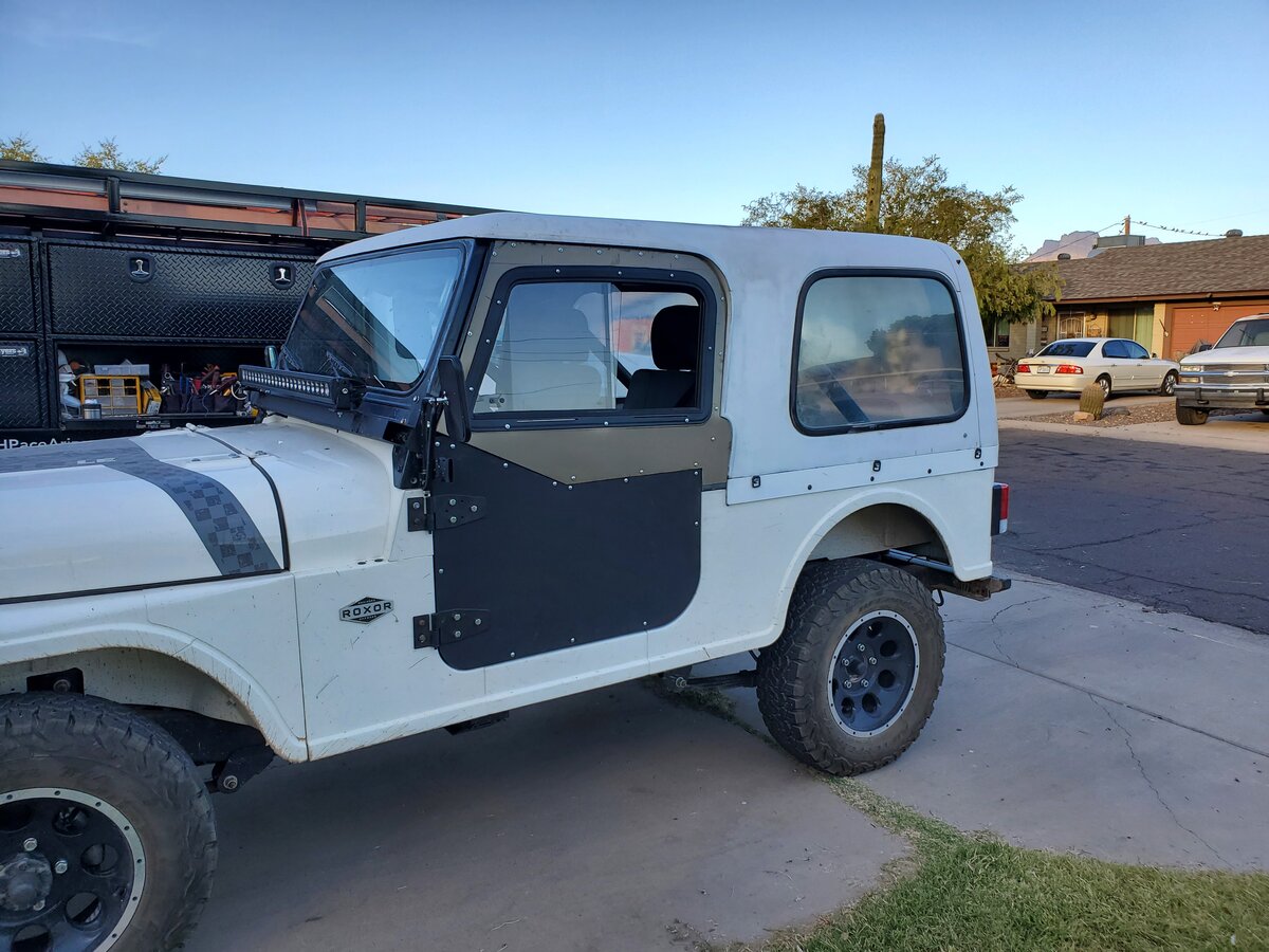

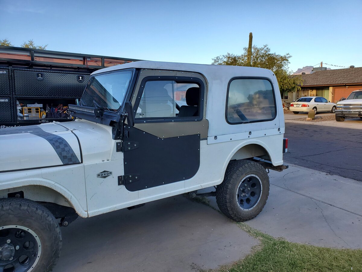

If I did it again I would split it like that easier to keep it square. I haven't got to the rear hatch yet but don't see it to be that difficult. Figured I would extend the lip on the gate with some weather seal and a little metal shaping.
How are the bars attached to the windshield that run from the main hoop? Can you take some picture of the roll bar specifically? I really like this setup.... does anyone know if this top will work with a yj windshield?
T66coupe
Sep 8, 2018
11
Apache Junction, AZ, USA
1586
The bars attach just like a factory yj and yes yj widshield frame will fit. you can use all the same parts I used from a cj or a yj. I set my cj7 roll bar in the roxor and took a little of the main hoop at a time until it fit

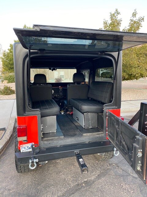

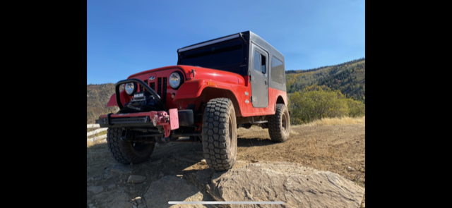

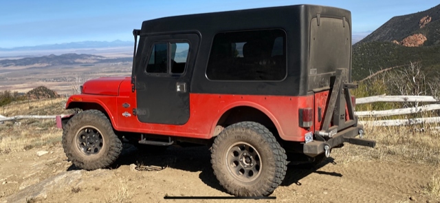

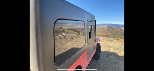

Here is the top I just purchased from Rallytops with a few pictures. This is the first one that they made and the fit is awesome.

The price was $3,195 and did not include the windshield, but does include both doors
Looks good.
What windshield are you using? And I assume you had to drill holes to mount the top.

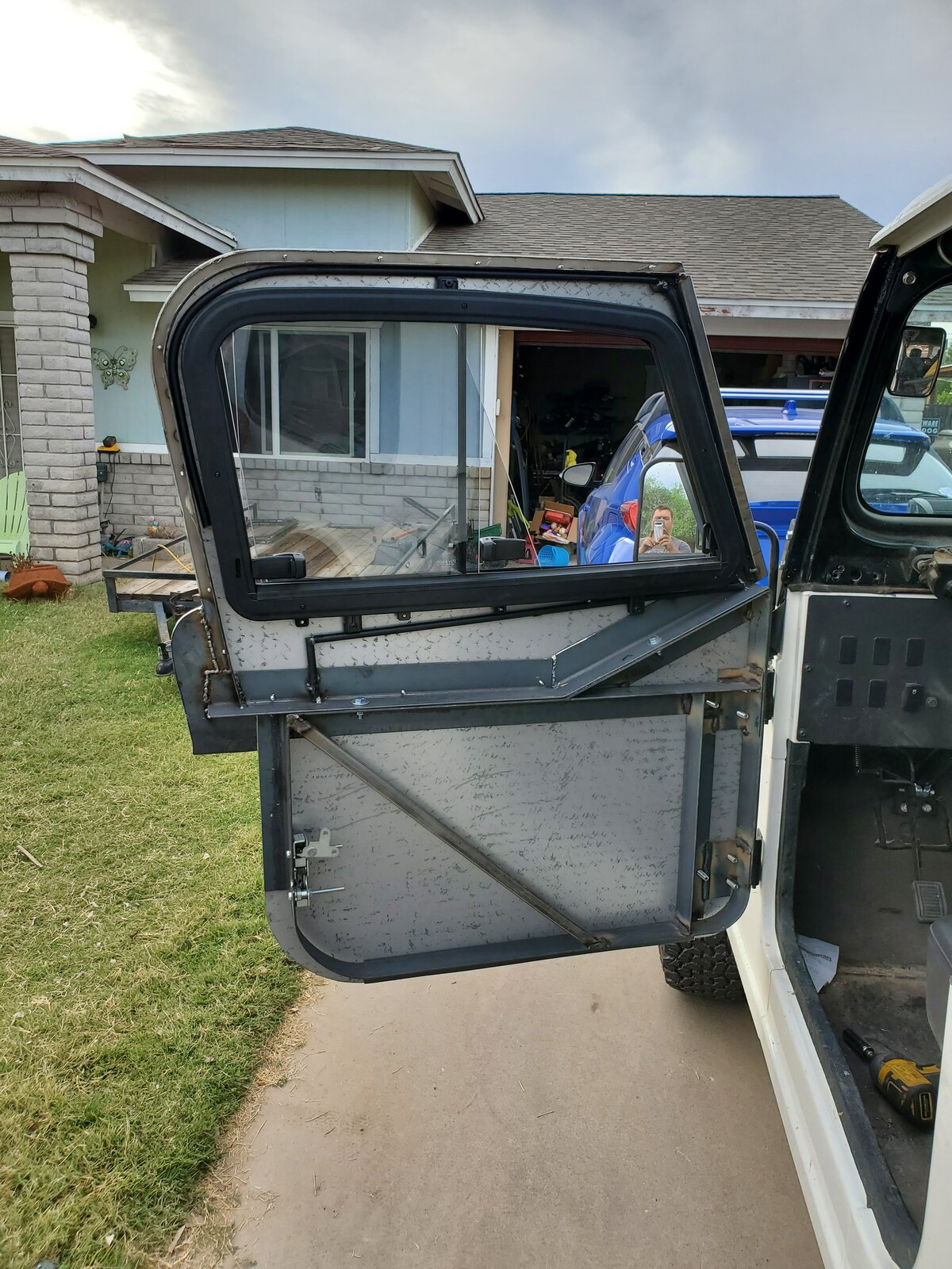

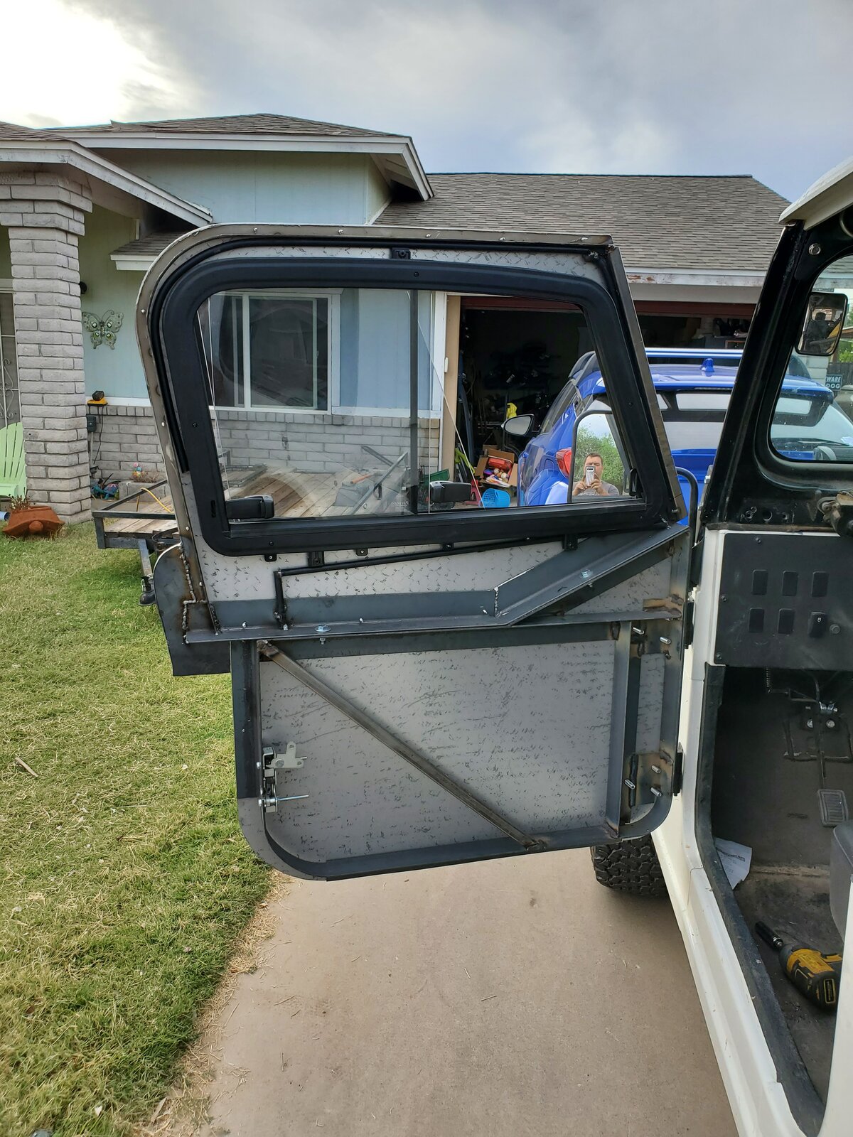

I picked up a used set of tj uppers and used the sliders and frames
The tj uppers will fit and the seal alright you have t shim the lower windshield mounts a quarter inch to get the right angle for the front seals on the uppers I live in the desert so we tend to tear soft stuff up easy that's why I skinned them in sheet metal
