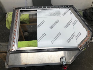

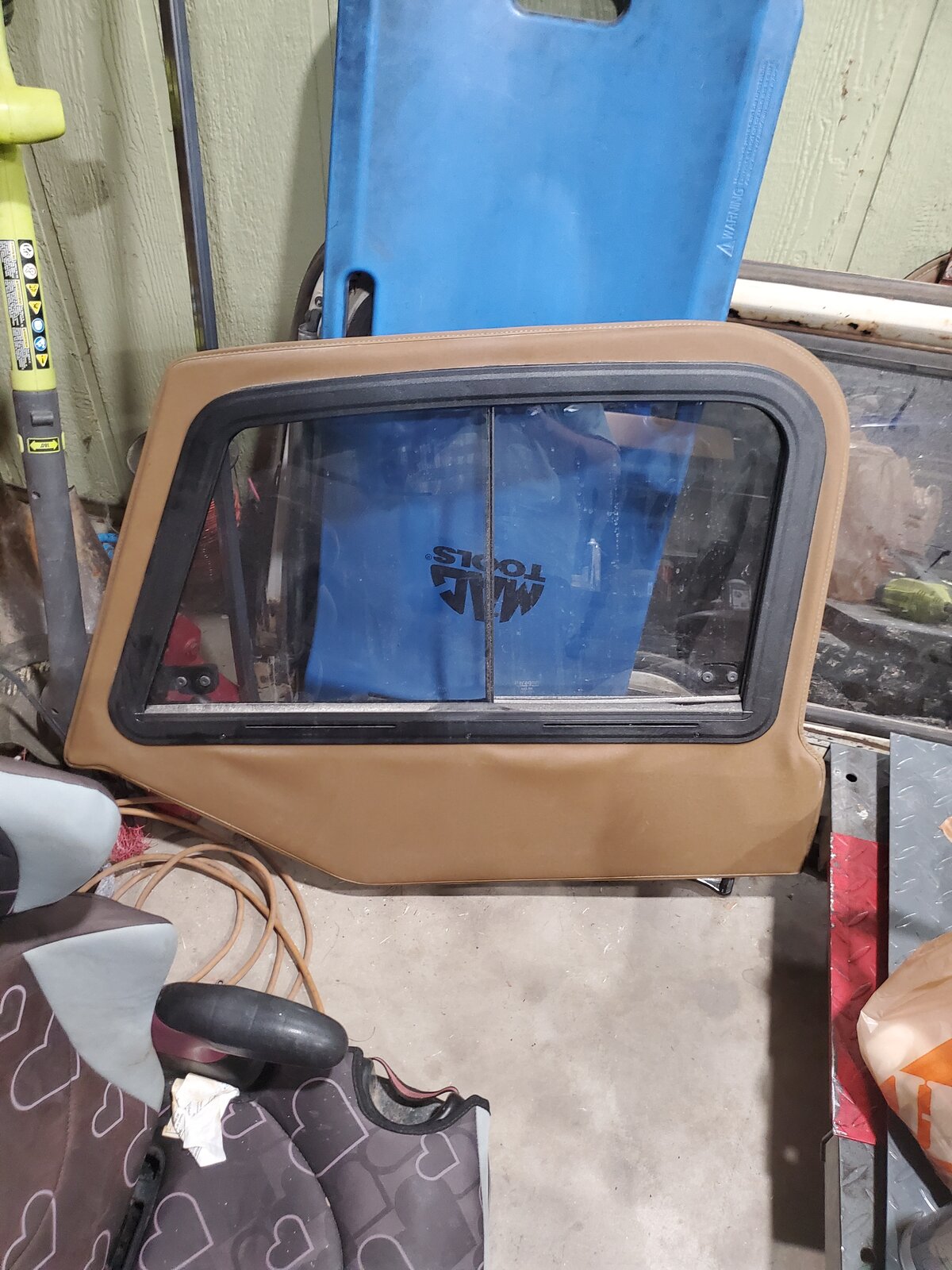

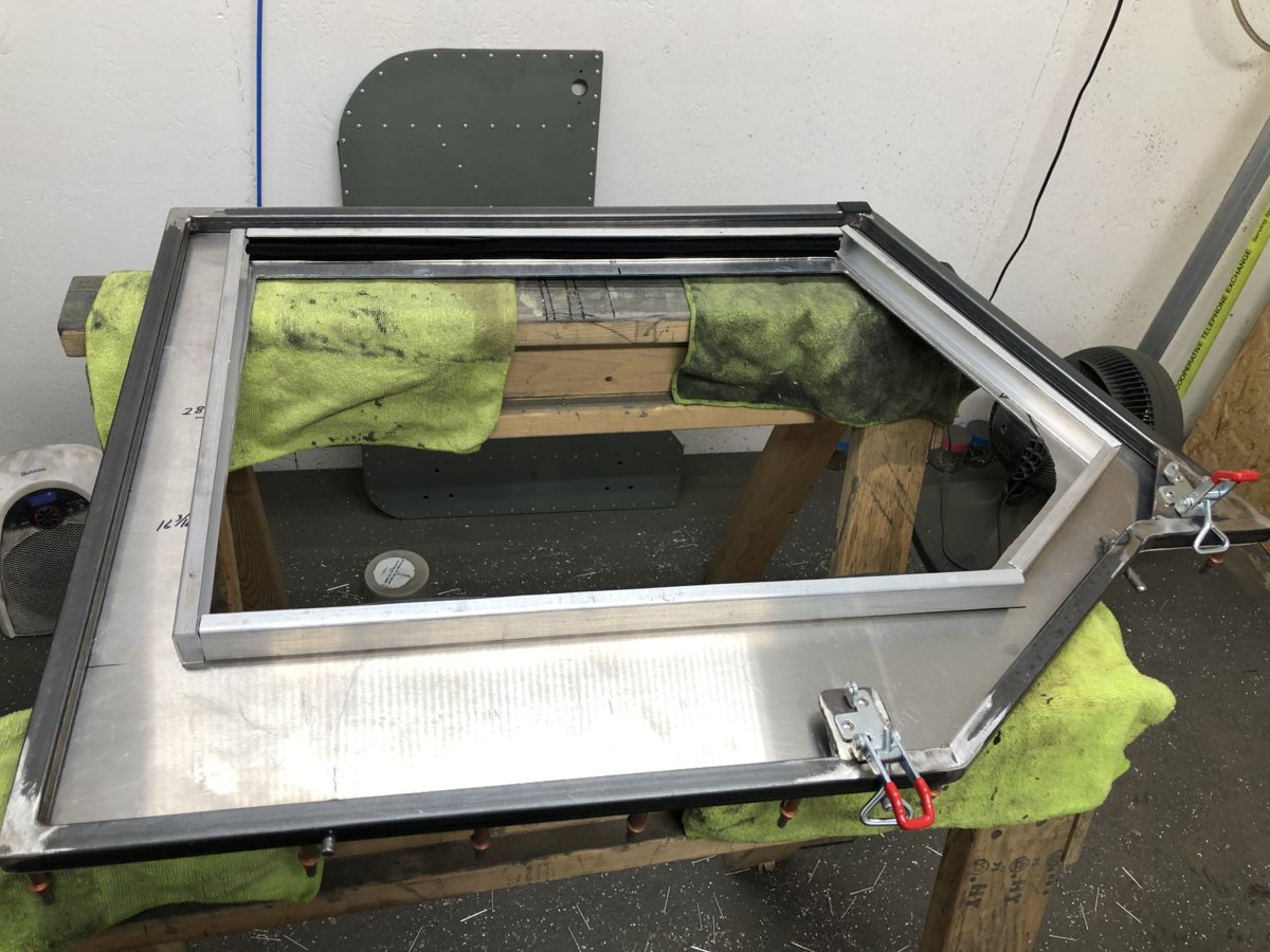

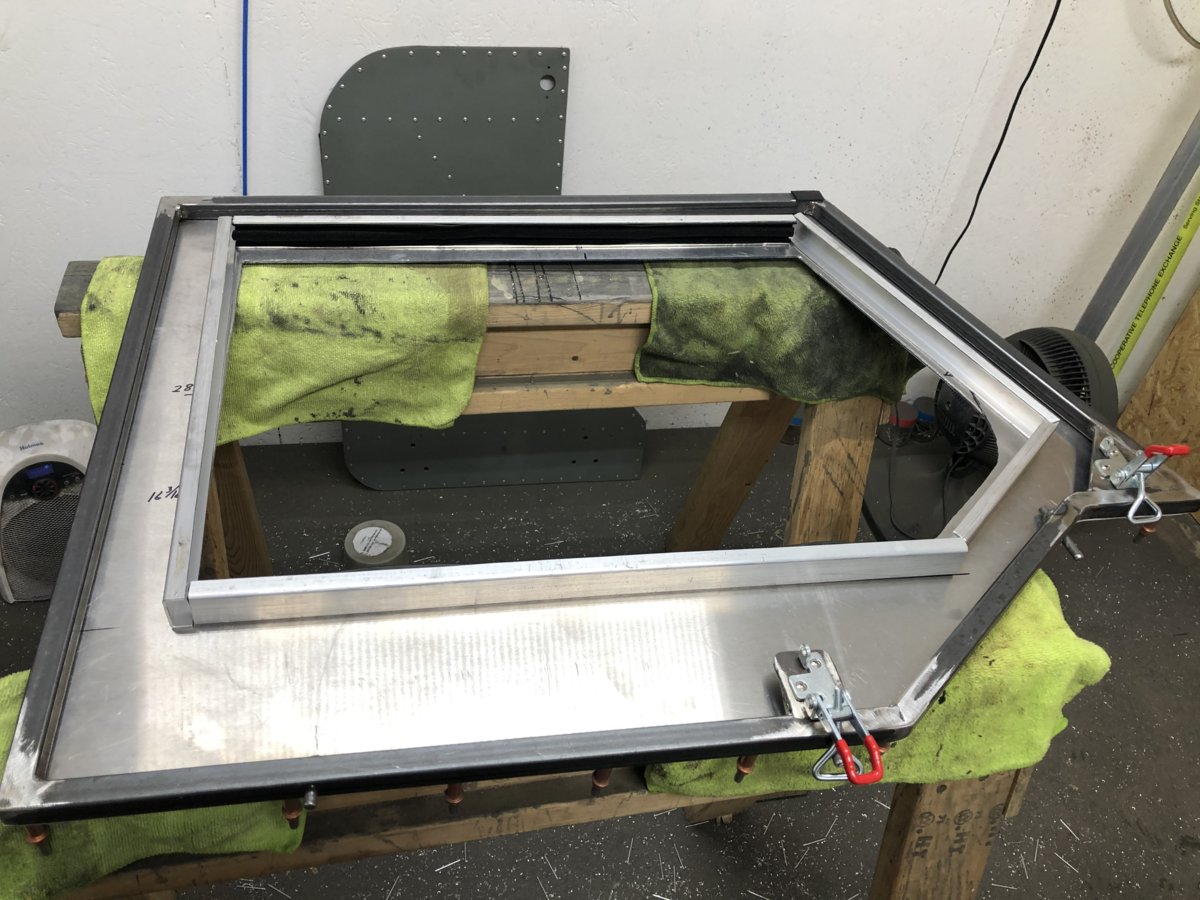

Decided I should get started on the windows for the doors, after this the cab is complete.
Where do you plan on getting a sliding window from? I planned on using a sliding window on my doors the same height as the CJ hardtop rear window I'm using but I have no idea where to order one in the dimensions I need with the same angle as the windshield up front

Making my own.

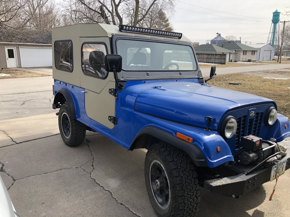

Finished up the cab with a set of fixed windows, I’m waiting on the seals for my sliders but couldn’t wait anymore.
I’ll make another set of upper door frames when I acquire the rest of my seals.
Wife and I went for an area tour this afternoon, the cab is so tight and quiet, absolutely love it.

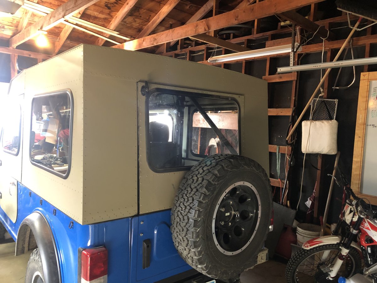

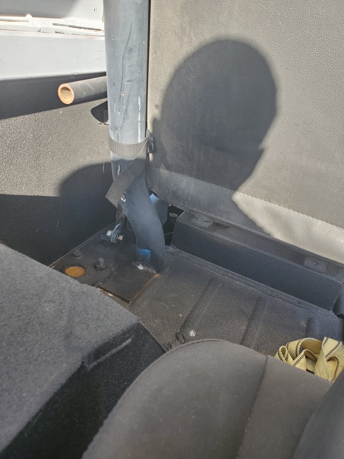

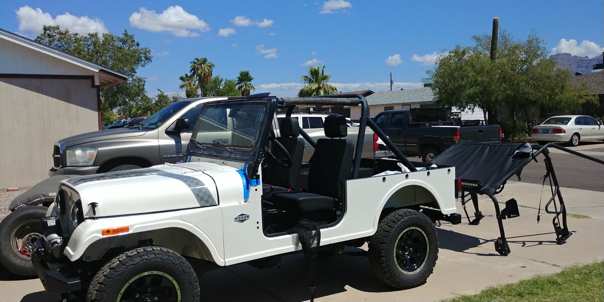

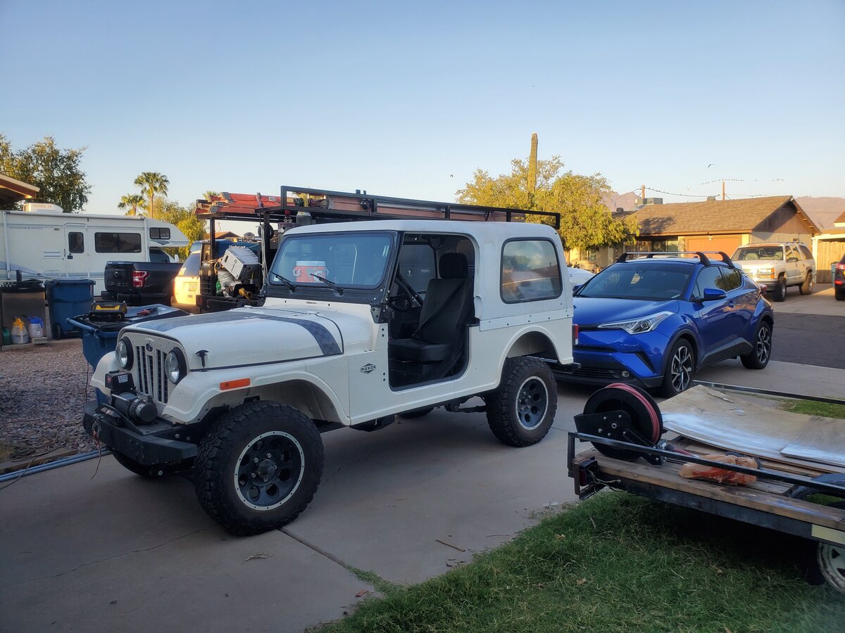

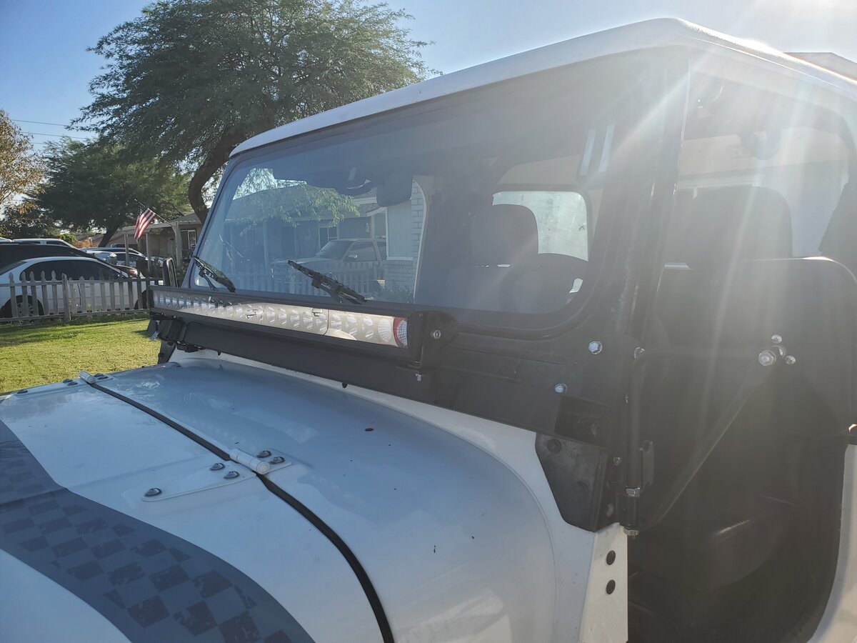

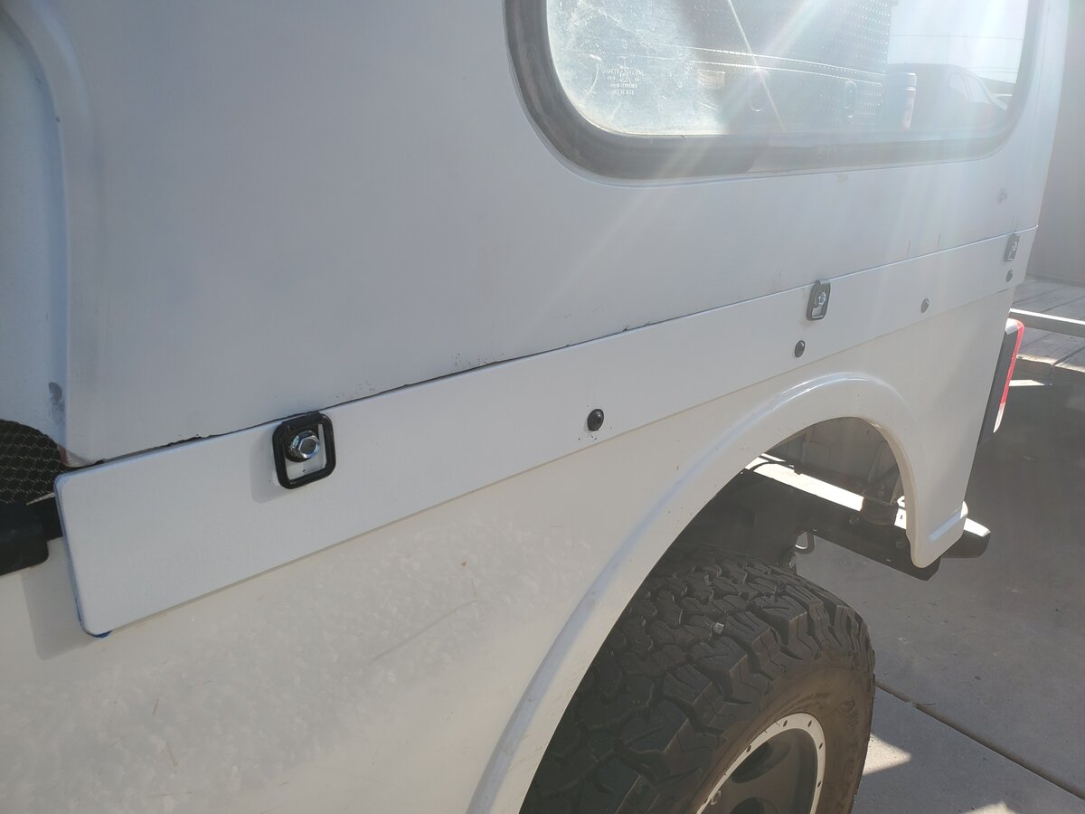

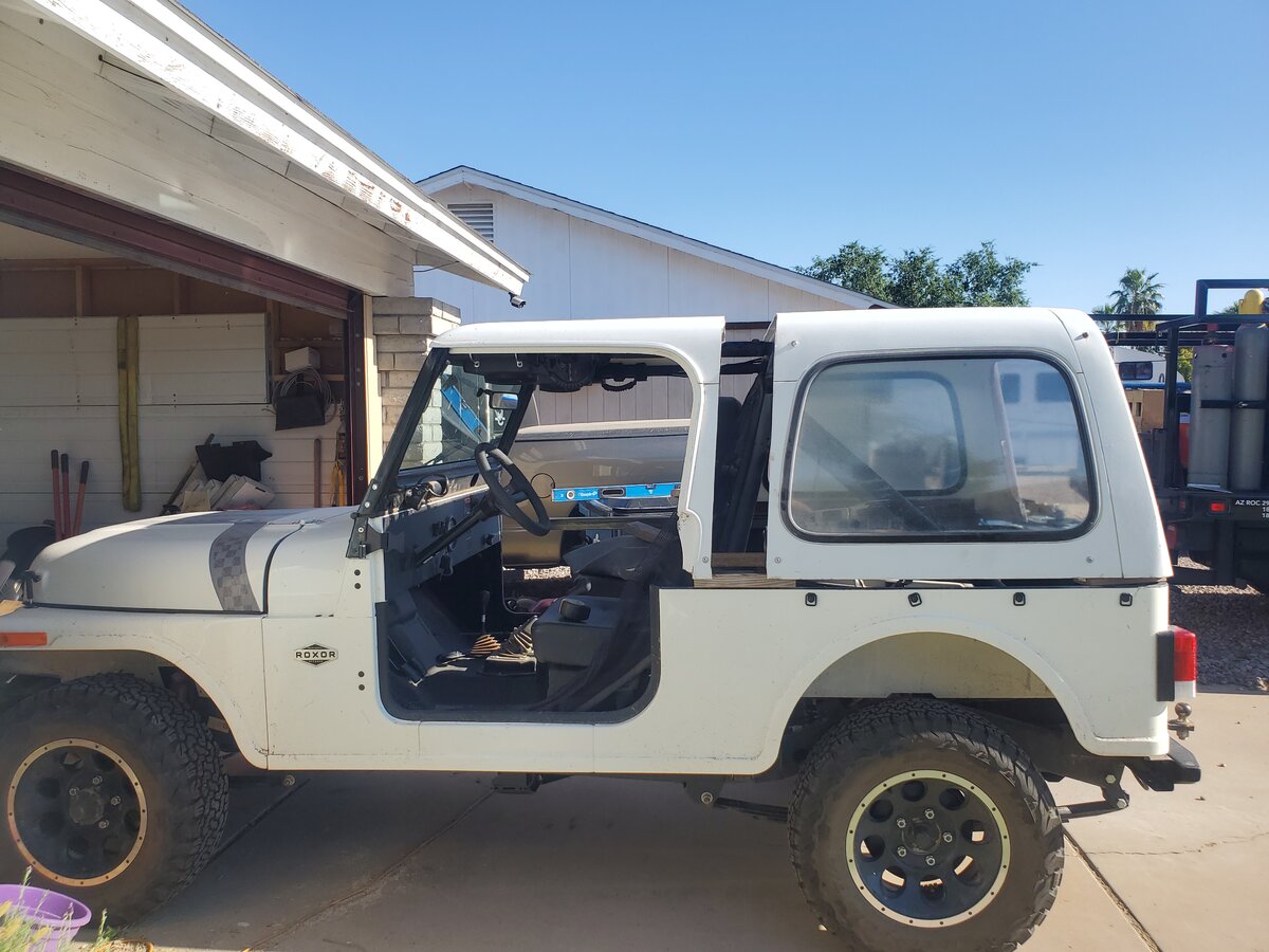

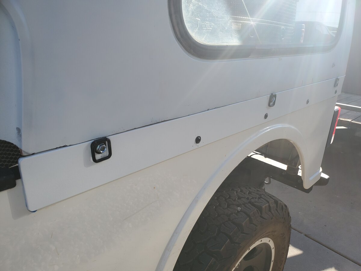

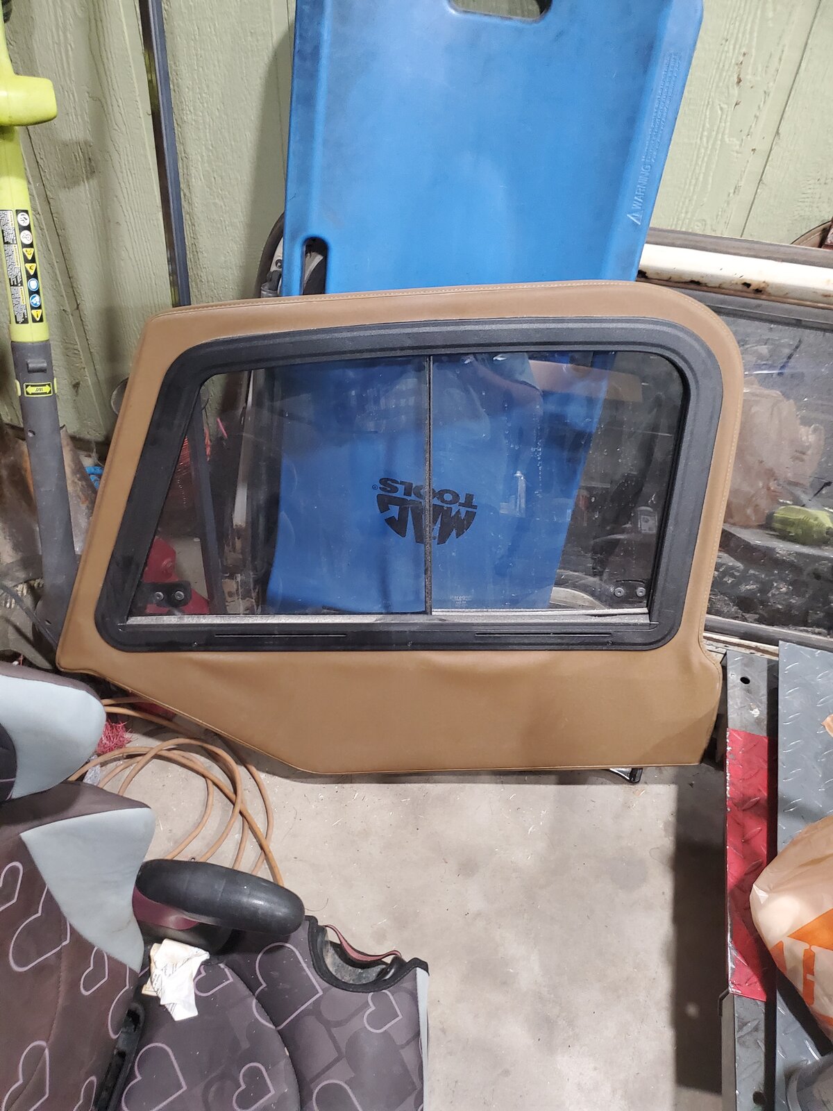

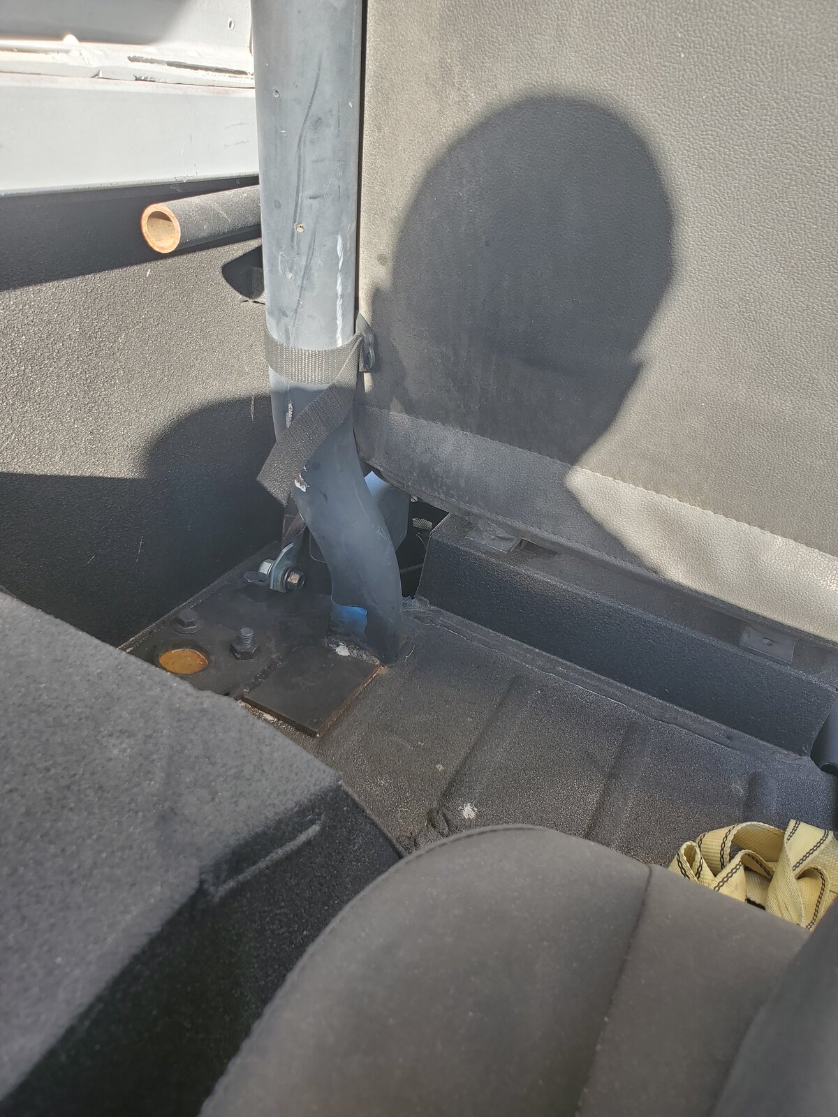

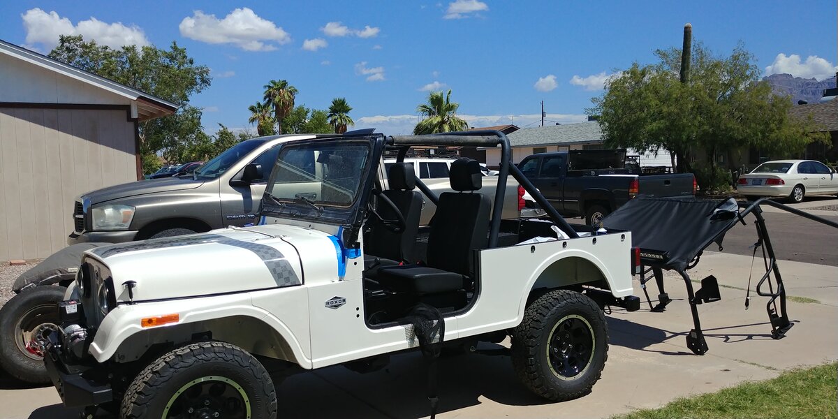

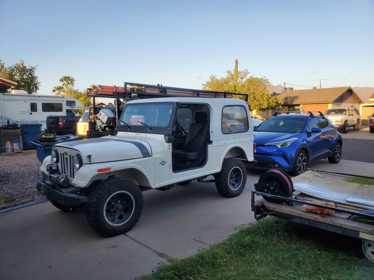

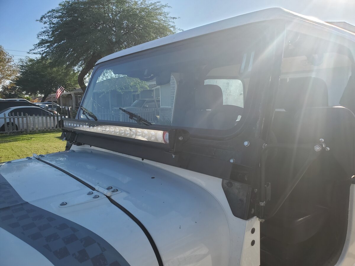

The top has to be shimmed up 2 inches I used 2x2 square and shaped 3 inch flat stock to clean up the outside i used a cj windshield frame and a cj roll bar cut the main hoop down I believe 5 inches and welded to the roxor mounting plate on the floor i am going to build my own half doors and use yj besttop half windows they fit the cj top curves I used sheet metal onthe inside of the top with 3m panel bond for strength and
layed fiber glass to fill the gap i have wipers and a dot windshield now and all the parts are easily sourced used I have about $ 700 dollars into the set up and I use a Bimini for a cj in the summer 16014216470697307262494784657206.jpg16014217305051598129415712539027.jpg16014217305051598129415712539027.jpg16014216890625535642313669397101.jpg

The top has to be shimmed up 2 inches I used 2x2 square and shaped 3 inch flat stock to clean up the outside i used a cj windshield frame and a cj roll bar cut the main hoop down I believe 5 inches and welded to the roxor mounting plate on the floor i am going to build my own half doors and use yj besttop half windows they fit the cj top curves I used sheet metal onthe inside of the top with 3m panel bond for strength andView attachment 7725View attachment 7726 layed fiber glass to fill the gap i have wipers and a dot windshield now and all the parts are easily sourced used I have about $ 700 dollars into the set up and I use a Bimini for a cj in the summer View attachment 7727View attachment 7729View attachment 7729View attachment 7728
View attachment 7725 View attachment 7726

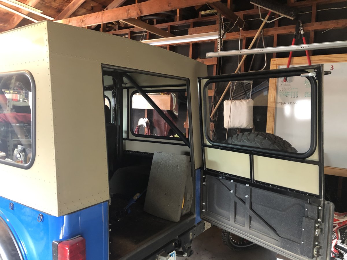

How did you handle the gap at the tailgate? I got a CJ top last summer and my plan was stretching it behind the window at the seam.
T66coupe
Sep 8, 2018
11
Apache Junction, AZ, USA
1586
If I did it again I would split it like that easier to keep it square. I haven't got to the rear hatch yet but don't see it to be that difficult. Figured I would extend the lip on the gate with some weather seal and a little metal shaping.
