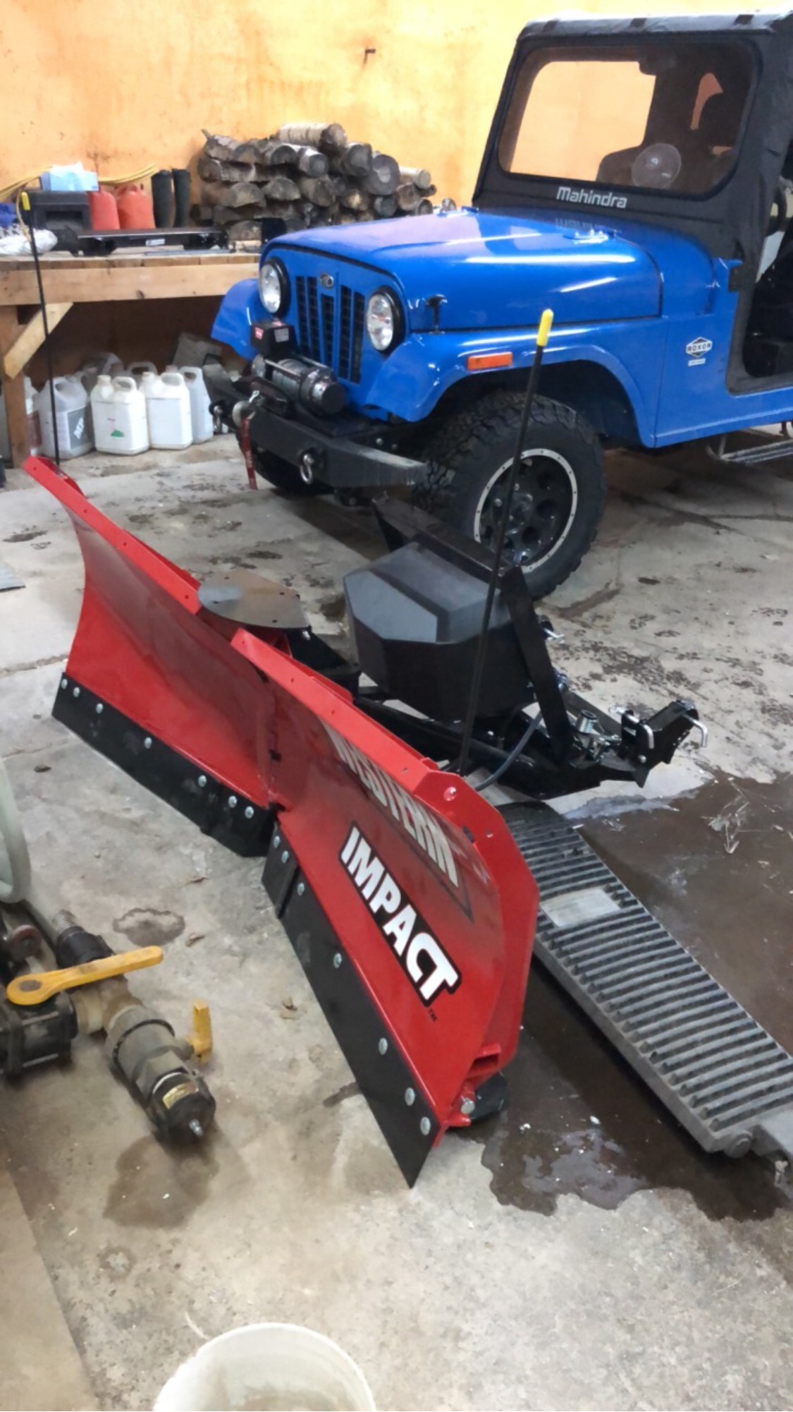

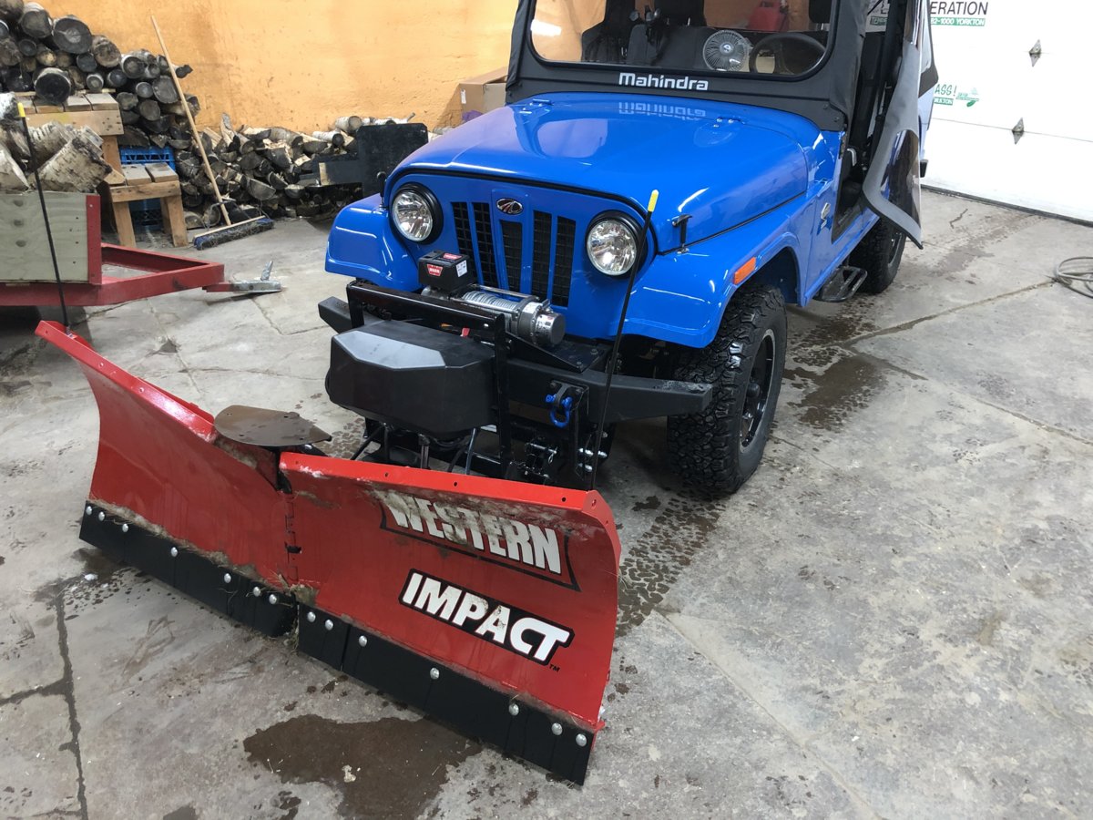

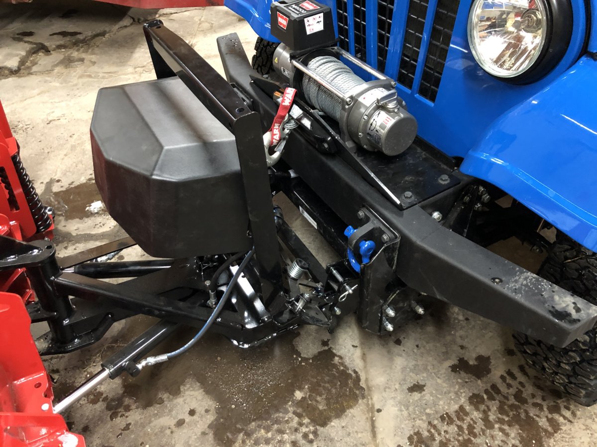

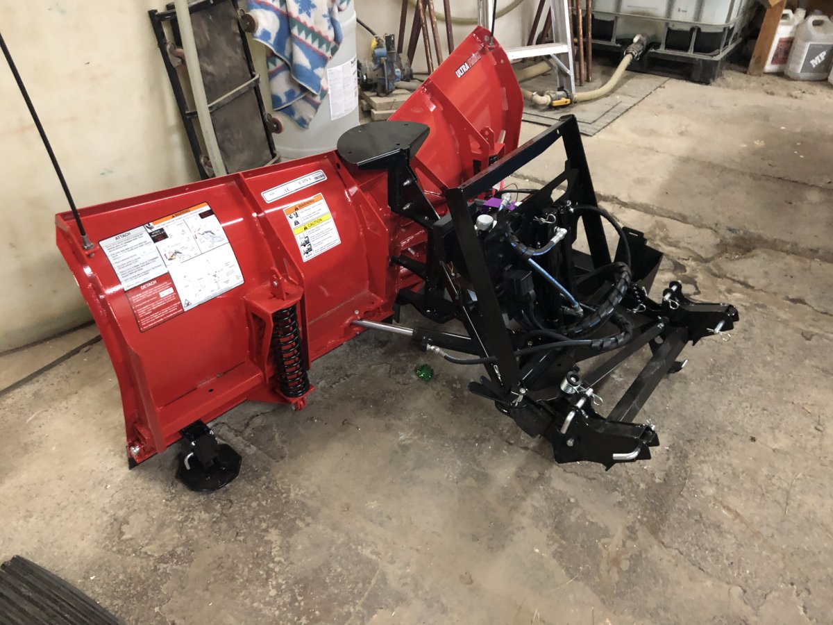

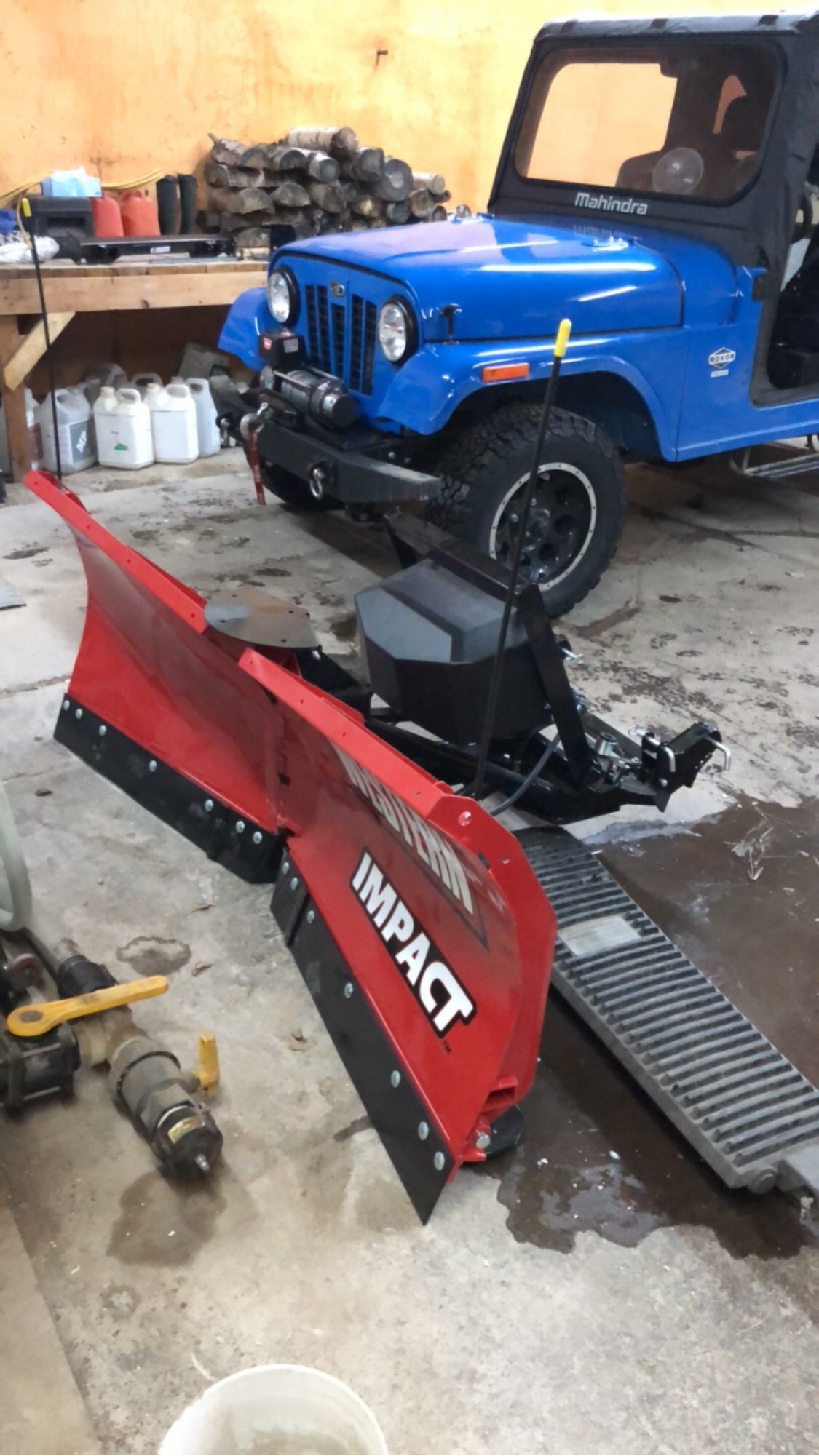

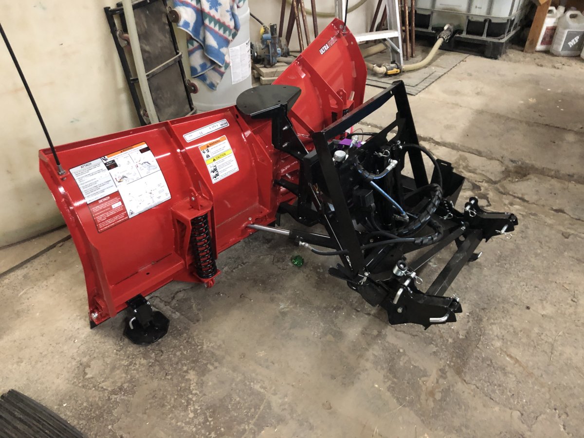

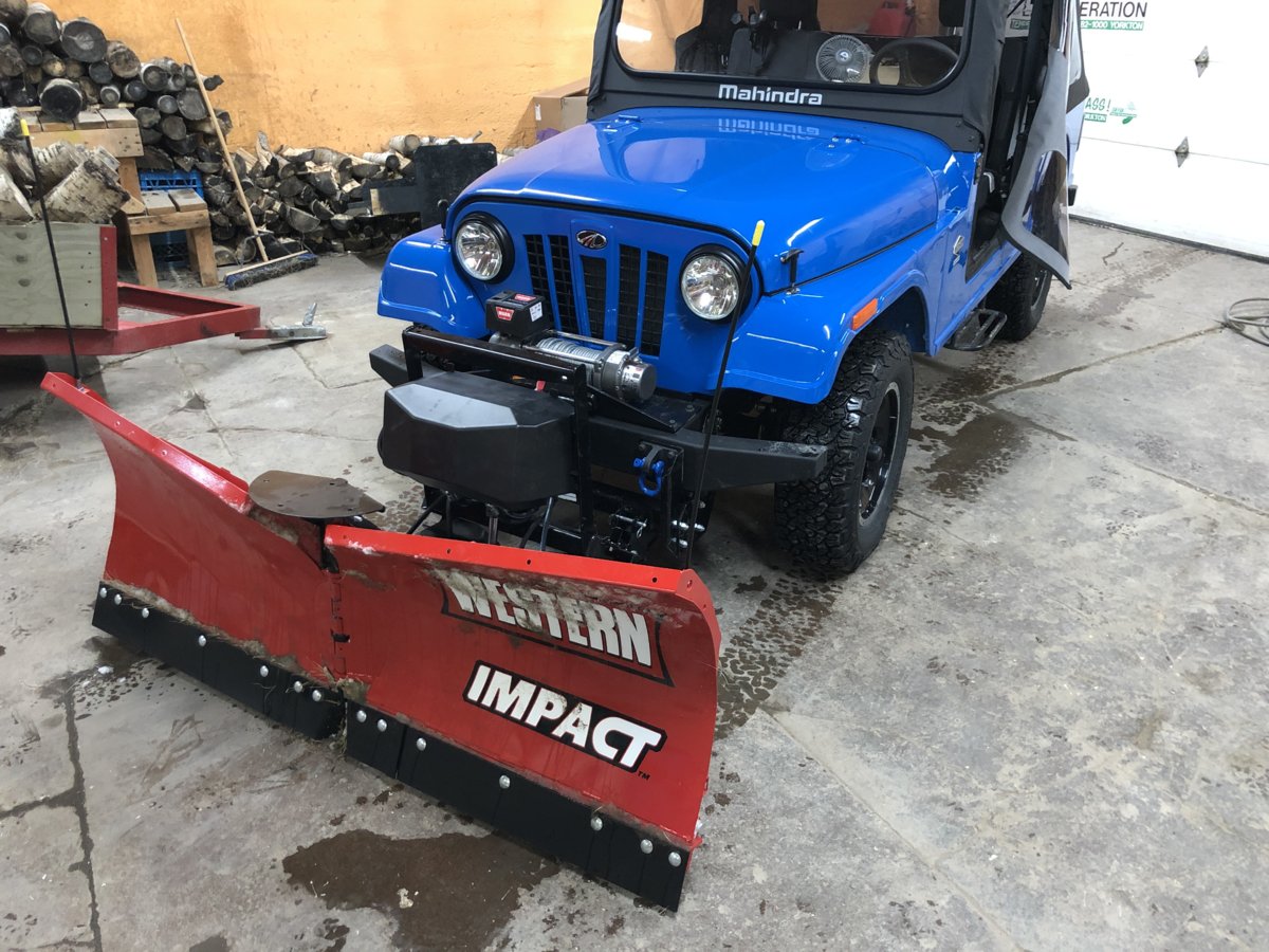

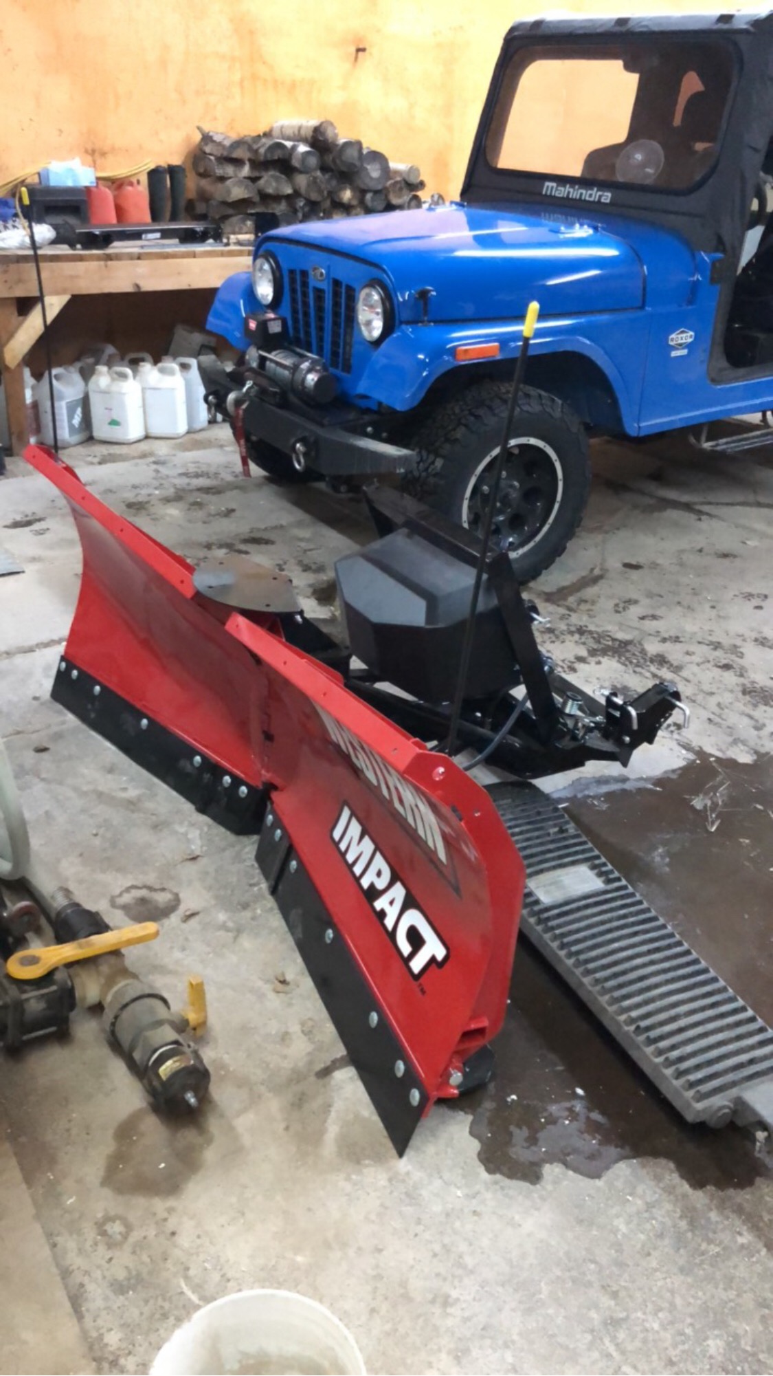

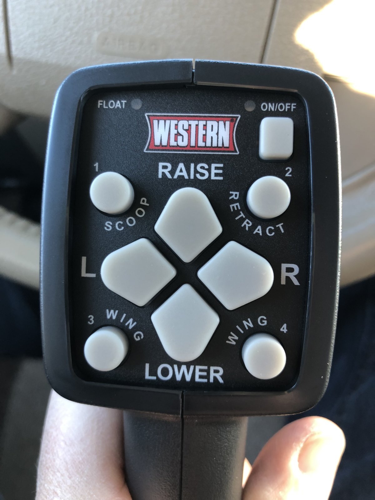

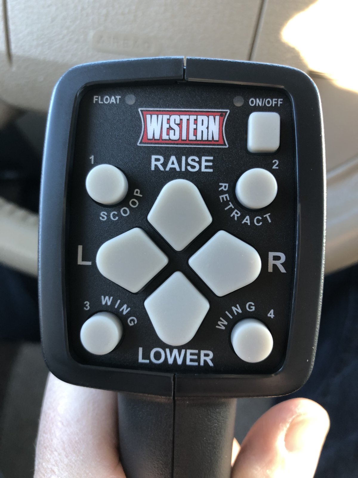

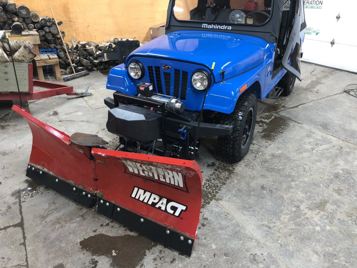

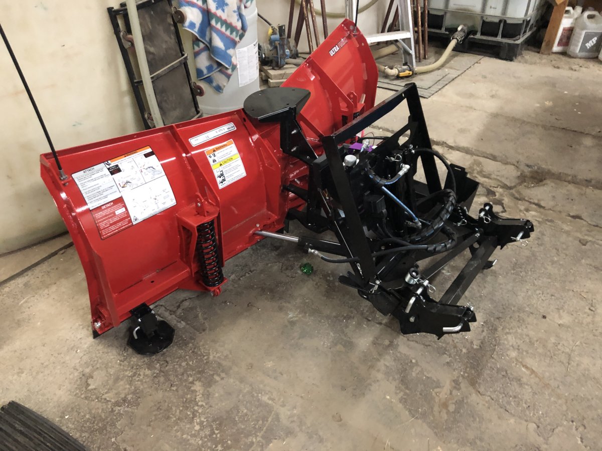

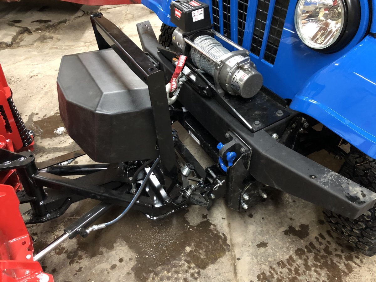

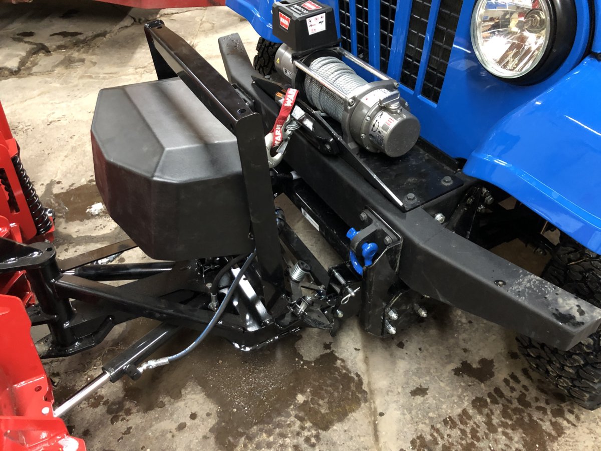

Well, I got the plow on. There are bolts with flat irons welded on to get them inside the frame behind the bumper after you drill the mounting holes on the drivers side, it took a little creative bending, but I got them in. The passenger side is fine because there is no steering box bolts in the way. The instructions are pretty straightforward so I never did a video. I might do an ‘overview’ when I get it out and try it. Very simple to wire in also. Some minor adjustments on the drop speed and a couple other things, that was about it.
View attachment 2450View attachment 2451View attachment 2455View attachment 2454View attachment 2453View attachment 2452
