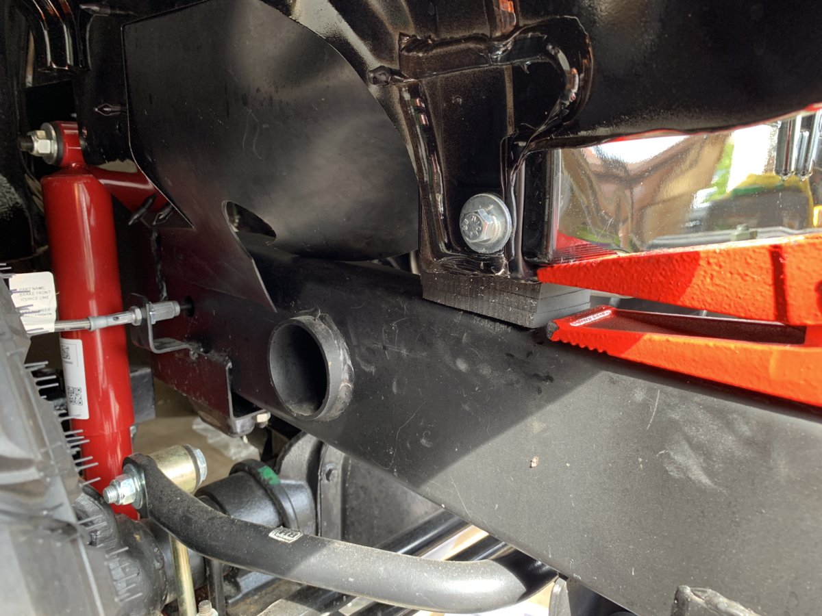

Note here for this thread. I wrote in the thread about crawled under the roxor, when I was installing my oil pan skid plate I noticed on the transfer case shift linkage there are 3 pins with cotter pins holding them in. 2 were not bent or installed. Needed to be flailed out. One was curved slightly but I just pulled on it and it would slide out. Another was straight and could have fallen out. So check yours.
