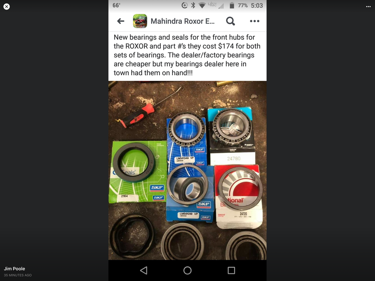

Haven’t confirmed any of these but this pic was posted on Facebook and supposed to be the correct parts

Confirmed everything is right except the inner seal is not correct in its outer diameter. Thanks for trying! The seal is metric and cannot get the number to cross over to anything. Looks like I'll have to get it from Mahindra.
Take the seal to your local industrial bearing supplier. tell them measure and find. They have ALL the books with anything ever made in them.

Please list the part and part number.
How did you do this.
What was the cross reference vehicle.
I was just sharing what I saw on Facebook and haven’t verified. That said just buy from Jesse at torque king and support a fellow Roxor owner thats supporting our habit.
