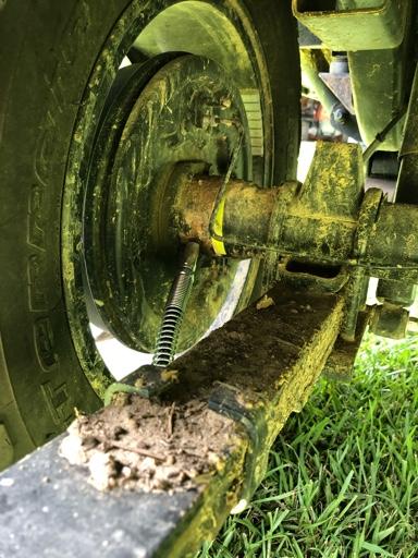

Where are the ones on the rear axle? Picture?
Ridem32
Jul 18, 2020
154
Terry
Anyone? Are they behind the center cap?
AZROX
Oct 12, 2019
434
Phoenix, AZ, USA
@Ridem32: not sure what happened to my post... I replied... maybe didn't hit the post button.
As the precious poster said, they are just a few inches in from the brake drums on the axles.
There is a very small hole (1/16 or smaller) at the top of the axle above each zirk fitting. Once you pump in enough grease, a thin threat of grease will come from these holes. It took about 15-20 pumps on my Roxor until grease came out the top.
Ridem32
Jul 18, 2020
154
Terry
Thanks to both of y’all. Found it and greased. Took lots of grease for it to come out of fill hole. Must of been dry
