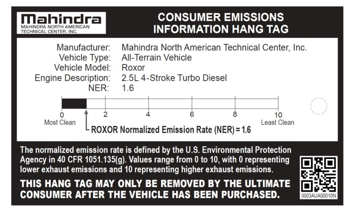

I was told it does. On the engine tag it is rated at 1.6 out of 10. That’s on the clean end of the scale. Full Disclosure: that’s I just what I was told, I don’t know that much about these numbers.
When I find my tag, I’ll ad the picture.
Edit: found it
