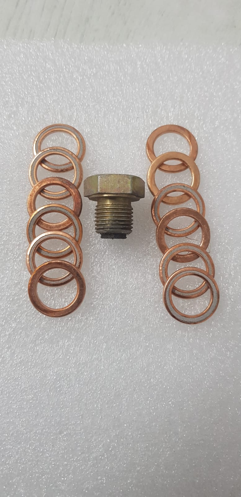

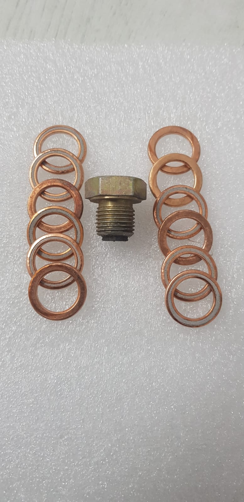

Considering is issue of crush washers being a headache have decided to send two washers free with all filter orders from my store from today.
Its also available spirally

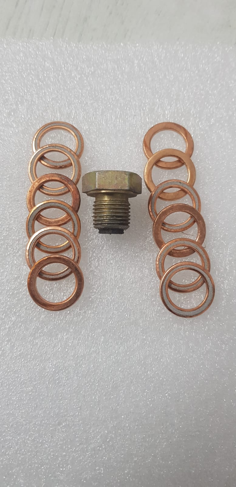

Hope This Resolves the issue for all
