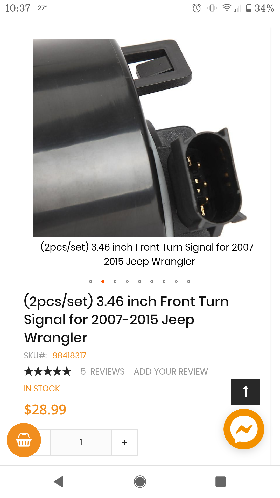

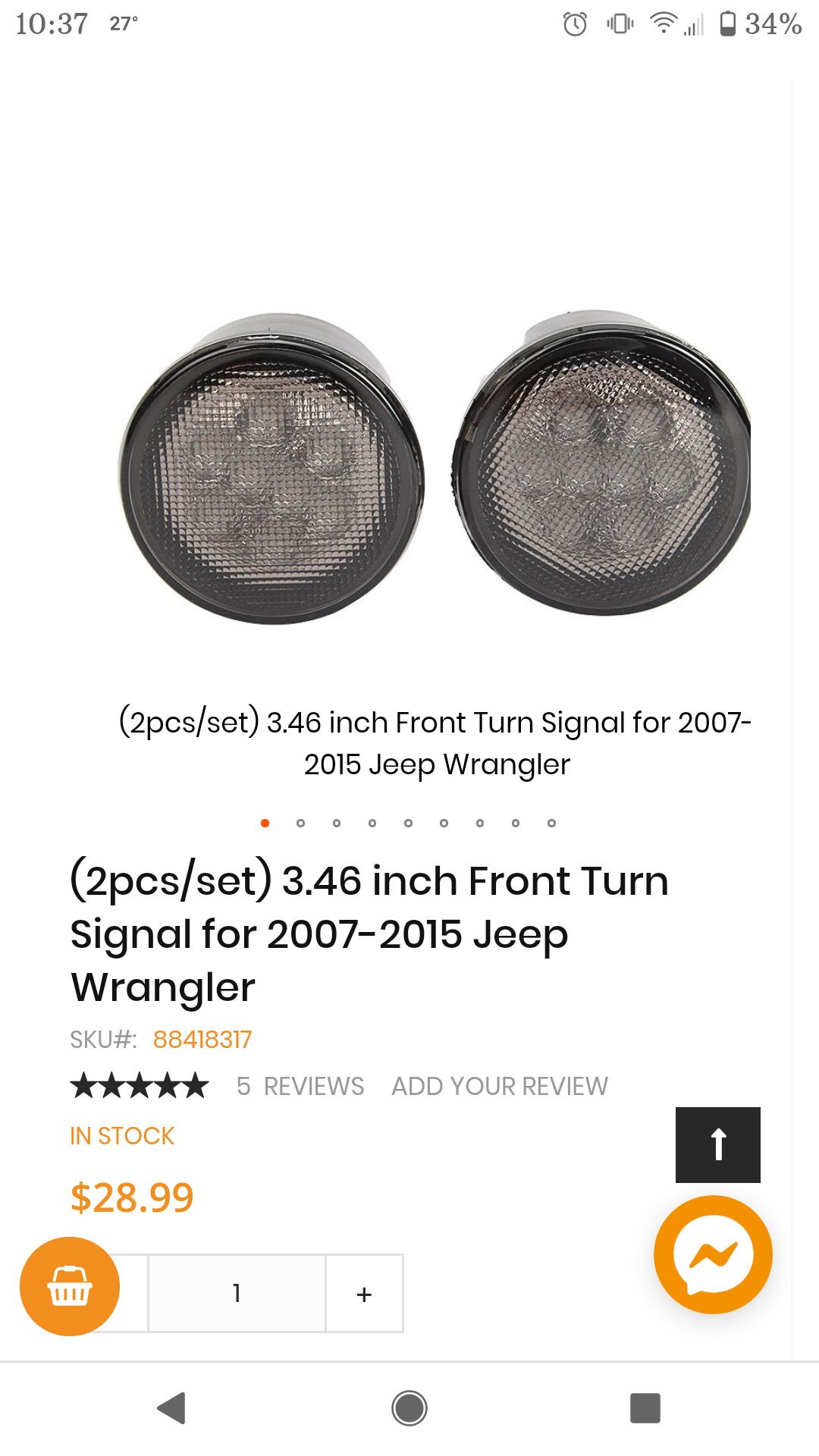

What issues should I foresee with these turn signals? Cutting into the grill obviously, but how do I convert that plugin to the pencil plus of the xtc harness? Cutting and splicing?
Charlie I bought the xtc turn signal kit and added 2.5” led fronts from O’Reilly’s instead of using the supplied 3/4” ones.
