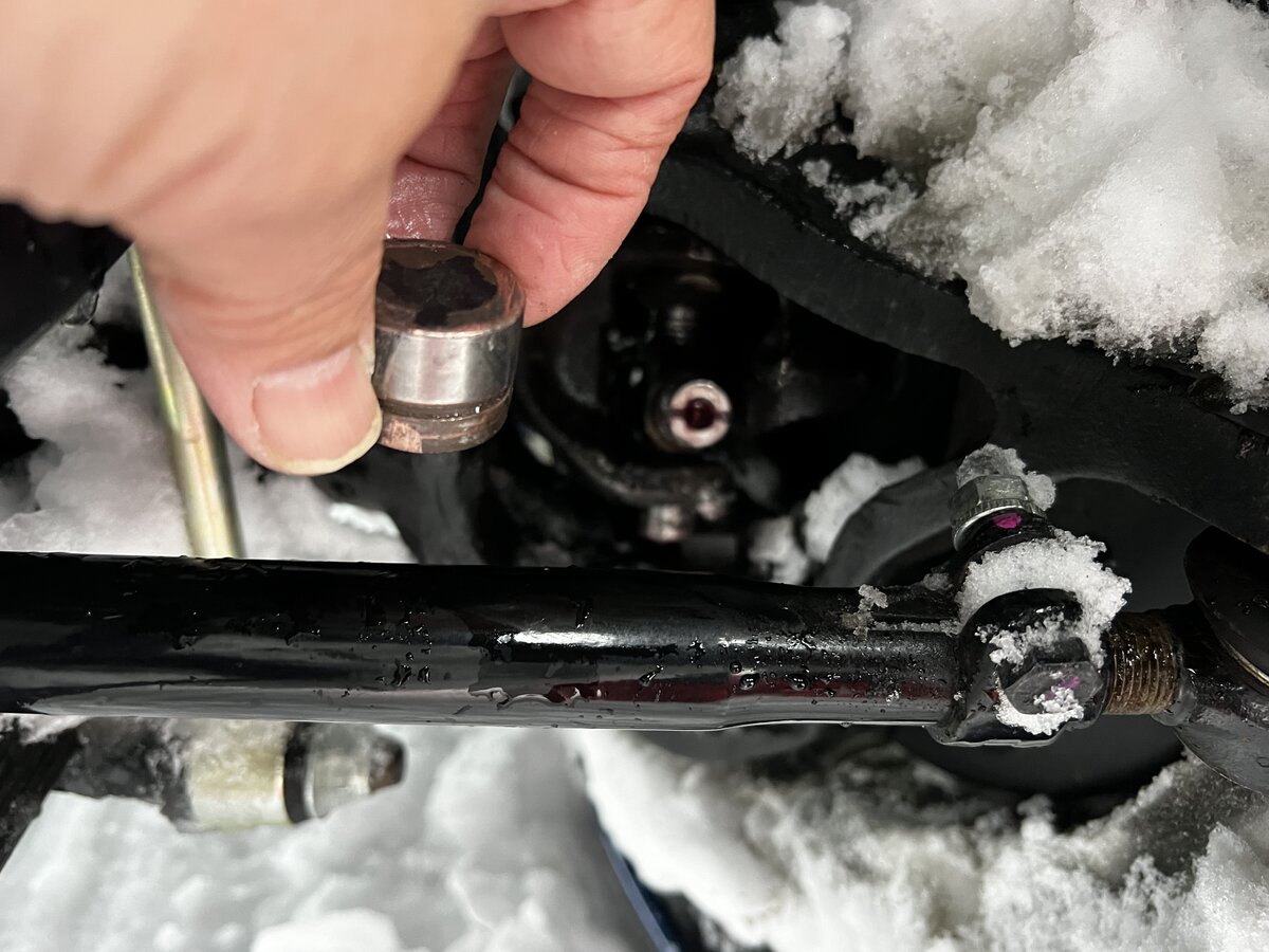

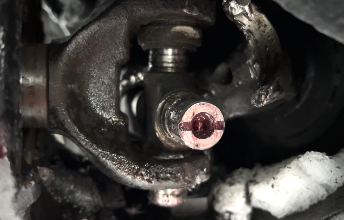

New 2022 Winterized all original equipment. I added some SUV chains, Western Impact 6ft V-Plow and I that's all I was gonna need ... I thought. Well, I broke the front axle on the second day of use Plowing but first real test of what it could do. It cleared out the road that it was parked on, it did my 50 foot driveway, it cleared my partner's (half owner) 60 foot driveway with 3.5 feet of snow, it cleared all of the streets that we traveled (half of a mile squared), it cleared up steep hills and down with no slippage and it carried a Korean War Vet and his grandkids up a hill that nobody was attempting ... no problems. I get back to my cabin to clear the road adjacent to my home and it was buried with 3 to 4 feet of snow on the upper half (uphill portion). So not to ride the clutch, I decided to finally use Low 4wheel drive to have a nice slow steady push. I put it in v-formation and a little raised off the ground and plowed away. One of my neighbors joined me to witness firsthand the effortlessness of the Roxor in action ... he was impressed beyond all means. Just as I was finishing up I felt the Roxor loose forward power and slide to my left with a snapping sound. I looked at my front wheel and the chains were still on but there was a dark cap like piece of metal out in front of my plow. My neighbor saw it and explained what it was and he was right.
I called the Farm Implement company I bought it from and the mechanic stated "The perfect storm! You added chains to the front wheels, you added a heavy plow that extended out 3 feet and then you put it in 4 Low which then caused you to loose all power and started to slide to the broken side right? Well, that is what happens when something gets overweighted and then forced into a greater stressor ... something has to give and it is the weakest link, your front u-joints." I am not a mechanic, but I did stay in a Holiday InnExpress last night and I call that explanation a CYA Exemption. My neighbor called me later and said that he swore he heard me say that I had Dana 44's "... that should not have happened Joe those are almost bulletproof and you were not working that rig hard at all! That should be covered by Mahindra or the dealership!" 2 days of easy polite snow pushing and the 44's give out? Mahindra employees carelessness or 44's are not really that great? I am disappointed but not pissed, although this is now the 2nd Roxor in 2 months and I am batting 0.

That's a lot of torque pushing against 3.5' of snow. That's more than 1 ton territory, and you added chains. Speed, torque, and no tire slippage, U joints and ears are always the weak link in a solid axle. If this is the intended purpose for your Roxor, I would upgrade your shafts to 30 spline.

I loved plowing snow with my Roxor but it was too much weight for the springs. Granted I was using an old school Meyer, it just did awesome plowing. It looks to me like a keeper came out and then you got out of alignment which snapped off your ear to the yolk. I’ve replaced u-joints and every time it is a tough fit because of the poor machine work for the axle-yolk. If you go with torque kings replacement I’ll bet you won’t have that problem again. I hope you get plowing again soon!

Add a selectable locker and upgrade the carrier to a 30 spline unit and run aftermarket axle shafts. That’s essentially what I did and I have had zero issues with the axles and u joints crawling in the rocks.

I was hoping that this would be covered by Mahindra, but why would I put crap back in only for it to happen again ... Torque Kings it is and free coffee for everyone! I appreciate that advice and I will not use low 4wheel for plowing above 3 feet. What gets me is that I have driven this for less than 10 hours and maybe 7 times total with 2 of those times for working purposes.

Swap the shafts to a 30 spline inner aftermarket chrome moly shaft and be done. It’ll fix the wobbly factory shafts. Do the same for the rears and get away from the two piece axle/hub set up. It’s only a taper and a key way held in by a nut that’s transmitting torque to the wheels. Once you upgrade that you’re pretty much bullet proof as far as the drivetrain goes. Keep in mind these vehicles are essentially 40’s era tech with regards to the drivetrain with exception to the engine.
