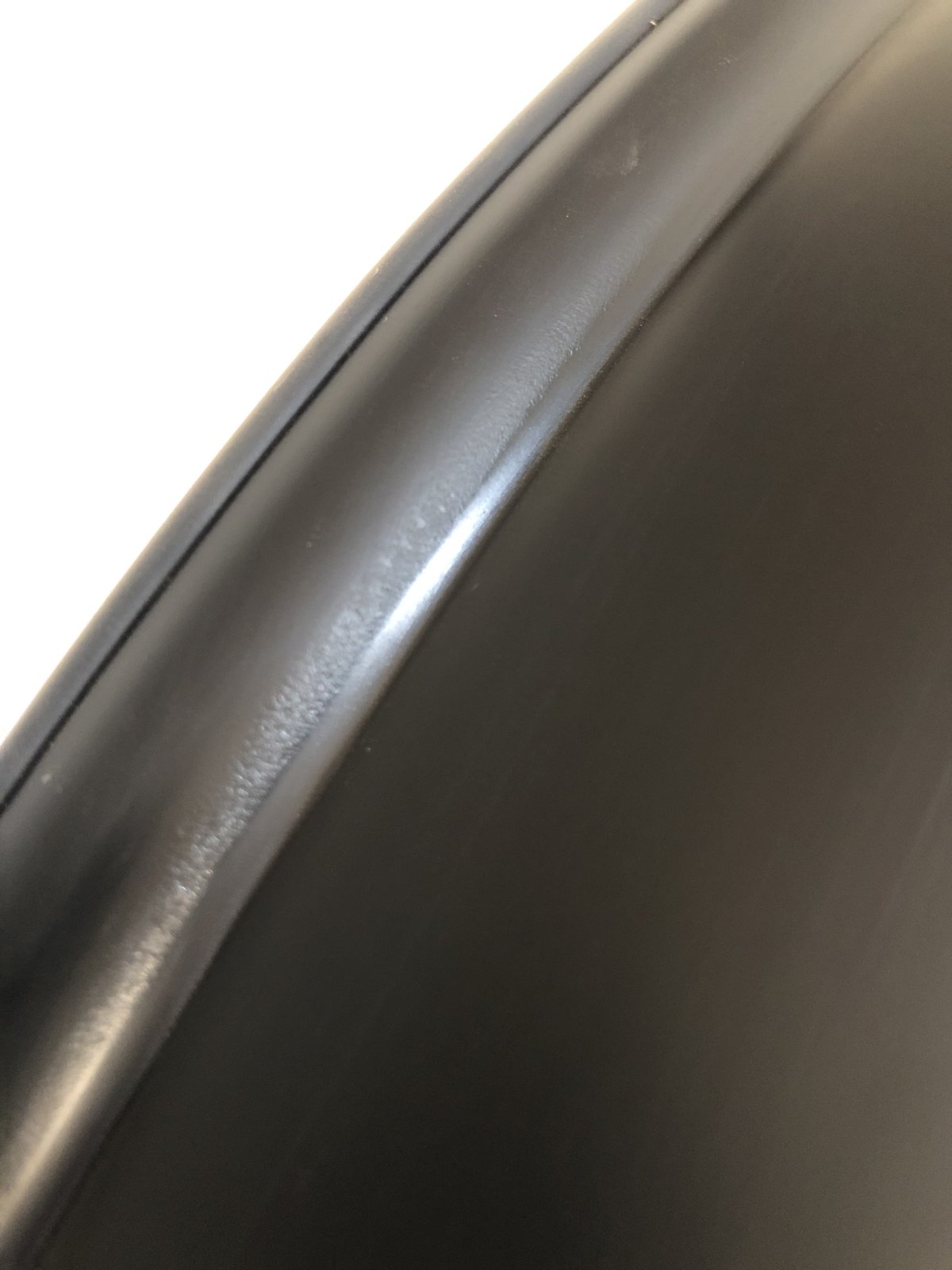

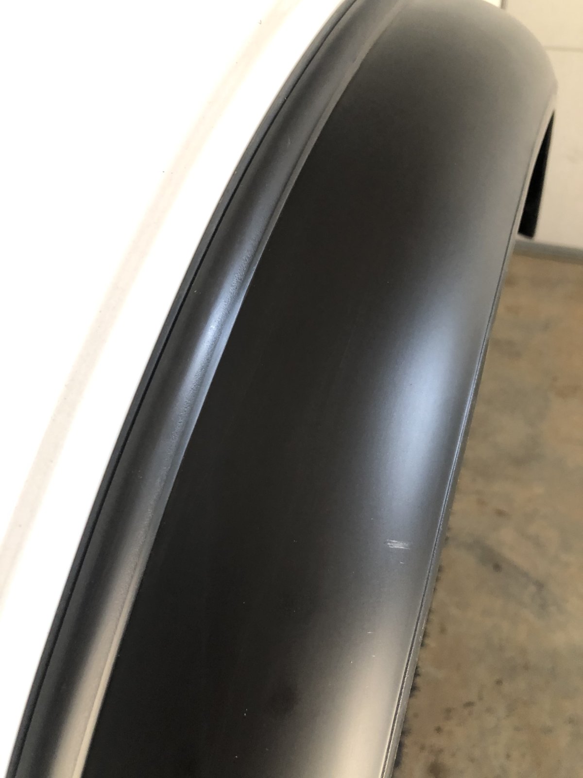

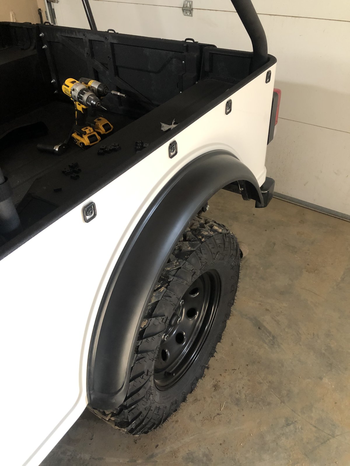

mcmacsten
Feb 7, 2020
17
Scotland, SD, USA
3C73597F-42A8-44ED-8DD4-9116F065BA52.jpeg 4FB63689-EA76-432C-B6D0-7A8502837D65.jpeg 435A7A76-8F92-430B-8946-62EAF838187C.jpeg
838
Are these mandated in some states?
Togo
Mar 17, 2019
228
Hammond, LA, USA
Put rubber gasket in between it’ll keep all the water out and keep from ruining paint underneath. Also fill any small gaps
where did you purchase your flares? Where did you get the gasket material.
