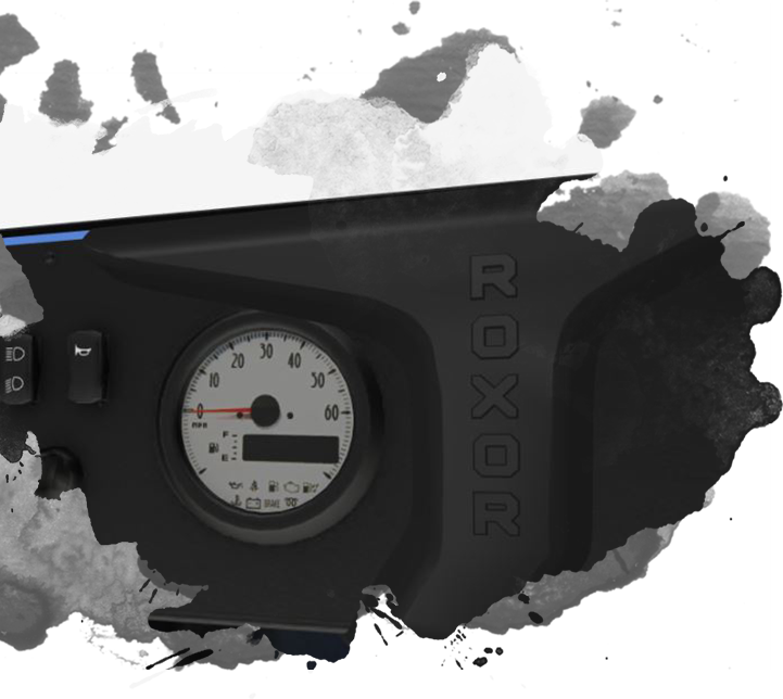

For those that never looked at the Roxor accessory page, this is the defrost kit for this heater. I like the idea the way it is going to work, no holes to drill for vents or tubes to run under the dash. Looks like it is just going to slide over the heater under the dash and have air deflected where needed. Right now it blows straight down on to the floor. Another very simple design. I'm glad I went with the factory unit and did not try to rig something up myself. Another (minor) point about going with the factory stuff, anything new they come out with should work around the rest of the accessories.
DEFROST KIT
The Ultimate ROXOR Accessory for your soft cabin enclosure and heater is our new Defroster kit. The Defroster kit allows to control the climate inside the cab with adjustable floor vents and a big sweeping windshield vent to help keep your windshield clear. (Heater sold separately).
Part Number: 1202AAA00380N
MSRP: $109.99

Thanks for posting the video Bister. Nice install. Does the defrost option really wrap to the outside of the dash? That just seems odd. Anybody have pictures of the defrost part of the heater kit?
Yep, it comes up the front according to the picture. That is the only picture available until someone buys the defrost kit. Mines on order. It's going to be a real simple install though. I don't mind it, I think I would rather do this than start cutting up the dash, but thats just me.
