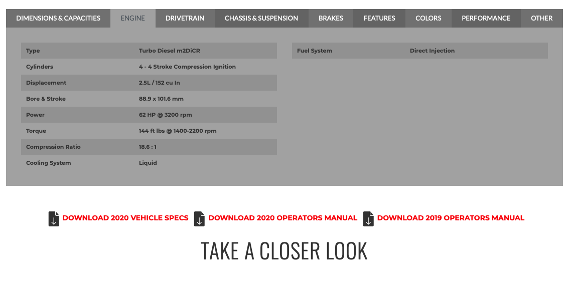

Anyone know the bore and stroke on this engine? Somehow I would suspect the stroke is much greater?

Bore and stroke is listed right on the engine specs on Roxor's webpage and the 62HP is at 3200RPM. This is a bit higher revving diesel than most older diesel engines. I rarely find any reason to run higher than 22-2500RPM, and that is the high end, but I drive slow.

Hey great! When I got the specs, in 2018 Roxor was hush hush with everything. I am glad they are finally sharing as they should. I got so TEED off with local dealer, haven't been back. I found that I knew more about the machine than they. They only wanted to sell and didn't care after that. Probably sounds familiar huh? Thanks for the knowledge, we are all in this together.
