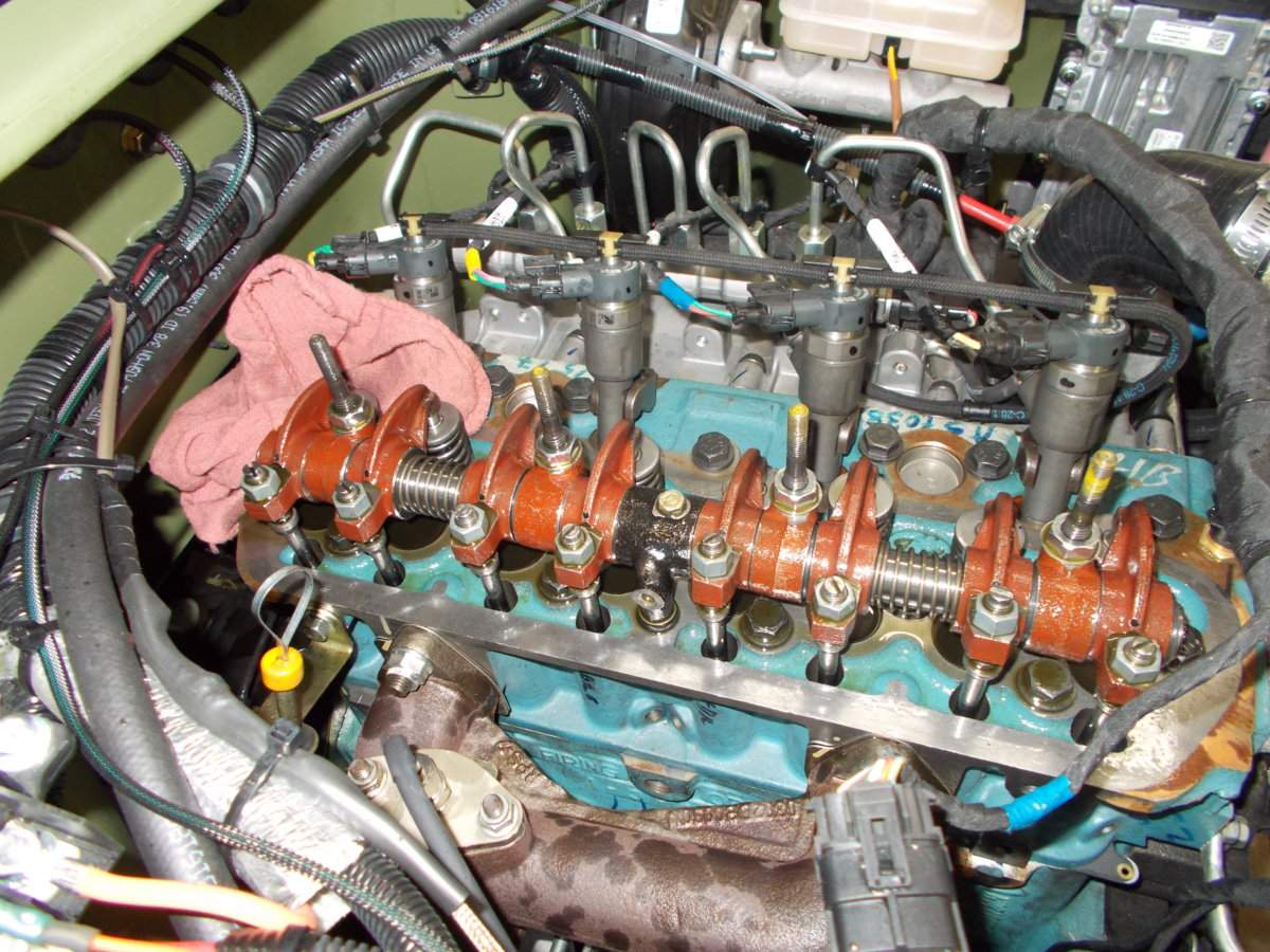

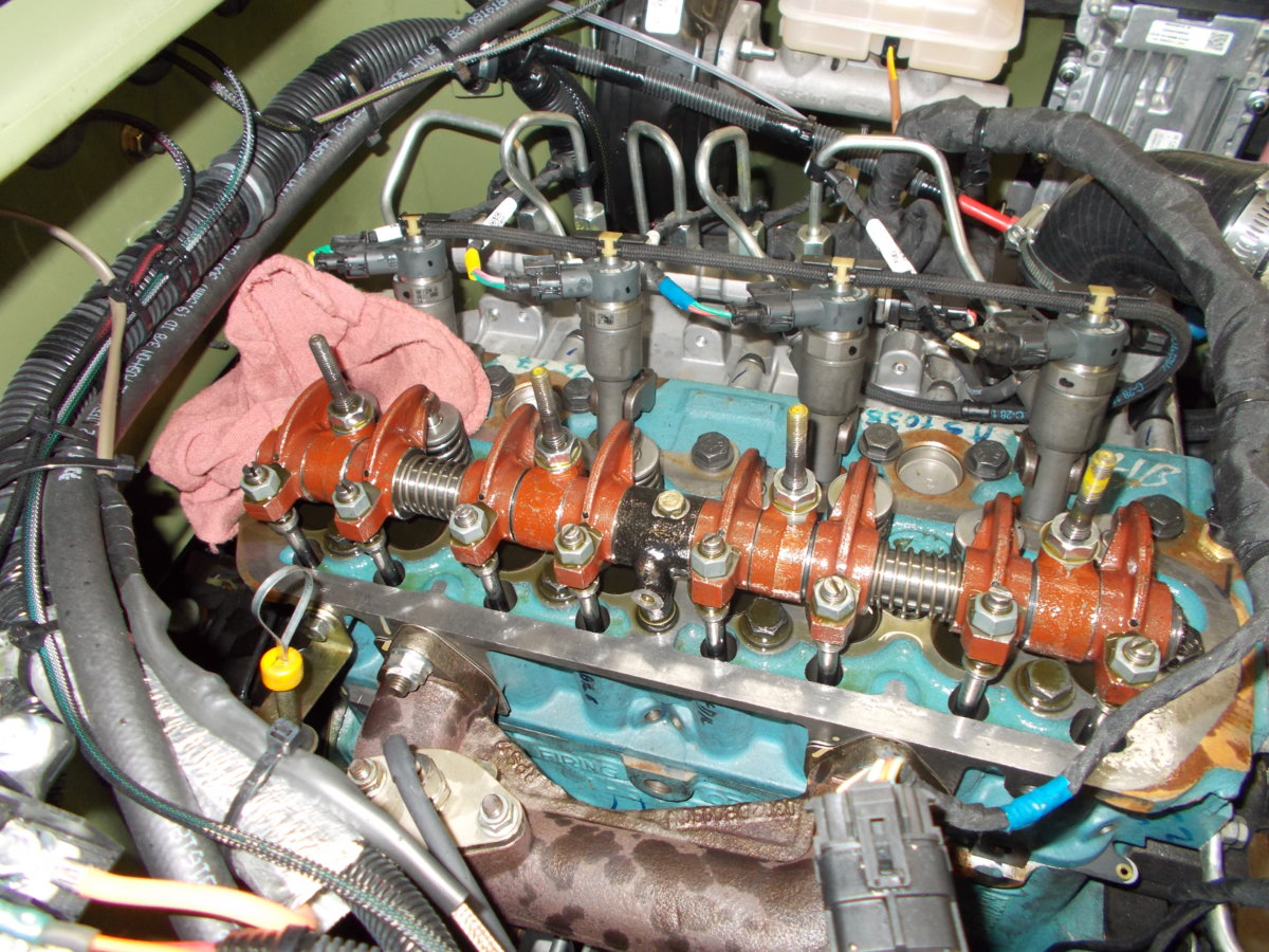

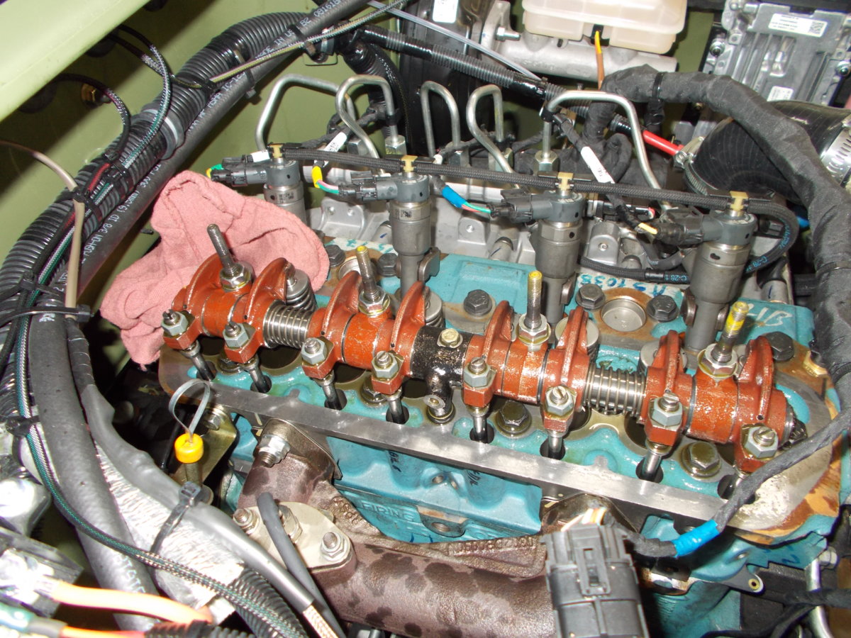

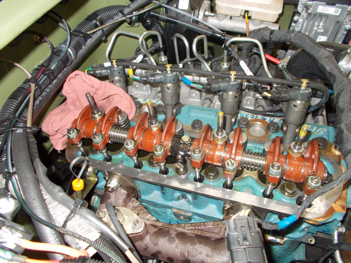

Using some highly sophisticated diagnostic equipment (an ice scraper and section of 1/2"rubber hose) this noise/clatter appears to be in the overhead. There sure seems to be an inconsistency in the valve lash adjustment?
On the exhaust side seeing as high as .023 and low side .019 Have an intake valve at .021 I can't find anything on the adjustment specs? Typically .010 intake and .020 exhaust is a safe bet.
I would also note these checks were done on a fairly warm engine so cooling will increase lash.
Anyone have lash specs? Knowing where TDC is would also help. I am going to inspect the balancer and timing cover for marks.
Lastly, lack of oil on the overhead is hardly an issue. I did fire the engine with the cover off. It's a gusher.
Did you ever find some specs for the valve lash, or make any adjustments?
