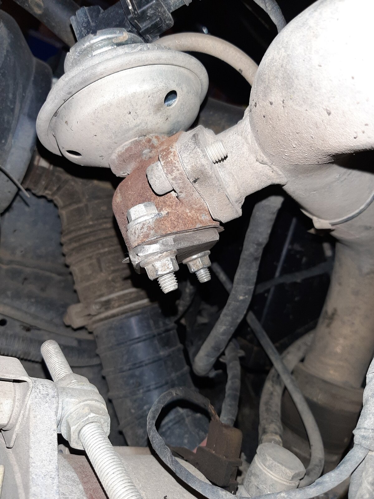

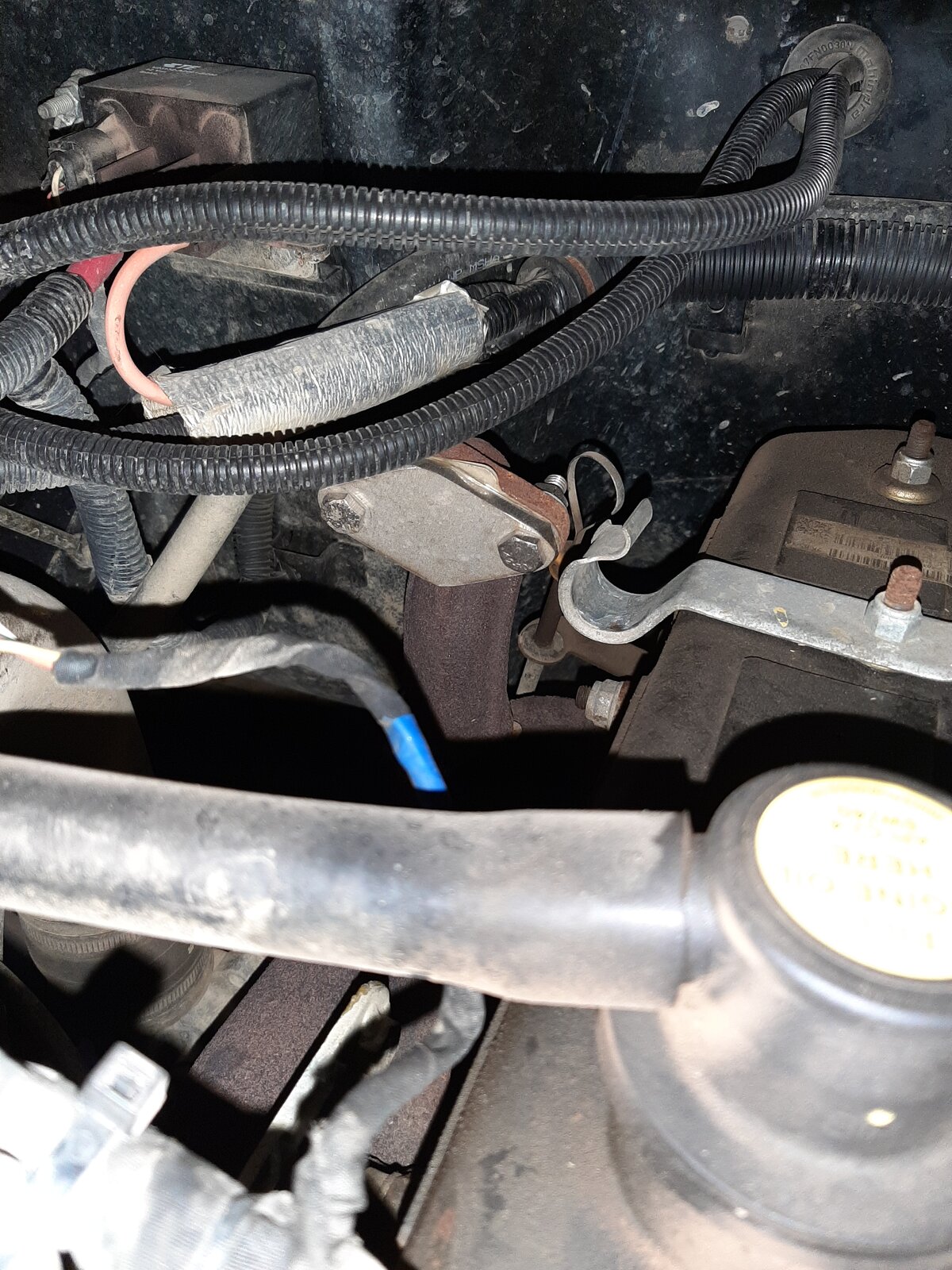

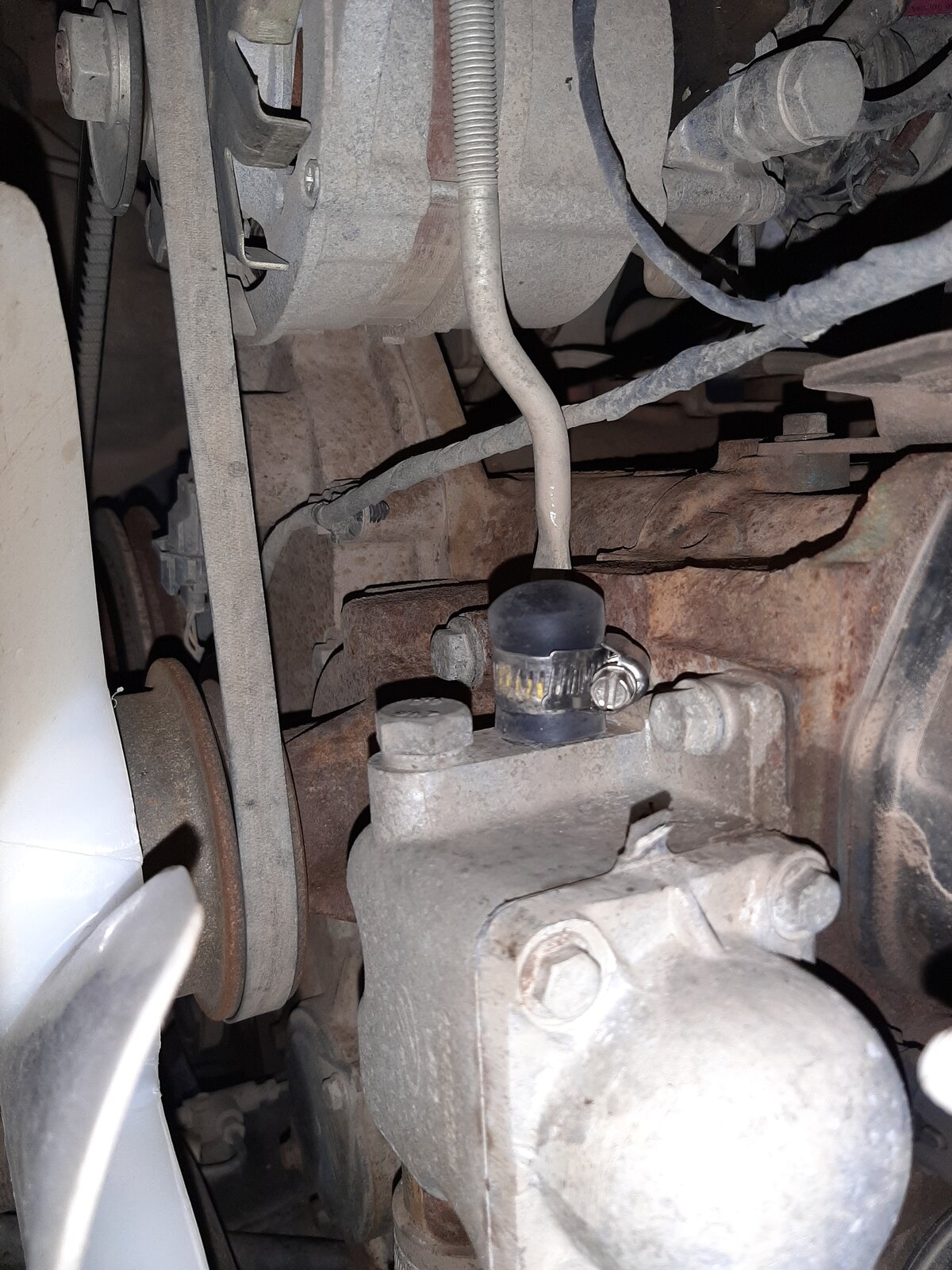

I'm looking for a delete kit any ideas

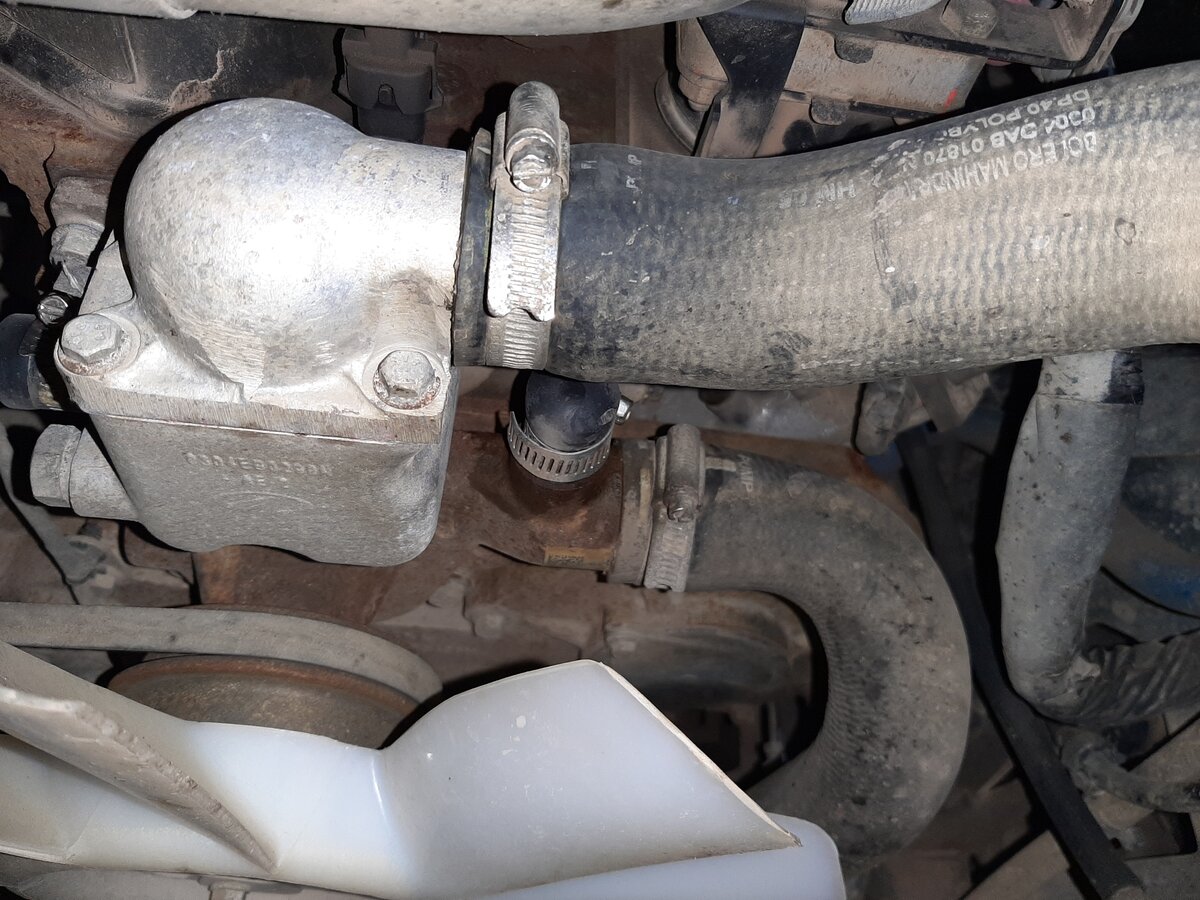

Get a piece of plate and make it. I removed the EGR , took the gasket and traced it onto the plate and cut it out with a grinder then drilled the holes. The 2 cooling lines I capped off at the source. No check engine light.

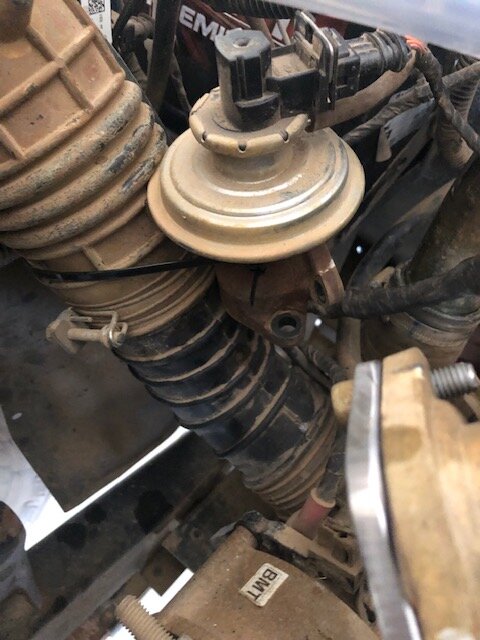

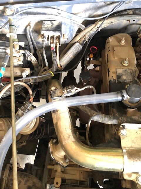

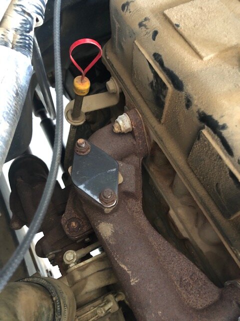

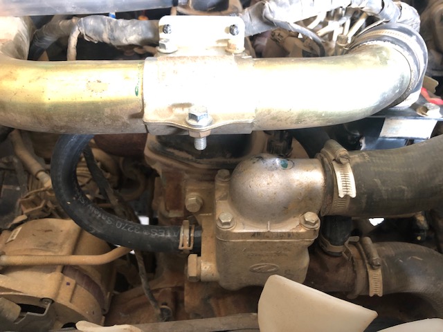

I did mine this afternoon. I made the plates from 2" x 1/4" flat strap and found about a foot of 5/8" heater hose in the shop. I used the heater hose to loop between the intake and discharge instead of capping them. I zip-tied the valve to the air intake up-tube. The whole thing, including making the plates took just over an hour without hurrying. It was really easier than I expected.
