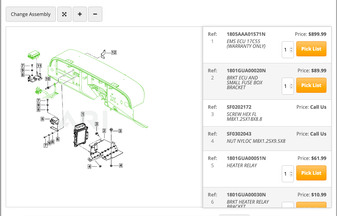

Just looked, do you really get to keep original one? These ECU's are not cheap, if you are good withe the power increase and get to keep the original thats a great price. However i do not know if it is a good tume, my sons and i have several custom tuned cars and have not used "KMS".
No kidding, considering a new one is $899, I doubt if they bought them from Roxor...
and the way it lists it as 'warranty only, I'm not sure you could even just buy one out right.
I heard, and I don't know if this is correct, that a 'stage 1' tune is the same as what a Thar is stock. Are these just imported Thar ecu's? I am totally guessing on that part. They might work fine, I'm just thinking out loud.
Bhayarock
Oct 22, 2018
74
Taylorsville, UT, USA
Very unlikely that these are OEM imported from thar as they cost around ($600 even in india)shipping extra and plus the profit.
The interesting part is the chip the bosch EDC 17c55 which is a generic diesel chip, and I know some folks in india who import the board (the PCB) from china and puts the chip on these boards and there after they program them. The board (china import)costs about $150 and the chip if ordered in bulk costs around $100. The whole package can be procured including the metal shield for around $300 but this wont be OEM but essentially the same bosch chip. However the quality of this thing cannot be guaranteed.
[I dont know if anyone here is electronics enthusiast a good analogy here is your personal computer , the processor chip is from Intel or AMD but the board can be made by multiple vendors Asus,GIGABYTE, foxconn, apple etc]
Same ecu for a different vehicle, all you need to do is burn the tune for bolero, thar di or whatever tune the roxor uses
Foton Sapp SUV/BJ493 engine computer board ECU Bosch EDC17C55 0281017499 - ChinaglobalMall
Long story short $625 dos not looks like an OEM but it will be the same bosch chip on an aftermarket board. The quality of the same can be in question. I would only buy it if I am given a warranty for at least 1 year.
Other thoughts:
The software tune is out on internet and all it takes is the program to burn this chip and I guess many companies have made profit just by burning 1 copied tune, for the same price you can actually get the software tune file, the work bench and the burning software. A good business idea for sure.
