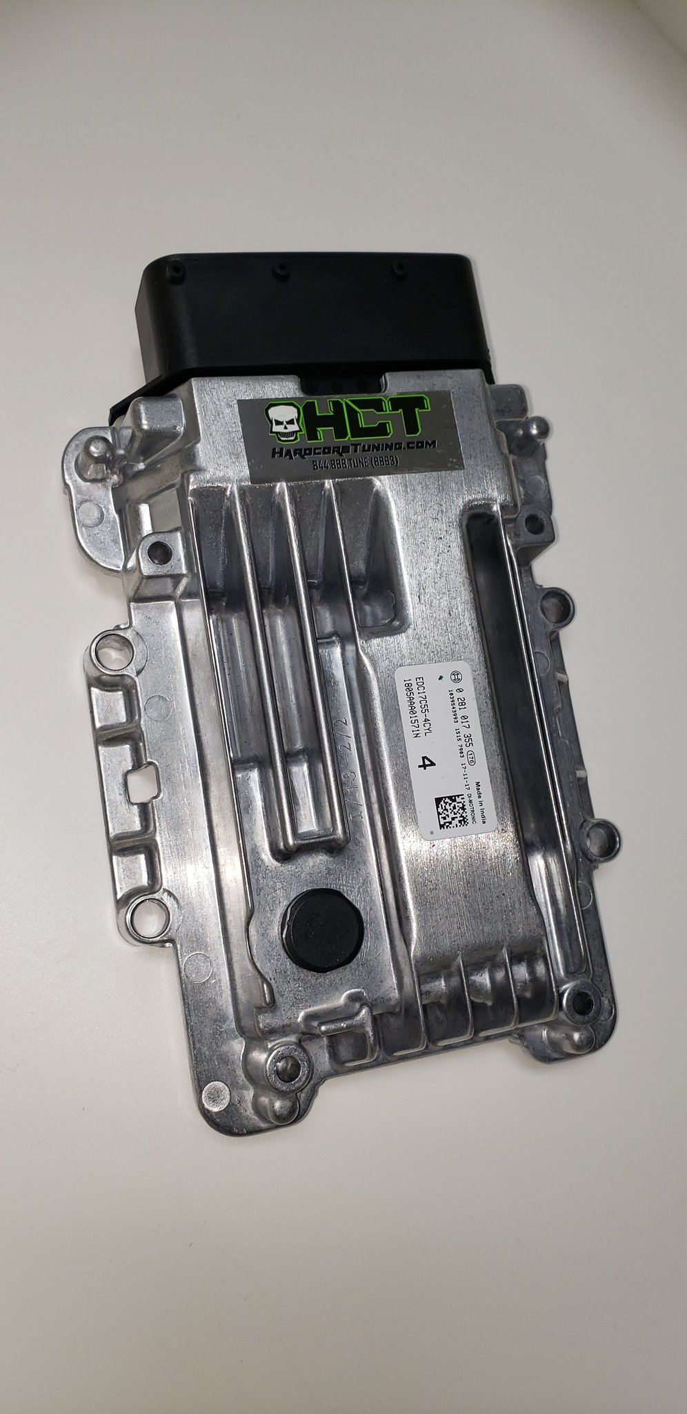

As far as what's involved in getting the services, it's very simple. Just remove your ecu ( 4 bolts and a plug on drivers side wheel well under the hood) and mail it to either of them with an attached letter and contact info. Put tracking on the pack so you can call them when it attached rives attachedrrivesnd they will flash it same day and overnight it back to you. I have attached a pic of a roxor ecu so you know what your looking for. Again, it's the only thing like it under the hood and sits on the drivers side wheel well, their are 4, 10 mil bolts at each corner, then you cam the plug retainer up and remove the plug. I would unplug the batery prior to doing this though. Good luck. P.S as for numbers, use Google and find the number. I'm not a phone book;)
