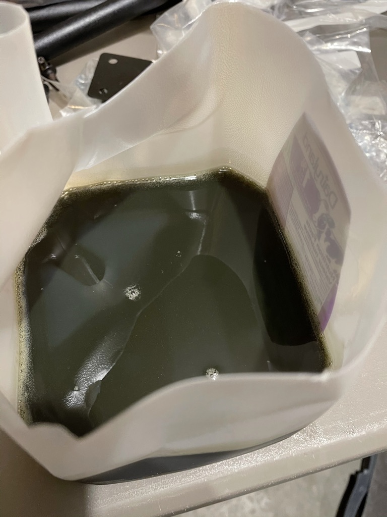

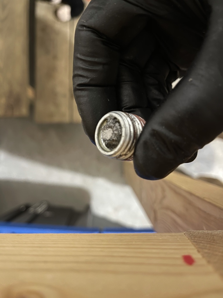

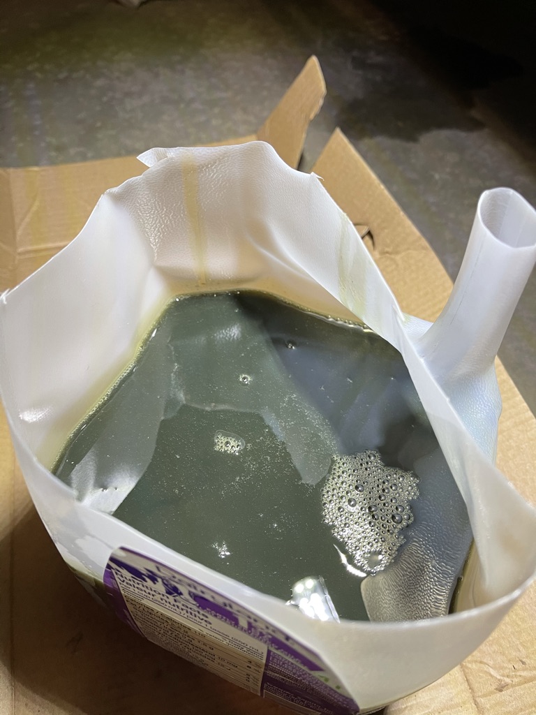

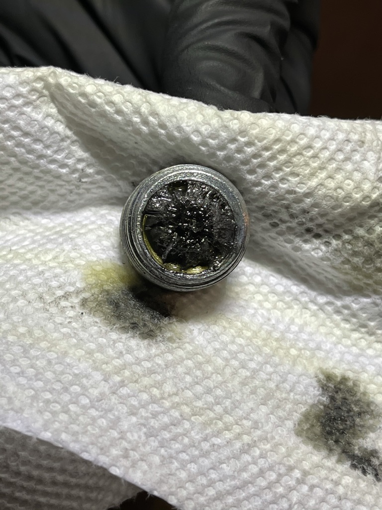

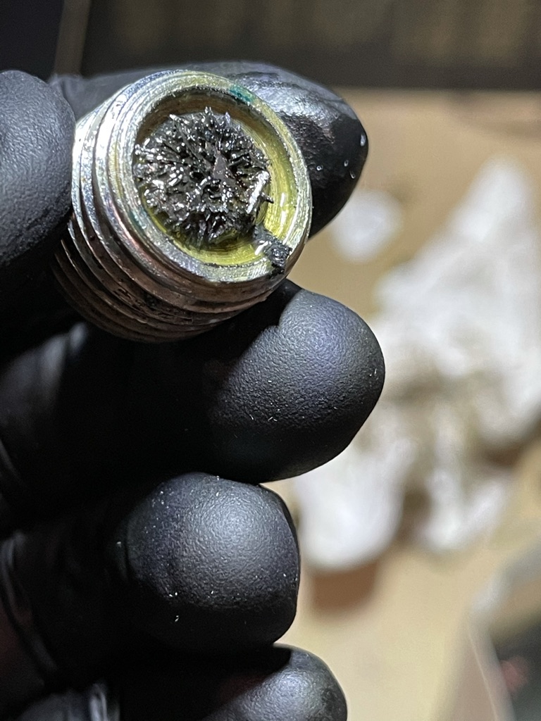

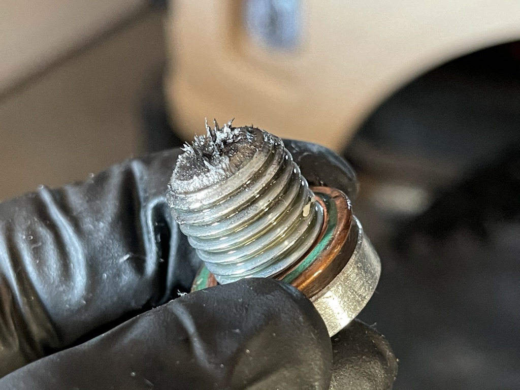

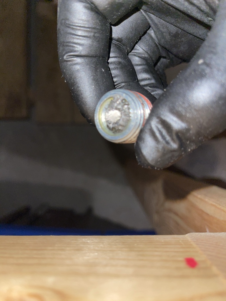

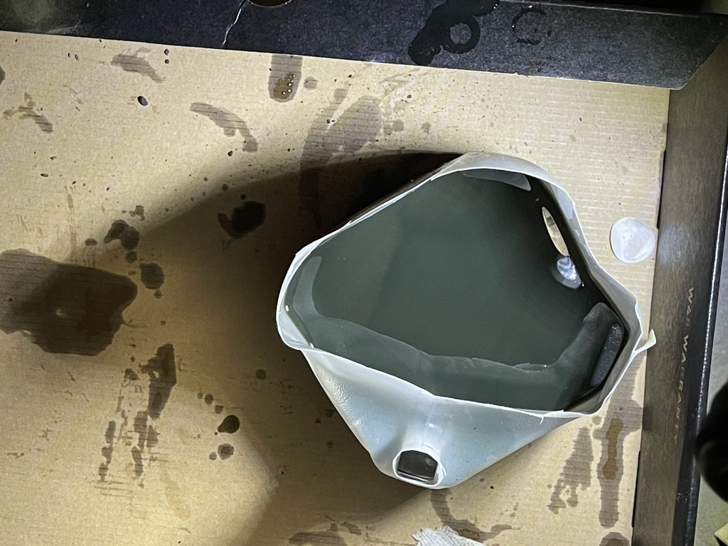

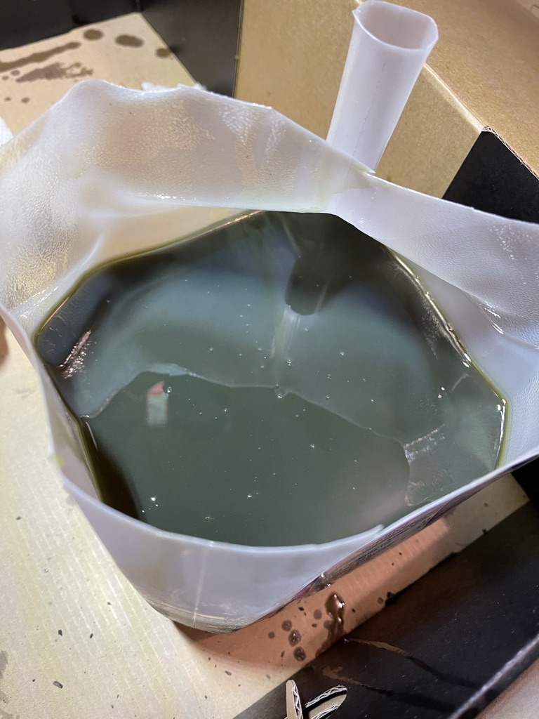

Still trouble-shooting this sound. I did replace all of the fluids in the front, rear diffs, TC, and transmission a couple of days ago (750km, 48hrs). The colour of the factory gear oil was interesting (see below). None of the magnetic plugs showed anything unusual (minor filings typical of vehicle brea-in). This Roxor has seen any deep water, perhaps 4-6" once, at a crawling pace, while crossing a small puddle.
I'll include a video of with the sound in the next post.
Transfer Case Fluid
Transfer Case Plug
Transmission Fluid
Transmission Plug
Front Diff (Spartan Locker) Fluid
Front Diff Plug
Rear Diff (Spartan Locker) Fluid
Rear Diff (Spartan Locker) Plug
1609825927887.jpeg 1609825990668.jpeg 1609826124820.jpeg 1609826163316.jpeg 1609826186076.jpeg 1609826237333.jpeg 1609826267099.jpeg 1609826308361.jpeg 1609826352357.jpeg

Those magnets sure seem to have alot of metal. Mine hardly had anything on it. I would keep an I eye on things for sure.
